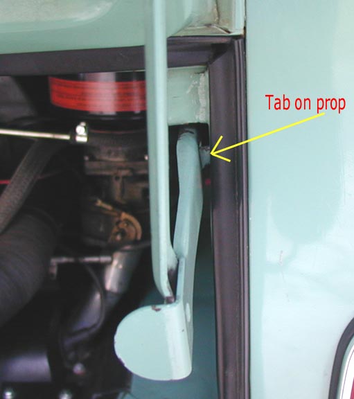

Well I found one of those elusive springs that helps close the engine lid on early buses. As I look at the engine prop elbow area it looks like there are 4-5 places where a spring might go. Does anyone have a picture of the spring installed or is realy good at explainations? Your help will be greatly appreciated. Oh, I have already checed the archives section and did not come up with anything.
Moderator note:
Here is a summary of the information in this thread:
Spring:
Operation:

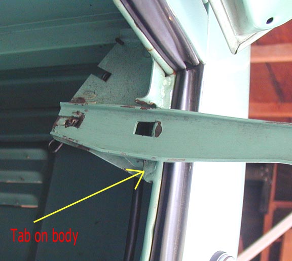

When you lift up the engine lid, the prop tab (see photo) slides up the side of the engine compartment wall along the tab on the body. Once it gets to the top of the body tab, the spring pulls it towards you (or you pull it if you don't have a spring) and the tab ends up sitting on top of the body tab (bottom photo)

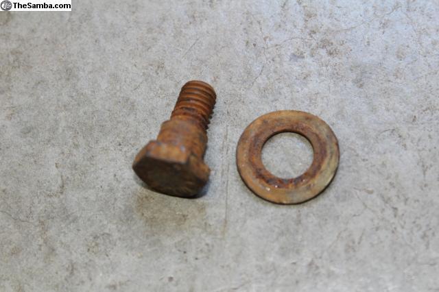

Original bolt with shank and wavy washer:

Here it is:
Hope that helps,
Scott
tasb
The Distributor Distributor
Joined: April 27, 2002
Posts: 6787
Location: Pentwater, Michigan
tasb is offline
PostPosted: Sun Jan 11, 2004 10:10 pm    Post subject: Reply with quote
Dag Scott that photo is dead on. How in the world did you get that pic? Either you are a circus act performer or you are smallish and could fit inside the engine bay. Anyway you are THE MAN thanks !!!!!

Installed the spring this afternoon. I have never seen another bus that had one installed though I'm sure they are out there. Most do not know they have one missing.
for those who have know ideas what this is all about the spring adds tension to the elbow prop so all you have to do is push lightly on the tab of the lever to disengage the stay and down comes your lid. Previously I had to push and tug and finagle it loose.

can someone post a pic of the front side of this bracket that the stay and spring go on as it looks to me as though some of that is missing from my bus

Does this help?

Great pic! yes it does help, need to get out and compare it now. My stay will connect to the bracket on the bus but comes off just as easily, will the spring hold it? In other words I've not been able to get the lid to stay up with the stay and no spring, still I feel i'm getting ever closer to the answer!
