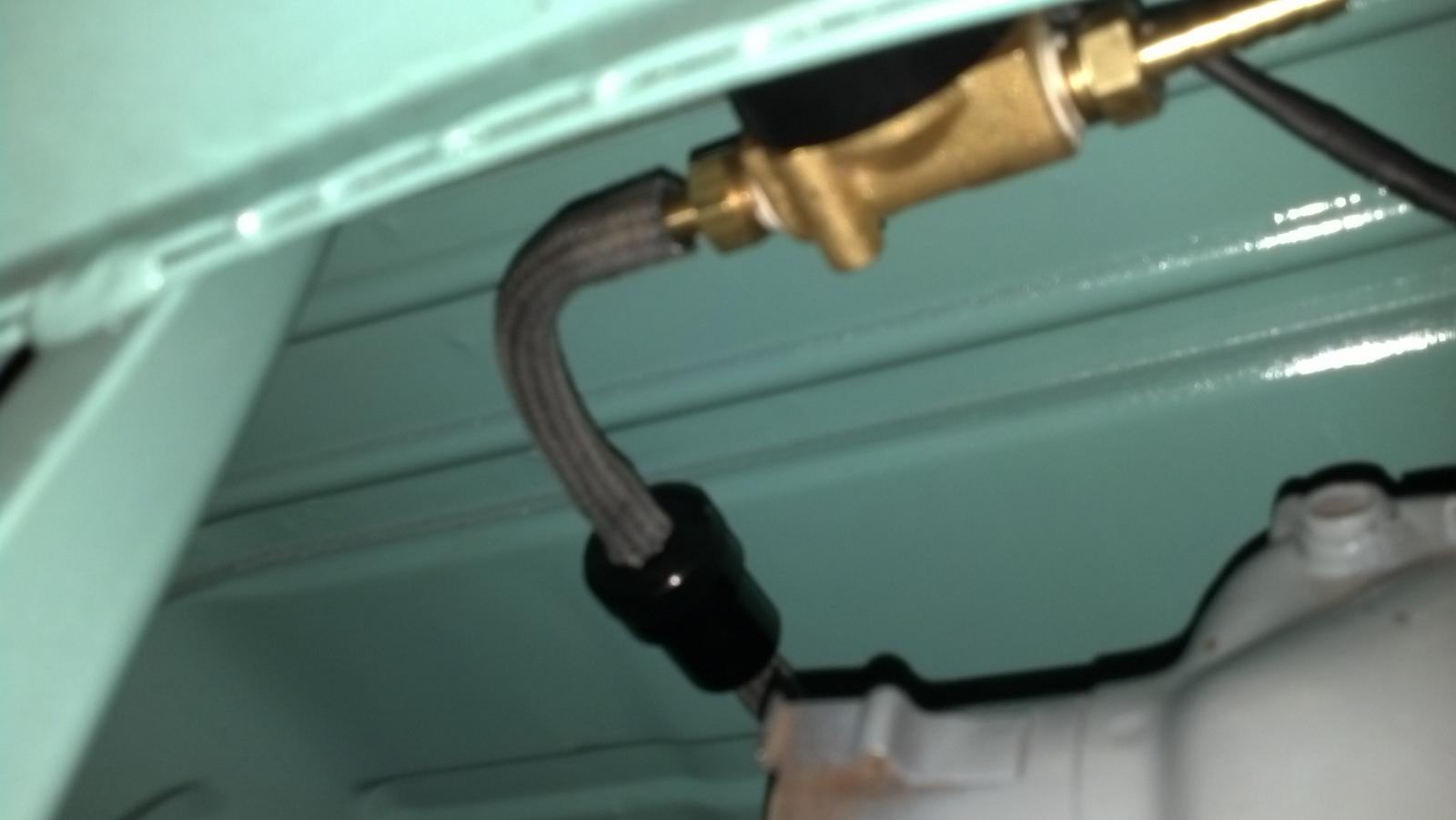

PostPosted: Mon Aug 04, 2014 8:21 am    Post subject: Follow up Reply with quote
Well, I pulled the carb, tapped the fuel inlet and installed a threaded nipple (needed to drill with 7/32 drill to get the tap to go deep enough). The needle/seat I pulled seems to work good when blowing air through it and closing. No wear on float tab and float is perfect. Unfortunately, replacing the needle with the one in the universal kit was going to happen:
I bent the tab on the float just a smidge and put it back together. THEN noticed the screws weren't seating all the way before they got tight. The through holes weren't tapped completely. Could have been the issue all along if the needle wasn't seating all the way.
At any rate, installed the fuel solenoid, added an aluminum filter before the solenoid and added all new fuel hose with fuel injection clamps on pressure side. FWIW, I measured the amperage of this solenoid that you get from JOGR and it's 1.2A for the initial hit and draw bleeds down to .9A. I'm a fan of relays also, but then you create more failure points as well. At that amperage, it works fine off of the extra tab on the 12V side of coil.

BarryL Premium Member
Joined: November 01, 2004
Posts: 15184
BarryL is offline
PostPosted: Tue Aug 05, 2014 2:34 pm    Post subject: Reply with quote
That is weird about the needle/seat. The one on the right is a nice design fwiw.
I'm not a fan of the barbs which stress the hose when using factory hose plus they propagate cuts/cracks in the hose. If it were on my fuel train I'd sand those flat and try to get it down to 6mm diameter.
Still, a sano set up.

PostPosted: Wed Aug 06, 2014 7:14 am    Post subject: Reply with quote
The unit on the right is the one out of the carb that I reinstalled, Considering that the screws securing the top of the carb (and needle/seat) weren't even compressing the lock washers, I'm pretty satisfied with the theory that it was creating just enough distance between the float and not shutting off completely. Gasket was compressed "just enough" I guess.
I had those barbs in the garage and will likely change them later to the smooth type as I have more hose on order now anyway. I was 1" too short to complete the job and had to reorder (story of my life).

PostPosted: Wed Aug 13, 2014 3:26 pm    Post subject: Reply with quote
An FYI for anyone interested, this shut off solenoid got me 45 miles total before shitting the bed today leaving me sandwiched between the pavement and frame while I bypassed it.
I pulled it when I got home and tested directly to battery and instead of a "clunk" it had when new, it was just a "click". When it's "on" there's just barely a flow of air I'm able to push through now as opposed to an easy flow new.
