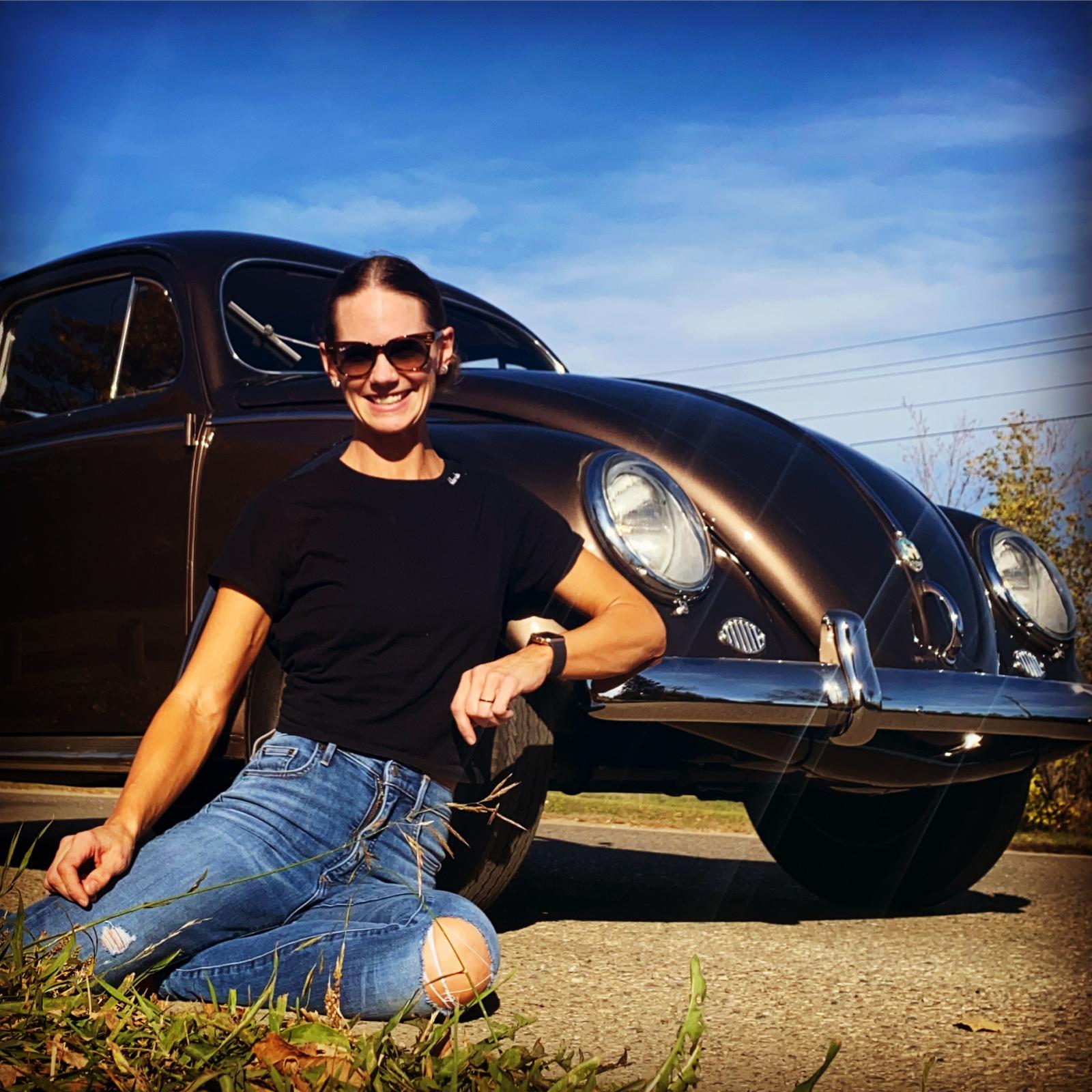

I’m not sure how I didn’t see this earlier.
But… a super busy summer with almost no time off work, meant I didn’t get out as much as I’d have liked, but I did get out a little.

It’s looking fabulous! You must be stoked with how it turned out!
Thanks for the updates 😊 Dave
