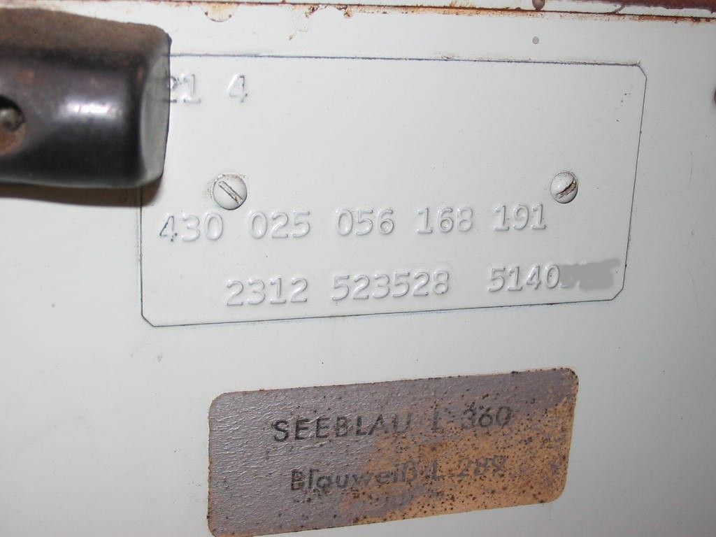

That's quite an mcode plate for a poptop Westy. Somebody went to the dealer and checked all the boxes. Good luck with the build.

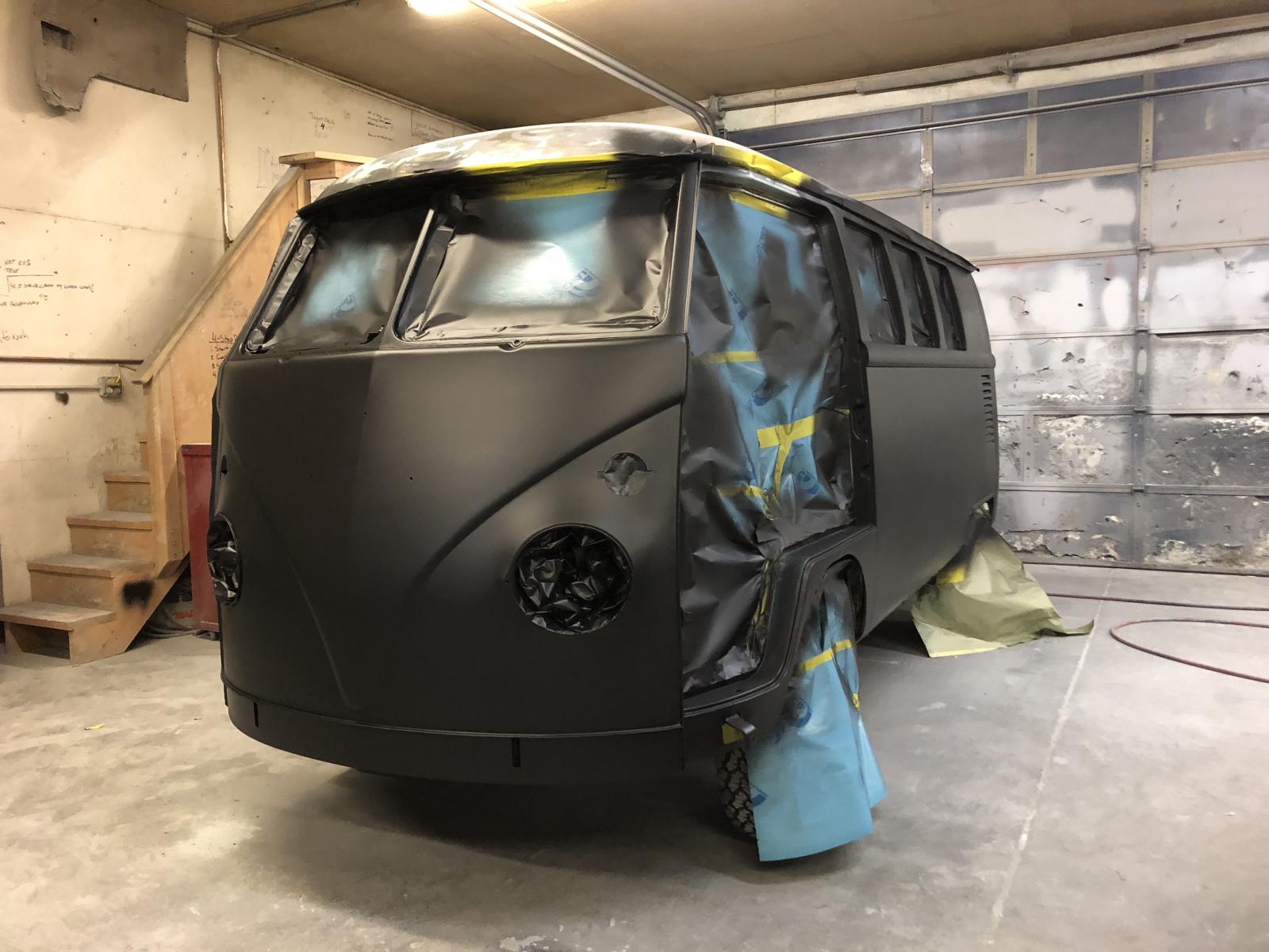

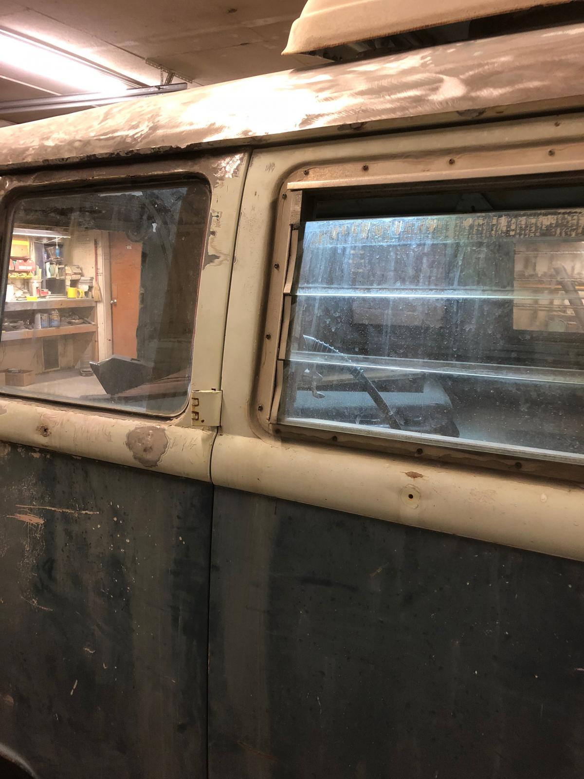

Well, lots of progress since my last update. The previous owner filled all the seams with silicone so that all had to be stripped out, which was easier with the doors off. While the doors were off I went ahead and replaced the lower door skin.
Got the new battery tray out after removing some custom "bumper brackets" the previous owner had welded on in order to clearance the beetle exhaust that was on it at some point. The new KF battery tray fit nicely with very little finessing.
Working my way around the bus I noticed that the gap between the rain gutter and the side panel widened as you moved from the rear passenger side to the front. It was noticeable from the outside but really obvious from the inside. To correct it I found the point where it looked like the welds had broken apart, hooked a portapower to the inside of the gutter, and linked it to a ring I had welded to the cargo floor on the cross member. Just a little bit of pulling and the whole passenger side panel got pulled into a better shape and make the gutter gap and the door gaps a ton nicer.
The spare tire mount on the nose was probably used as more of a bumper given how much pin and shrinking work it took to get it back into shape and stiff.
Undoing the wrapping on the heater tube revealed more rust and the rear cross member was too thin and weak for me to live with, so more replacement metal went in. Ground down all the welds to look nice and smooth too.
Then did some more finish metal work and getting every little dent pulled on the corner and nose before we started mudding on the nose.
Spent 3 days block sanding the long panel.... Shocked Rolling Eyes Rolling Eyes
I didn't think it was necessary to make it so nice its going to be used and driven off road and on trails and will be scratched, but John likes to punish me for being in his way.
The paint shop was out of grey poly, so we had to do black. Just shows more imperfections so I get to make it even more perfect, and spend more time fixing every little thing! Including my handprint I put in it while it was still drying Laughing
Up next is the roof and then removables!!

Really nice work. Since it was two-tone painted originally are you sticking with that or going a single color? The color code on this thing is really unique, never seen a poptop Westy in L680 over L289:
What does the color code sticker just below the mplate say? The paint on the bus now just looks like standard Sea Blue/Blue White.

What does the color code sticker just below the mplate say? The paint on the bus now just looks like standard Sea Blue over Blue White.
I'm going to be sticking with the original two-tone colors, Blue White over Sea Blue ,L289/L360. I was worried that combination would be too "cute" for the look I was going for, but got some pressure about it being a special ordered two-tone in a one year only combination.
Here's a photo showing the sticker in some terrible lighting from when I first came across the bus. I'll get a more clear photo of the m code and the sticker next chance I get.
What makes it a one year only combination?
I was under the impression that blue white over sea blue was 1965 only before going to cumulus white.
Myself as well. I prefer the blue white with the seablue.

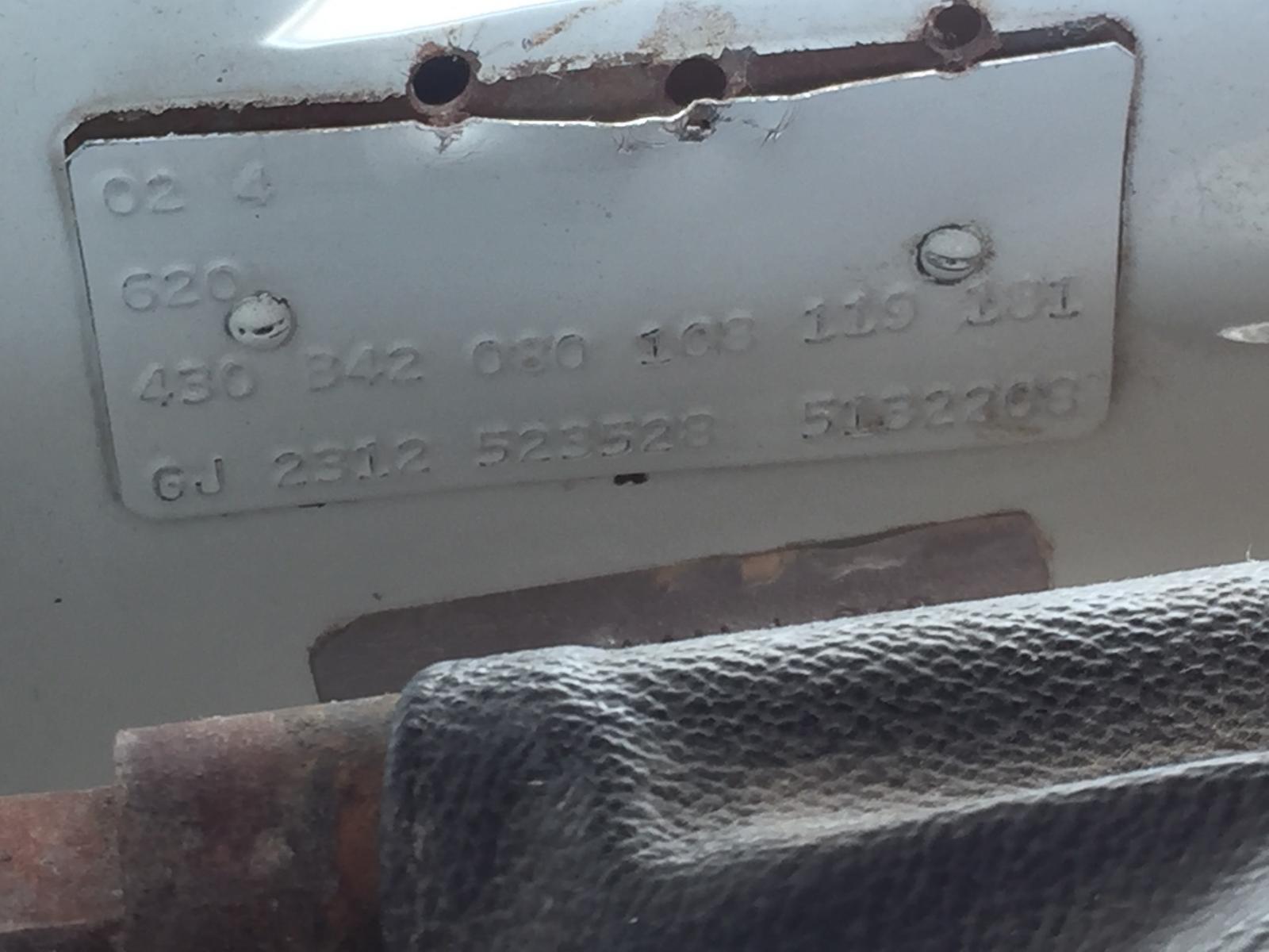

Interesting M-code plate. Generally an SO-42 with two tone and options has no portcode and no x42 or 108 code or power outlet... but yours does. Not sure I've seen that before. You got a cool one.
This is an SO-42 Dormy bus I used to have that was built later the same month. two tone no port code westy.
