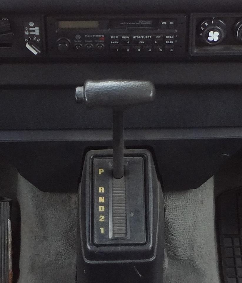

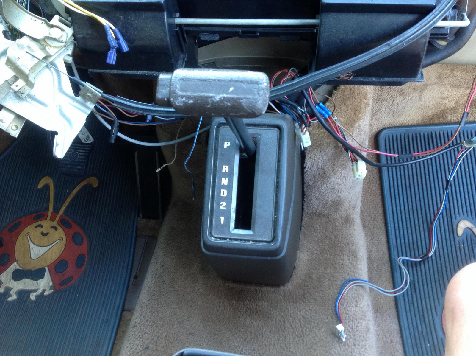

I've an Automatic Vanagon. Sadly the shift rod gap cover that surrounds the shift lever and slides forward and back with the lever is long ago broken and gone.
Heres a picture to help....... (Not my van and I wish my shift knob looked half that good! It's an 86 Audi 5000 Turbo knob)

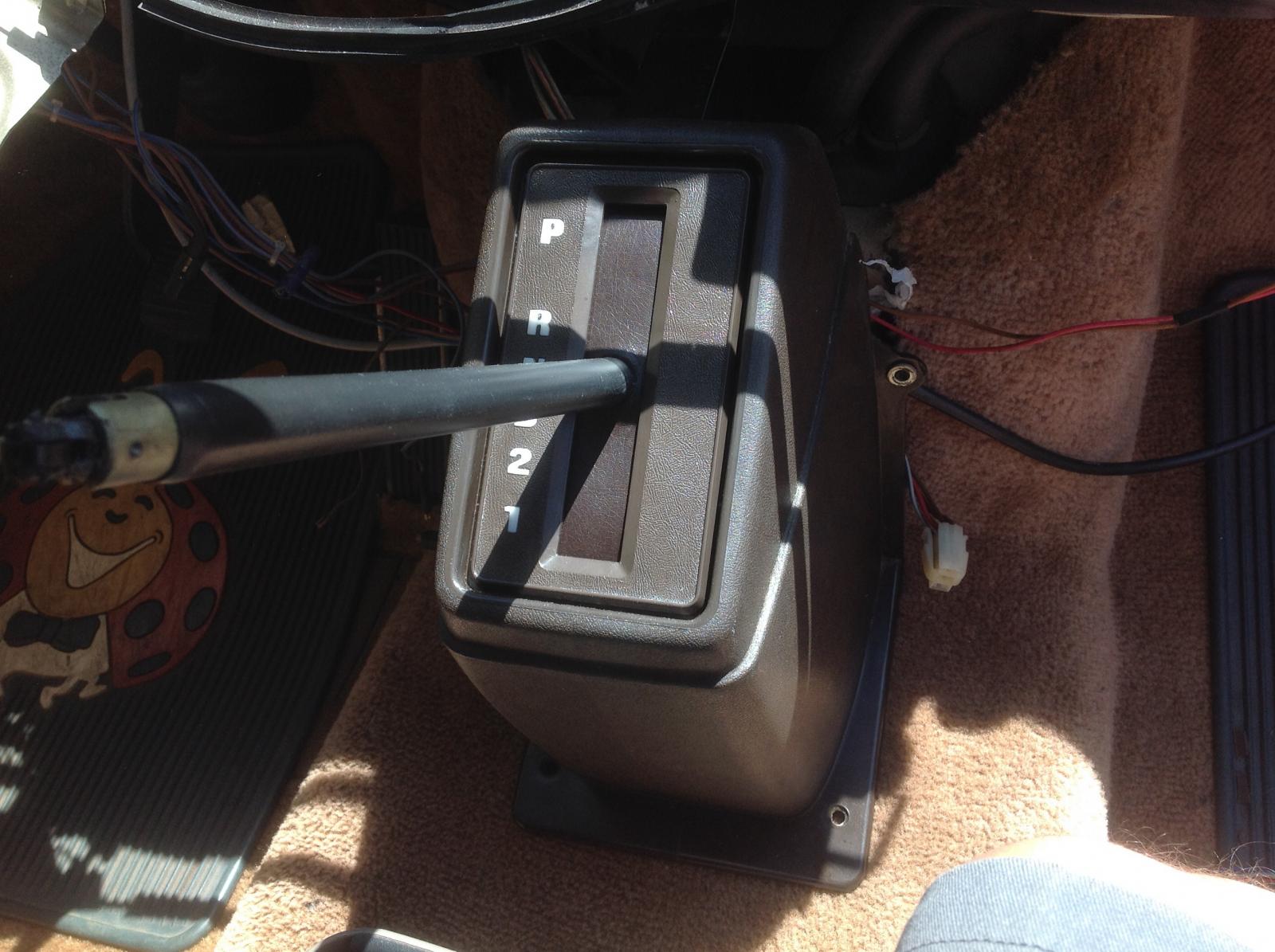

Here's mine without the gap cover....... I think my PO used to teeth on the knob!
Is there a source for a replacement piece or ideas for improvising a new one?

Foam board, good idea but too flimsy........

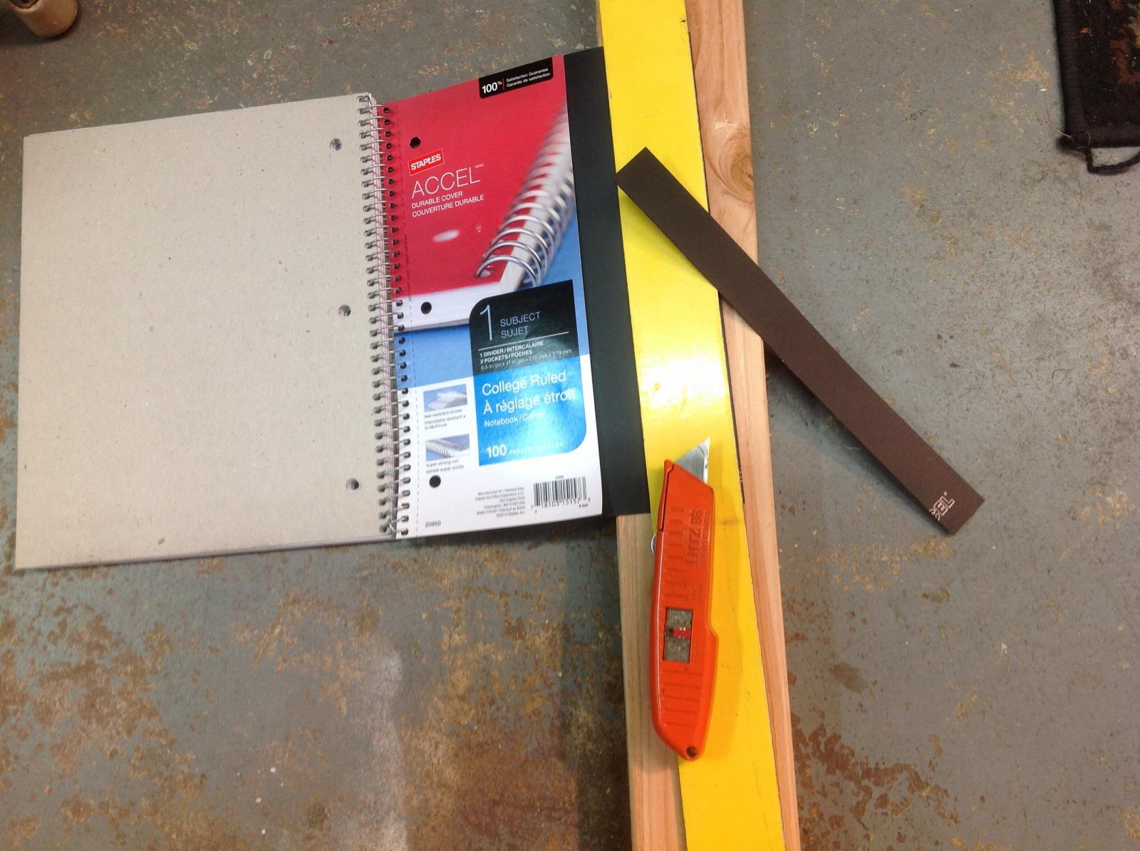

Hmmmm....... A simple $2 spiral notebook with a black plastic cover..... Not cardboard.......... Back side of cover is a nice pebble grain..........
If I slice off a 30mm wide strip (just shy of 1 3/16") punch in a 5/8" hole.............
Step one...... Brave the back to school shoppers at Staples and secure a notebook......
Step two, cut cover off........
What? You say that Step two is go pick up Pizza?....... Yes Dear........ Wink
Ghia
Vanagon
Beetle
djkeev
Joined: September 30, 2007
Posts: 32988
djkeev is offline
PostPosted: Fri Aug 29, 2014 9:39 am    Post subject: Reply with quote
Well, the night has gone by, good Pizza, good Wine, a nice fire in the backyard fire pit.

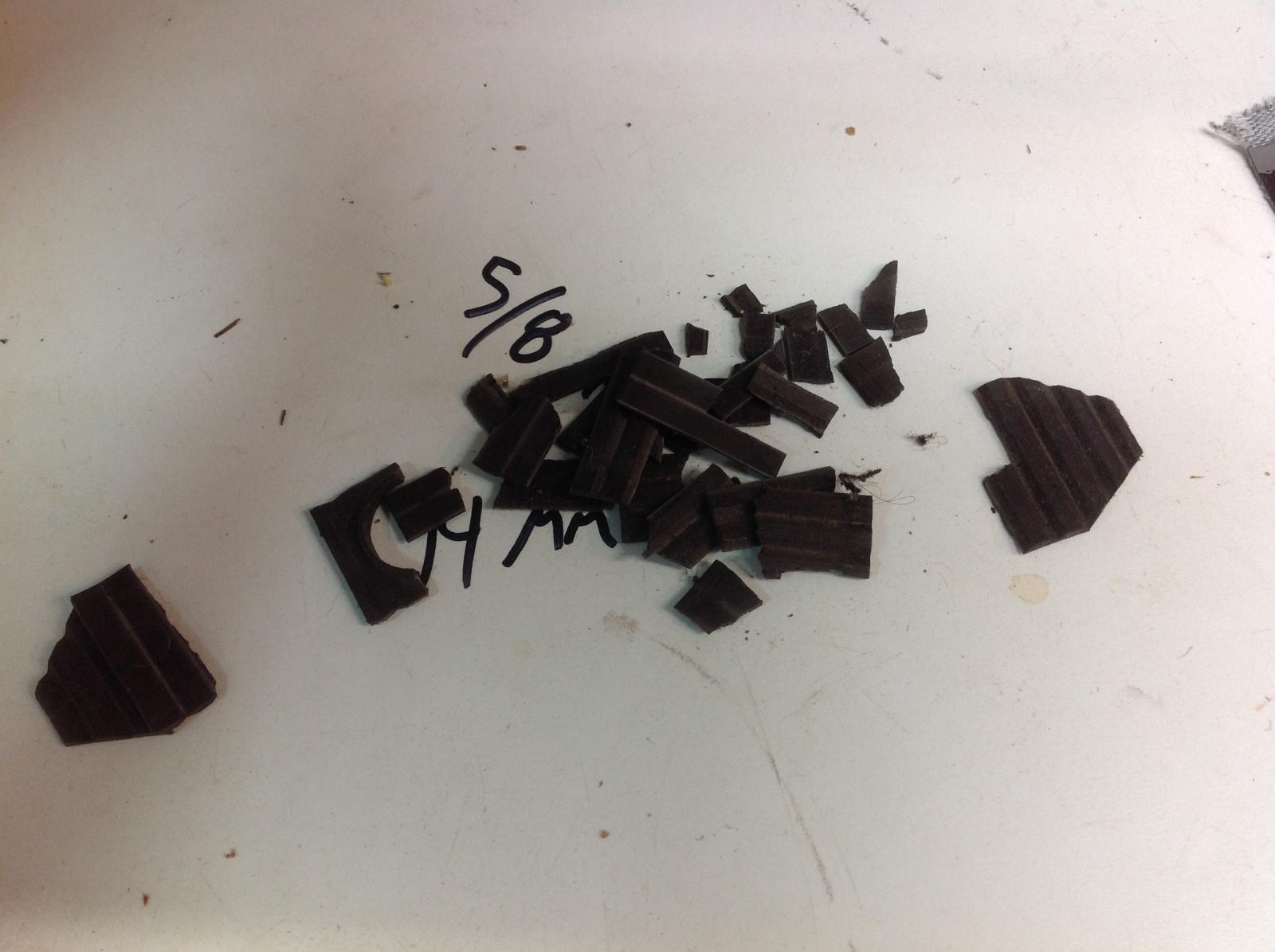

BTW, here is the original cover, it is so brittle that the pieces break when simply touched!
I didn't rip off the notebook cover, just sliced off 30mm of it.......

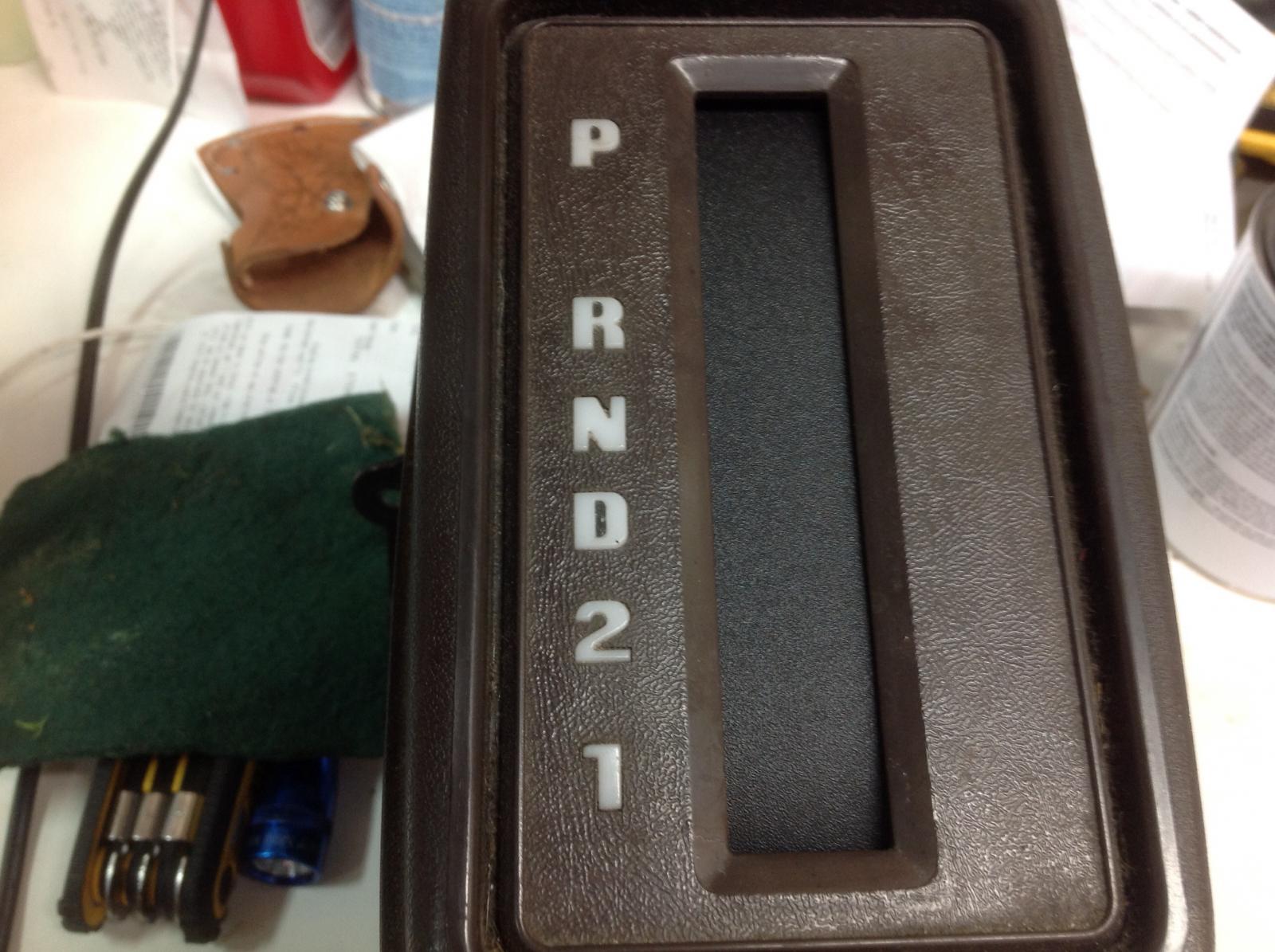

Installed! Pebble side up...........
I don't like the Black, it would look better Brown, I've got the Vinyl for my Dash recover project!

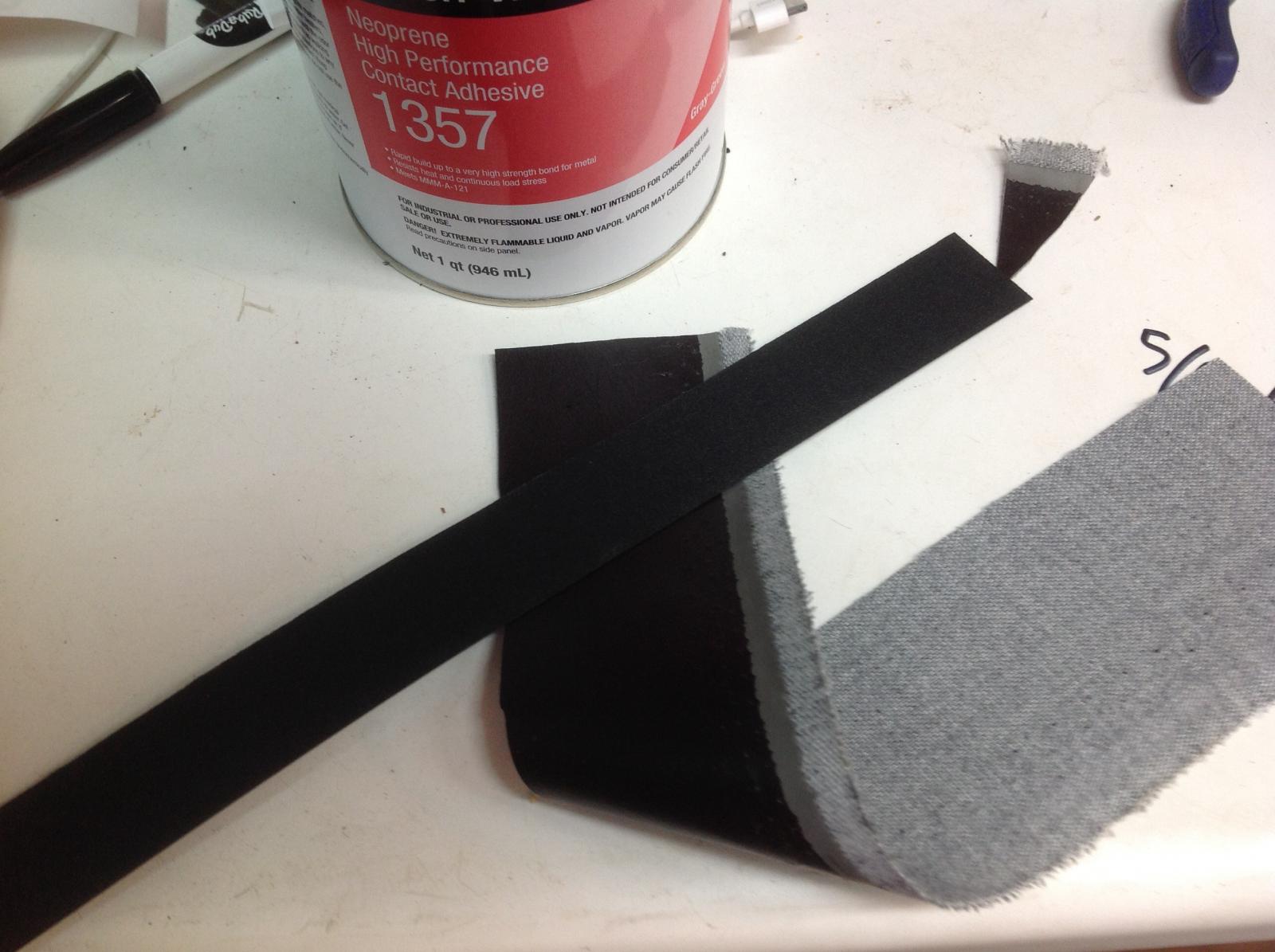

A small slice.........
I used my 3m 1357 adhesive and applied the Vinyl to the Notebook cover slice.

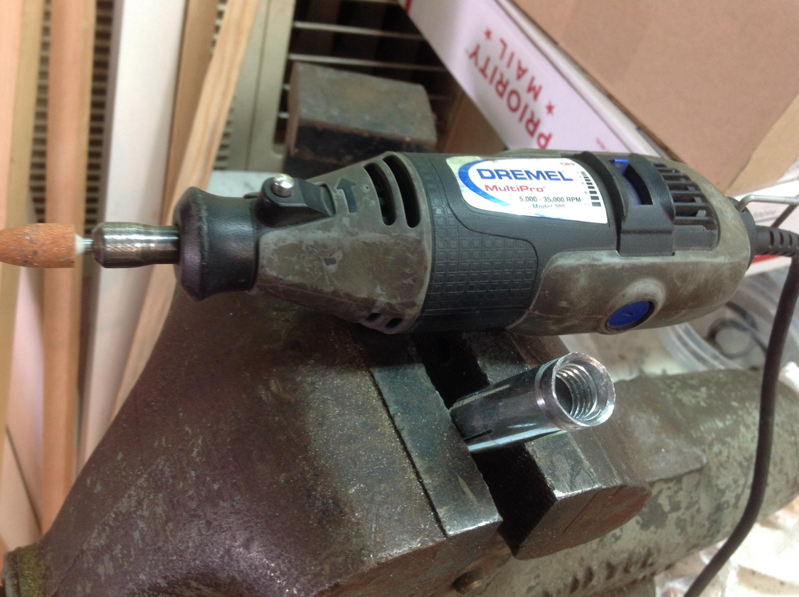

I need a 5/8" punch...... I don't have one but I do have a wedge concrete floor anchor that has a 5/8" diameter body!
A little grinding with the Dremel making the outer edge razor sharp..........
I set the strip on a 2x set my punch over it where I want the hole..... Strike firmly and Viola'!!!! ........ A Brown Shifter Gap Filler!! Smile
I placed the hole 5 1/4" from one end of the plastic strip that was cut from a binder cover. The vinyl over runs the length by about 1" at each end.
