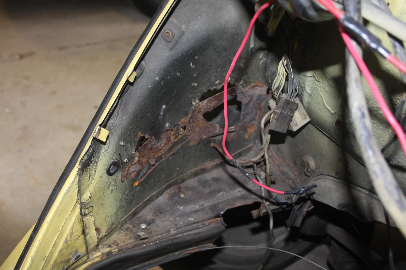

PostPosted: Wed Sep 24, 2014 5:37 pm    Post subject: Rear wheel well Reply with quote
So after 10 years of sitting here we go. I pulled out the door panels, seats, carpet. found more rust in the luggage tray area ugg. took off the rear fenders and started cleaning off a thick covering of undercoating. heres where Im at. Theres a few small holes here and there. the engine bay panel is shot. seems like no one sells a 74 super bumper bracket repair panel surprise surprise. it had small custom thin bumper brackets to hold a single blade bumper. How should I approach repairing this area? custom cut and repair every rust hole with spare metal? or could I weld in the 71-73 super bumper bracket here without fitmit issues? Btw Im making the rear apron removable for what its worth. thanks in advance

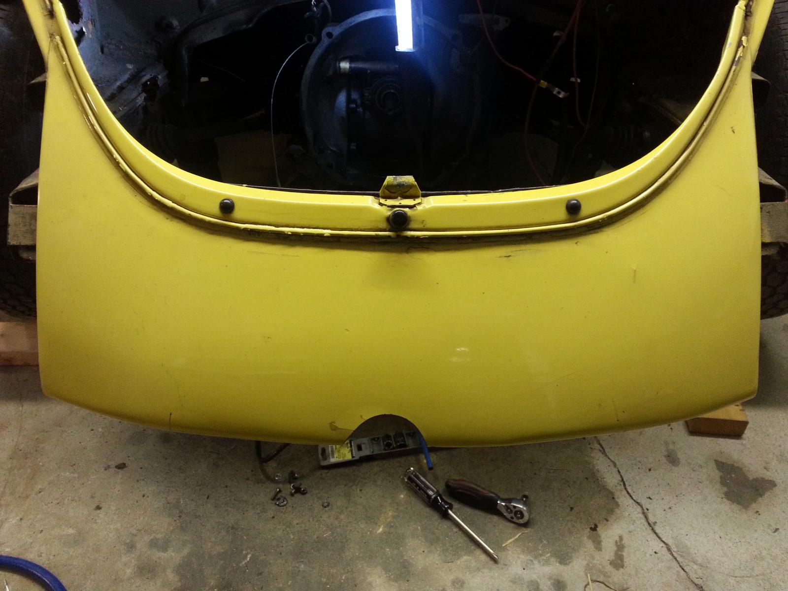

So I got the rear apron removed, the bumpers, fenders, gas tank, and one piece windows which are NOT going back in. undercoating looks really thick in the front wheel wells and shock area. going to be a nasty job removing that junk.
Here is the outside. P.O. cut a single moon in the rear. must have had an exhaust that needed clearance
the inside apron had this makeshift heat shield. I noticed a few small blisters in the paint. so maybe the P.O. made it for that reason. something I may revisit later. does anyone out there have problems with too much heat for the paint on the rear apron? I will not have a stock motor in the car.
this is the inside. Pretty much the reason I had to remove it. horrible bodywork, pop riveted metal with filler. no wonder it had cracks. I'm going with a removable rear apron since I went through the trouble of removing it. and going with the clean no exhaust cut out look.

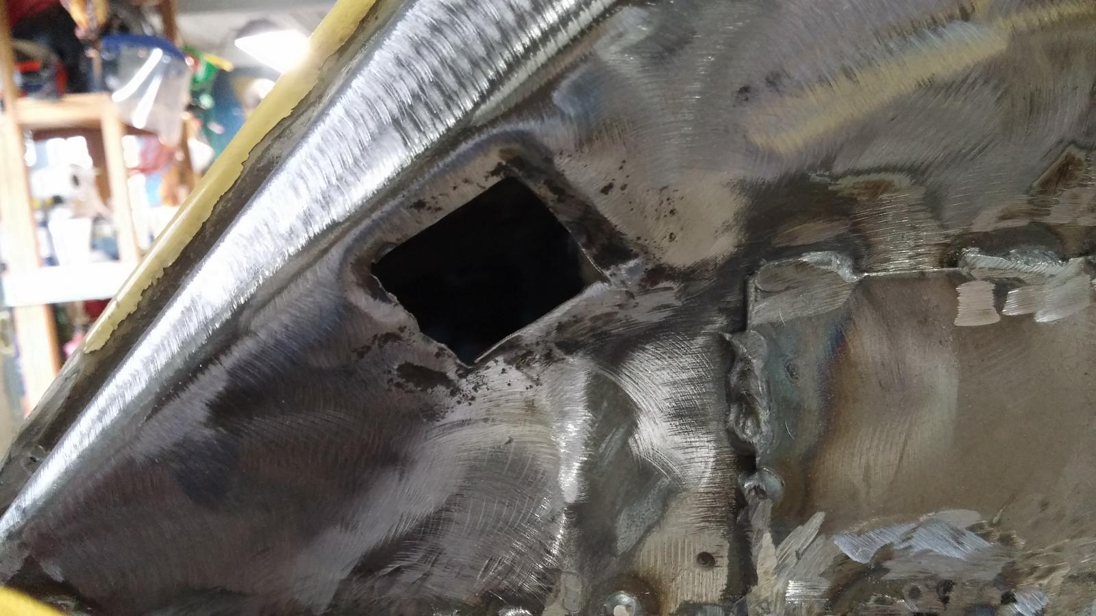

Removed the rear decklid and hood seal channel. Couldn't believe all the rust behind them. Heres a shot of a small section of the hood section removed. I got really good drilling out the spot welds and barely kissed the second panel. Not putting these rust traps back in. gonna grind it all smooth and go with the Mexican seals.
Used these 1/4" Irwin twist drill bits. cheapest thing out there and worked great.

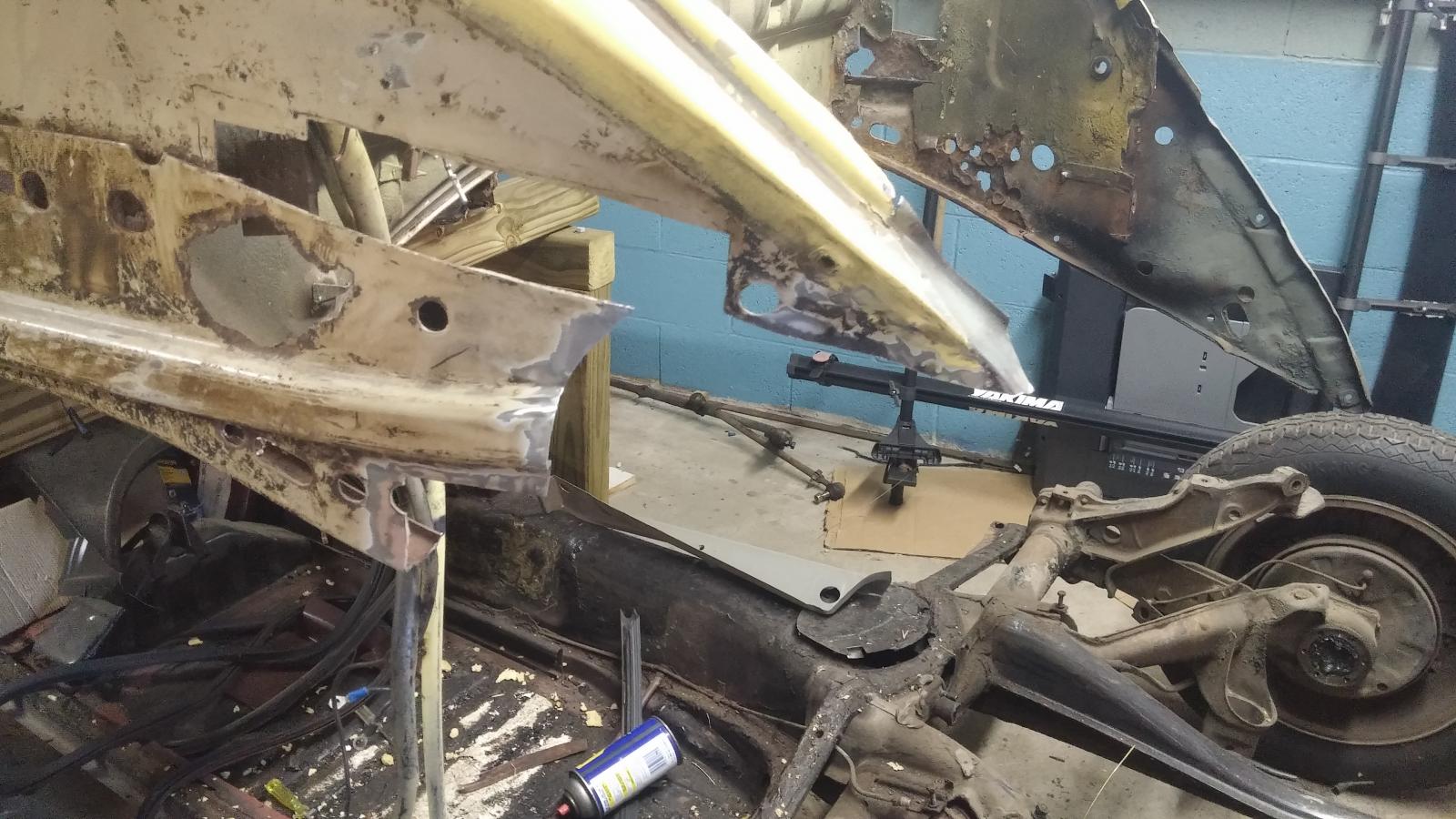

PostPosted: Sat Oct 18, 2014 6:48 pm    Post subject: body off Reply with quote
Also finally got the body separated and on a stand with wheels

PostPosted: Wed May 19, 2021 6:40 pm    Post subject: Re: Josh's 74 Super restoration "Lil Sno" Reply with quote
Been awhile. project stalled out a little. bouncing from body to frame. I figure any progress helps. Napoleon Hat crusty on both sides. time to work

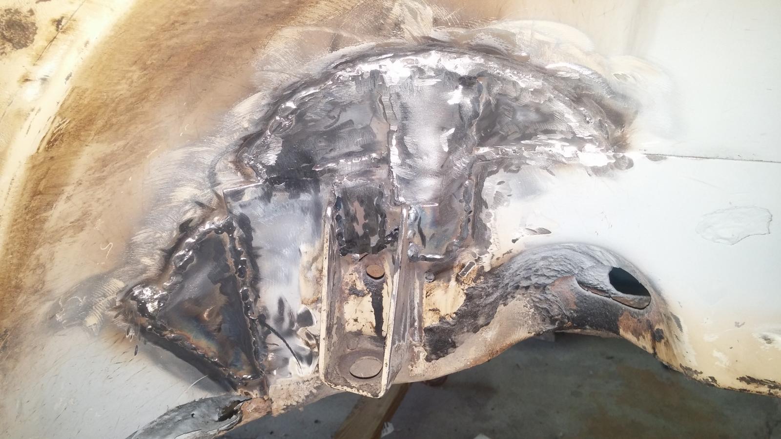

PostPosted: Wed May 19, 2021 6:52 pm    Post subject: Re: Josh's 74 Super restoration "Lil Sno" Reply with quote
Took my time, used parts of the Nap Hat and Bottom frame head repair panels and keep as much original metal as I could.

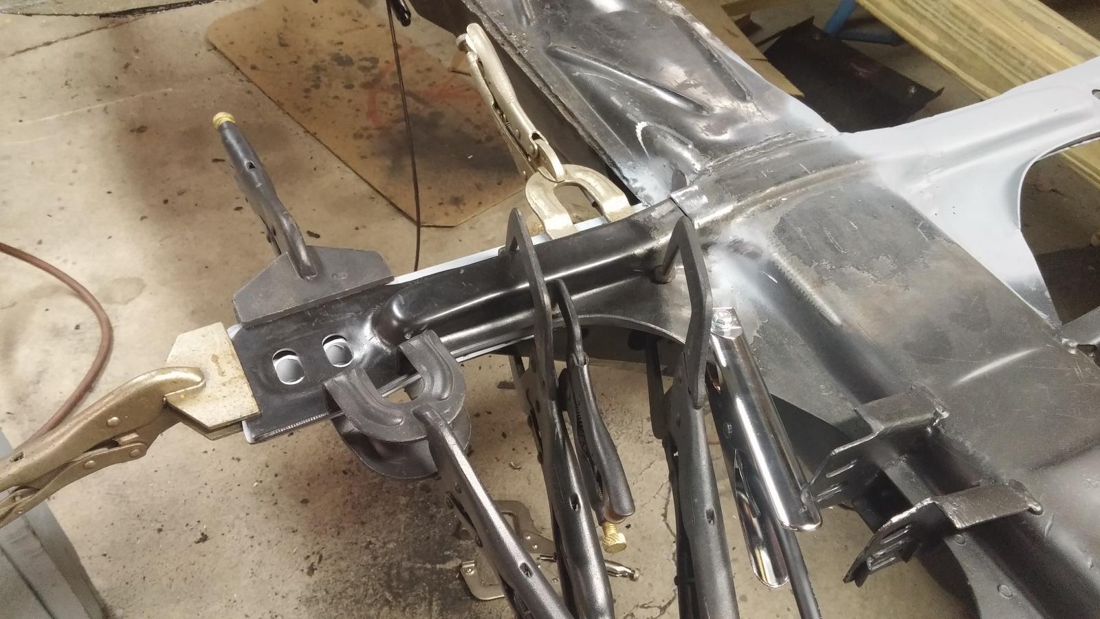

PostPosted: Wed May 19, 2021 6:54 pm    Post subject: Re: Josh's 74 Super restoration "Lil Sno" Reply with quote
While I had the welder out notice one of the frame horns was separating, welded the entire seam closed

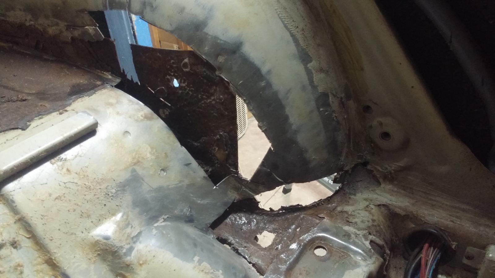

PostPosted: Fri May 21, 2021 12:49 pm    Post subject: Re: Josh's 74 Super restoration "Lil Sno" Reply with quote
Driver side wheel well and bumper mount area is a mess. Always uncovering more rust. Not a fan of the shock absorbing bumper mounts on the 74 Super. Since the rust was bad i lopped the entire bumper mount clip off and will graft in earlier ones.
Little patch here little patch there
