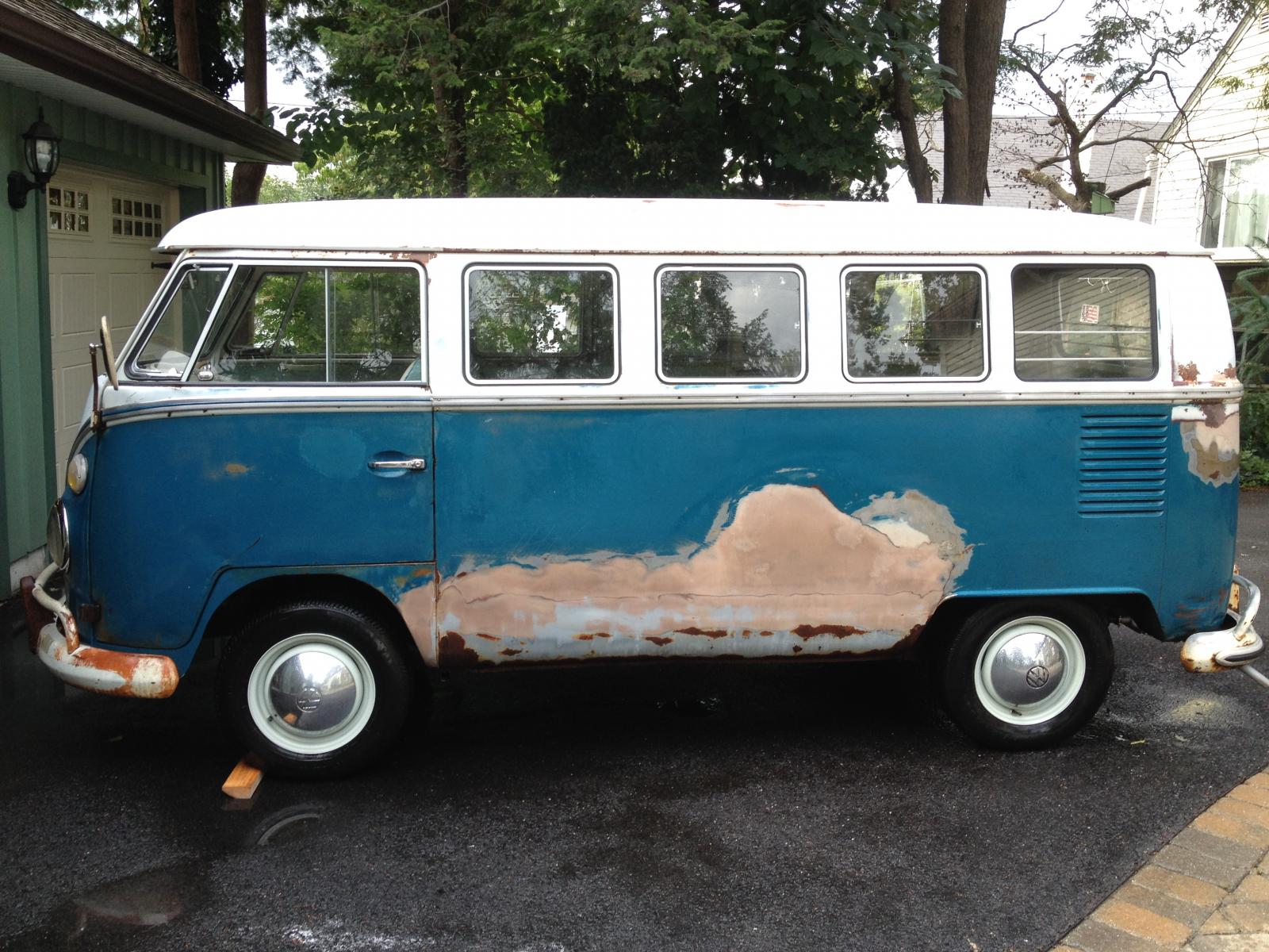

Hello all! Well i picked up this 1967 OG paint bus last weekend over in New York. I was pretty excited because this is my first split window project that's 100% original paint. The frame and under carriage in general is in very good shape. There's a fair amount of rust in the usual areas. Doglegs, floors, rockers etc. It's not too bad... Other then the roof. Im sure debris from a near by tree collected on it and over the years of sitting, it rusted thru. Then the water started making it's way down the roof channels, mice had nested there and those nest, water logged, essentially rusting the entire inner roof line. To make matters worse, the water made it's way thru the inner A pillars and rusted them from the inside out. From the outside the paint looks great and the windshield pillars and lower windshield look amazing. Their inner structure however, is non-existent. My goal is the preserve and keep as much of the original paint as possible. I ordered all of the lower sheet steel replacement parts from WW and i've got that under control. Im going to need some guidance with the roof lol.
All loaded up and headed back to Ohio!
At home and ready to be cleaned up! The wheels were locked up and i had to chain it to a post and drag it back of the trailer. I trashed my come-along winching it up on the trailer. Luckily the back wheels had just cleared the dove tail when it broke.
That's ugly!
All cleaned out to assess the damage.
All washed up and buffed out. Theres plenty of life left in that old paint. Popped a few dents out while I was at it.

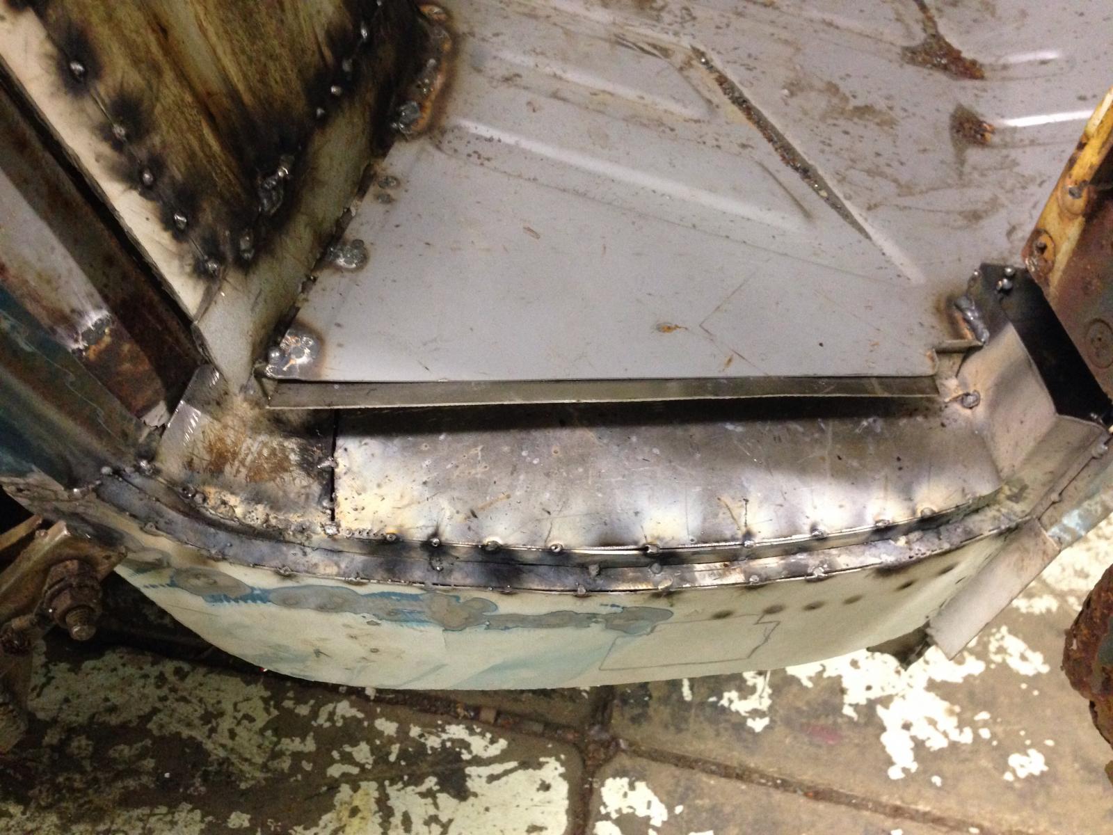

I used metal from the old door to patch up a big rust hole in the outer rocker. Trying to keep as much og paint as possible.

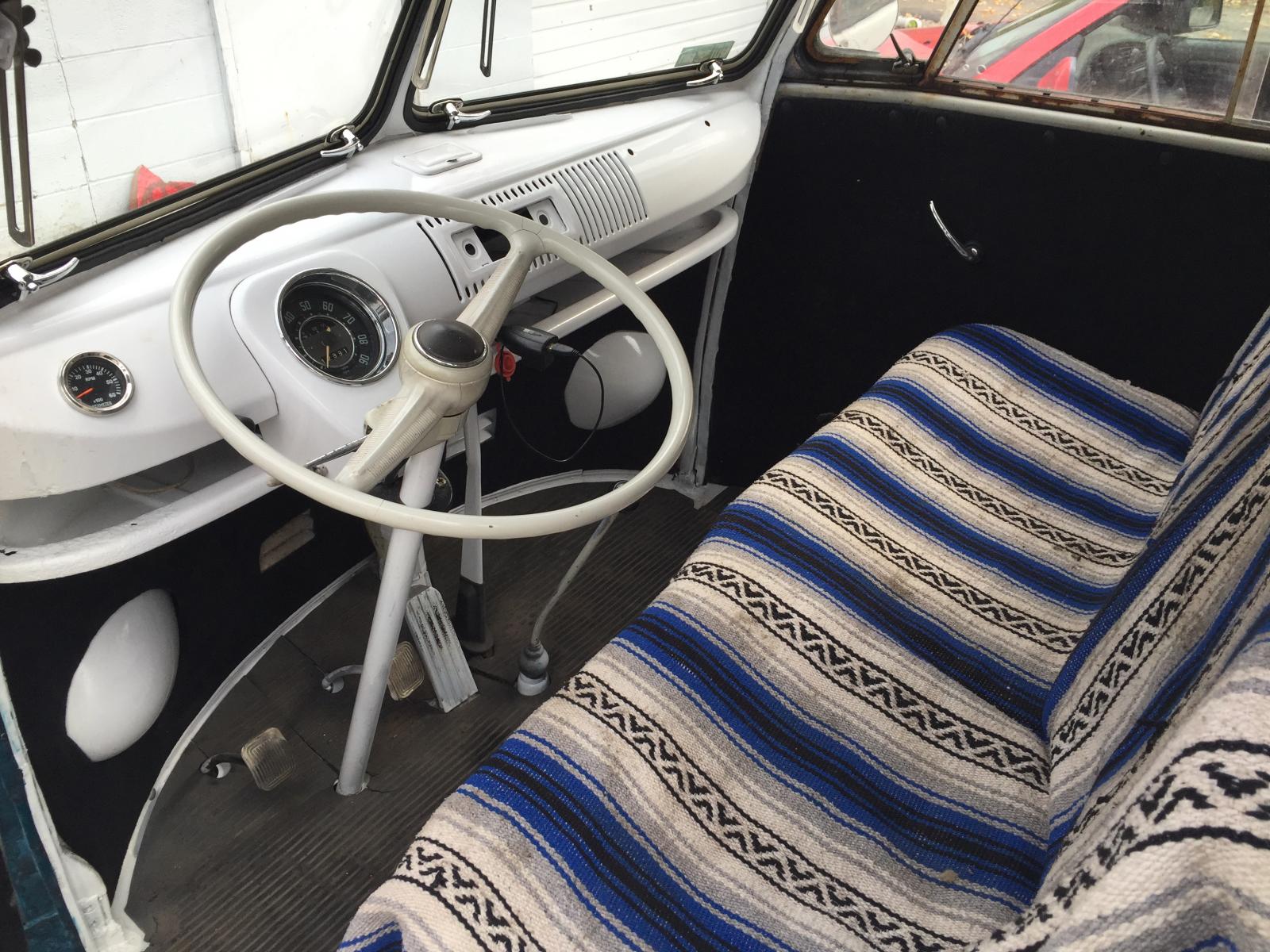

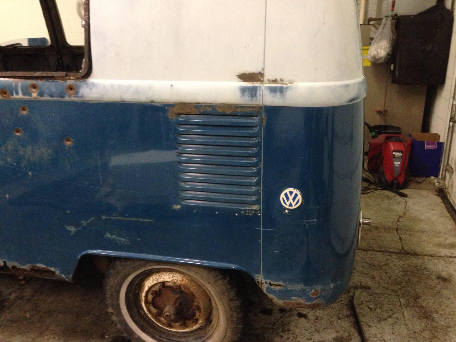

There was a big hole from where someone mounted a antenna on the bus at some point. So i used a VW belt buckle that i had and used it as a patch for the hole. It gives the bus some more character, goes nice with the bullet holes along the side too!
Then I slapped a couple stickers on the back as well.
After that i got all my electrical sorted out and ive been driving the bus around my shop parking lot. Its such a blast even in first gear putting around with no brakes lol.

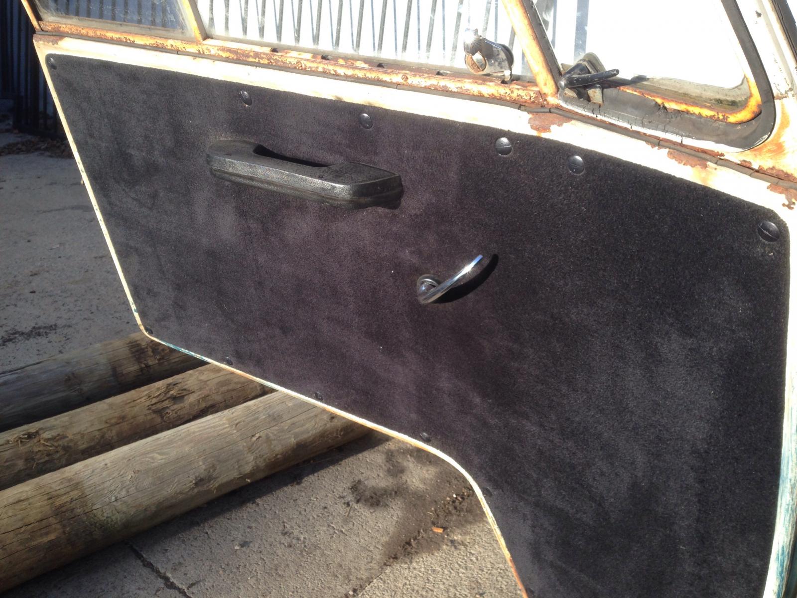

I still have alot of mine, but i was going to do new panels with black carpet. Early bay westy interior in the back. This bus was just alittle too rusty to give it the full on restore. I appriciate the offer tho. I have the chrome interior panel strips and headliner bows still. If your interested let me know.

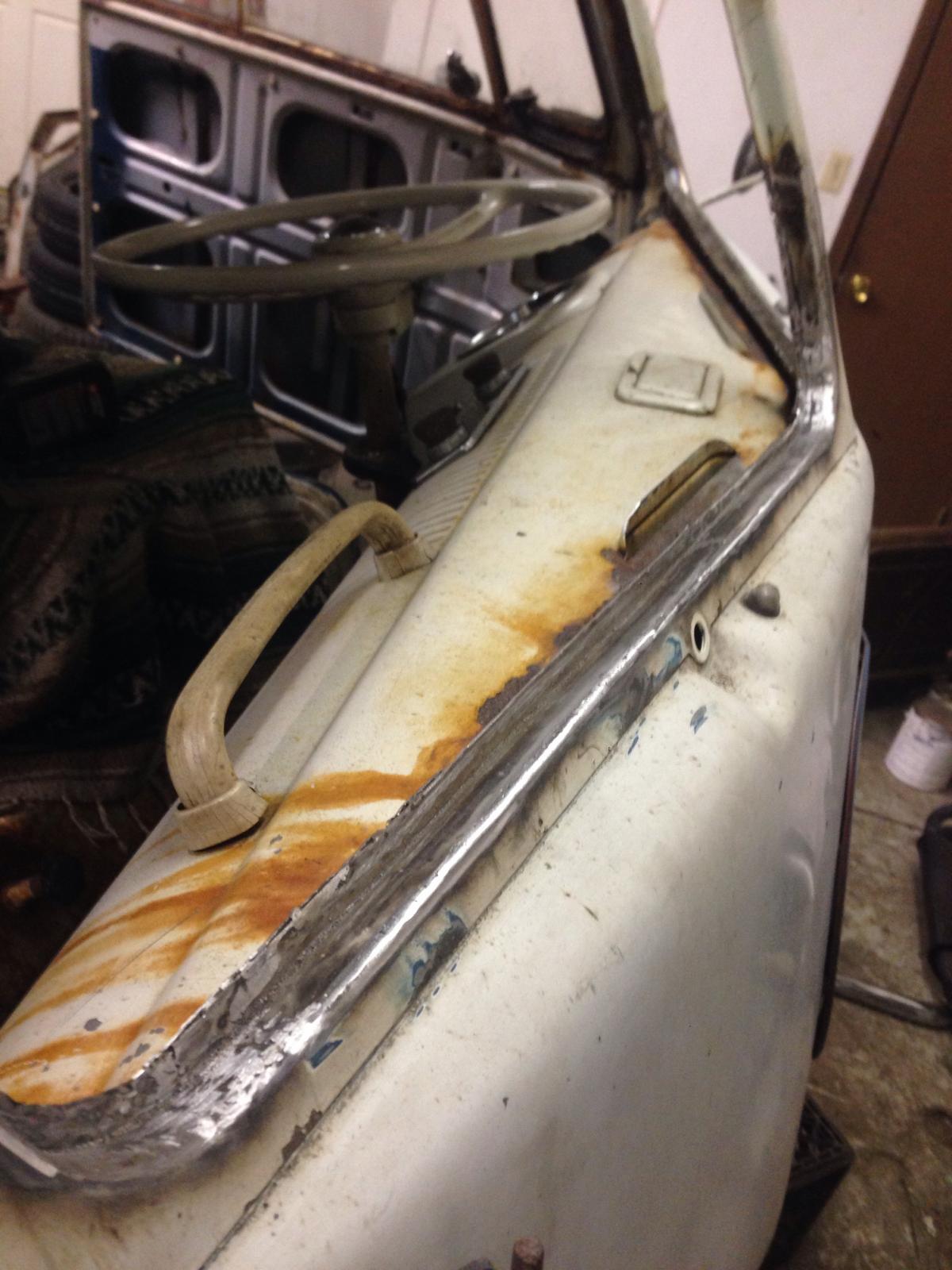

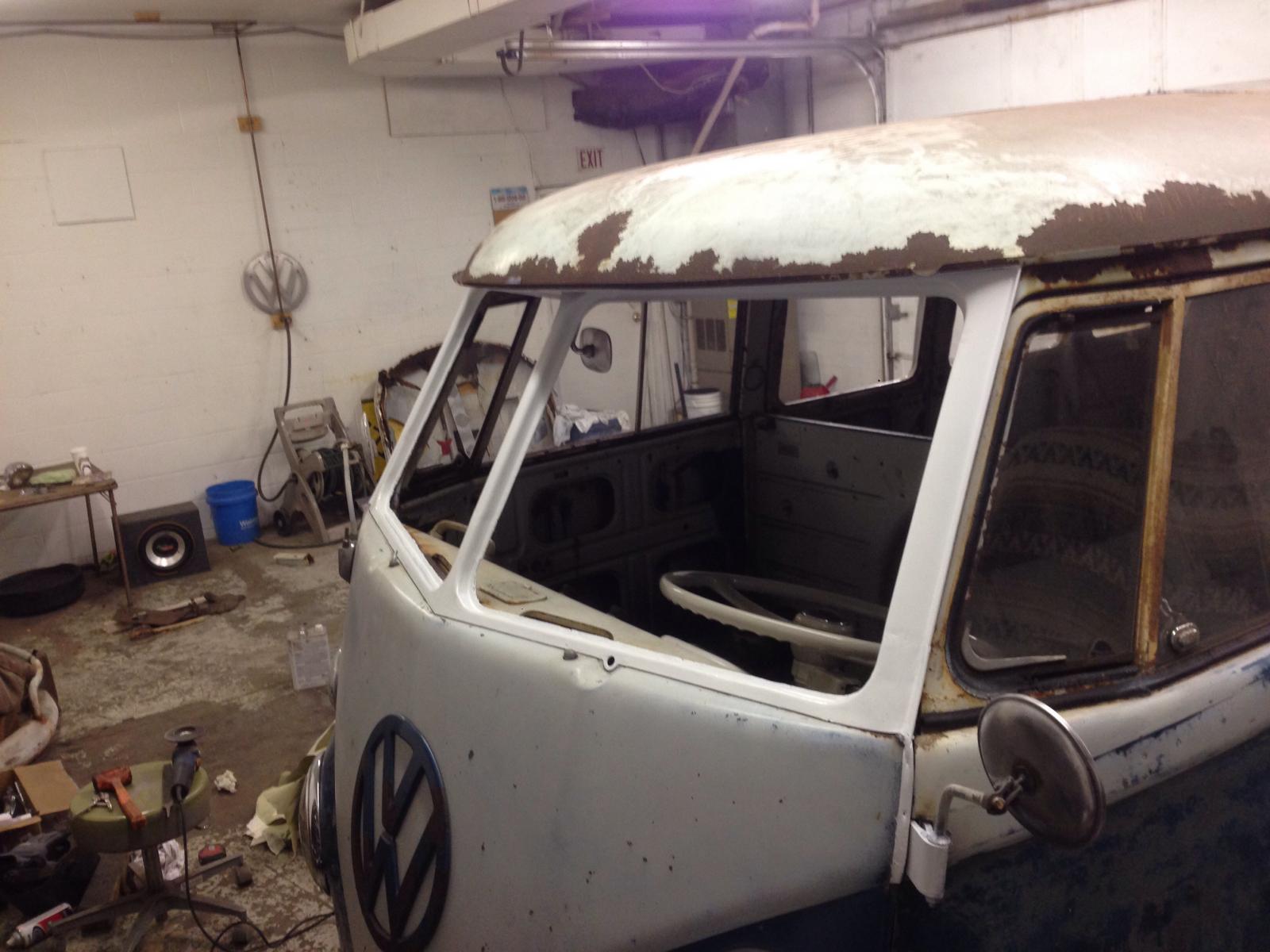

I rebuilt the A pillar by hand. Turned out pretty good. Trying to save as much of that og paint as i can.

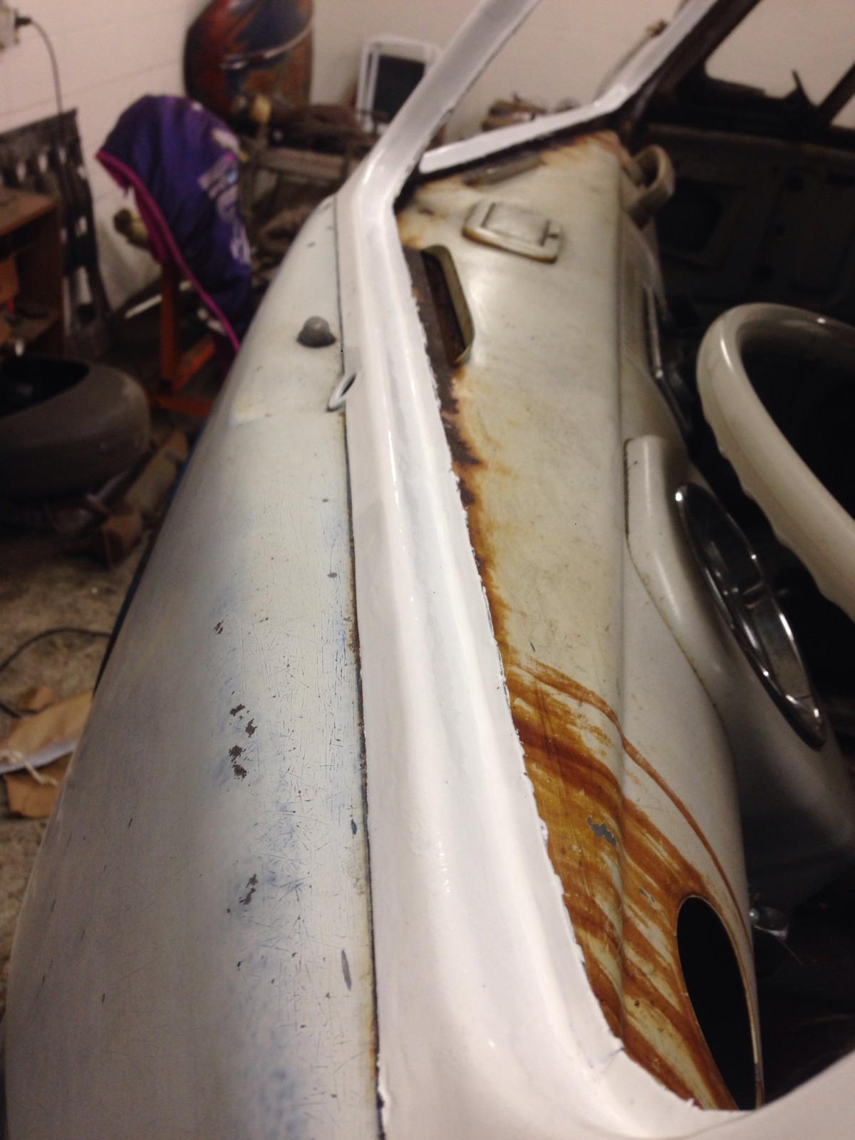

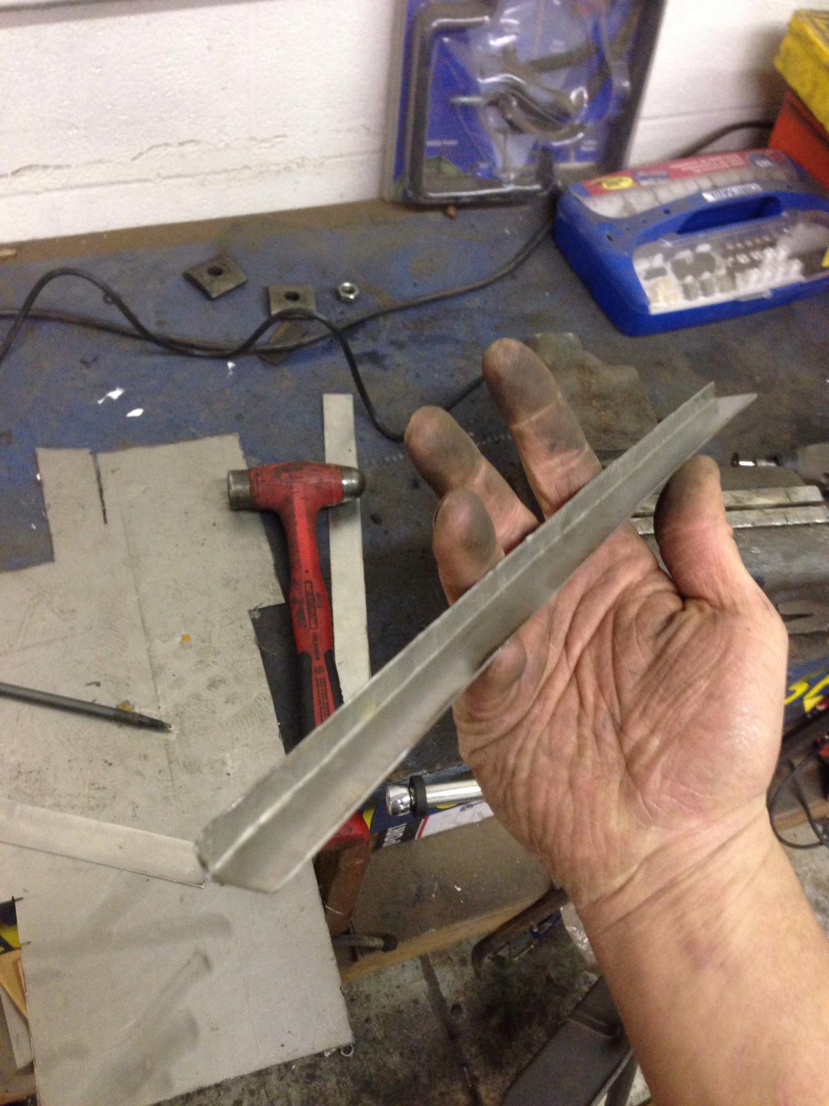

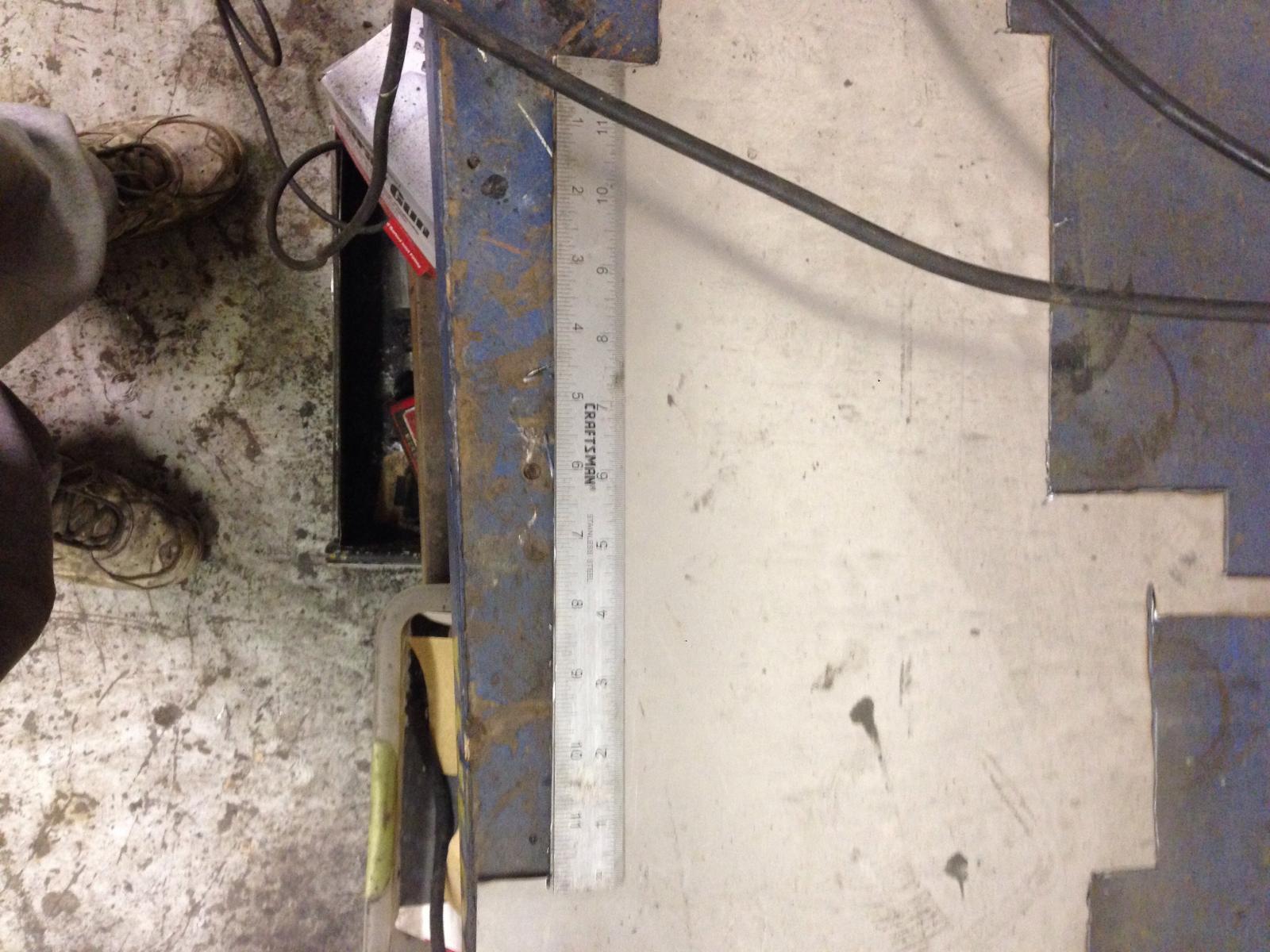

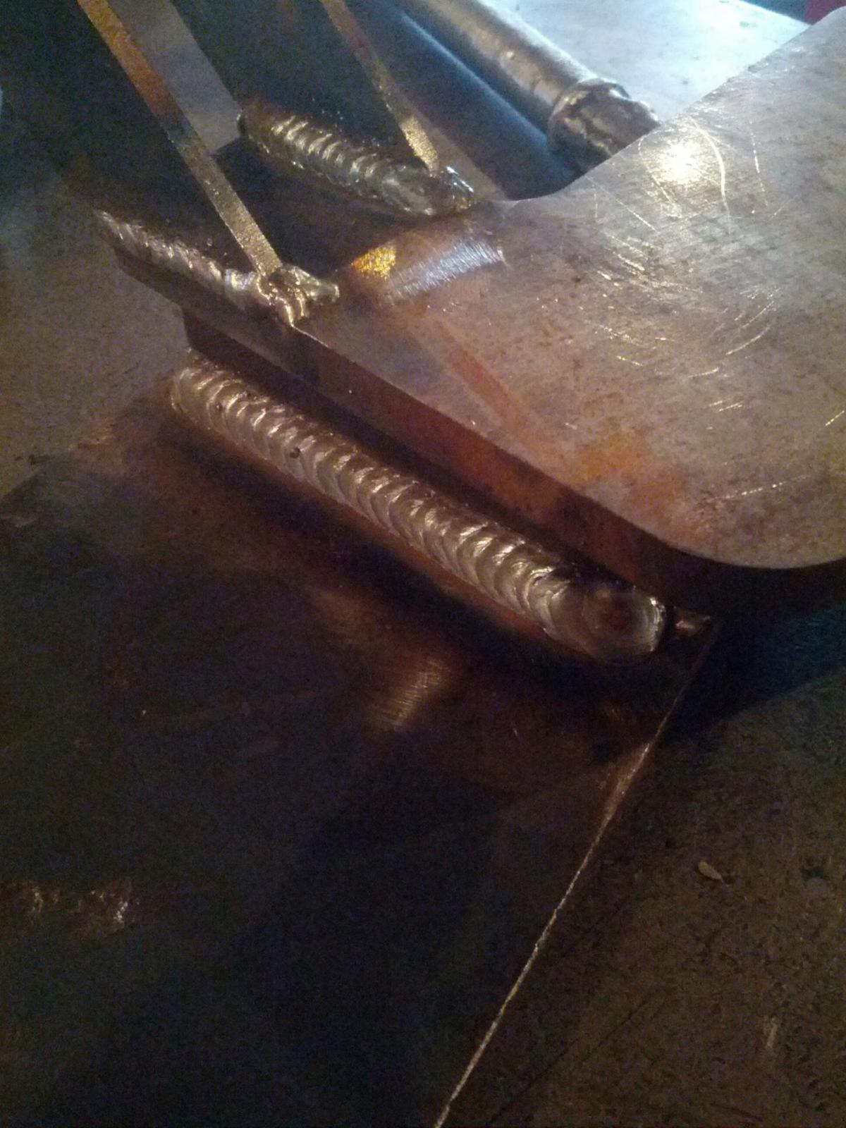

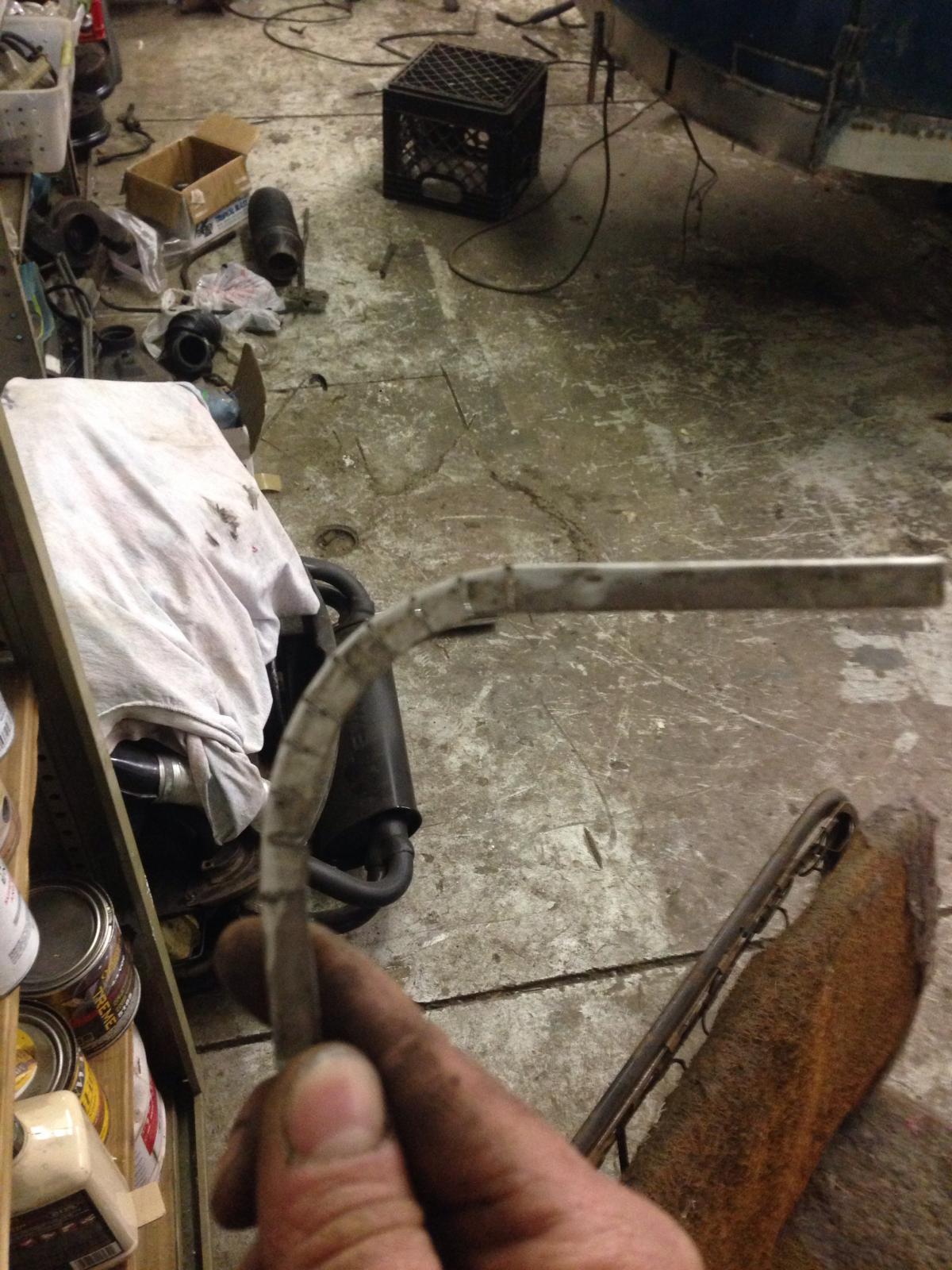

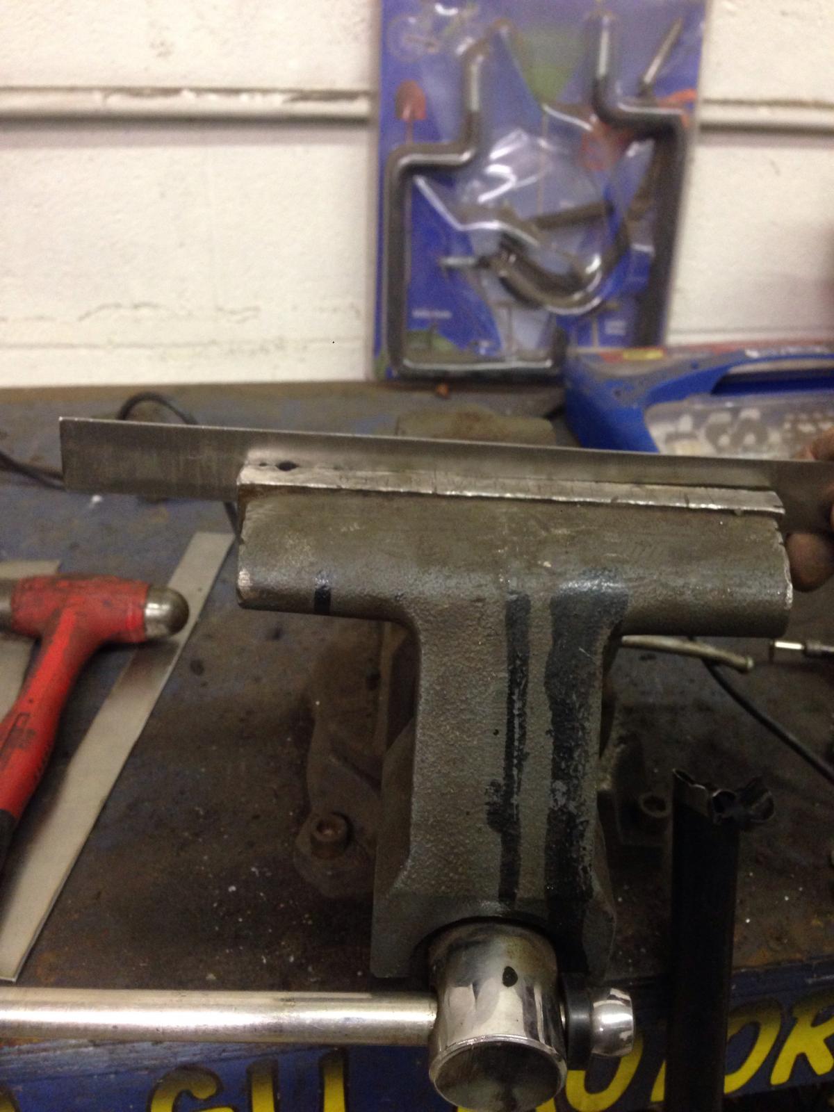

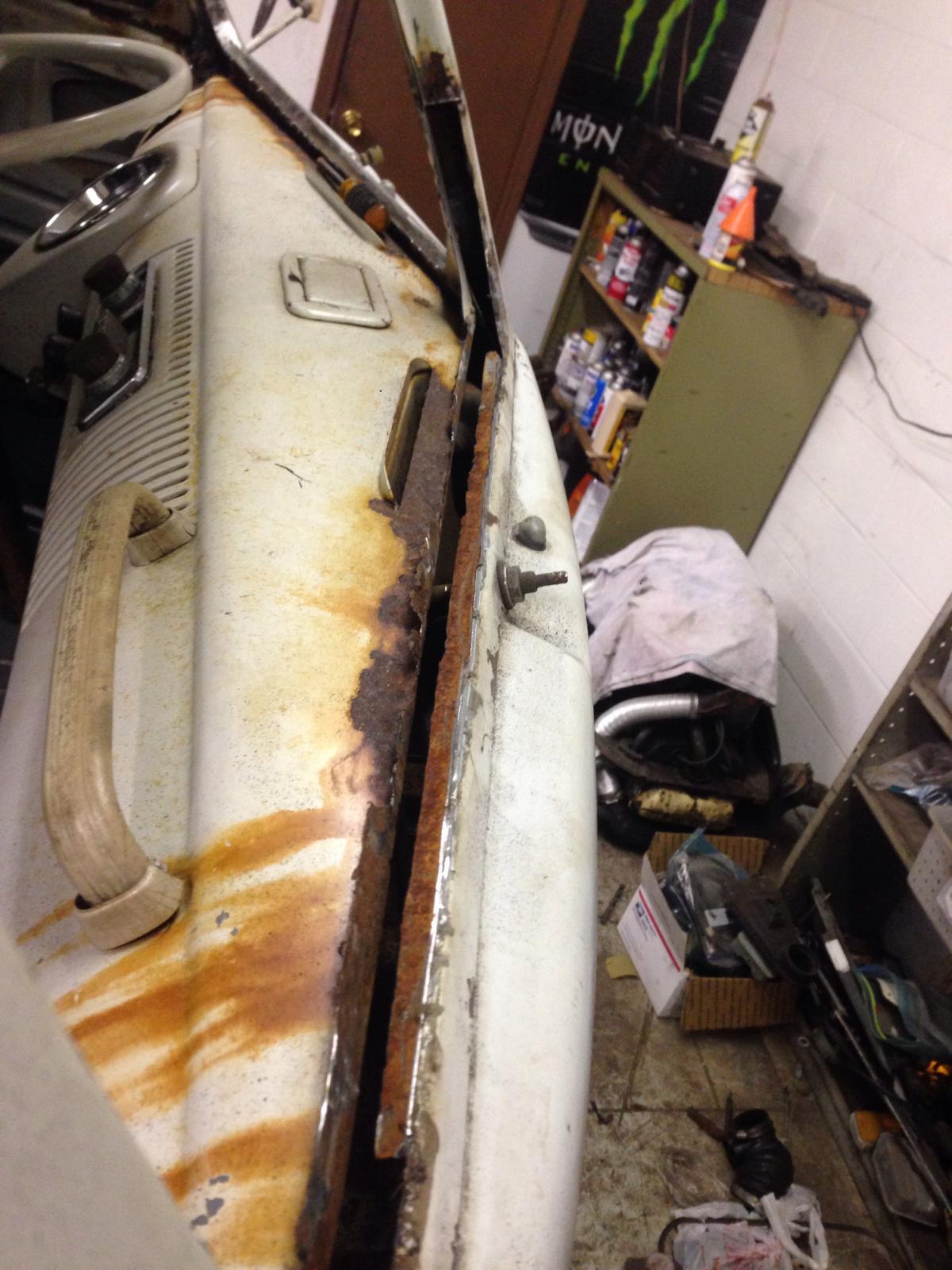

Then i started in on the lower dogleg. I had to cut off and replace the front half of my roof. I used what good steel was left to build it. Still german steel.. I started by making the outer part first.
Then i built the inner frame. Leaving enough material to tie it into the og dogleg.
Then i made the first little 1/4" step in part and the lower elbow. It would be really difficult to make the elbow and the top piece all in one part.
Then i made the top plate and tied it all in. Hand made dogleg in the raw.

It looks kinda crappy because i ran out of wire in the middle of the night and finished tacking it with flux core. Plus the paint. They'll look great when their all cleaned up. Thank you tho!
