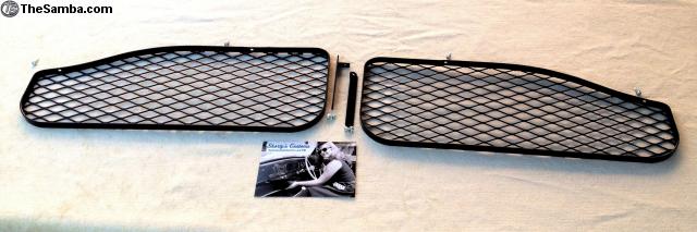

Bay Window bus parcel trays Price: 200.00
Bay Window Bus Parcel Trays. Fits any bus '68 to '79, deluxe or standard. Custom hand made here in the USA. Original look and sturdy for real world use. Powder coated heavy duty steel construction. Available in black. Comes with mounting brackets and hardware. Shipping is $25 in the continental US.
http://www.thesamba.com/vw/classifieds/detail.php?id=1698238
When I see parts like the one’s above for sale, I wonder if the seller has any clue they’re putting T2 Drivers in needles danger, in the event of a serious front end collision?
The OEM VW T2 parcel trays had a foam/plastic coated frame with an easily collapsible fine mesh bottom that in an accident would likely not shred the occupants legs like the ones for sale above…
I sort of feel that I should e-mail the seller and let them know about the problem with their product, but then sometimes think, I am overly concerned about safety? I see people replacing there door and kick panels with wood and think to myself in an accident how the wooden panels could easily turn into jagged edged surfaces resembling a bunch of wooden spears that can skewer the occupants…
In addition, it seems odd that apart from upgraded self-tensioning seats belts that are available for sale for T2’s Bays without them there are few other available safety items offered for our T2 Buses…
From looking at front end accidents of pre 73 Bays; to me it would seem that adding something similar to a Roo Bar may help prevent the front end sheet metal from caving in as far as I have seen, due to the spot welds shearing off at the bottom due to impact… I understand that in an impact that sever there probably would be serious injuries, however the extra protection may reduce the total trauma especially to the legs?
Anybody have a four-point harness seat belt in their T2 and had a accident in one while wearing it? Any thought on if that would be a Beneficial upgrade Think

I see how those can be dangerous. I have seen trays made out of what looks to be ABS plastic which would be safer. There was a vendor here a while back that made those trays out of copper pipe and license plates. I was in a bad front end wreck where my knees made serious contact with the dash. No broken bones, but it was difficult to walk for more than a week. 25 years later I'm having knee and hip problems, though I am not sure if from the accident or my line of work. As far as a four point harness, where would you mount the inner points without a roll bar?

There are several concerns regarding safety, I hadn't thought about the parcel trays. Good point!
One of the key things I like about my 1973 bus is the added safety features, but it still has enough early bay features to keep me happy.

I messaged him the dangers on this part. Too risky to put in any bus, but if somebody was crazy enough, I had told him to put a disclaimer stating that this is a potentially dangerous part in the bus.
I also let him know some websites sell reproduction OEM pieces for $80, and they are safer Laughing

Lionhart94010 wrote:
I will be interested in his response…
RE:
do you have a link?
http://www.eisparts.com/ZVW-21411.html?gclid=CPK6gbDKk8ECFRJk7AodBBsApA
May not be pretty, but I can tell it does not work on deluxes (without modification to the tray).

I too “agree with Ray in making sure you bus or bug is in top condition. Drive VERY defensively like your riding a motorcycle and smile and enjoy your VW and life.”
However making them even less safe with dangerous add–on’s for sale to uninformed samba members on Thesamba is my main concern, adding beneficial upgrades is just a subtopic ;0)
ChrisFred, RE:
It was only after buying a similar plastic tray as the one above that I realized even the plastic one could cause unnecessary harm in an accident over the stock ones, IMO I have worthless tray that I can’t in good conscious resell :0(
Another less than safe parcel tray for sale on Thesamba
http://www.thesamba.com/vw/classifieds/detail.php?id=1603818
Hand crafted trays. Their great as,a foot res and to place your,food on. You can also fit a small pet on them and it has cup holders. they are steel constructed and hand welded. Feel free to texft me if interested 6263105136 local pick up only
