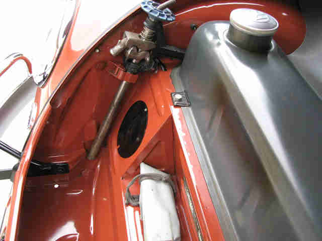

Black on a 1958. This pic is an original 1960 and they were still using black.[img]
[/img]
The ad is for a 1961 bug and shows the silver brackets.

61 and up the brackets were silver. 60 and down they are black, just like what's pictured above.

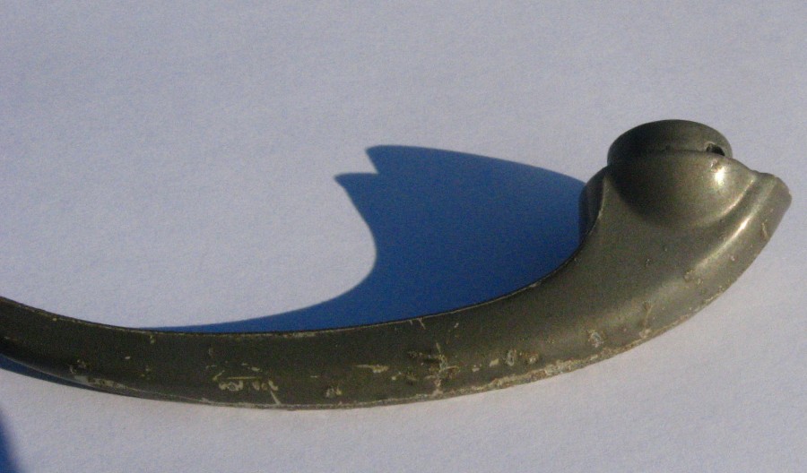

No, I'm in central Ca. near the coast. I do have a 65 111 that was built almost like a Canadian standard (called a 1200 Custom) sans a few different items. L-328 looks like this;
https://www.thesamba.com/vw/gallery/pix/519384.jpg
