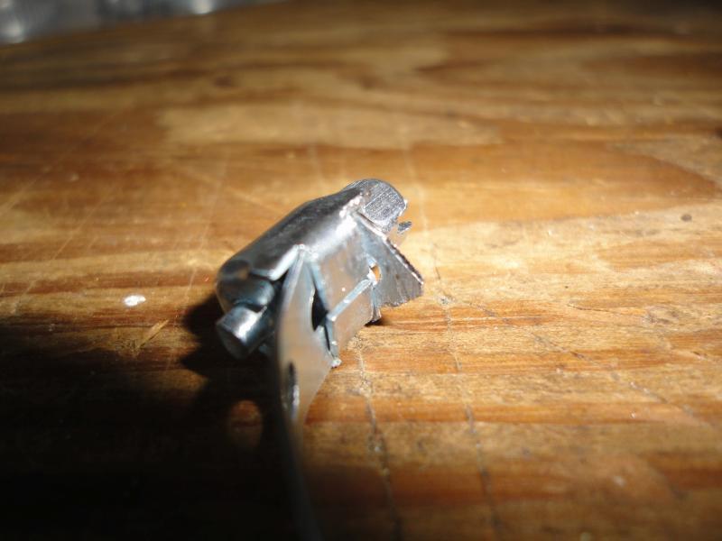

One of the things I had to fix on the (new to us) Westy yesterday was the intermittent speedo. Yes, the clip had broken off at the speedo end, and it was weakly tied on with ancient electrical tape. So I tweaked a cheapo hose clamp to hold it on securely.
Start with a standard 3/4" hose clamp, open it up, bend the inside end by 90°, cut that end to a point, re-assemble around the end of the speedo cable so that the pointed bit is held in the groove that the broken plastic clip should have been in.
