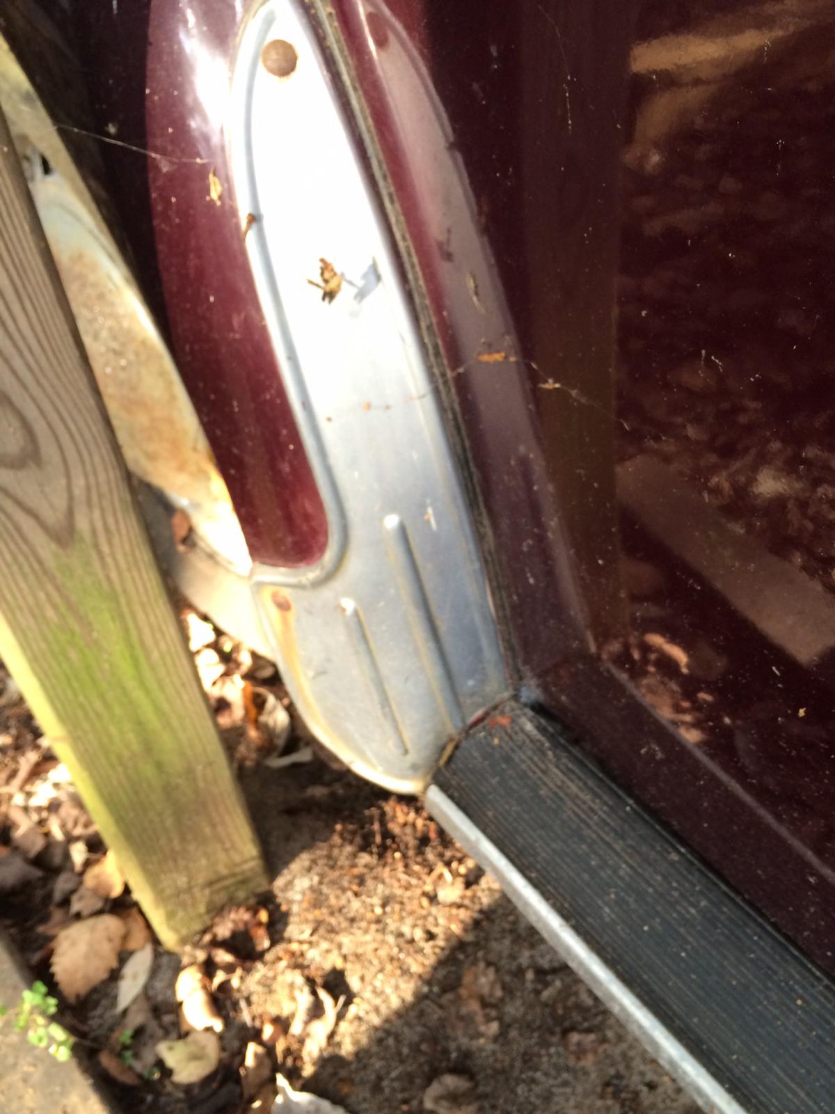

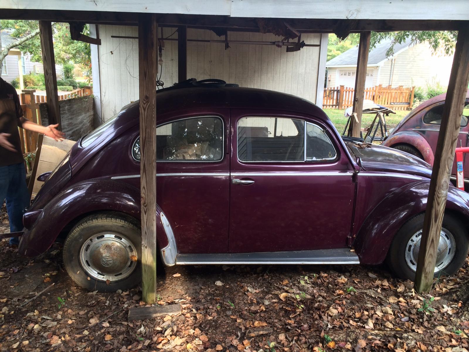

First look: The pictures the owner posted were good. But I wanted a closer look.

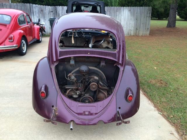

A second look soon followed. I also took down all the numbers; They all match.

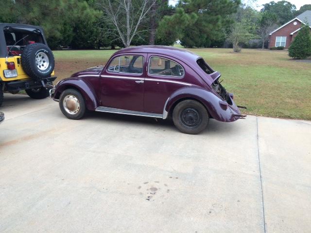

I have determined, this is the original color: Capri
this is based on the inside of the dash

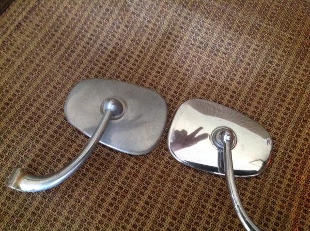

Working 12 hour shifts right now, so I didn't have a lot of time today but...
I broke out the Blue Max polish and Nev-R-Dull.
German chrome is the best! Not bad for 56 year old chrome!

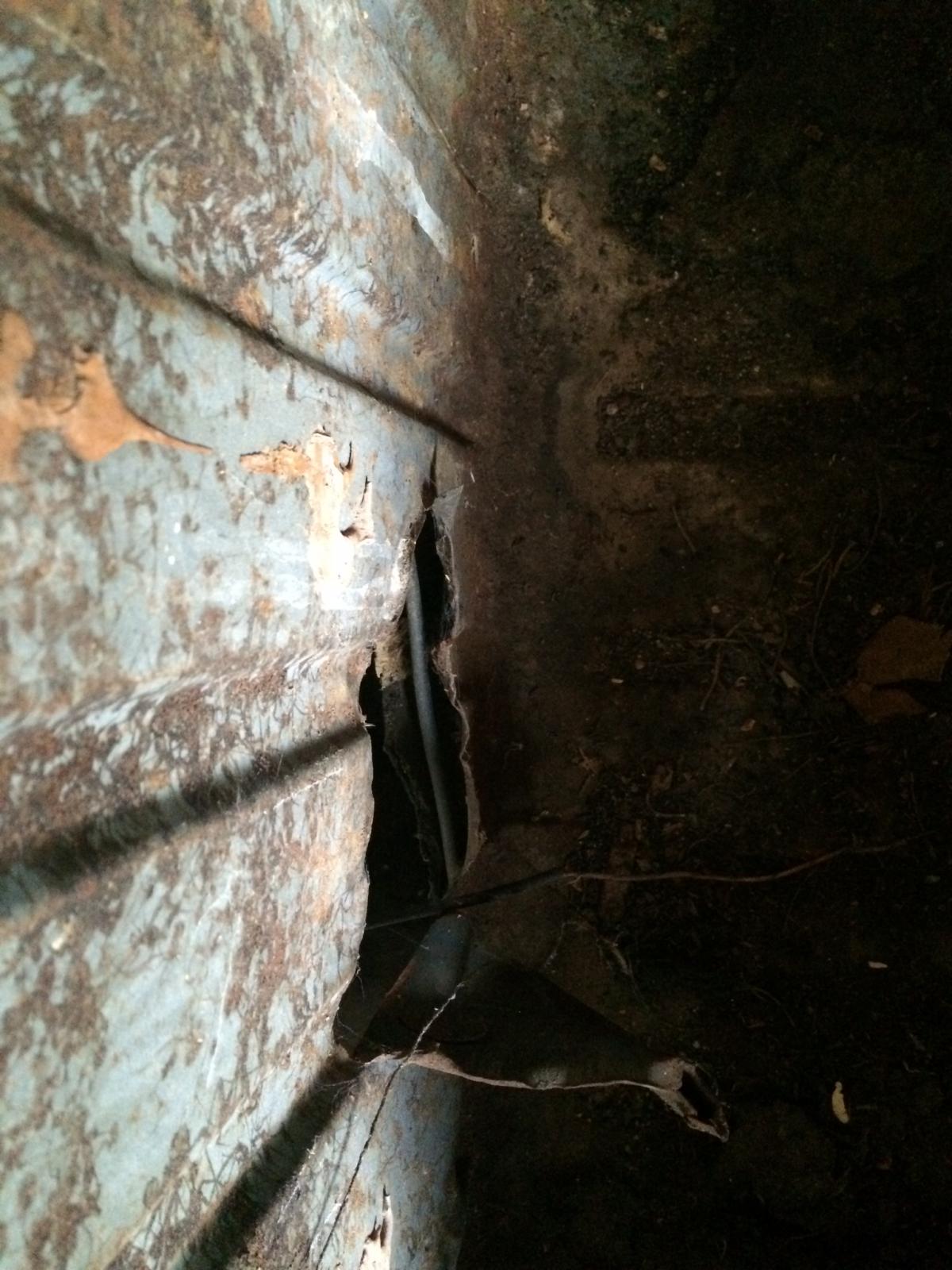

A little cleaning today, and what a load of crap I pulled out! But now it's time to get ready for another 12 hour bender!

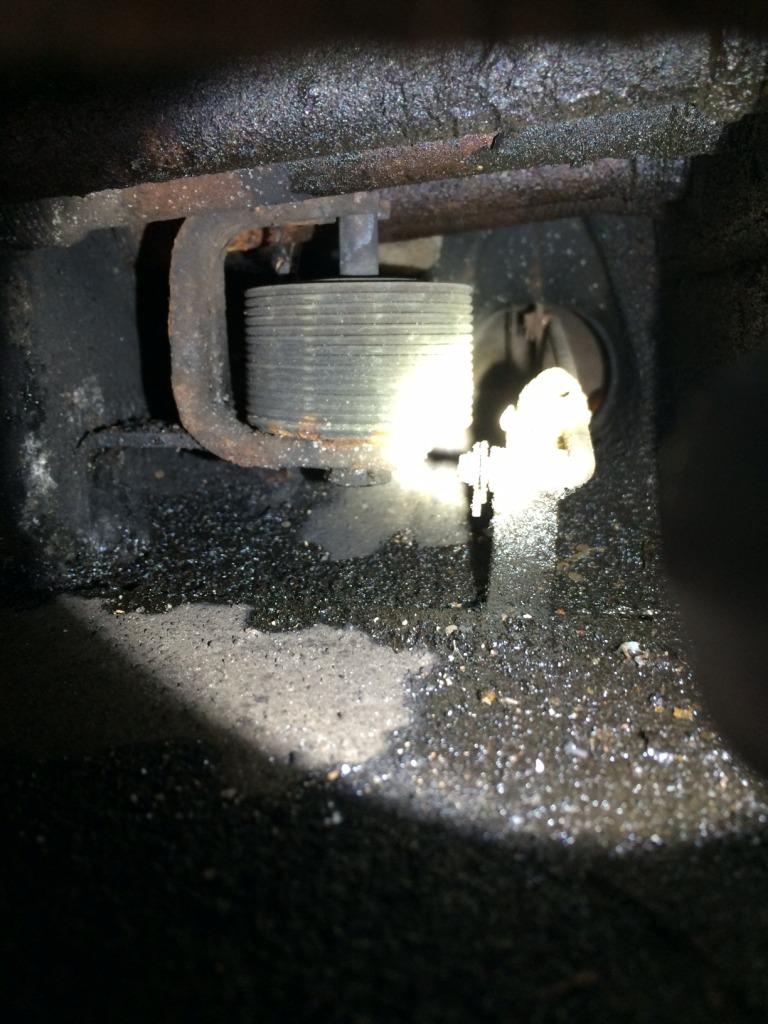

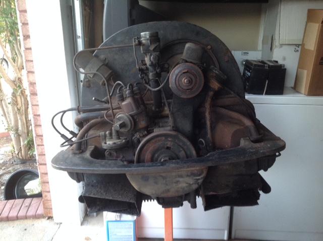

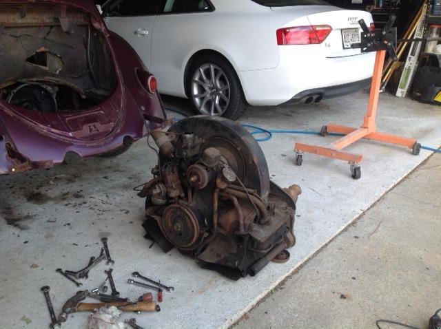

Well, here's what I'm looking at so far.
Everything is there, including the conduit for the spark plug wires.
I have the rear breastplate removed and it has the wrong muffler on it.
28 PCI carburetor
Belts loose, but wiring looks okay. Vacuum line is connected
One lightly used original distributor
And the heater boxes look great!

Saturday- November 18th:
Got off of work and decided to do a compression test before the motor comes out tomorrow. The results are as follows-
Compression test-
1. 105 psi
2. 105 psi
3. 0 psi. Exhaust valve stuck open. Will move but doesn't close
4. 115 psi
BLAST! I can see the exhaust valve sitting about 3/16" lower than the other three valves on that cylinder head. It is most definetely stuck open. The other three cylinders have pretty decent compression. But that's why we call this Mission Impossible and not Mission Difficult.
So, the motor will come out tomorrow. Check end play, disassemble to the heads and see if I can't figure this out.
Stay tuned-

PostPosted: Sun Nov 09, 2014 3:33 pm    Post subject: Reply with quote
Engine is out. Good Lord, what a chore when alone.
Here you can see the jagged hole in the rear firewall I'll be fixing. Previous owner (not the guy I bought it from) tried to remove the fan nut...the fan nut!
Now it's tucked away on the stand. That too was a chore, but I elisted the help of my daughter to lift the motor and my wife to steady the stand.

PostPosted: Sun Nov 09, 2014 3:38 pm    Post subject: Reply with quote
End play checked out at .005". That'll work! The case does not need to be split!
The pressure plate is toast. They needed a new disc about 10,000 miles ago. The rivets in the disc have cut a groove in the pressure plate. Flywheel looks okay though

PostPosted: Mon Nov 10, 2014 8:12 am    Post subject: Reply with quote
Here are some teaser pics though:
This motor appears to be unmolested

PostPosted: Mon Nov 10, 2014 9:01 am    Post subject: Reply with quote
Looks like a nice start for a project car! I would strip that engine down and clean it up, will help you locate any oil leaks down the road. Might want to go ahead and change out all the gaskets for pushrod tubes and oil cooler while you have it down that far.
The wiring works harness we used on my Dads was nice, didn't have any trouble at all hooking it up. If you look at our build we also wired it to flash along with tail lights flashing as well. It has helped out with driving around, most people have no idea what the thing sticking out the side means. When it flashes on the other hand they seem to understand lol.
