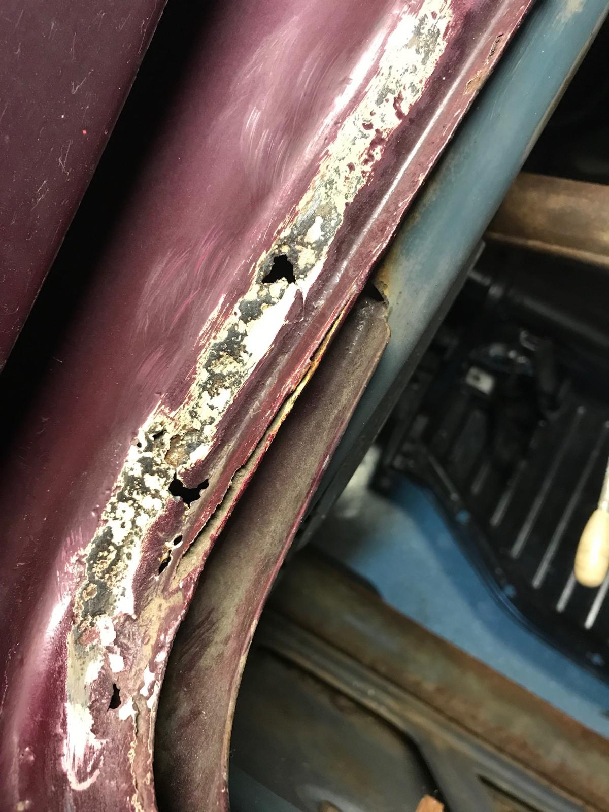

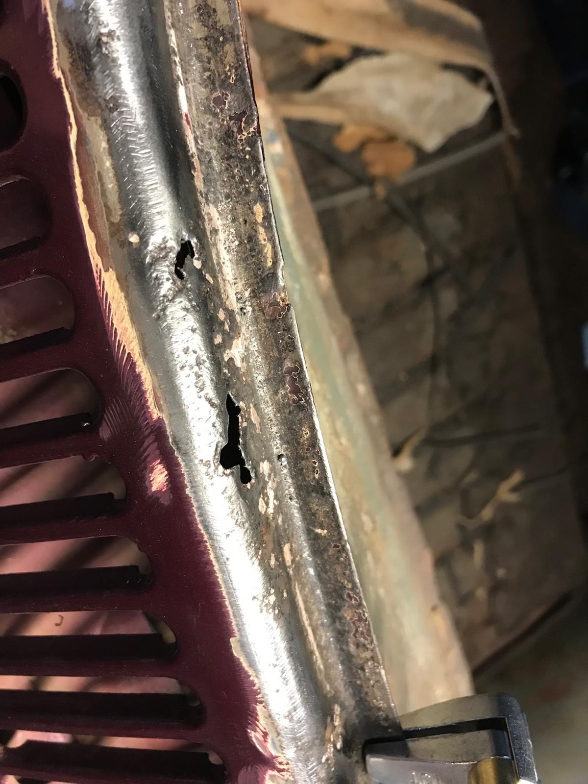

I did a little digging around the windshield though
You might remember this from a couple of weeks ago
Ugh! I hate rust

Broke out the Dotco today and went to work stripping the paint and bondo off the windshield channel
Drivers side. Thought I’d hit the passenger side while I was here
Oh yeah. This is gonna be fun. Did I mention I hate Bondo too?

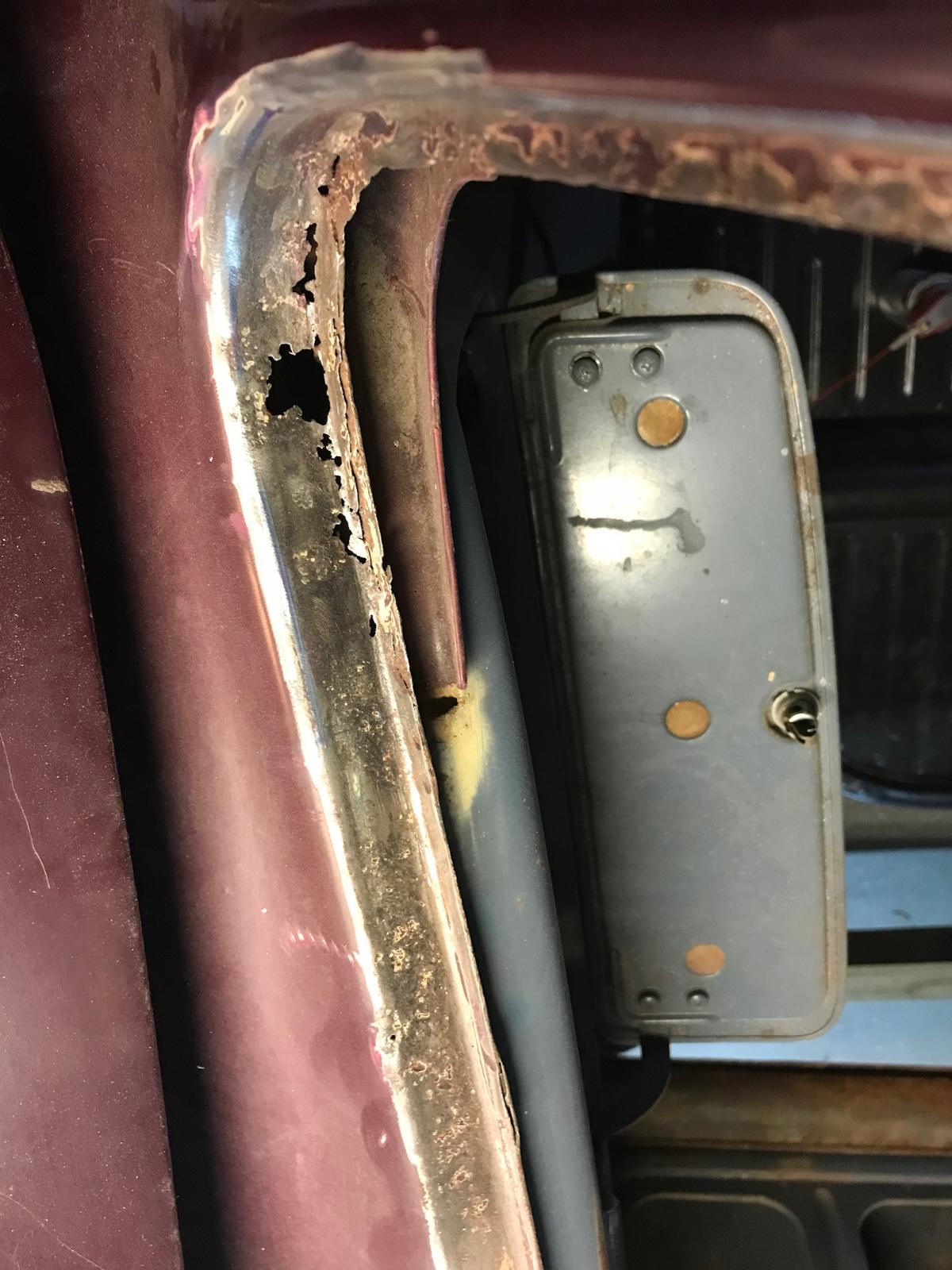

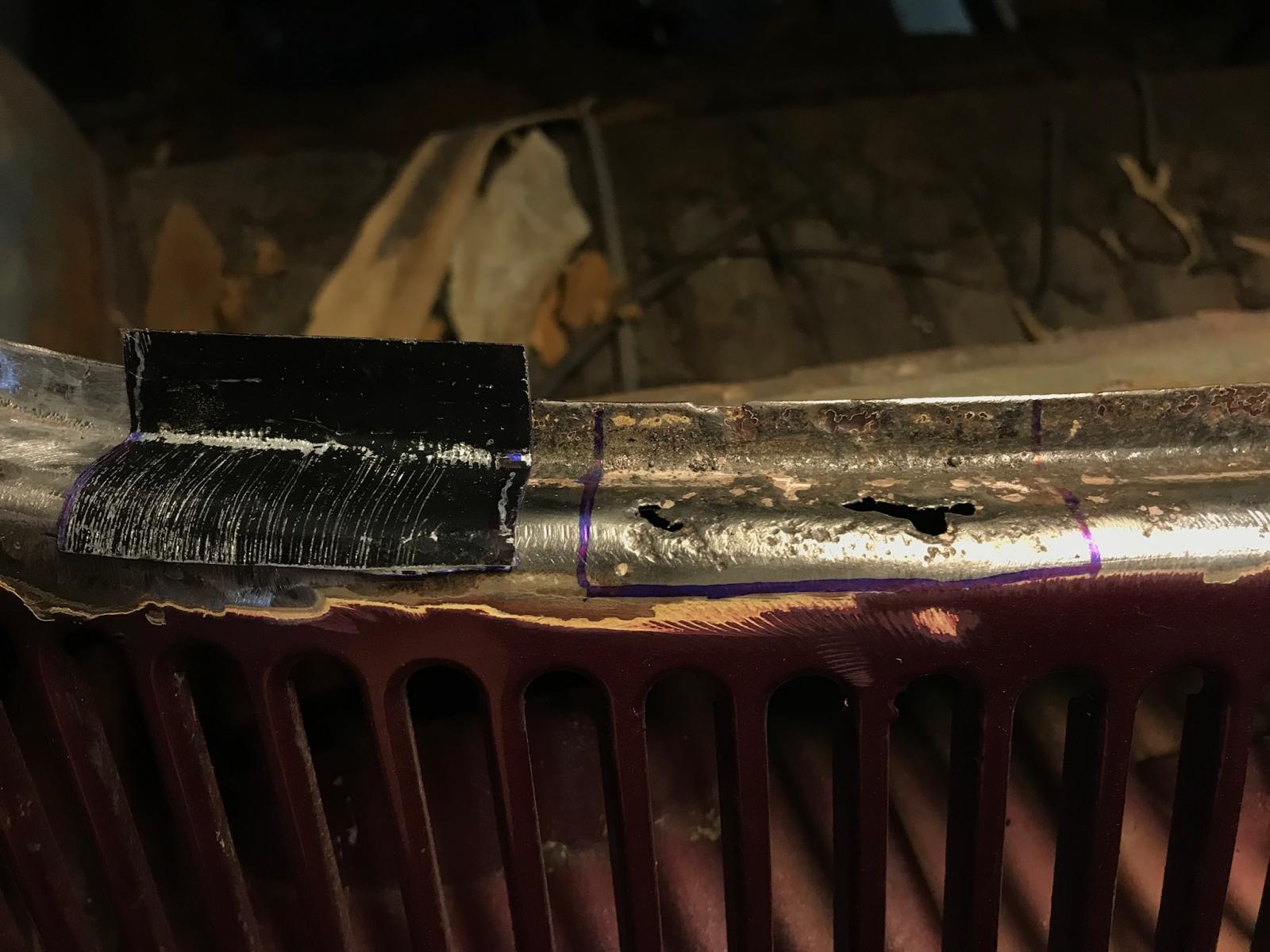

Still removing Bondo from the windshield area
Driver's side looks ugly but it's contained
Passenger side actually turned out to be worse but it's contained as well
This is the center section. Some pitting rust filled in with Bondo, but doesn't appear to go through...we'll see

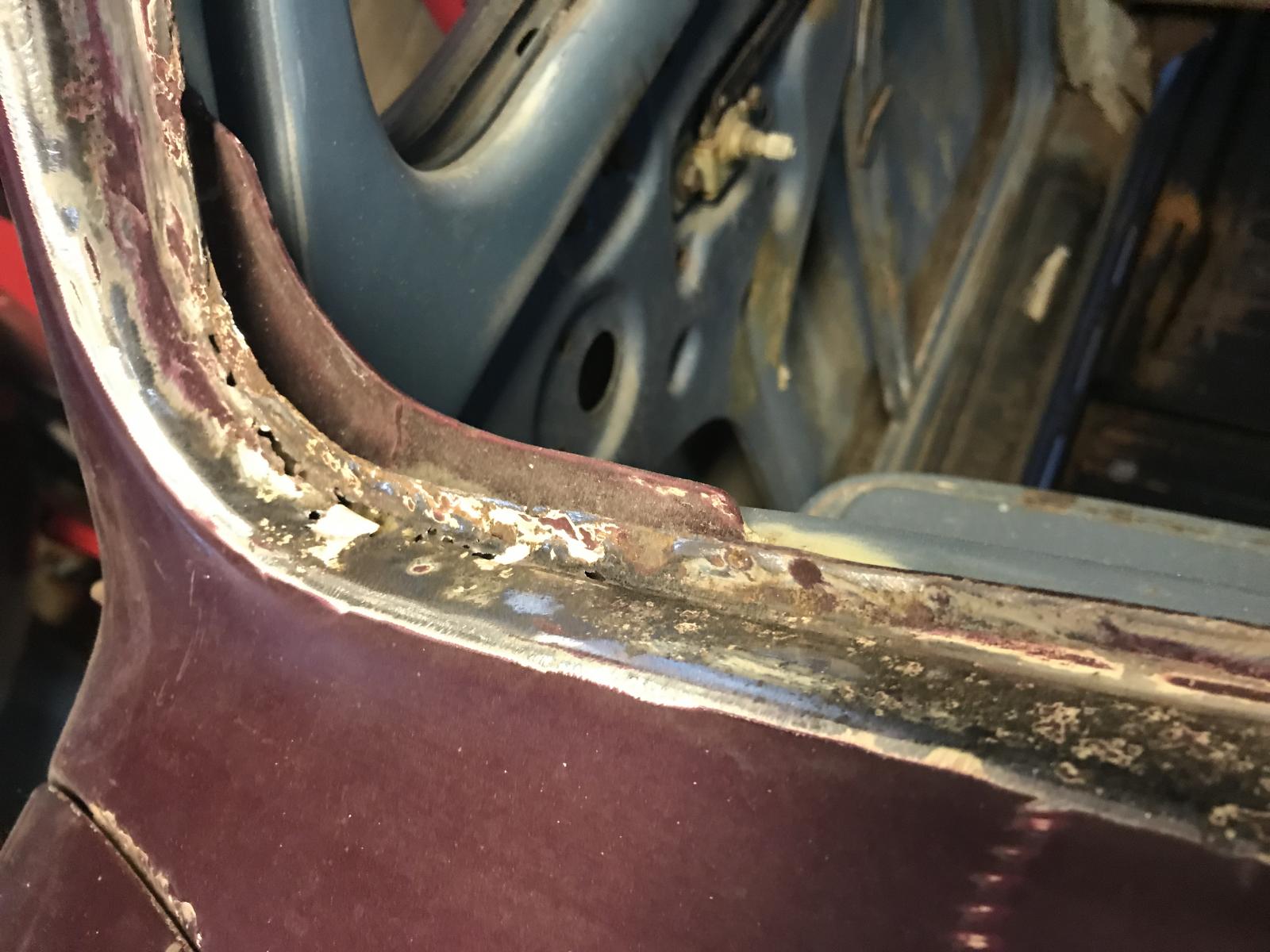

Well, I decided to take a look at the back window frame and....
It’s pretty ugly too

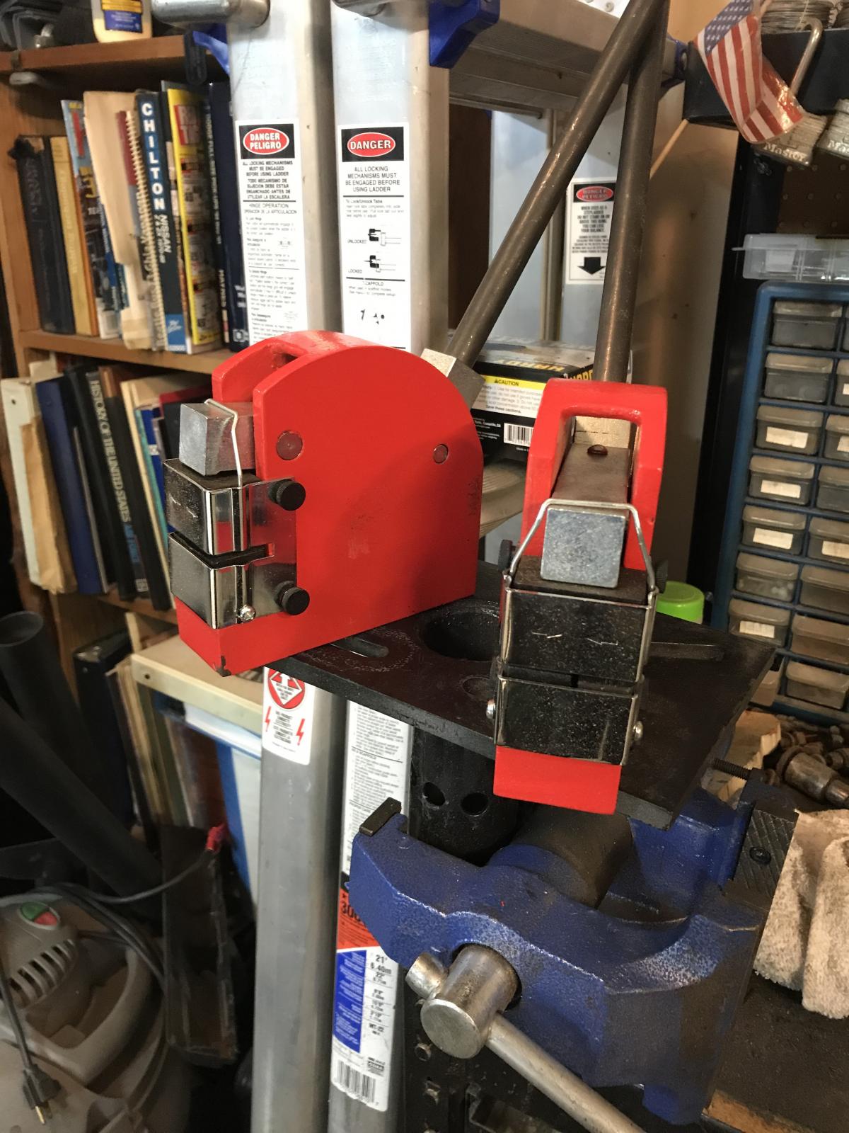

New toys arrived! Got a metal stretcher/shrinker set and some clamp clecos. This morning I got out in the garage and played around with a piece of scrap metal.
This is just an experimental patch, just to get a feel for fabricating a curved piece.
Super easy! Took about an hour to make this one. I won’t install this one, it’s too narrow and I need to get better at cutting. But I am pleased with the simplicity of the shrinker/stretcher.
Now to acquire some 20 gauge metal, practice my butt welding, and start making some patches

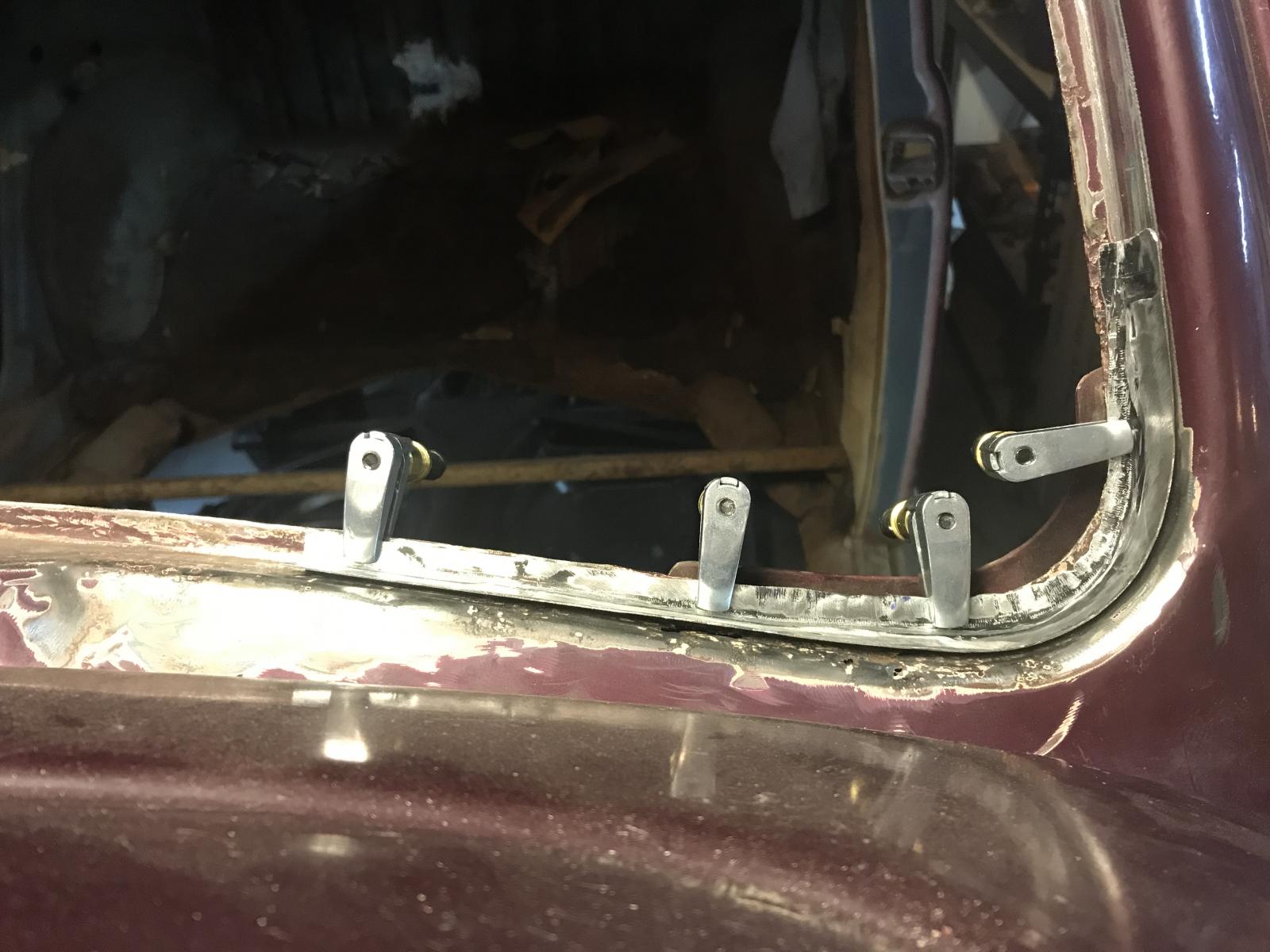

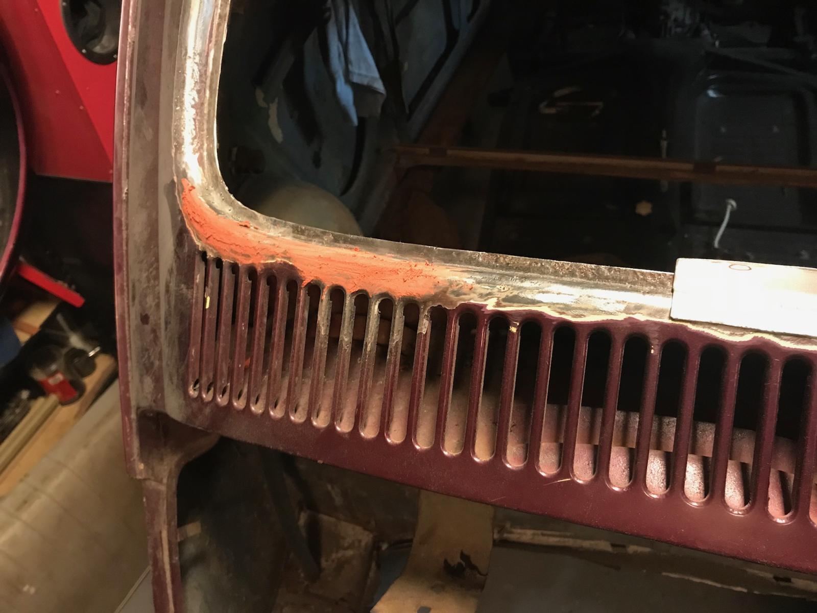

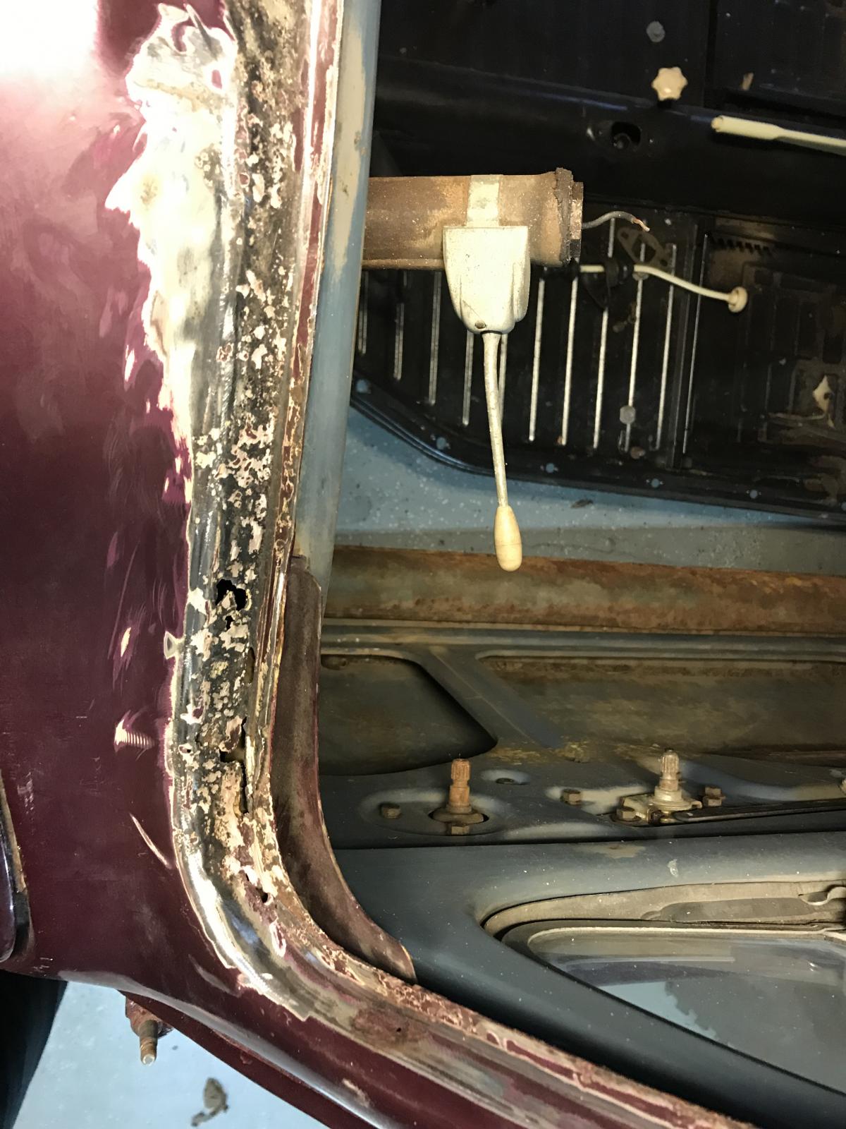

Today I thought I’d tackle the back window as it seems the hardest to do. There are about 8 holes across the bottom of the window frame. I did one One this afternoon.
I started by bending a patch. Then carefully cut out an area slightly smaller than the patch
Then using clecos I trimmed the checked the patch fit. I started by using a dotco to get it close and ended by hand filing the patch until everything matched perfectly.
Then the welding began.
A lot of grinding
And it’s done.

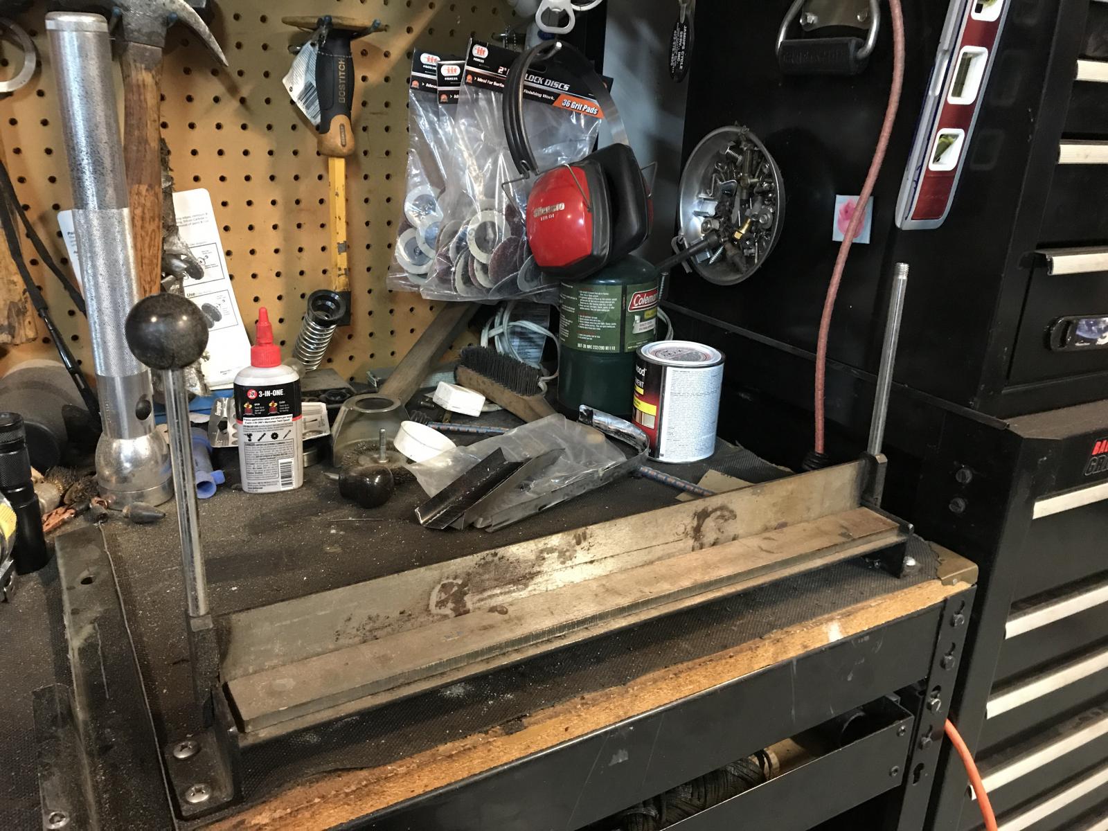

Metal shrinker/stretcher Don...
Bought off Amazon
And an 18” sheet metal brake
Available at your finer Harbor Freight Stores

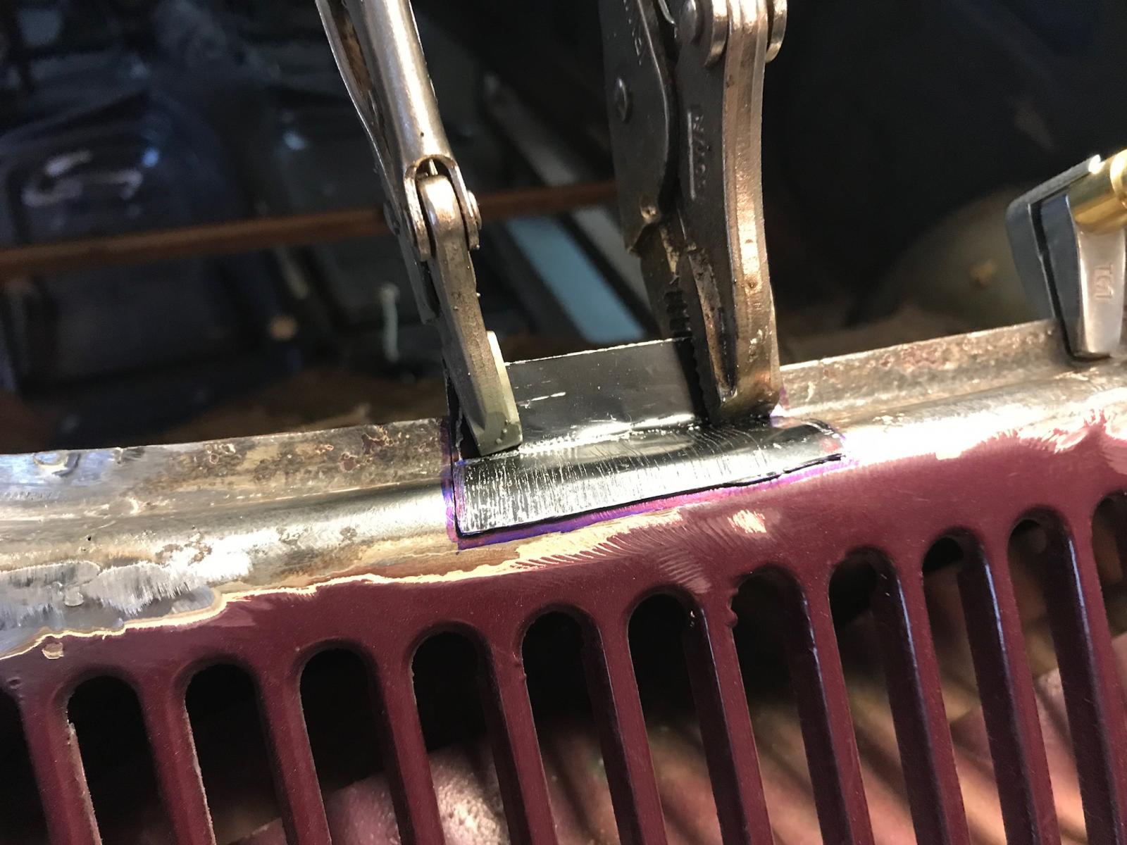

Here's a step by step of the patch fabrication
Today we'll be fabricating a patch for this area
First I cut a rough piece out of the front clip I bought a couple of weeks ago. This is from the gas tank struts. It's already been through the stretcher to get the radius of the back window. Clamped in place with vice grips I'll lightly hammer the shape to match the curve downward on the body.
Here it is.
I removed it and cut it to size. It is now clecoed in place to check fit.
It required a little more hammer to lay like it should.
After hammering I drew an outline of the piece.
And voilà. It is ready to be cleaned up. This was all done prior to cutting the body. I'm using the body as a dolly in essence. Tomorrow I'll clean up the piece to remove the paint and straighten the edges smooth. Then I'll mark the body and cut out the bad metal slightly smaller than the patch.

PostPosted: Tue Jan 16, 2018 3:24 pm    Post subject: Re: 1958 De Luxe Beetle from Morocco Reply with quote
Glad to help. Once I cut out the pinch seam part of the old metal, the new piece should fit perfectly.

PostPosted: Sat Jan 20, 2018 9:12 pm    Post subject: Re: 1958 De Luxe Beetle from Morocco Reply with quote
While waiting to see if I'm going to be furloughed, I figured I'll keep my hands busy to take my mind off of it all.
Three holes fixed. Now there is glazing putty on it setting up.
Next hole is surrounded by some deep pits, so I'll be cutting out more than I really wanted to
Patch is fabricated
