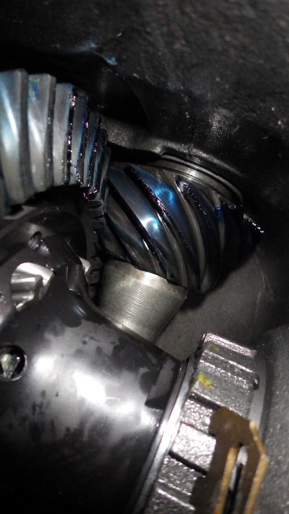

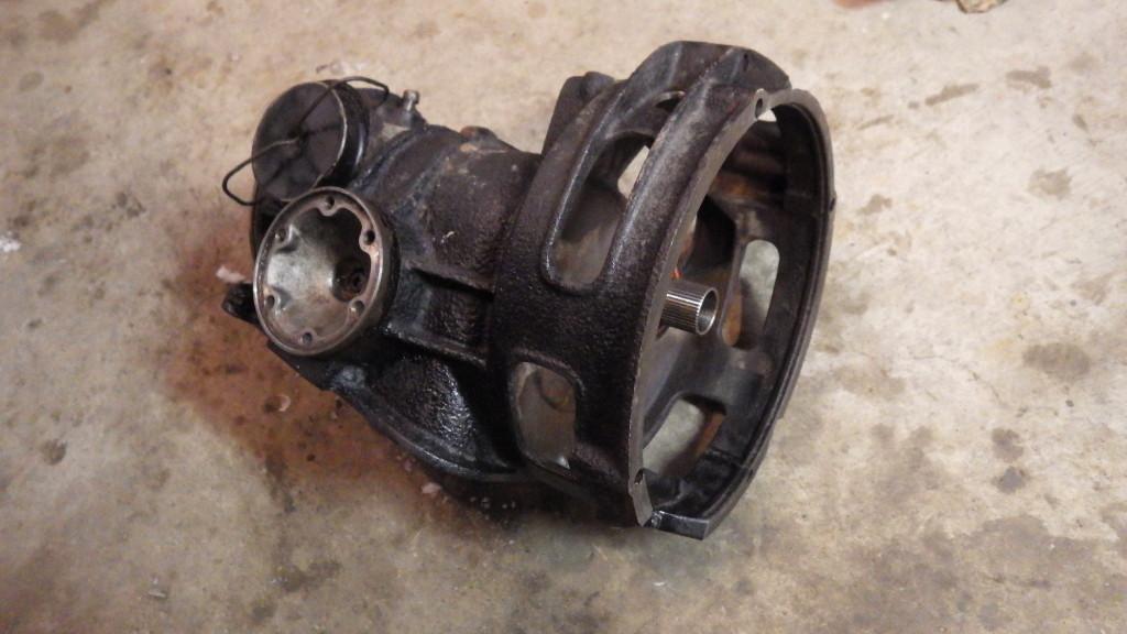

PostPosted: Wed Jan 07, 2015 9:20 pm    Post subject: Reply with quote
After reading the Bentley and realizing that a transmission shop would be the best route to go, and then getting a reasonable guesstimate from a local shop I took the tranny out, separated the final drive from the gear box and dropped it off last week for the differential install. I got it back from the shop today. They did a nice job which included the seals, bearings and races. The final price was less than the mid-range of what was estimated so I'm happy. I'm glad I didn't attempt it myself.
1984 Medium Blue Vanagon Westfalia 2WD w/ rebuilt Auto, Peloquin differential, 3.27 R&P gears, 2002 Subaru 2.5L engine, Girling G60 front brake upgrade, PS, power mirrors
Build thread: http://www.thesamba.com/vw/forum/viewtopic.php?t=610481&highlight=

At this point before you mate them, I would look at how to measure and shim in the Bentley manual. If it was correct prior, it should be fine. Better to know it is correct though.

I was considering the details of a TBD install and was wondering about the extent of the adjustment required. Am I correct that assuming the pinion depth was correct before removal of the stock diff, only backlash adjustment is needed? It would still obviously be wise to paint the teeth to see the pattern and double-check.
MarkWard
Joined: February 09, 2005
Posts: 18671
MarkWard is offline
PostPosted: Mon Aug 06, 2018 9:59 am    Post subject: Re: Installing a Limited Slip Differential in a 2wd Automatic Reply with quote
You are correct. Measure the backlash, prior to removing the ring gear carrier. Mark the adjusting rings as well. Because the dimensions of the TBD carrier may not be exact, you will want to check the carrier bearing preload whether you reuse your bearings and races or new ones.
Assemble the TBD into the case without the ring gear. Run your side supports in to the marks you made prior to backing them off. New and used bearings will have slightly different turning torques. Basically, you don't want it loose or so snug it is difficult to turn by hand. Ideally the side rings will be back to where you started, but if not, once you have the turning torque set, remark your rings differently than before and back them off. Slip the TBD out, install the ring gear, place back in the case, run your side rings to the new marks. Its a good idea to keep track of the turns you are making always.
Once you have the side rings back to where the bearing preload is correct, recheck the backlash. You want it back where it was prior to disassembly. If the backlash is correct, you are done. If the back lash is worng, move the side rings equal amounts to move the ring gear off the pinion to increase the back lash, or move the ring gear towards the pinion tightens backlash.
Turning the rings equal amounts, one in and one out maintains the bearing preload you set earlier while changing the backlash. It makes more sense once you have done it a few times.
