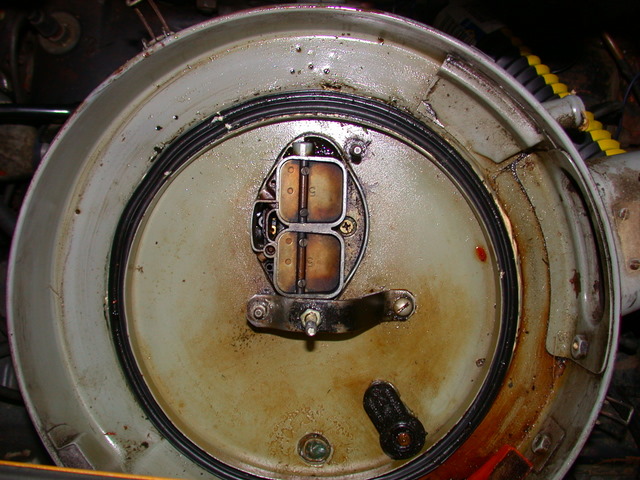

This was my solution, but it took some work to make the adaption. The setup has been somewhat modified since the picture were taken to improve its function.
