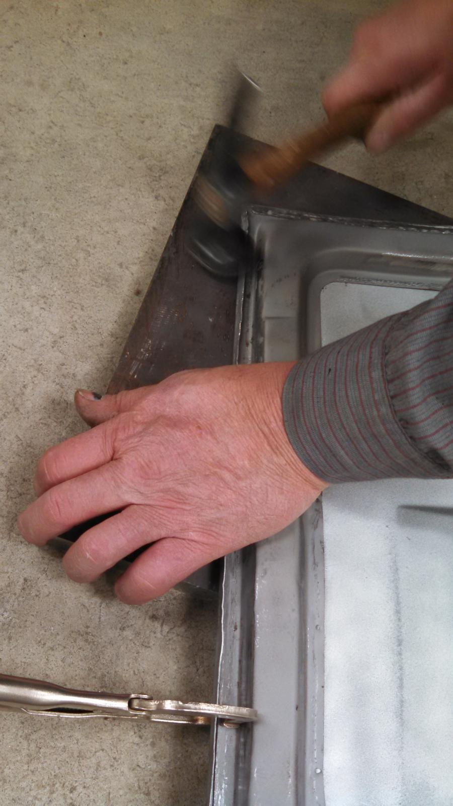

When it was time to reassemble, the outer edge was carefully crimped back around the inner reinforcement.
The edge looks great!

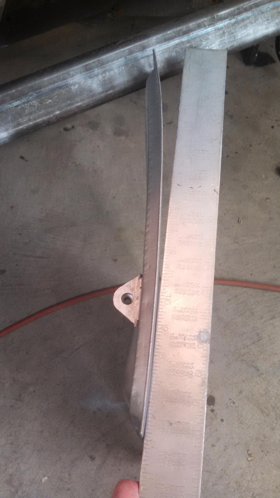

Spin off question from this - should the deck lid profile be dead straight or does it have any curvature to it?
i.e. If you placed a straight edge horizontally and vertically on the face of the deck lid, along the top, bottom and side edges, would the deck lid be flat or bowed?
Mine has what appears to be low-speed impact damage that has pushed the centre of the panel in, below the lock.
I'm considering trying a trick that's worked for me before, where I warm the panel and sandwich the bent edge between two 'formers' and clamp the sandwich together.
I need to know whether the profile needs to be straight or whether there is a contour to the panel that I need to shape the formers to follow.
I don't have access to an undamaged panel to compare it with, hence the question and the valance panel is similarly bent, so will need straightening too.
I suspect that it's low speed damage as there is no damage to the paintwork whatsoever, so it looks like it was pressed out of shape, rather than smashed out of shape. In the past, I've managed to reverse that type of damage by pressing it back out.

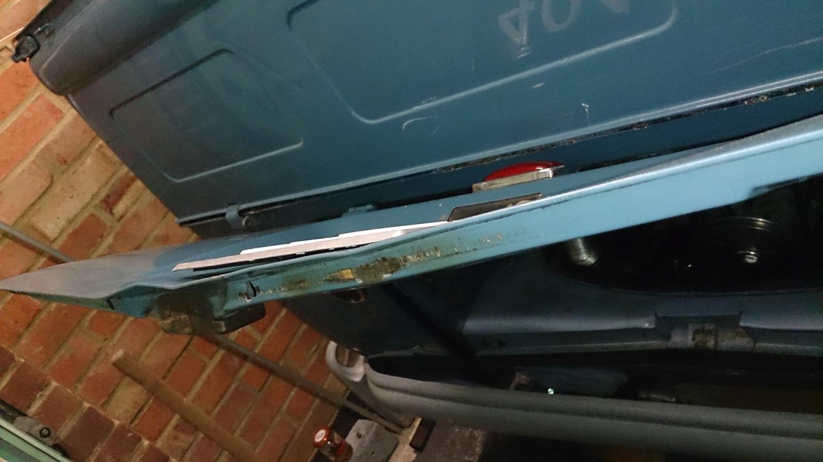

Thanks easy. I went ahead and had a go at roughly straightening it a couple of months back when I managed to source a good used valance. I used some clamps and 4 x 2 timber to get it close enough for now without unbolting it...
Before and after. You can see better how bad it was from the gap between the valance and bumper in the first picture...
...and later with a pair of Doug's repro bubble tail lights...
I also pushed out a slight bow in the left hand rear corner. The missing filler is where a PO tacked some thin metal behind the hacked-out taillight holes and just filled it to get it up to the same level as the corners. The hit that bent the taillight cracked it and it just fell out when I pushed the dent out.
