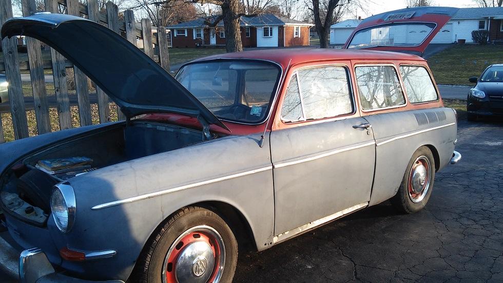

OK, here goes.
My 12 year old son and I just bought a '66 Squareback last weekend. Just put it in the garage today. This thread will document the restoration.
She is in pretty good shape with not a ton of rust and in running condition, a steal at $1000 in my opinion. Looks like the only modifications have been are a set of Empi dual carbs (I know they are hated, deal with it, they won't be changed out any time soon), and a 12 volt starter and 12 volt battery added. Otherwise, she is pretty stock. Has been repainted terribly, but that is about it.
Today we removed the seats and carpet. In the next day or two we will vacuum out, remove all door and side panels and continue.

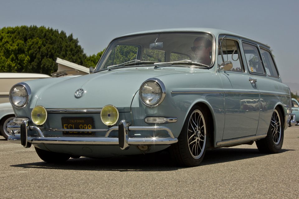

Are you going to go back to Baltic? It's a beautiful color. Here's mine:
1963 Notchback - Ruby Red
1963 Squareback - Pearl White
1965 Squareback - Baltic Blue

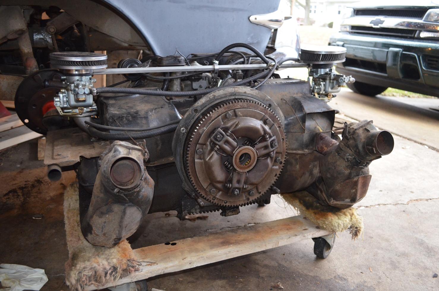

PostPosted: Sun Jan 25, 2015 5:33 pm    Post subject: Reply with quote
Have not had time to do much as of late but I did run the motor for 20 minutes for so on a couple of different occasions and definitely have a couple of oil leaks, seemingly from the push rod tubes, but not sure.
In light of this I pulled the motor today. I figured, this is a long term project and a motor rebuild is in the plan so why wait.
Motor came out easily with no problems, took about 30 minutes.
Not really sure what direction to take, figure once I get the fan, tin, carbs and heads off I will put in on my bench and work on splitting the case.
I have the Bentley manual but any advice or cautions would be appreciated.
