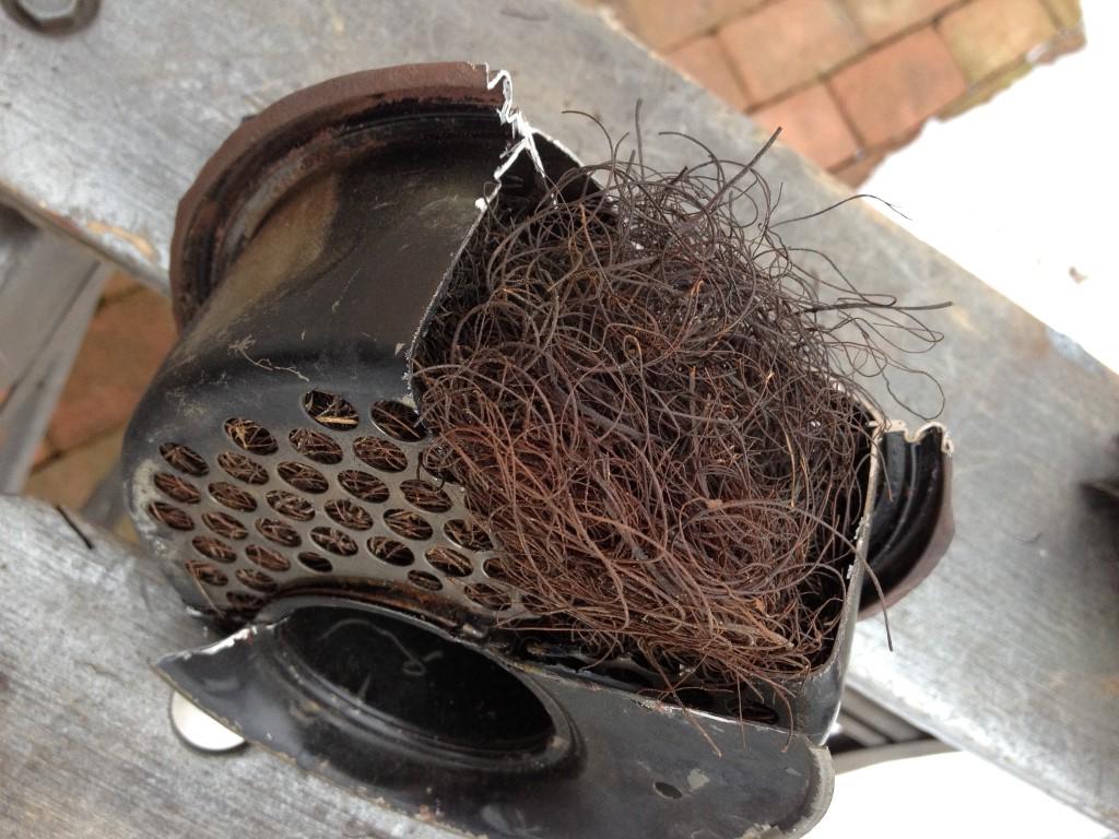

I just bought a used oil bath filter for a type 2 and cleaned out the top filter part with brake cleaner fluid. I ended up using a whole can. I cut the side off a flat sided jug and use it like a parts cleaner. It finally started to drip clean fluid at the end of the can. let it drip dry at least overnight.
I only cleaned it because I'm going to paint it. The one in my bug I've never cleaned. Like Eric & Barb said it shouldn't need it.

I would imagine a '67 would have a similar "element" as an earlier ACL...
Looks like Coco fiber to me, same as seat padding?
Not sure if it was treated in any way or not either, perhaps the oil just wicks up into the weave by natural capillary action?
I'm curious too as to what can be done to recondition or restore them.

The fibers are there mainly to disperse and block any liquid from entering the intake and carb.
The oil does the majority of work.. and any oily air and dust that makes it through the oil generally is trapped in the continuously re-wetted fibers which will drip back down into the filter sump when the engine is off. Hence why it gets so sludgy so fast.
Its very important to keep the oil level in the filter clean and the correct level..
The fibers can be washed and swished out in a bucket of diesel fuel or kerosene. That's the cleaning procedure for typical oil bath cleaners.
My problem is most of these nut fibers are starting to show there age.. due to non use (dry)
There is no problems with repacking accordingly it with more fibers or an alternative such as steel wool or a plastic mesh, provided you have time as trying to pack these through the intake perforation is a pain.... and taking them apart usually destroys them. The correct amount of packing is important as well..... too much restricts, too little wont disperse/block...

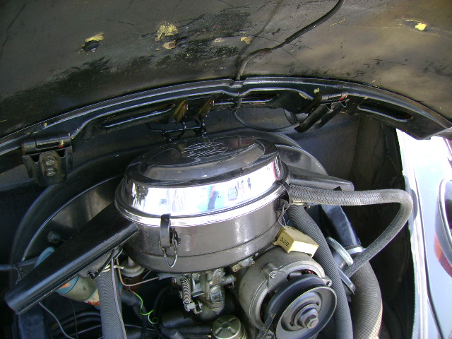

This is the air cleaner I've used for 8 or 10 years. I had added a port for the tube that goes under the left cylinders. You can see the patch job from closing the port. The engine lid kept crushing the tube so I found a spout at Ace Hardware instead.
If I soak the upper piece in diesel overnight, how do I get rid of the diesel soaked into the fibers?
TIA,
crvc
Eric&Barb
Joined: September 19, 2004
Posts: 25904
Eric&Barb is offline
PostPosted: Mon Feb 23, 2015 8:52 am    Post subject: Reply with quote
A tiny amount of diesel should not affect the engine. Just drain it out over night.
crvc
Drip or shake dry. Diesel is nothing more that refined oil... Wink
A flush with brake cleaner will get any excess off as well.
For '67- Late models, OG EMPI probably came up with the best idea, which is a custom top cover and a replaceable element that fits the stock housing...
yes it is coconut husk fiber.
there is a orange/red line inside bottom half that gets oil up to line as oil level.
