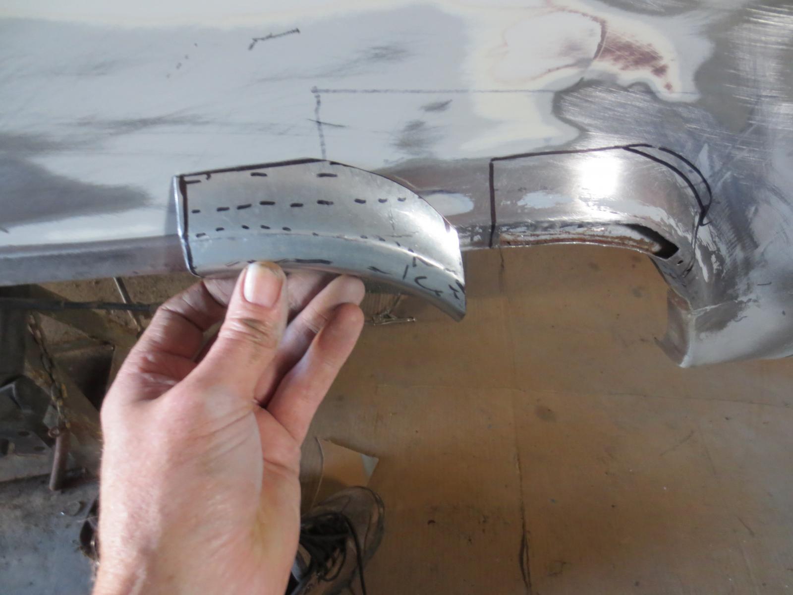

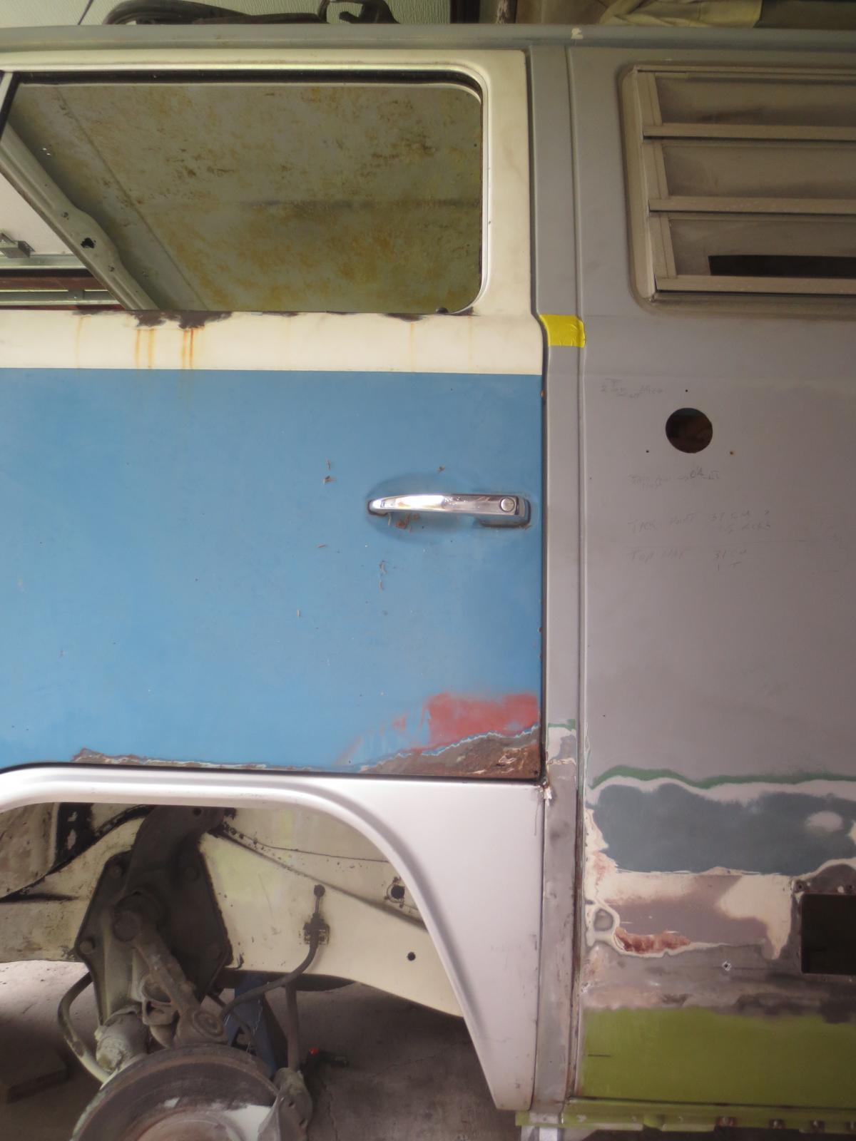

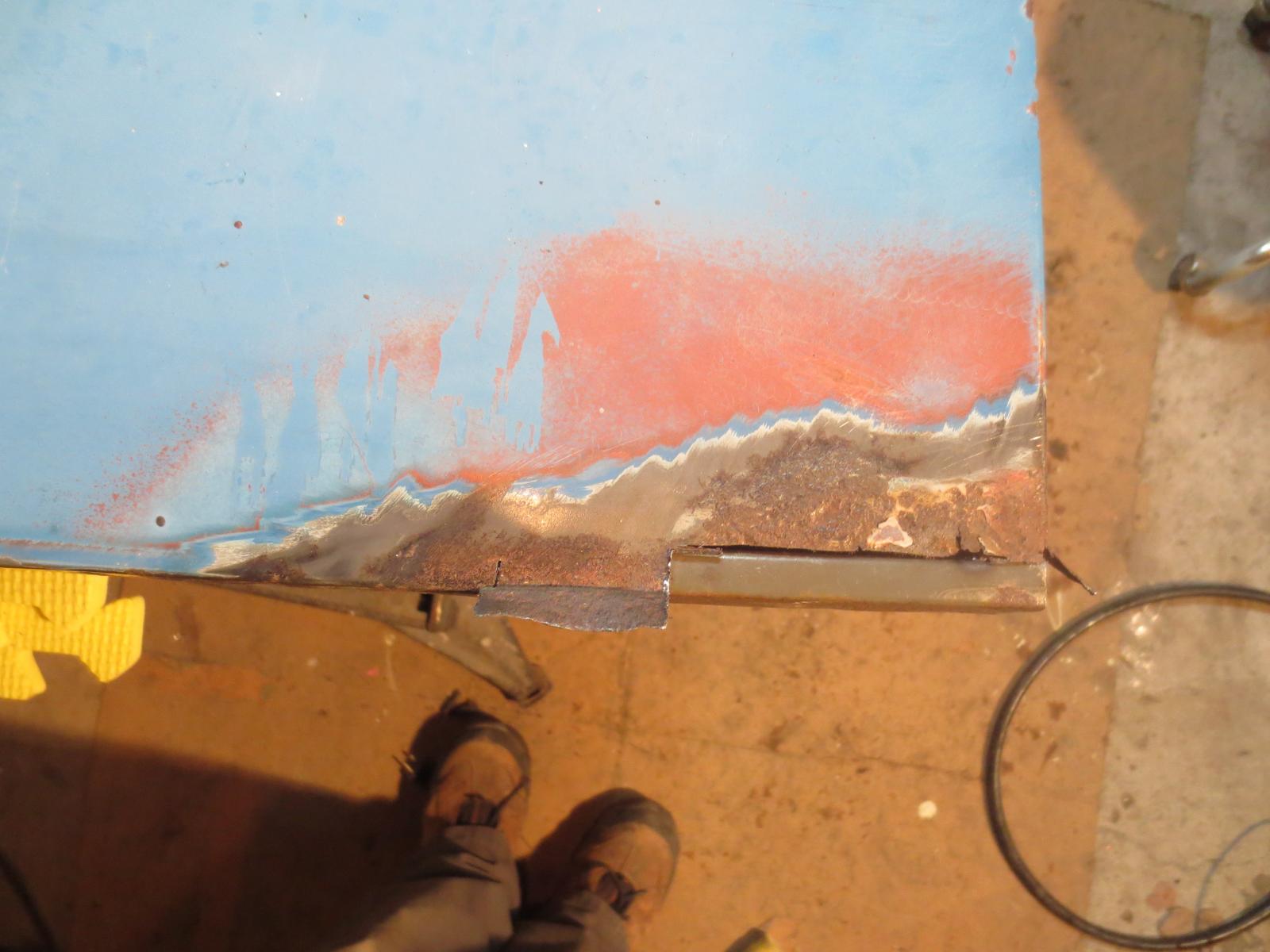

The door was rusted out on bottom,Luckily the door from the parts bus was not too bad,so I will use it.
Also started the patch at the rear arch,just got to get the cut right for the easiest weld.

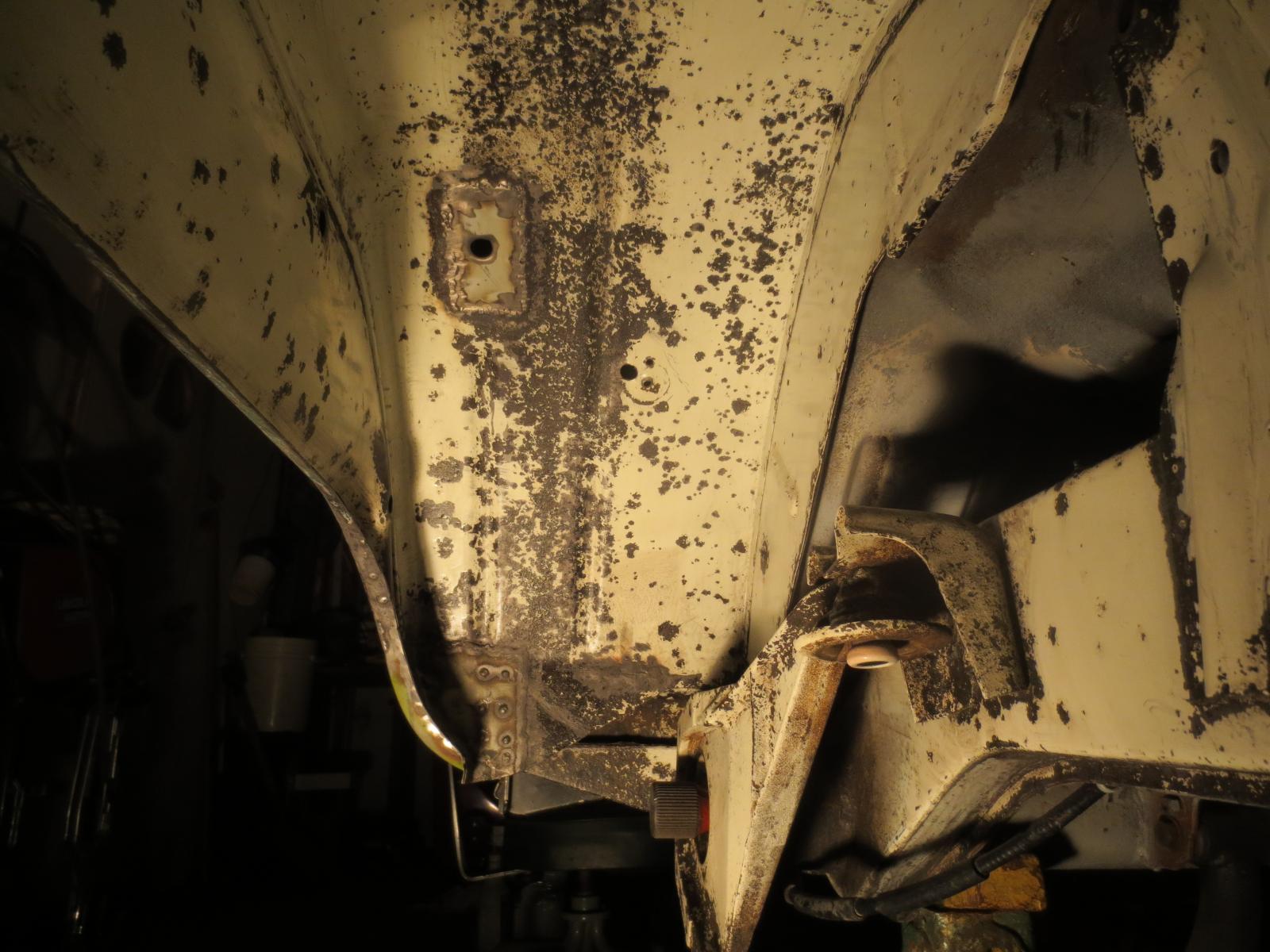

I have welded in the arch patch and made a patch for the seat belt mount,This brings me back to where I started at the left rear corner.now I will go around it again and get it ready for primer and seam sealer.and I still have to replace the floor section at the rocker.

Here's a question, did you treat the old and new metal on the backside before installing. What did you use?

Hi Rob,thanks for looking,I used weld-thru on the patchs that were not accessible from the back side.
When I finish with the body and paint I will spray Krown rust protector into all the nooks and crannies,that should stop any rust from forming.

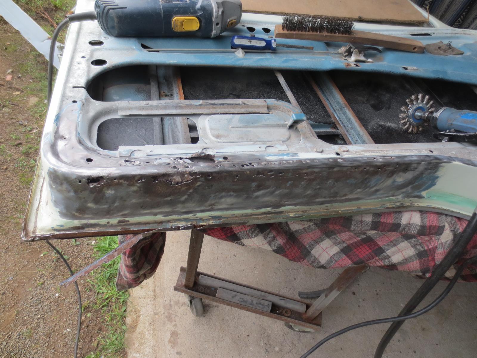

Still at it,cleaned and put some rust converter on the wheel well,patched the rear seat belt anchor point,small patch at floor and wheel well,then started on the door.I cut up an old door to get the channel patch.

That came out really well, lines up nicely and clean welds. From the pic it looks like you won't much filling to do. I can't tell if there is already filler in it above the repairs. I did my side panel about 20 years ago with a different panel. I made a lot of mistakes and there was already a lot of warping from a previous repair a friend of mine had done brazing in a repair panel some years before. I ended up taking the whole panel back down to bare metal and it took me ages to get is straight first with the stud welder, then filling. I ended up covering a large area with filler though not deep. I have this theory that the rust starts with water coming in through rust holes starting in the window frame below the smokers window. I deleted mine as well as the hole for the electrical box. I am also considering using something besides those channels spot welded to the rear window frames to hold on the side covers. They are just asking to rust. I love stock, but rust prevention is my first priority.

I am also thinking of deleting the elect outlet hole,and the vent window will be going,not sure if i use the jalouse windows or not,I am pleased with the way it out,I think the aluminum strongback, that I fastened on the inside just above the weld line,helped to keep the warping down.There is no filler above the repair,just lots of paint 3 different colours.My grinding skills are much better then my welding.

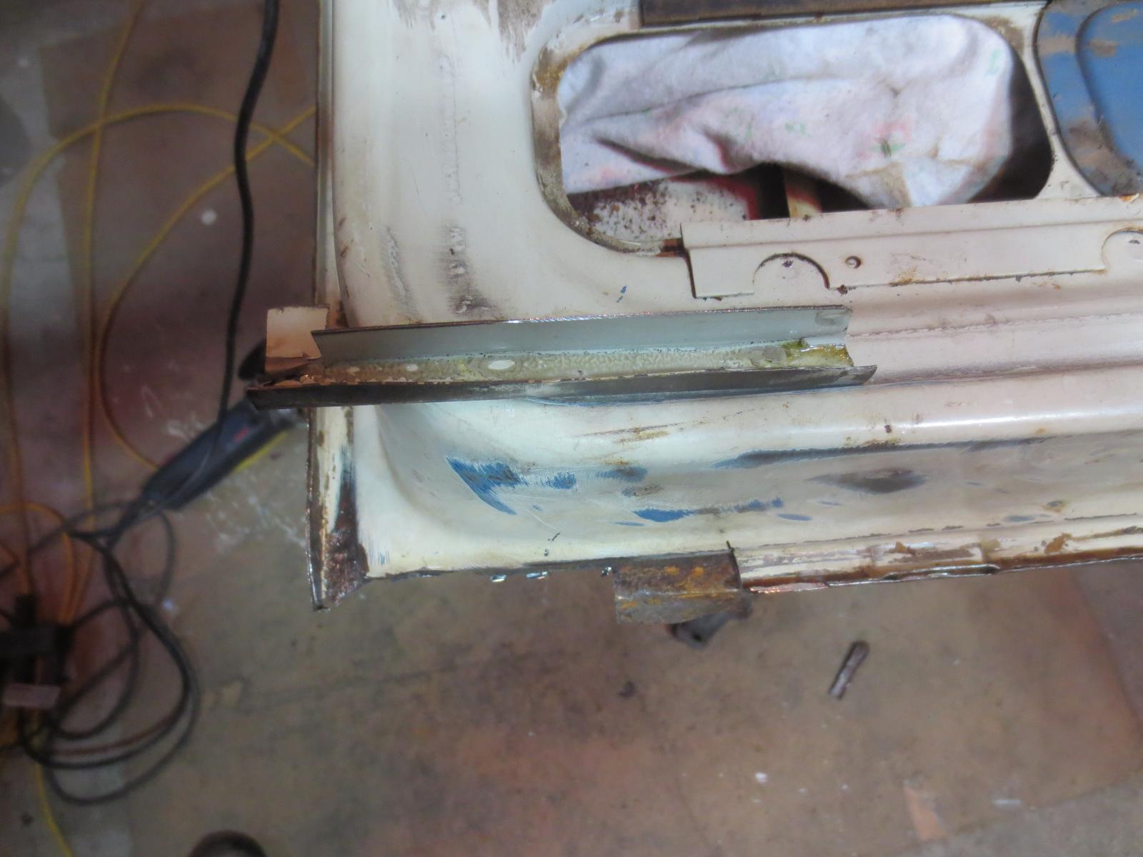

The channel patch picture!!!!! Now i see how you did it. Ive got to practice some welding first, but then im going to try and ressurect the doors i thought were solid enough to install, I was just having trouble visualizing how you did it, but now i see outside and inside, i think i can handle it.

Yarkle,I know how you feel about welding,I have to plan every tack,and go thru the motion each time before pulling the trigger,I space the tacks out and grind them down after I do 4 or 5 of them that gives it time to cool,thing that really makes a mess is the under coating, behind the panels, that I can't clean up.
You may notice that I left a small piece of the corner in place,I left it there as a guide when I get it all fitted up I will remove that small piece.

Welded in the door patch.
