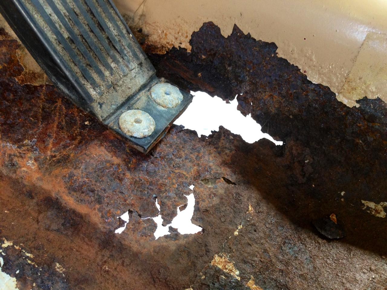

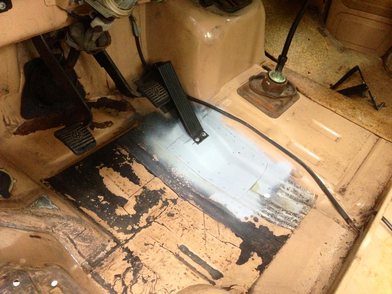

I have two Vanagons. One is on the road to redemption, the other just gives up its parts to the other one. Both have rusty holes underneath the accelerator pedal, so I suspect I'm not the only one with this problem.
Today, I decided to buck up and get the job done. Since the donor Vanagon had nothing useful in the same area, I was going to have to full-up fabricate a repair. Here's what it looked like to start:

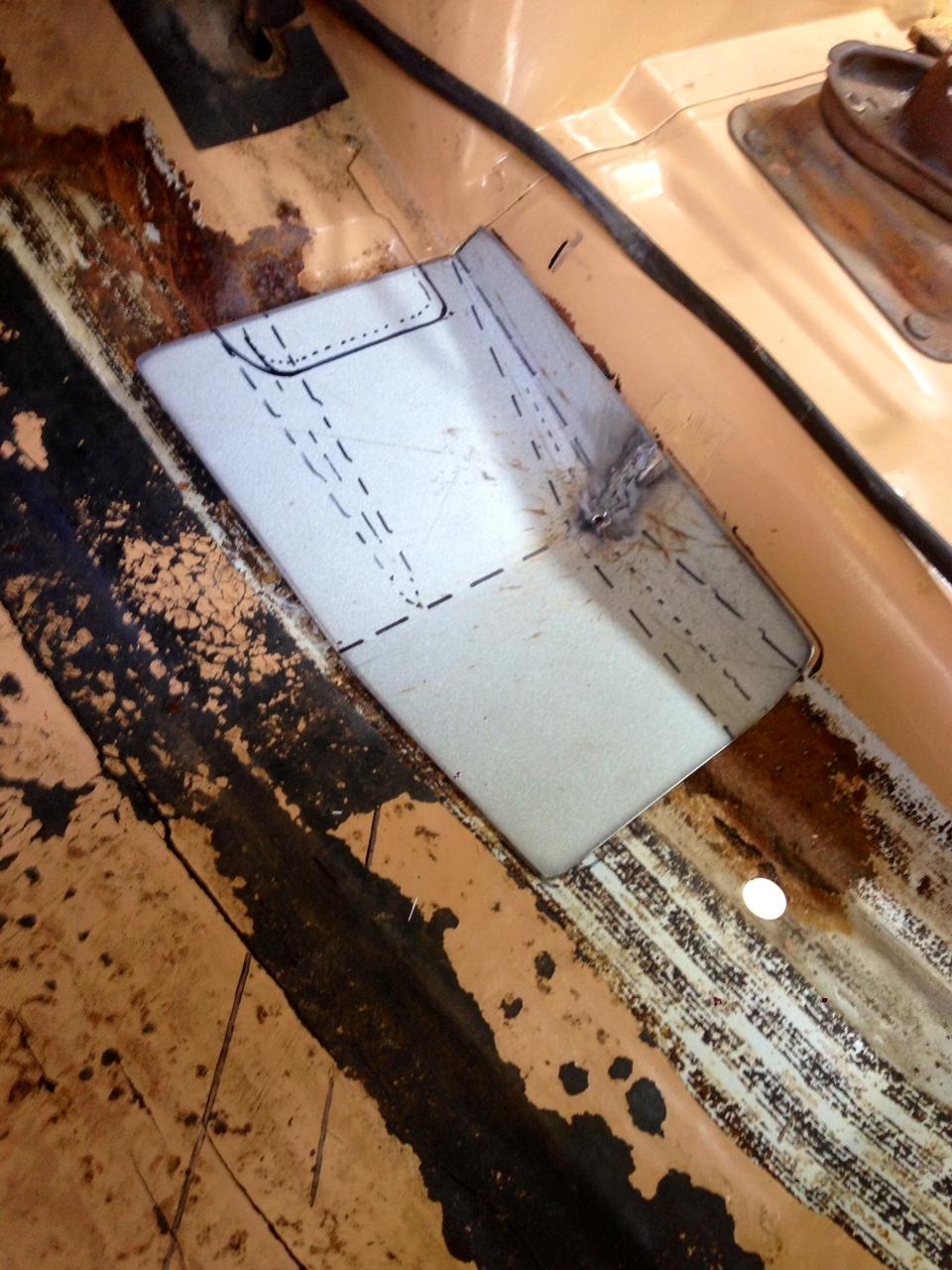

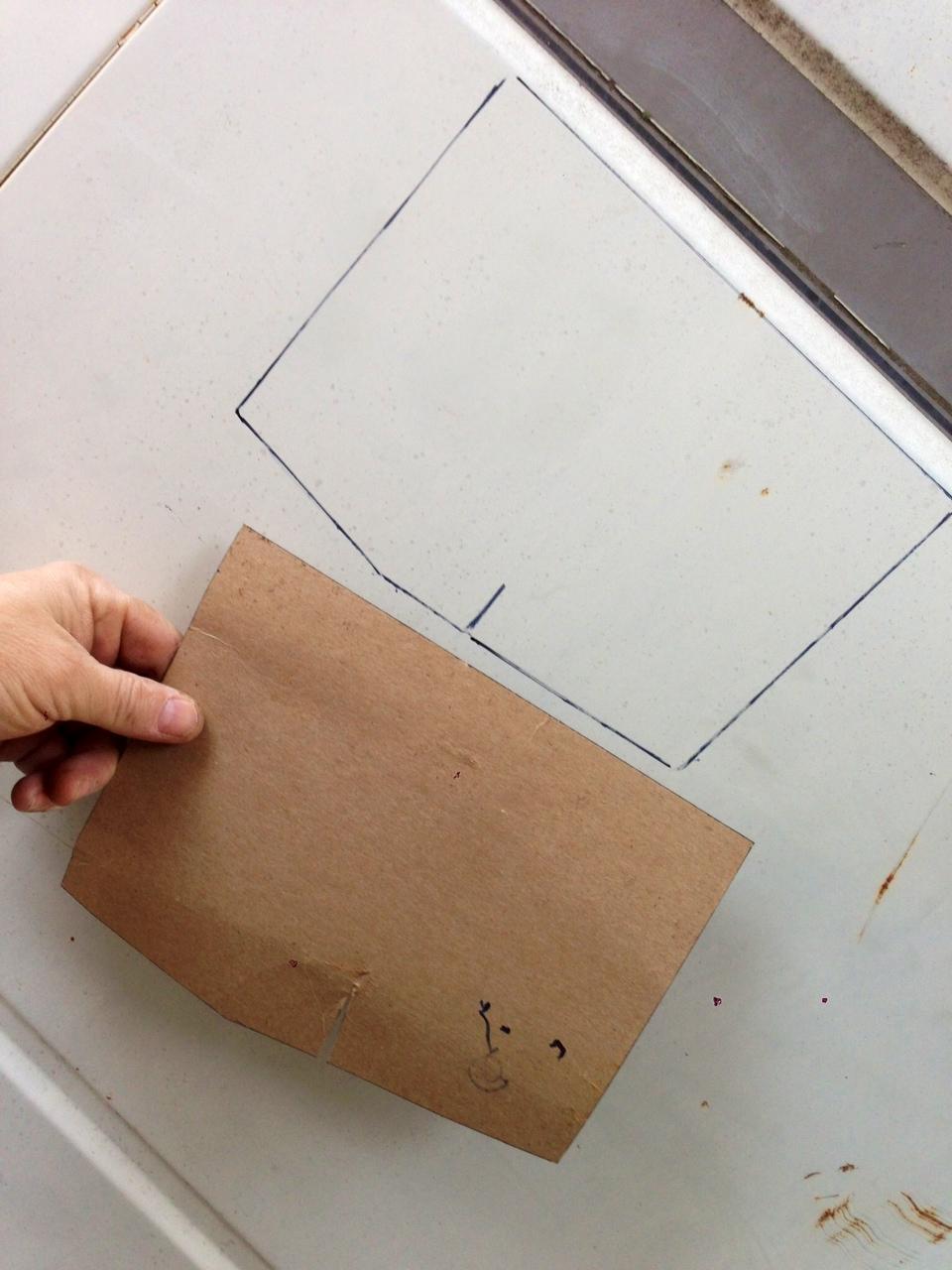

First thing I did was to put some cross-hatch reference lines outside of the repair area to show me where the accelerator pedal fasteners go. That way, I can locate them after the repair is in place. The lines are kind of faint, but they are there if you look closely.
Then I took a piece of thin cardboard and cut it to fit the dimensions I wanted for the final repair.
None of the bends are sharp 90-degree bends, so I marked the beginnings and ends of the transition areas on the cardboard template.
The donor van had a clear area on a panel that was damaged in a wreck at some point. I traced the template onto the skin.
I cut the section out with a high-speed die cutter.
I cleaned up the edges with a file and belt sander.

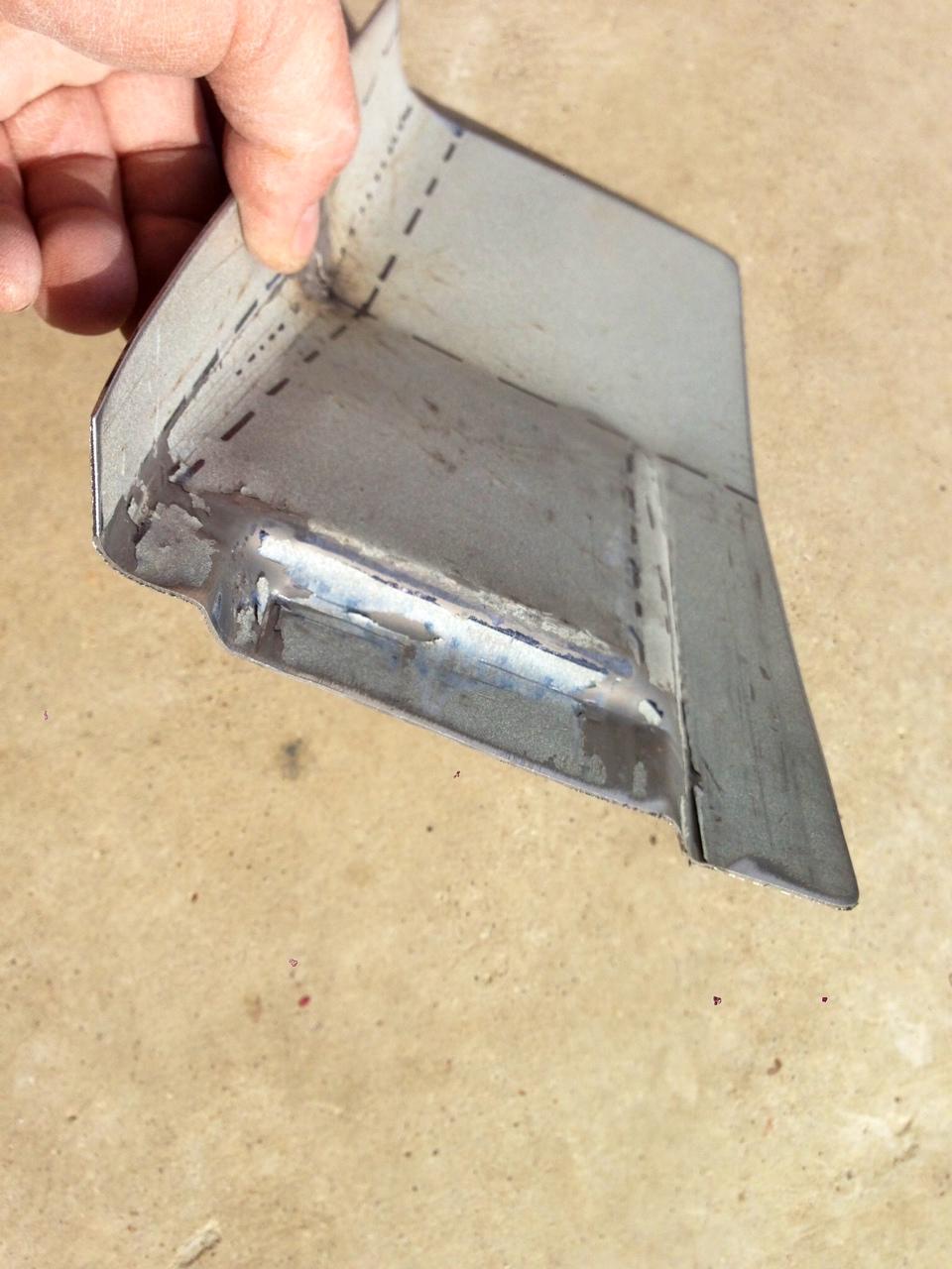

Transferred the bend lines and other references to the repair part.
Using only a bench vise with some aluminum angle as jaw protectors, I "step bended" the areas forming the inboard bends that mate with the center tunnel, as well as the slight left-to-right crease.
I threw some tack welds into the dart to help the part hold shape and gave it a test fit.
Continued to cold work the part, using the vise, a hardwood dowel shaped to use as a bumping block, and a big hammer.
Test fit again.
Started work on the front area.
On the next fit, I was reminded that the front area had two transitions. Here, I have begun adding the second transition.
The fit is looking good. Cleaned up some bumpy areas, smoothed things out, and primed the underside.

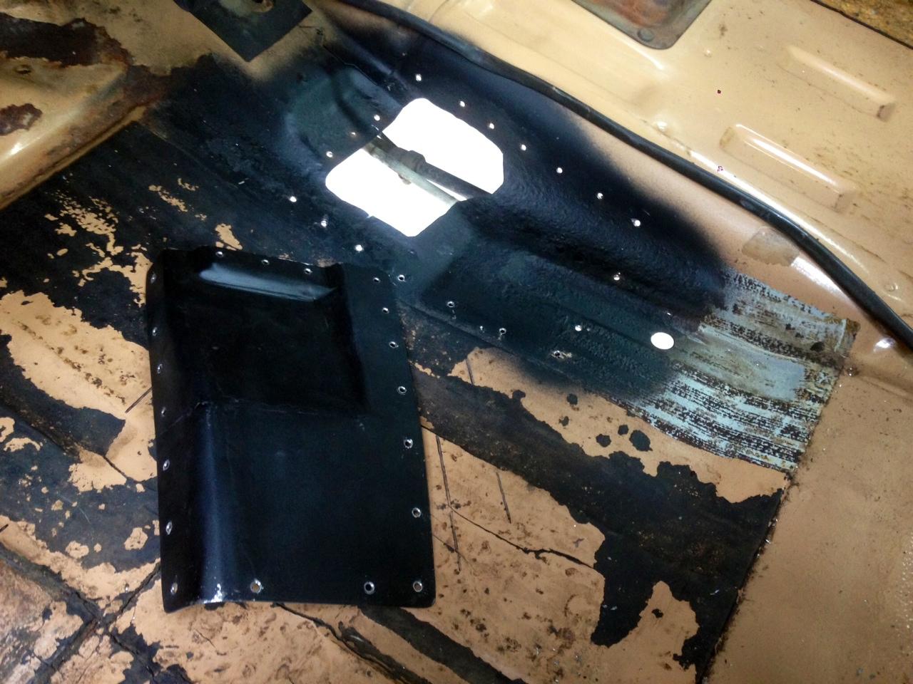

Cleaned up the jagged rusty hole and wire brushed/abraded the surface rust areas. I primed it afterward with some rust arresting primer.

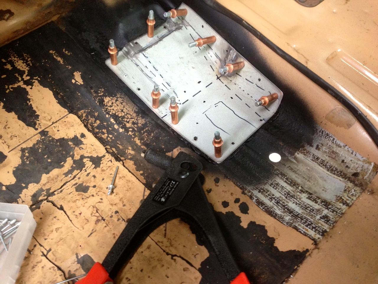

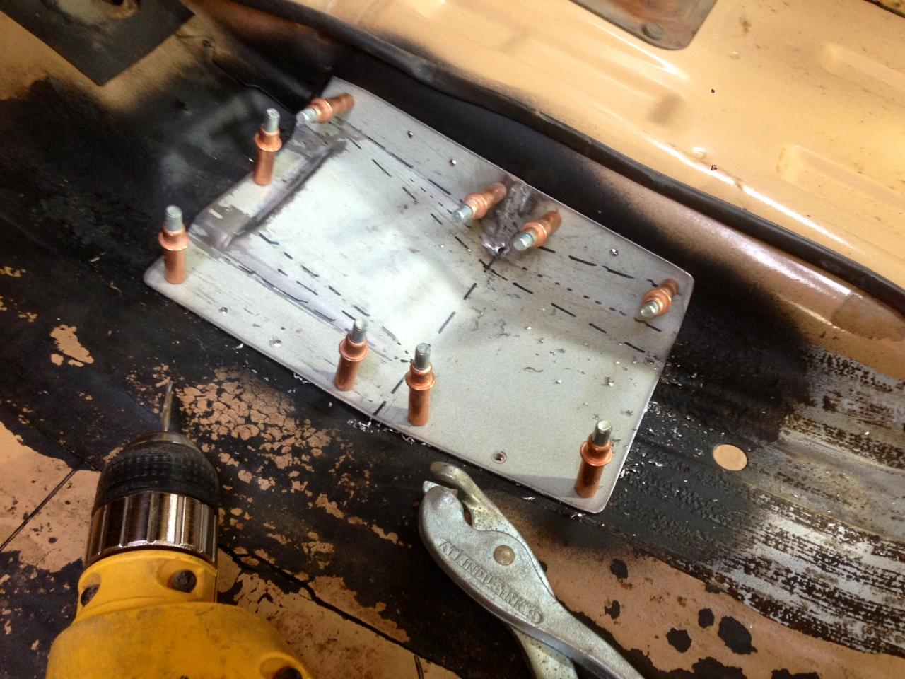

Now, many of you probably don't have Cleco's, but they come in really handy for this sort of thing. Others might just use a welder. As you may have noticed, my weak skills as a welder are not enough to overcome the limited ability of the cheap HF flux core wire welder. So I opted for rivets. I used to be a USAF aircraft sheetmetal guy, so it's what I know...
Deburr the holes.
Apply sealant (Blackjack) to repair area (note the channel I filled with sealant, instead of trying to make my patch fit the trough).
Install rivets.
Seal underside of patch with more Blackjack.

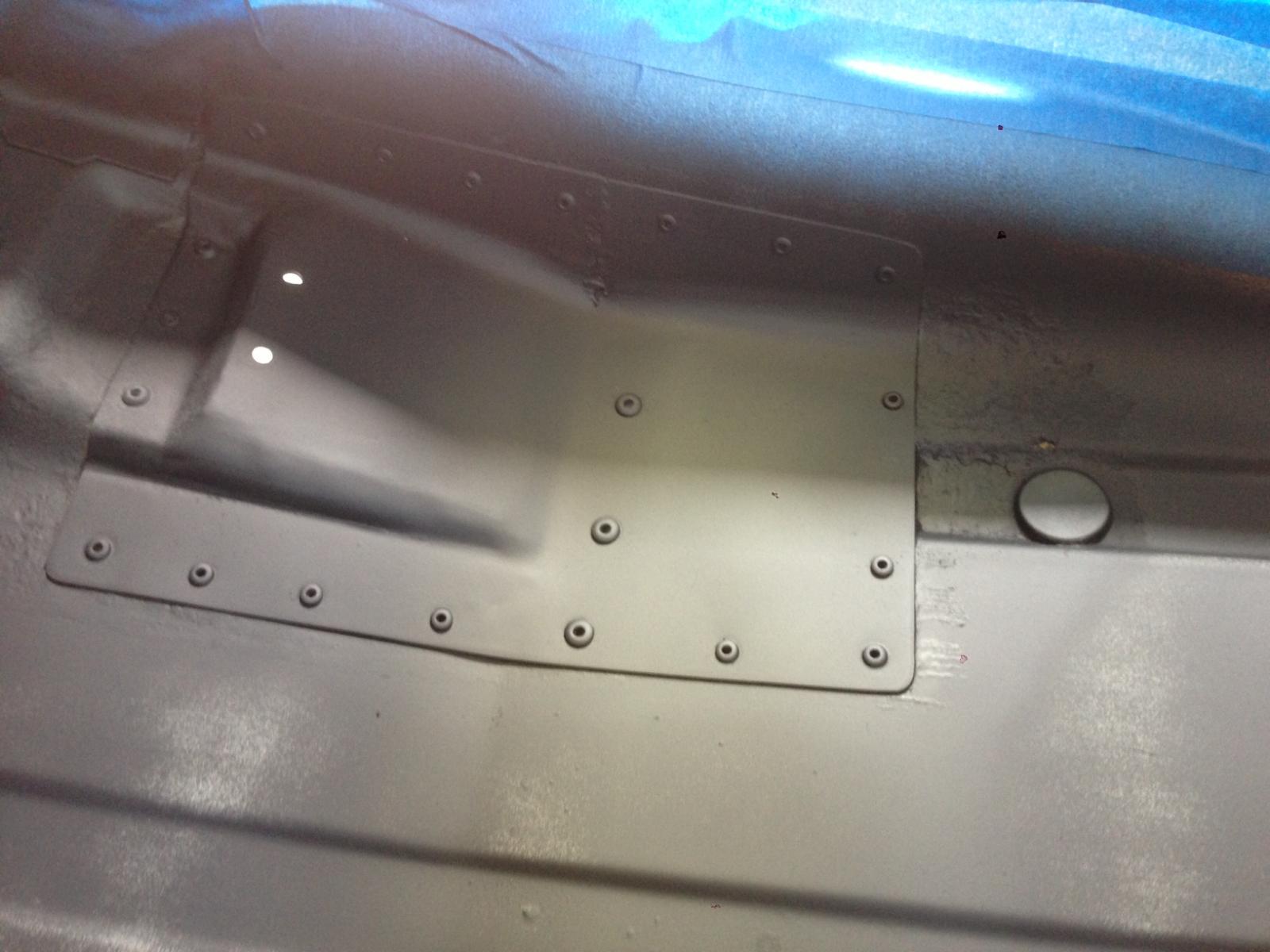

Cleaned up for priming.
Primed.

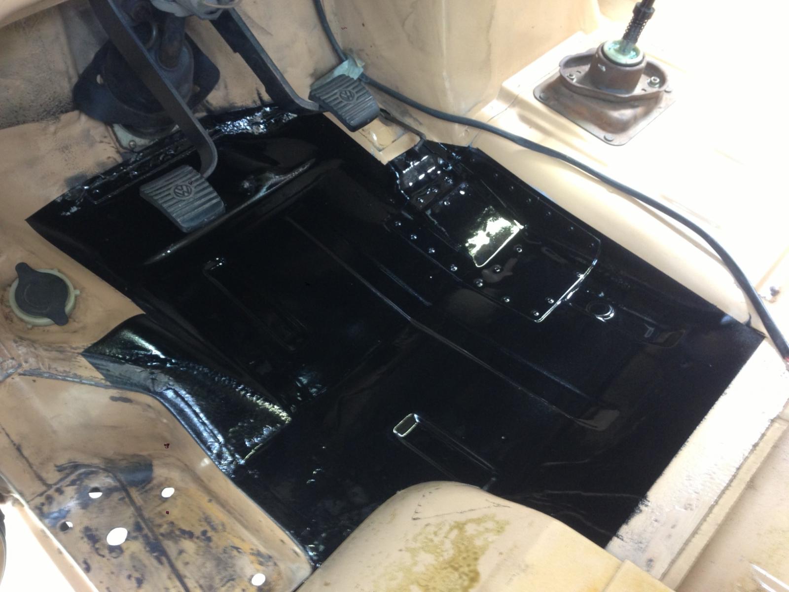

Pick up holes using cross-hatch lines from the first step, transferred back onto the repair part. They didn't exactly line up with the holes in the pedal, but I was able to get a good placement.
Drilled new holes and installed pedal with two 3/16" carriage bolts.
Complete.
Cheers!
-Karl

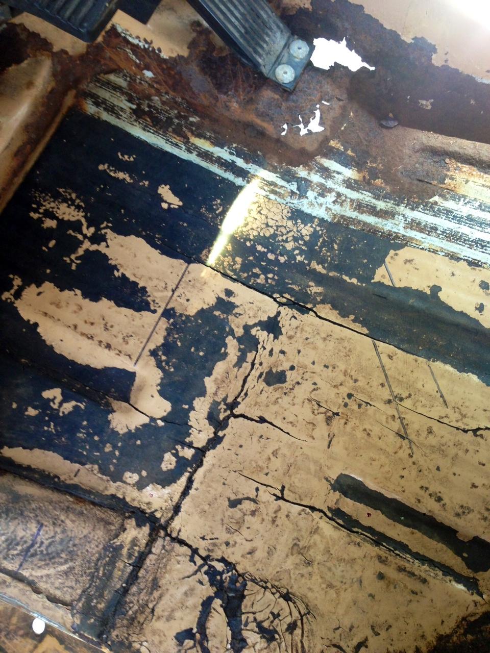

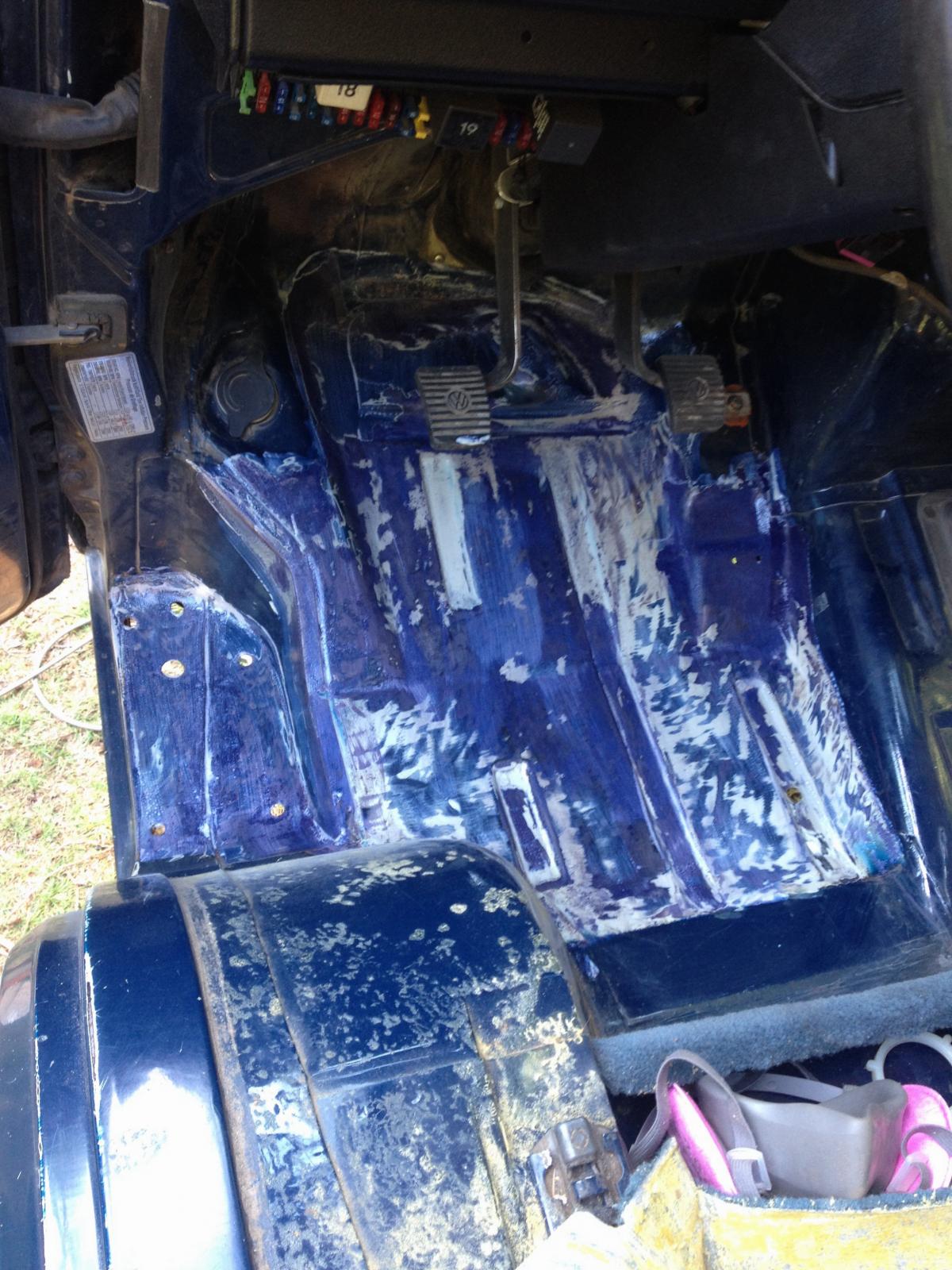

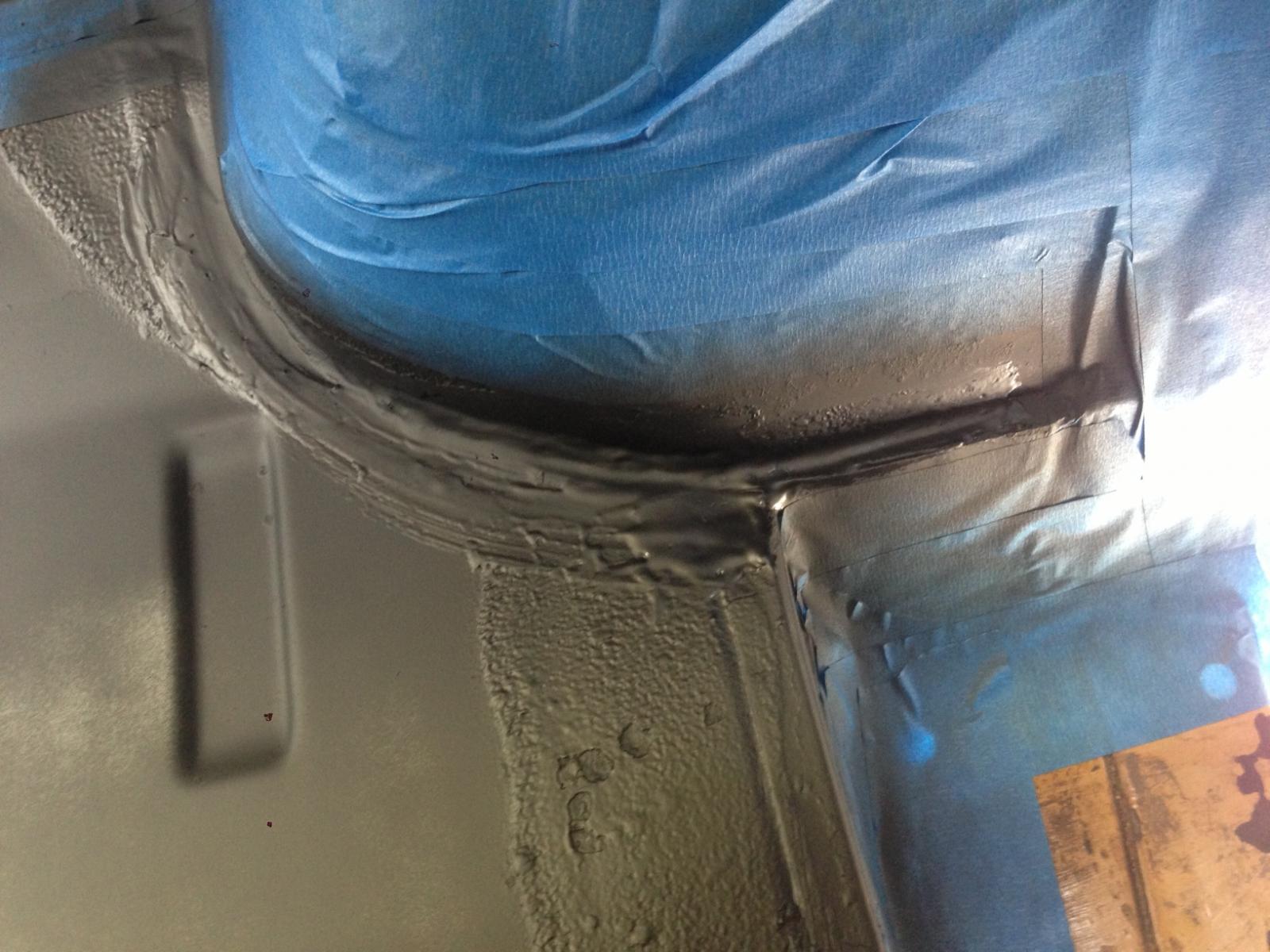

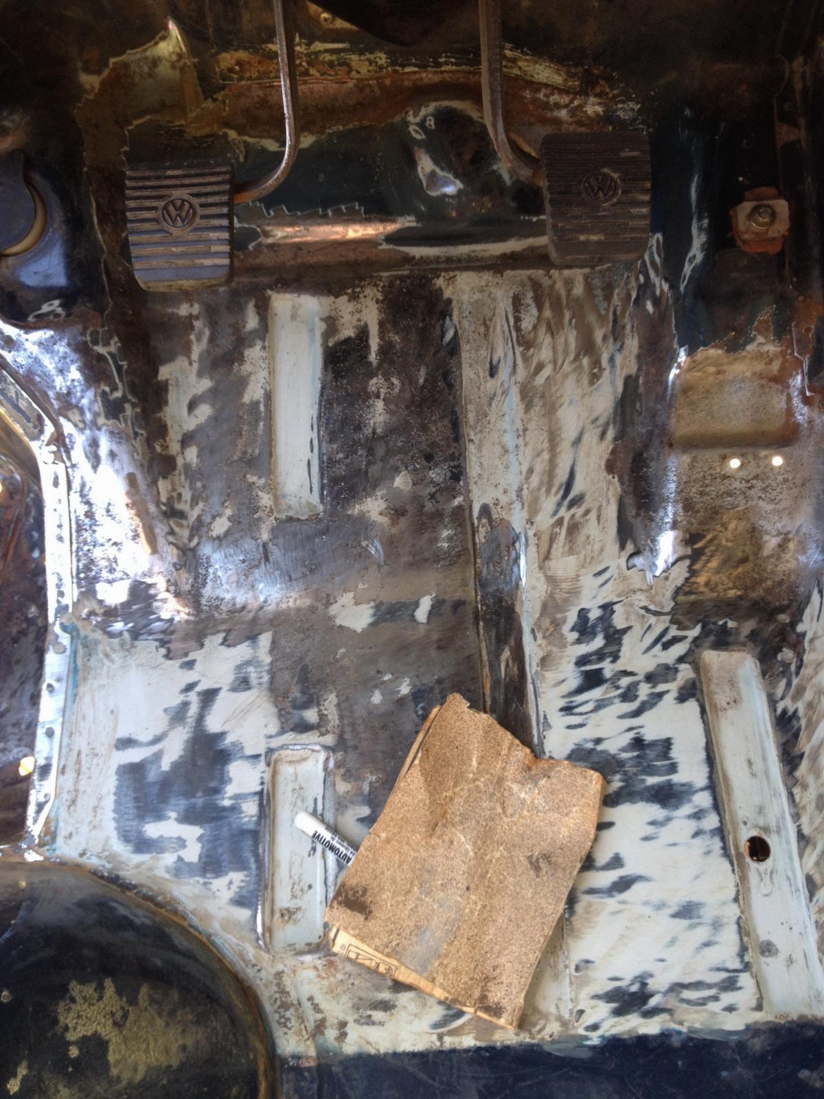

Well, I finished up today. The plan was, once I got it repaired and rust (hopefully) arrested, to build a swimming pool out of truck bed liner.
The asphalt based floor covering was full of cracks and I noticed that when I removed the stuff in the repair area, it had moisture underneath. Also, it didn't seem like a good thing to paint over. So, I removed the rest of it and cleaned up the residue with mineral spirits. I also wire brushed out the rusty areas in the enlarged area of concern, applied rust converter primer, and re-sealed them. You may use your sealant of choice. I used something I had (not blackjack).
So, here it is with the area all cleaned up, sealed, and primed.
I glued a plug into the hole revealed by the removed asphalt mat.
You may have noticed that I missed a hole! It popped out after the primer was applied. The black on white made it clearly visible. If you go back into the previous photos, there it is! I don't know how I missed it.
So, I took a small piece of aluminum tape and backed up the hole from the underside. You can see the underside of the plug. Again, just something I had in my collection.
The main area that I resealed. There was actually a small hole revealed after wire brushing, but not worth my time to repair.
This is after the truck bed liner was applied. I used an entire spray can in several coats. The material preferred to be sprayed with the can upside down, by the way. Use a respirator and/or spray in a well ventilated area. I had a little fan going, in addition.
The film strength of the material would probably be too much after it is cured, so I removed the masking tape while it was still wet.
Re-installed the accelerator pedal.
Once the bed liner is completely cured, I'll go underneath, pull the aluminum tape, and hit it with some undercoating to seal both sides, including the plug, to help retain it.

Thought I'd share some photos here, I got into this job yesterday. It all started with sound deadening the engine decklid, but before long I had the hole interior pulled out. One thing leading to another...
I've had a wet floor problem for a little while, despite refreshing the front windshield seal. I think I'll have to get in there with some sealant. Anyhow, that's how it looked when I finally pulled up the sound foam & carpet. The asphalt-based floor covering was pretty haggard looking, so I scraped it out and began sanding:
Once I got *all* the rust (ha) sanded off, I applied 2 coats of rust treatment:
And am in the process of letting that cure for 24hours. What are folks' thoughts on the 'bathtub-type' paint scheme for the front floor? I picked up these two products:
Thinking of laying down a few coats of the rubberized undercoating, and then bedliner over that. I'm tempted to leave the passenger side be, as it looks just fine:
But maybe I should continue my theme of goin' to town, and go to town on the whole floor?
My water problem was solved by resealing the two body seams coming down from the windshield, above the headlights. YMMV
