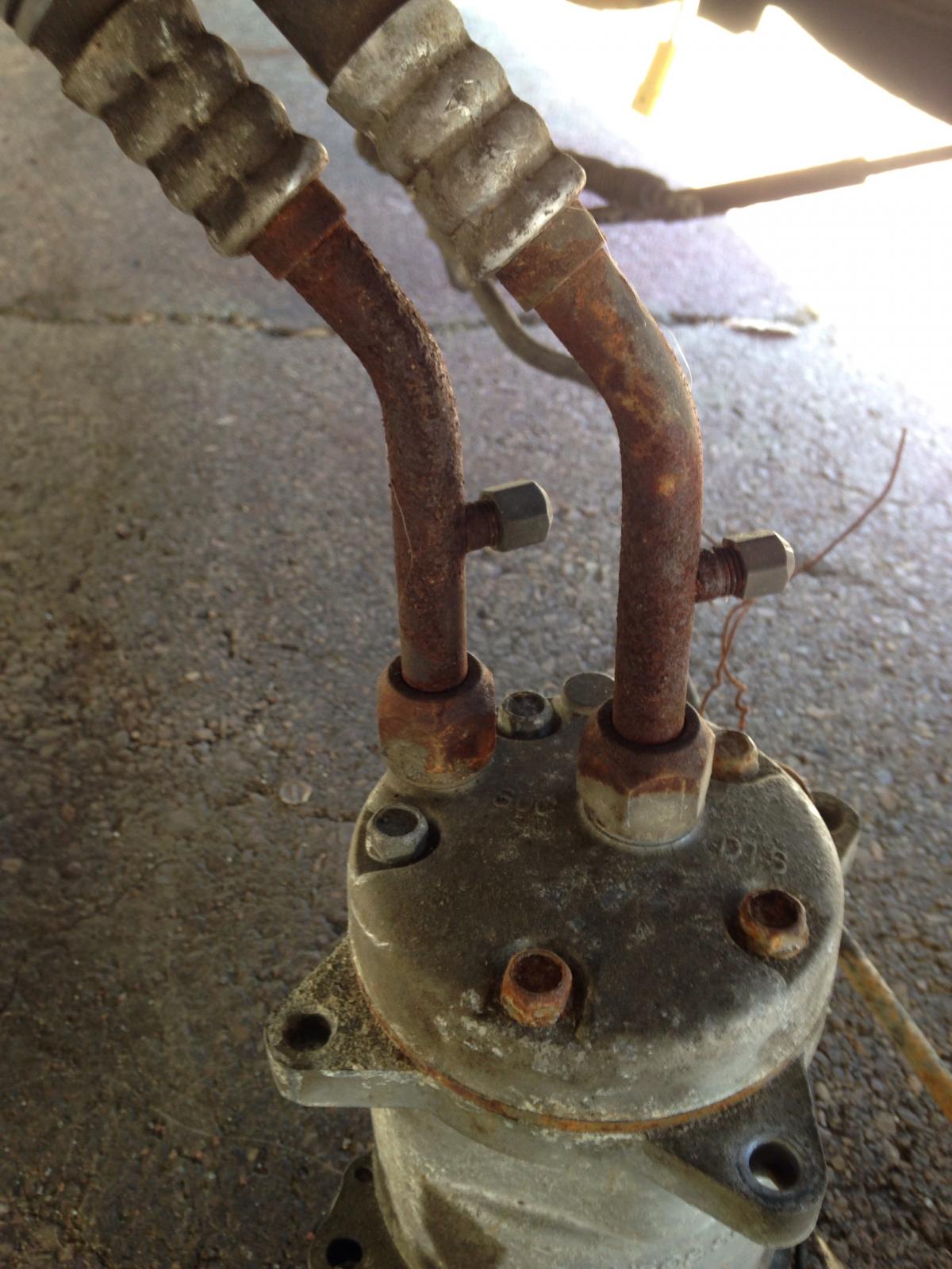

PostPosted: Wed Mar 25, 2015 12:44 pm    Post subject: Reply with quote
So...... My 1986 vintage Sanden 508......
Pretty? .......
As part of the repair and reuse or replace I thought it best to open it and see what I'm dealing with here.......
Tools are good! To not damage the clutch there is a tool kit made for multiple applications. For the Sanden you only need the items along the bottom of this photo...... Three 6mm bolts, large bolt to screw into pulling plate above it....... Wouldn't be hard to utilize something already in the shop or make up a simple puller from a chunk of scrap steel and some hardware......
Clutch puller assembled on clutch plate........
Here it is separated....... And a close up of the corrosion....... I LOVE the Northeasts love of deicers! ........
Here is the inner portion of the magnetic clutch. Need to remove the inner snap ring so I can pull off this assembly.......
I used a standard 3 arm puller CAREFULLY so as not to distort the pulley......
Here it is after the inner pulley was pulled. You Can see the magnet coil, the insulation is badly cracked which will allow moisture in.
As the pulley came off it caught on the snap ring groove and broke a bit off of it thus throwing the concept of reuse into serious question! .....
Cracked part by screw driver tip....... Notice cracks in insulation too! .....
On the back side, loosen the rear cover plate to remove the interior check valve plate........

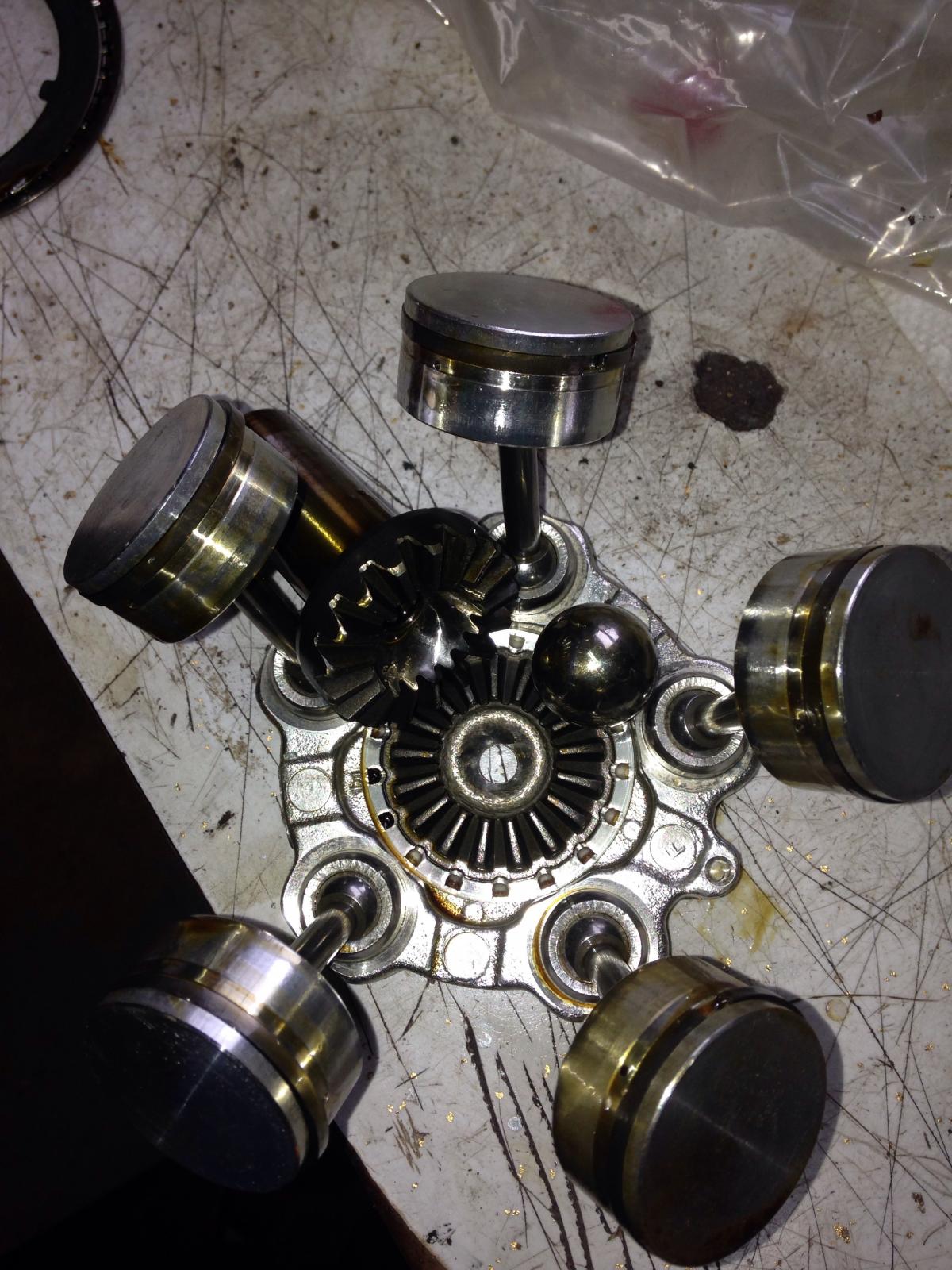

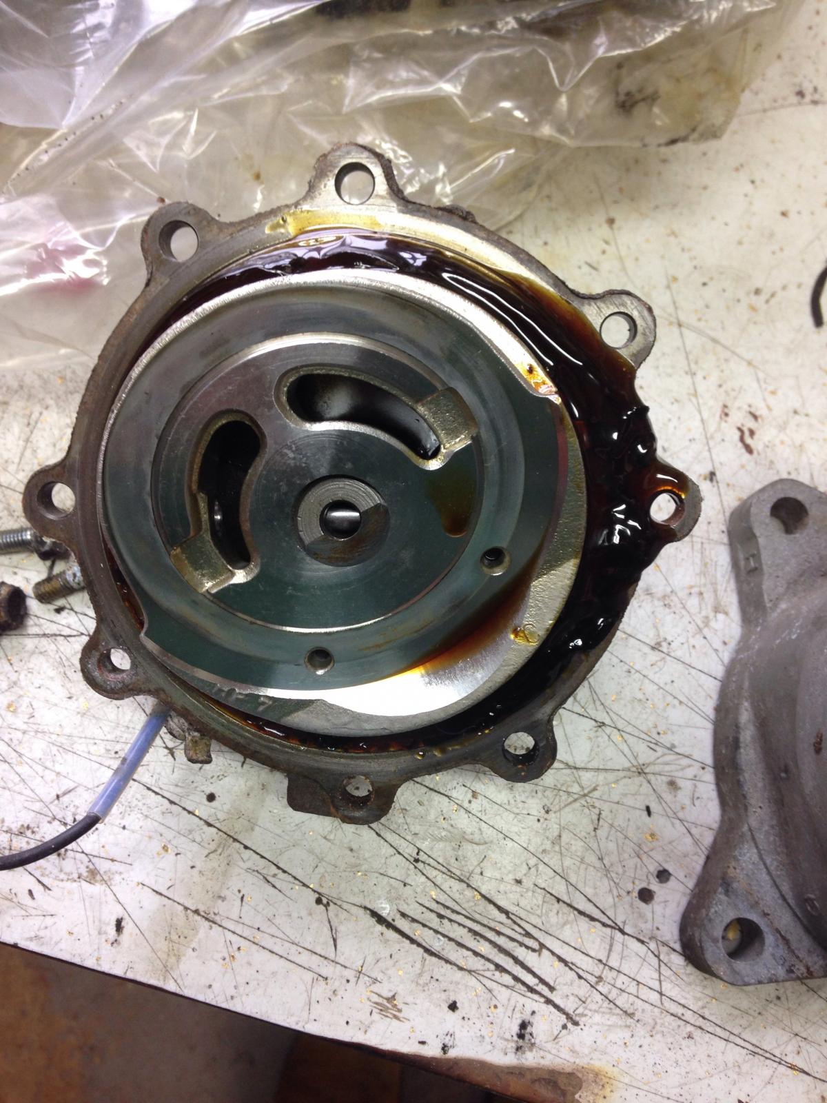

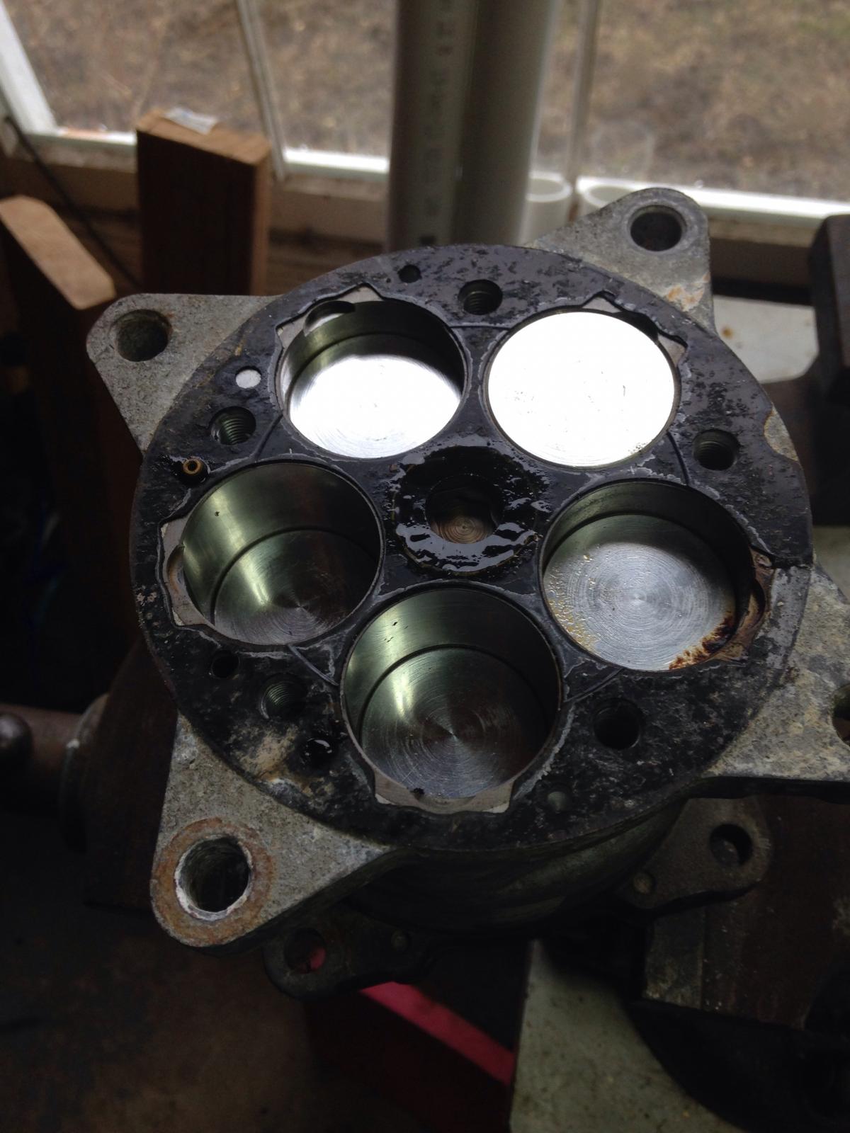

PostPosted: Wed Mar 25, 2015 1:05 pm    Post subject: Reply with quote
Lifted the back cover off..... Simple design......
Exterior is the Suction side..... Center portion is the pressurized output.
This is why you can rotate a cover to align the ports as needed thus keeping the oil fill hole up.......
Under the cover is this greasy mess. Stuck in the nooks and crannies of this gasket is black gooey grease like substance! See thise bubbles in the gasket? They are packed full of grease! NO GREASE BELONGS IN THIS PUMP!!!!! The grease is simply old congealed mineral oil from the old R12 Freon days.
I'm guessing this goo will be found in every component is this AC system! ........ The five point star is the check valve (reed type valves) for the exhaust or pressure ports of the pump.
The five holes along the outer edge are the intake ports.......
Here is the same plate flipped over, it didn't want to come off, I had to convince it to come by doing as the manual suggests and using a very thin scraper blade worked under the plate..... Worked under as in I tapped it under the plate with a hammer!
The intricate five pointed star are the reed valves controlling the intake of the cooling gas/liquid.........
This compressor is a 508.... Five pistons, the 709 has...... Wait for it....... SEVEN pistons!
Here are the pistons in various stages of travel, intake to compression.
From sitting unused, that cylinder you see in the lower right with the brown goo? Not a good thing, not sure how or if that affects that cylinders rings chance of sealing........
Now to pull off the the magnetic coil and open up the crankshaft end!

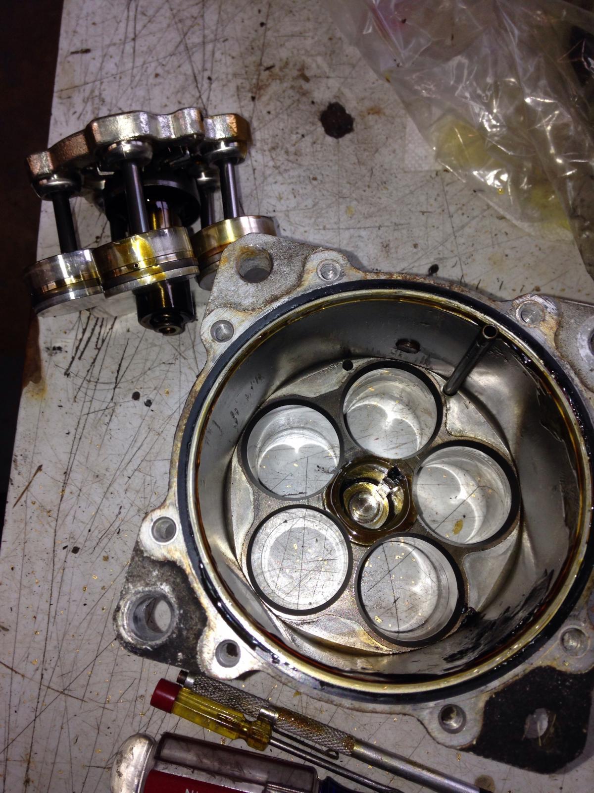

PostPosted: Wed Mar 25, 2015 2:21 pm    Post subject: Reply with quote
Oh..... I couldn't wait!!!!
Just pulled the crankshaft cover off and separated the two pieces.........
Ewww! Grease! Stinky smelly grease!
Anyway here is the Crank cover end. When the magnetic clutch engages it spins the input shaft that in turn spins this tilted disc, the tilted disc in turn pushes each piston up and down creating coolant pressure........

Here are the pistons pulled out of the crankcase........
The piston plate rotates on a ball bearing set in a single planetary gear which keeps the entire assembly centered and aligned.
By engaging in this planetary gear, the pistons remain centered in their bore and don't try to walk off to the side!
Ingenious!!!!! ..........
That shaft shown lying off to the left is keyed into the crankcase so it does not rotate. This gear system is only for piston alignment in the bore! ........ That big ball sets in the center of the gear........ Each piston connecting rod is fastened to the plate by a ball joint.......
As I found in the reed valves...... Thick gooey grease! No Grease belongs in here! This is lubricated by mineral oil! .......
