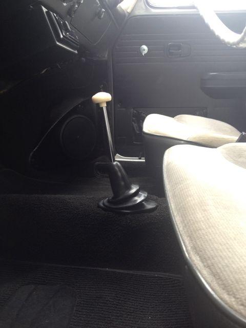

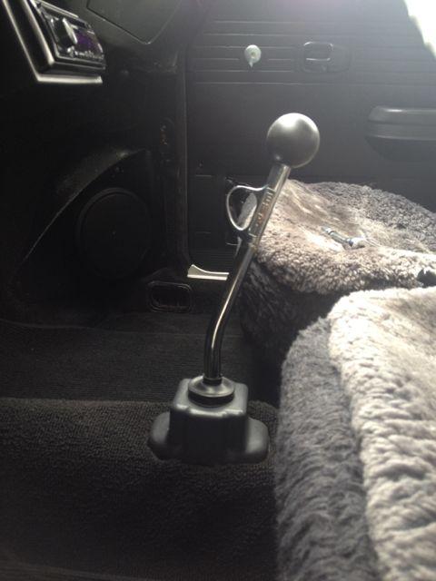

PostPosted: Sat Apr 04, 2015 1:22 am    Post subject: still playing Reply with quote
little by little, i'm getting details attended to and checking it over prior to inspections. yesterday, my little helper (10 yr old son) and i got the shifter changed from the Empi back to the stock shifter.
after that, i took the seat covers off to see how hideous the seats underneath were, and i was not to be disappointed - they were indeed hideous. they don't sit bad, but they sure don't look right in there. not to mention, they're light grey. i'll paint them black at least for now, but i'll for sure keep my eyes peeled for a set of OG seats for the front. how i'll get them over here once i find them will be a different problem, but i've got me some "idears" about that.
now i've gotta get that horn working, and then have a look at those weak rear brakes. my brake warning light is coming on when i step on the brake pedal, can that be caused by poorly adjusted/worn out brake shoes on the rear? or am i looking at changing the master cylinder in the immediate future?
anyway, piccies!
take care,
-dan

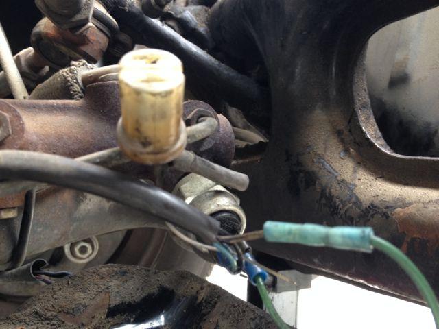

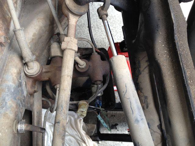

now i'm confused about something else.
according to the vin, my car should have been built around the middle of December in 1968. however the fuse box i have has the horn fuse in the fourth position from the left, and the black and yellow wire to the horn comes from a 3 way connector in the frunk.
that's all fine, even though it doesn't seem to match the build date for the car. it's when i took a look at my master cylinder to try to begin to figure out why my brake warning light is coming on that it got weird real fast.
i was expecting the 3 prong switches attached to the master cylinder with red, black, and black and red wires going to them. nope.
the middle prong on each switch has nothing attached to it. on the front switch, i have a black wire and a blue wire together on the left prong, and what looks to be a gray and red wire attached to the right prong.
on the rear switch, i have what looks like a red wire on one prong, and a blue wire on the other prong.
i also have a two prong plug wire tied to the brake line that has a red wire and brown wire running to it, and i have 2 more wires, a black one and a black and red one, hanging loose attached to nothing.
from the 3 way connector in the frunk, i have the right black, red, and black and red wires coming out and running down toward the master cylinder area, but i haven't been able to make sure where exactly they go yet.
the master cylinder itself doesn't appear to be either of the ones that the Bentley manual shows on page 9 of chapter 2.
one more piece to make this all even crazier, my tail/stop lights all work correctly.
if anyone could shed a little light on any of these things, i would really really appreciate it. eventually, i'd like to put the car back to what it should be, but i just don't know where to begin immediately.
here are some photos so you folks can kind of see for yourselves:
take care,
-dan

PostPosted: Thu Apr 09, 2015 8:27 pm    Post subject: Re: horn Reply with quote
take care,
-dan
The reason the MC doesn't match, is because it's been swapped out for a 70.5 to 73 unit (the 68-70 are NLA). The MC you were expecting to see looks similar to a pump action shot gun, and were a problem even when new. The lower unit on those housed the brake light switches.
On your later unit, the switches screw into ports drilled into the unit itself (more like normal VW MC's). Normally the newer style set up had 3 prong switches, but the PO must have used 2 prong units for durability, along with elinimating the warning light set up. You could always swap a 3 prong in place of a 2 prong, and wire up the warning light with it (to pass inspection IF required).
The extra 2 prong plug tied to the MC is for the original electric fuel pump, used with FI (yours has carbs right?). You can eliminate the wiring feeding the plug, but just know that the wiring goes thru the front trunk wall and up and behind the dash behind the fuse box.
I hope this helps.
Bob 65 Notch S with Sunroof

PostPosted: Fri Apr 10, 2015 12:25 am    Post subject: wow Reply with quote
thanks for the explanation, Bobnotch! that sheds a whole lot of light on the situation and makes a lot of sense. and you are correct sir, in that it was a fuel injected car but now has dual carbs.
now i just have to investigate the wiring to the switches and see where it goes.
btw, they actually are 3 prong switches, but nothing is wired to the third prongs on each switch. so if i find that red wire coming out of the 3 way connector in the frunk and wire it up to those third prongs, i should in theory get a properly functioning brake warning light?
i guess what i'm asking is, if the third prong is not connected to anything, will it cause the brake warning light to come on when you hit the brakes? looking at the diagram in the Bentley, it looks like that red wire that runs from the third prongs to the brake warning switch may be operating a relay which would essentially turn off the brake warning switch under normal operation. then, if one circuit or another failed in the MC, the switch wouldn't be activated, thus not turning off the brake warning light?
