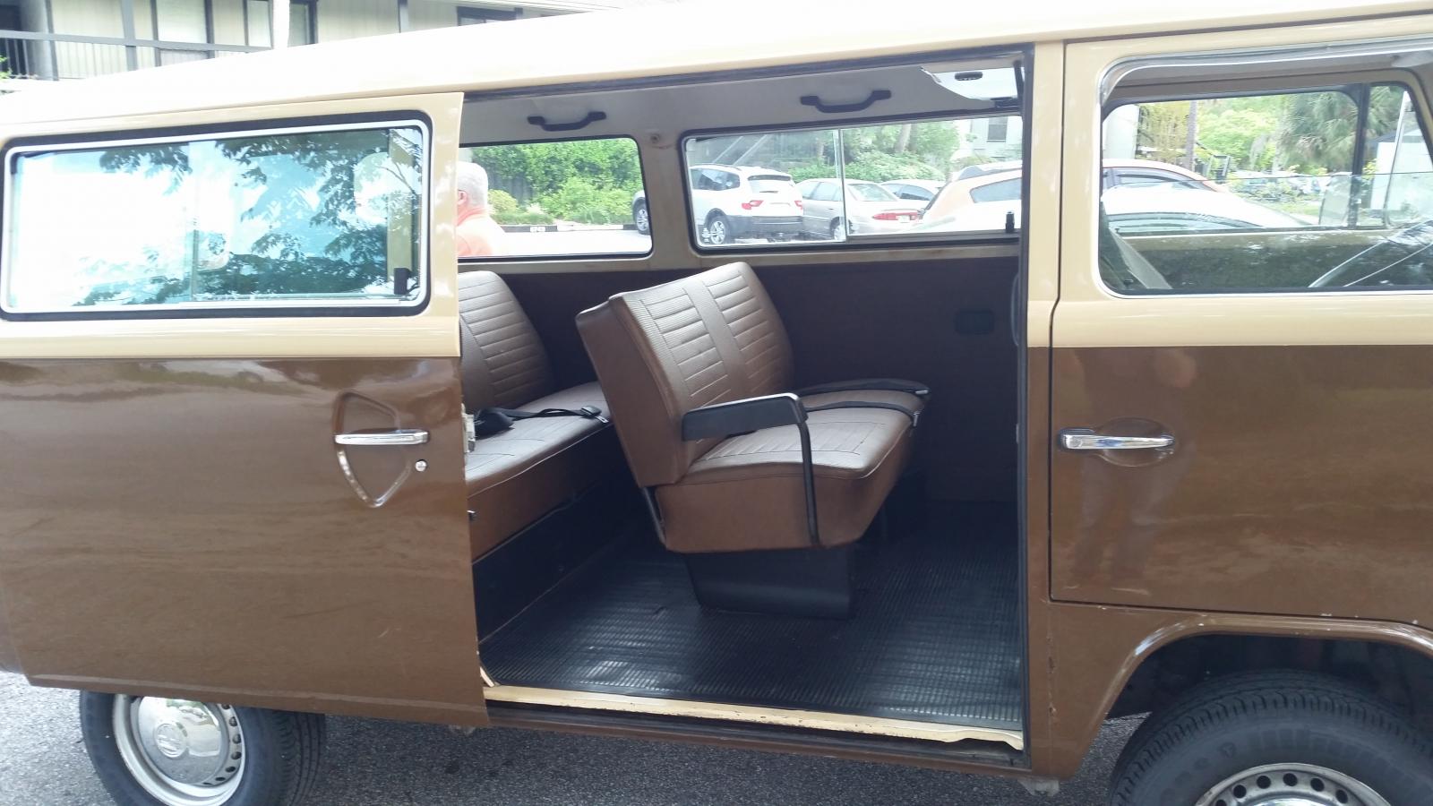

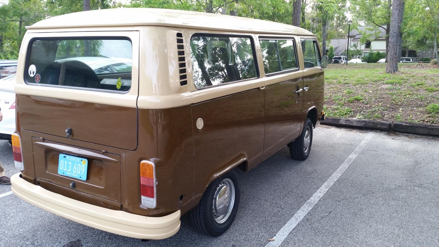

Hey all! I just picked up my 1st bus (last weekend actually), from some pretty cool folks here in town. Cool
Here she is:

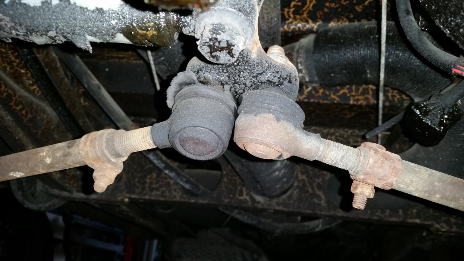

She's pretty solid, and runs well, but she doesn't stop well. I'll be addressing the bad brakes (tie rods and ball joints as well) over the next few weeks/months (and will appreciate any advice you guys have in doing that).
Here are some shots of the underneath:
(there's virtually no rust on the underside. Looks like it was coated by Ziebart).

Nice bus. Looks like you'll want to rebuild those drive axles asap. From the rotors I'd guess it hasn't seen much travel lately. Can you tell us what you paid for it?

Unless you are made of money I think you should do almost all of the work yourself. The following really aren't in a specific order and are just off the top of my head.
1) Tires. As Busdaddy said you probably need to replace your tires. If they have cracks or slick tread for sure. Buses need stiff sidewalls so an 8 ply is best and I prefer the Hankook RA08 185/75R14. Since your wheels are off best to just take them down to a tire shop that can order them up for you. Don't settle for anything else they try to talk you into. Price should be around $450 out the door.
2) Brakes. Better assume that you need new rubber brake hoses front and back. You might be able to have the front rotors skim cut to remove any pitting. Check the front calipers and if they seem stuck you can rebuild them yourself unless the cylinder walls are damaged from water in the brake fluid. How does the brake pedal feel right now? You might get lucky and have a good master cylinder and brake booster. Some new bus owners don't even realize that their power brakes aren't working. Inspect the booster vacuum hose and replace that if it looks original. You'll need about 7 feet of Gates 27231 power brake vacuum hose 15/32 I.D. Test the check valve.
3) Drive axles. Buy yourself 4 ea. boot kits for around $15 each. Remove the axles. Then remove the CV's from the axles. Clean everything. Inspect, reassemble, and lube. Usually doing this now will save a break down later.
4) Cram some new grease into the rear wheel bearings while you can and clean and repack the front bearings if they look good.
5) Steering. This would best be done with the front wheels on the ground. Climb under and have a friend lightly turn the steering wheel back and forth about 20 degrees while you look for play in the steering gearbox, drag link, center pin, and steering tie rod ends. Replace what you find bad then go get a front end alignment from an old tire shop that still does a non-computer alignment $60.
6) Air conditioning. It's doubtful that you'll ever be able to make that a/c work so better plan to remove what you can.
7) Tow adapter. I'd rip that out of there.
Cool Drain and fill your transmission with new gear oil.
9) Get a grease gun and lube the front beam. There are five fittings on the beam that are for this. Pump until you see the grease coming out.
That should be plenty for now. Find a mail order parts house you like and save money.

5) Yea, it had a bit of slack in the steering. The tie rods are on their way, but I haven't checked the drag link yet. No clue about the condition of the steering box yet (altho I've seen the prices on those so I'm hoping mine's still good). Not sure of where the center pin is yet.
