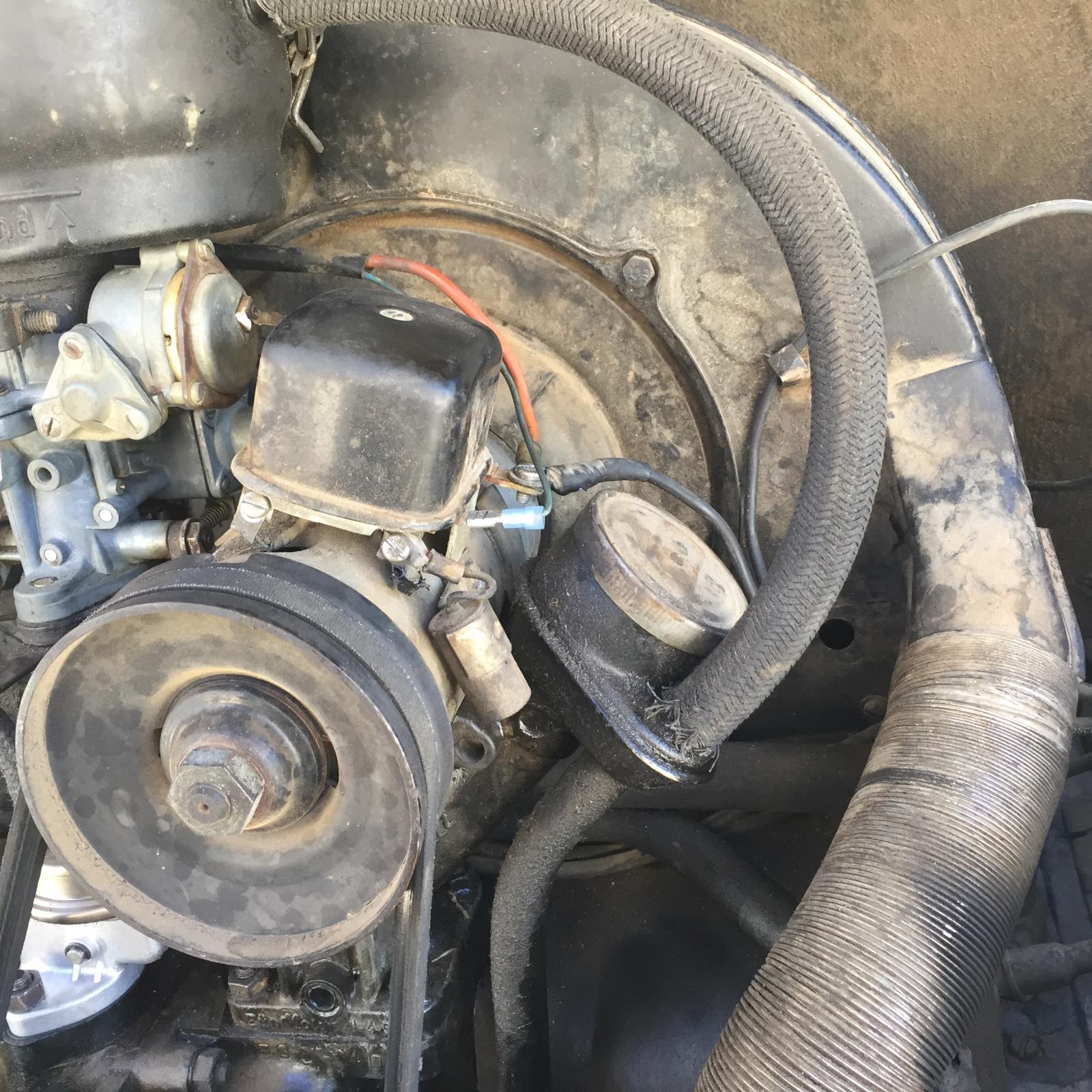

Maybe post a few pictures of your engine so we can possibly spot a wire out of place?

PostPosted: Sat Apr 18, 2015 8:57 am    Post subject: Reply with quote
This is what I've got.

PostPosted: Sat Apr 18, 2015 1:20 pm    Post subject: Reply with quote
someone is going to have fun with this one, i dont have time right now. sorry.

PostPosted: Sat Apr 18, 2015 1:45 pm    Post subject: Reply with quote
Other than being filthy and having a rather interesting throttle return spring setup, things seem to be generally in order. I'd start by cleaning and reconnecting all the wires on the voltage regulator, followed by checking to make sure the generator is actually working, brushes in good shape, etc.
mukluk
Joined: October 18, 2012
Posts: 7452
Location: Clyde, TX
mukluk is offline
PostPosted: Sat Apr 18, 2015 1:47 pm    Post subject: Reply with quote
Oh, and the metal tube for your distributor vacuum advance is installed upside down.
