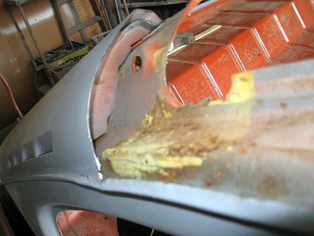

PostPosted: Tue Apr 02, 2019 9:11 am    Post subject: Re: Tell me about the 71 squareback. Reply with quote
'71 Fastback death foam removed:
