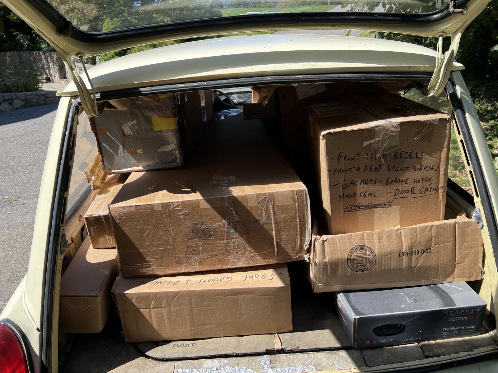

Here is the Squareback full of parts -it has already been delivered to TN

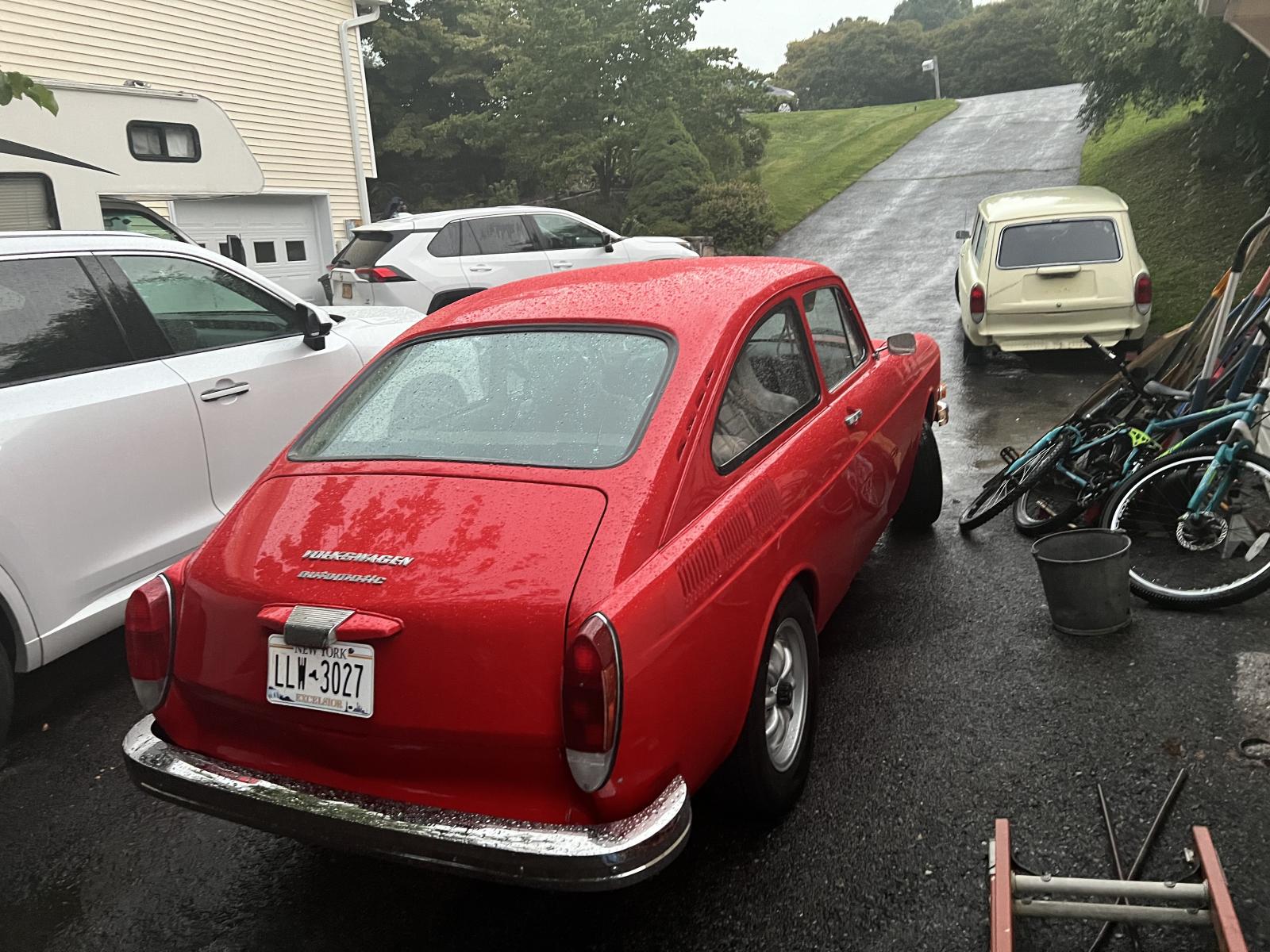

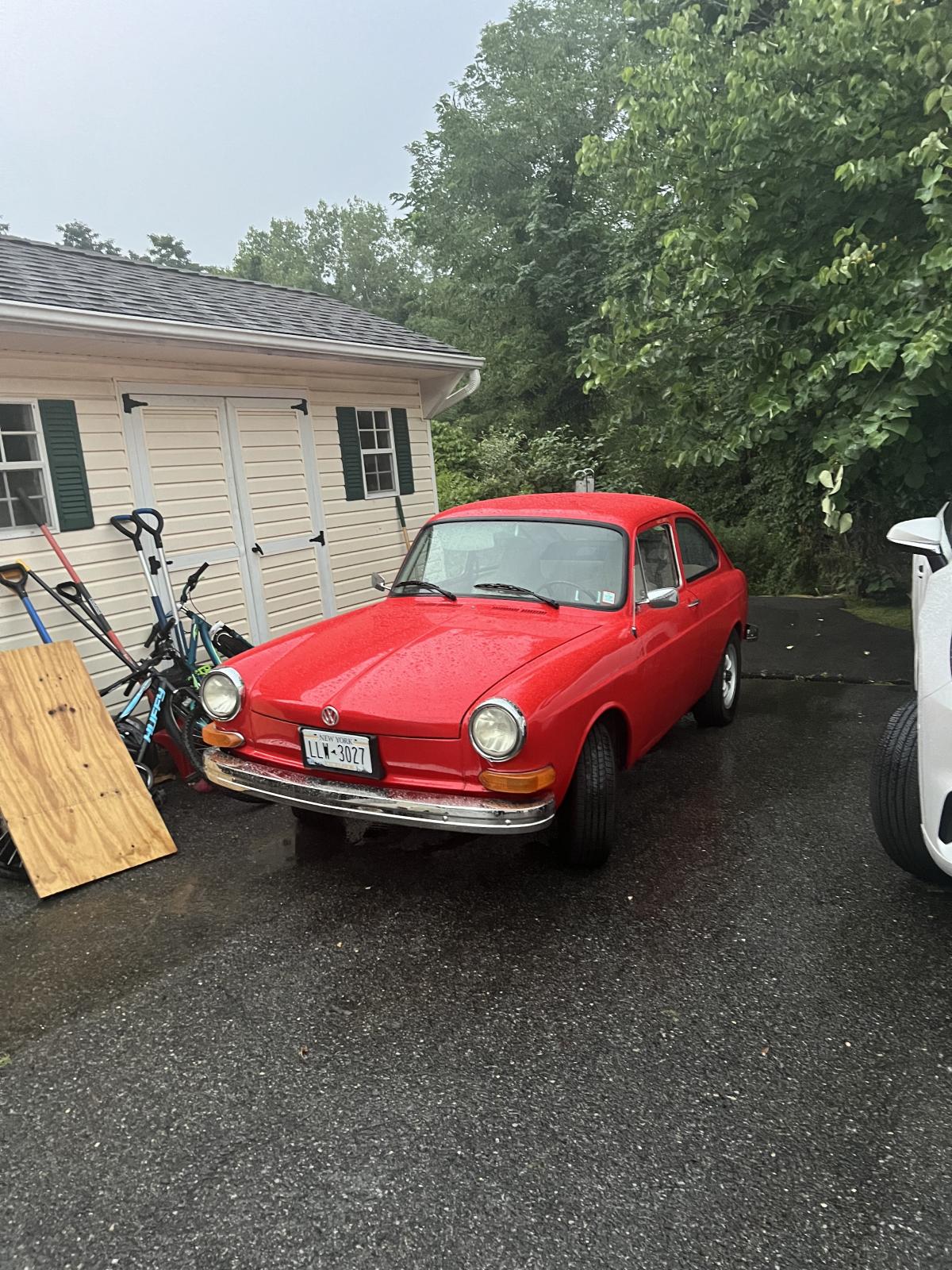

And here is my '71 Fastback-.It is an Automatic-probably the slowest car I have ever driven!
It gets a lot of attention from its shiny non VW color paint job.-It has a lot of rust bubbles under the paint (it's a 10 footer at best)and the guy before me put on these coil-over springs that raises the front and reminds me of a Willys Gasser....
Also some rocket scientist welded the bumpers brackets on to the body-Sheesh!
The interior is very nice though-it's white.
It's too "sporty" looking for my taste,but the price was right-$6000.
I plan on selling it when my Squareback is done.

That could be a twin to my wife's car, except the 4x4 look in the front (her's is dropped 2 outer splines), but has the 8 spokes and AT. I like to think of it as a full body go cart, as you drive it like one (full throttle take offs), since you only have 2 pedals to work with. Her's does have the FI still, which the AT likes. Her car (a 1970) is also Clementine Orange, which looks more burnt orange than bright orange like KT Phil's 71 Fastback.

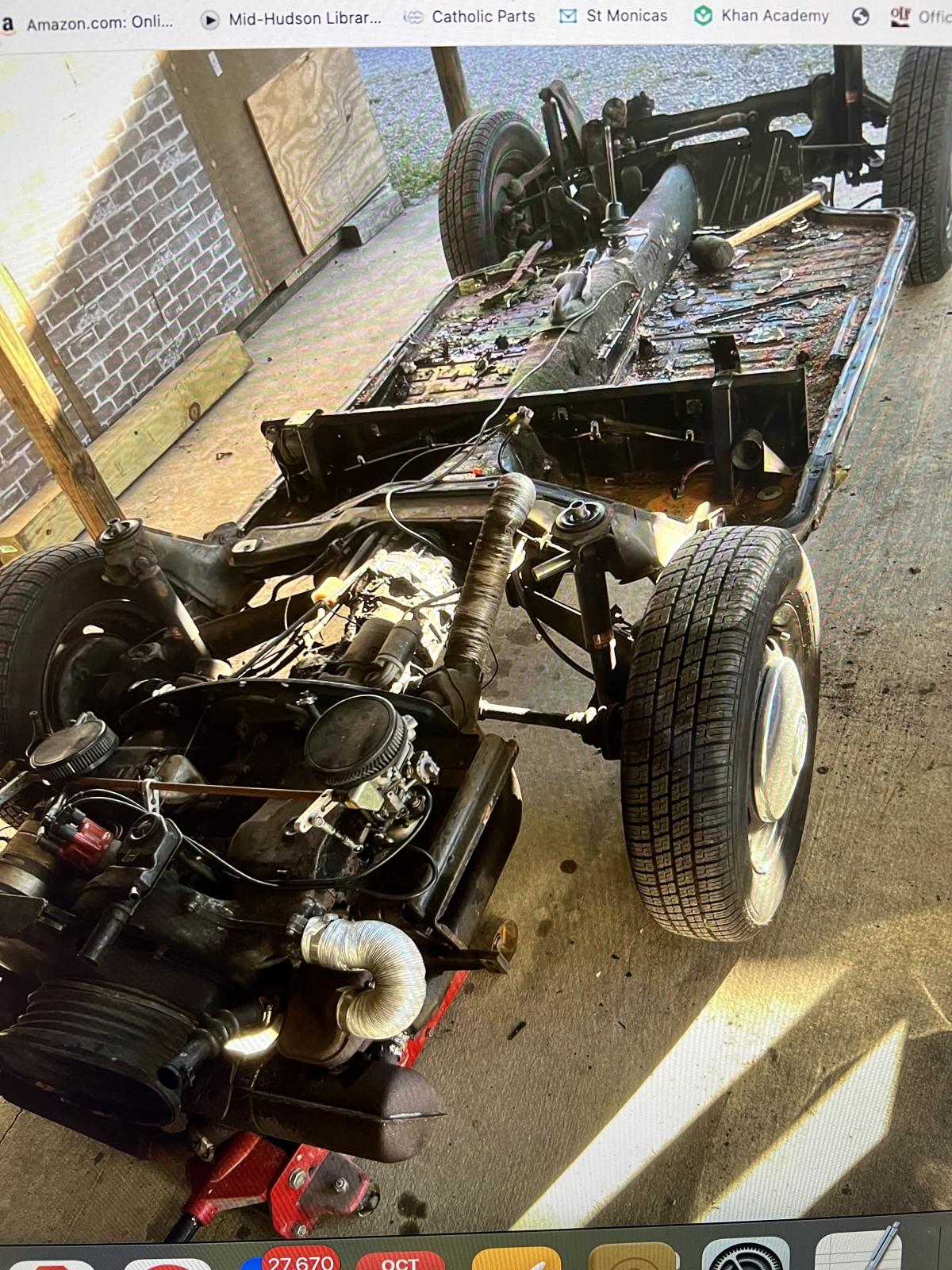

PostPosted: Tue Oct 08, 2024 3:22 pm    Post subject: Re: '71 Squareback build thread Reply with quote
Making great progress at Long Restoration...

Looks like they're making quick work on it. I usually start with separating the body from the pan, and rebuild the pan first (like they're doing). After that it's body work and paint, followed by new seals (windows and body).
Are they polishing the old paint to save it? Or to see any dents and dings? Rust?
We are changing the color to Clementine Orange....
The body is about to be bead blasted to bare metal, then any rust (minor in this case) and dents will be taken care of.
All new rubber,ball joints,Tie rod ends,brakes Steering box,engine transaxle clutch stater motor lines,cables,interior etc.,etc.

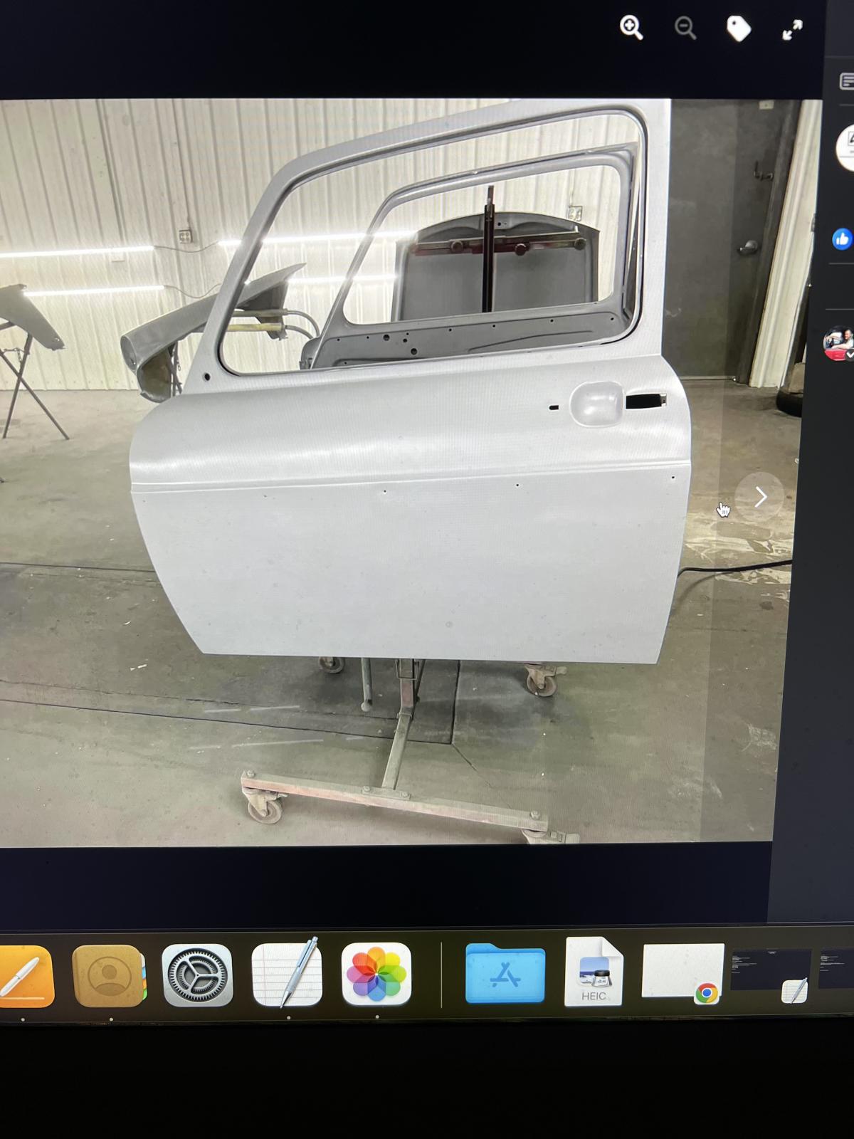

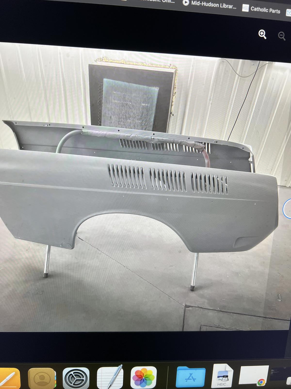

PostPosted: Sun Nov 17, 2024 7:57 pm    Post subject: Re: '71 Squareback build thread Reply with quote
Body and panels bead blasted and primed.
Virtually no rust anywhere on this car.

PostPosted: Mon Nov 18, 2024 3:59 pm    Post subject: Re: '71 Squareback build thread Reply with quote
How's the hump in the front trunk? Just asking as most 71-73's have some rust hiding there (leaves and such caught in the "fresh air system" box. It doesn't seem to matter where the car has lived it's life either, they just seem to go there.
It's perfect-not a speck of rust.

Scotty D wrote:
Wow that’s looking great. Won’t be long until it’s got a fresh coat of paint. Cool
Yes, They let the primer shrink for a couple of weeks and do whatever body work it needs and re-prime those areas.
