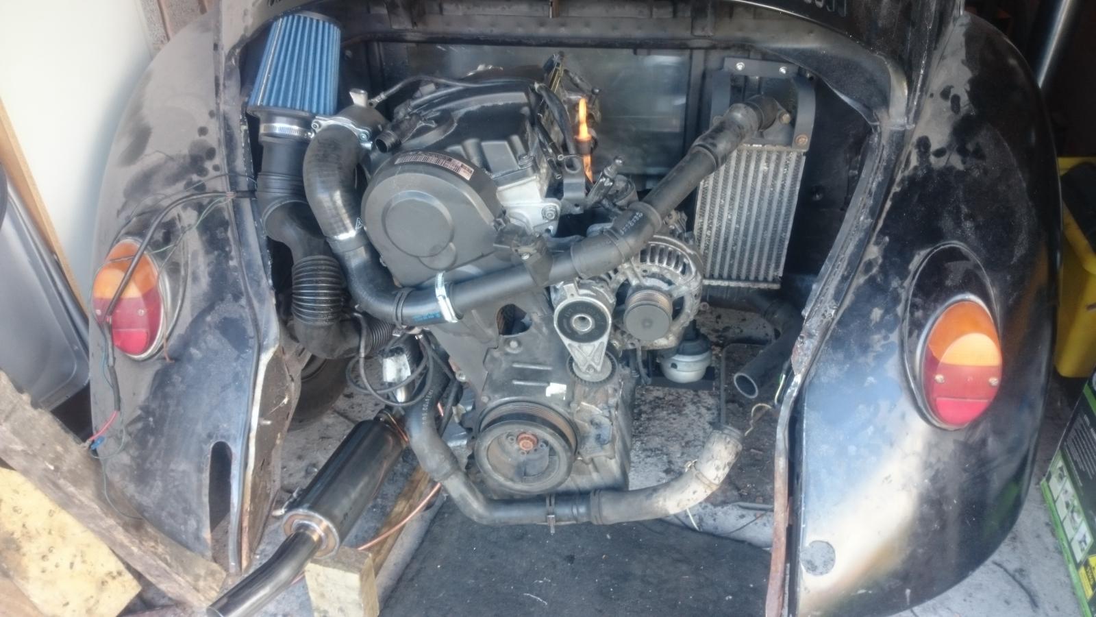

I'll put some up as I do the fenders. I will also start a thread in the readers rides section for my '66. I'm almost finished doing a conversion to the 3 cylinder tdi engine ( it's a long story!)

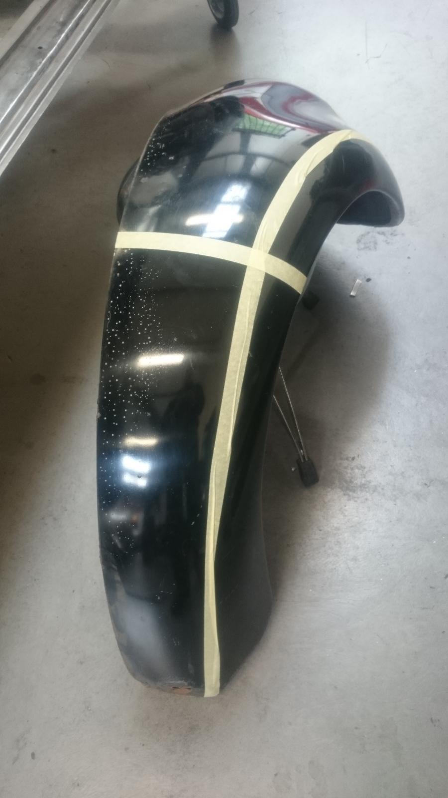

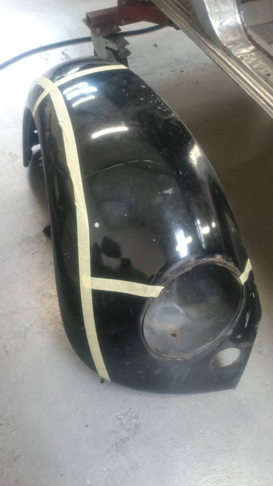

Anyway, I had half an hour free today to make a start on the front fender....

I started looking at dividing it into 5 sections.

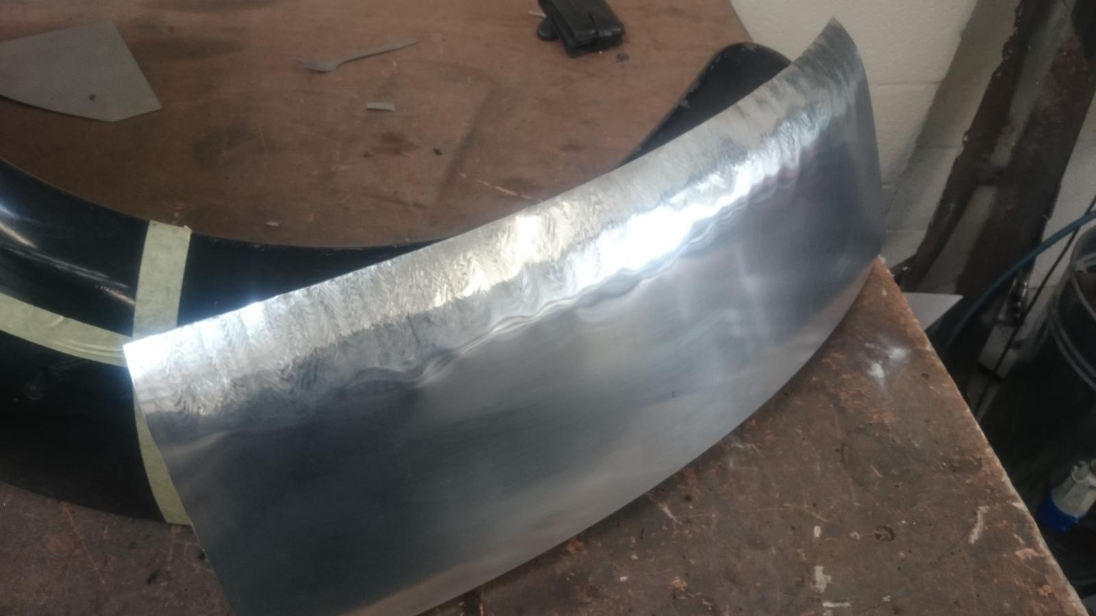

Then I started on the first section. By this time I was running out of time, so rushed it and maybe put a bit too much shape into it Sad
I used a edge shrinker in the power hammer to get a rough shape. Then I'll switch to the English wheel next time I get time
