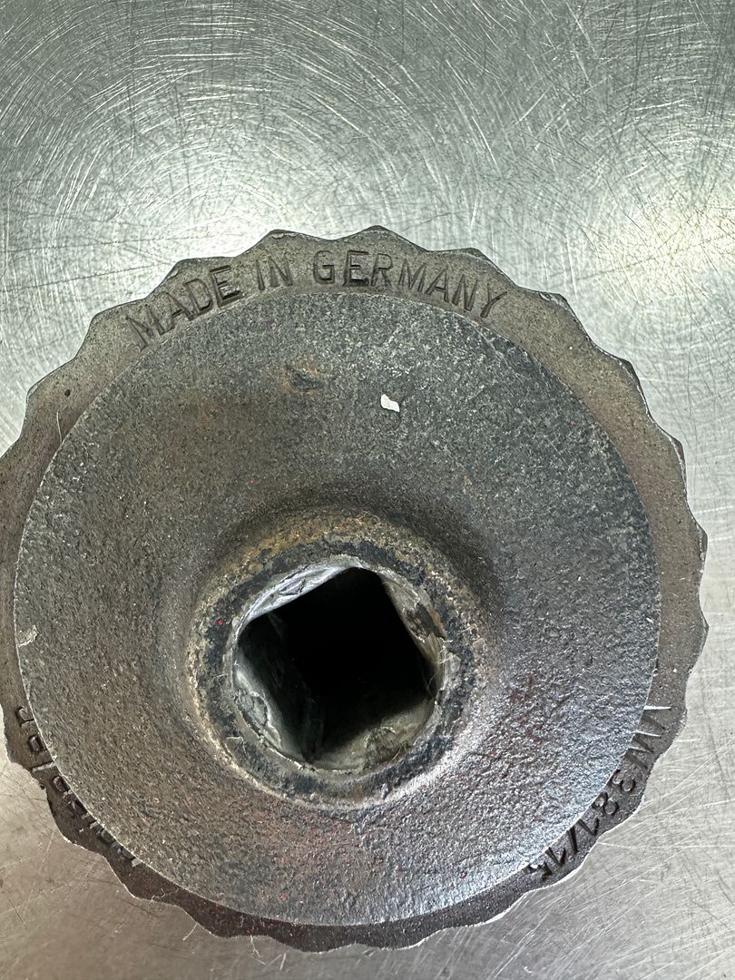

aeromech
Joined: January 24, 2006
Posts: 17612
aeromech is offline
PostPosted: Wed Aug 07, 2024 11:12 pm    Post subject: Re: Final drive seal Reply with quote
I was very fortunate to have been gifted the special tool by our friend Bigbore a couple years back. Very nice of him.
Airbus A319,320,321

Globedog12
Joined: April 11, 2024
Posts: 173
Location: Atlanta, GA
Globedog12 is offline
PostPosted: Thu Aug 08, 2024 6:38 am    Post subject: Re: Final drive seal Reply with quote
Care to elaborate?
aeromech
Posts: 17612
aeromech is offline
PostPosted: Thu Aug 08, 2024 6:45 am    Post subject: Re: Final drive seal Reply with quote
Globedog12 wrote:
Care to elaborate?
Do you want a picture or a step by step on the job?

Globedog12
Posts: 173
PostPosted: Thu Aug 08, 2024 6:54 am    Post subject: Re: Final drive seal Reply with quote
aeromech wrote:
Globedog12 wrote:
Care to elaborate?
Just a picture. I don’t need a step by step I’m just curious about the special tool.
aeromech
Posts: 17612
aeromech is offline
PostPosted: Thu Aug 08, 2024 7:09 am    Post subject: Re: Final drive seal Reply with quote
Globedog12 wrote:
aeromech wrote:
Globedog12 wrote:
Care to elaborate?
It’s early here but I’ll get that done this morning

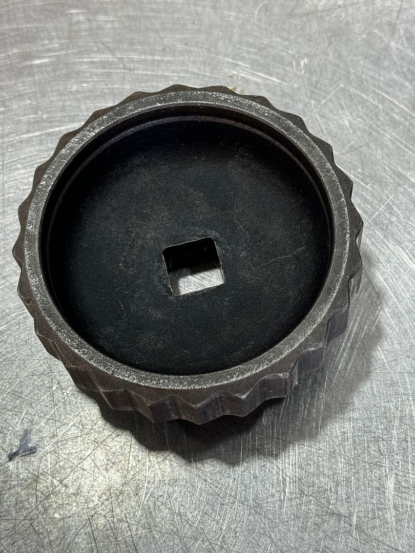

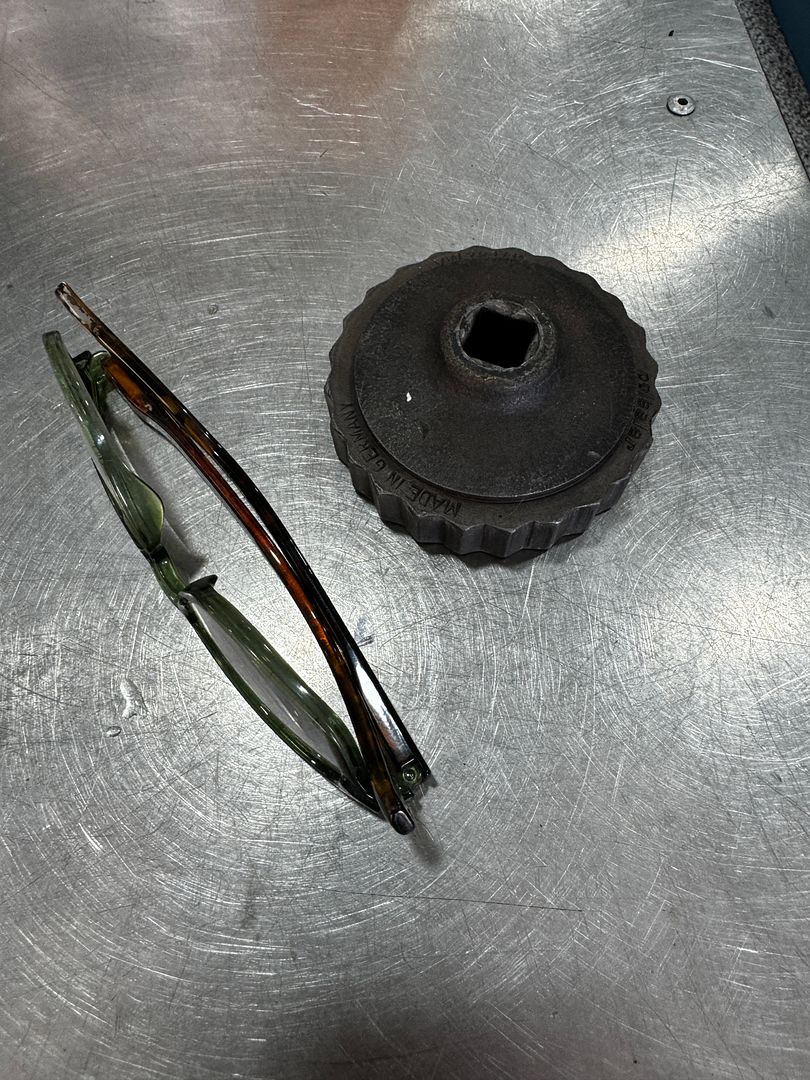

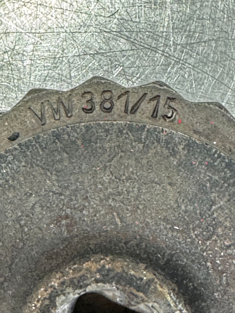

aeromech
Posts: 17612
aeromech is offline
PostPosted: Thu Aug 08, 2024 11:50 am    Post subject: Re: Final drive seal Reply with quote
Here ya go

raygreenwood
Joined: November 24, 2008
Posts: 23088
Location: Oklahoma City
raygreenwood is offline
PostPosted: Thu Aug 08, 2024 11:58 am    Post subject: Re: Final drive seal Reply with quote
Very nice to have. I made q crappy but functional version with a piece of steel plate and an angle grinder and a little welding.

Wildthings
Joined: March 13, 2005
Posts: 52262
Wildthings is offline
PostPosted: Thu Aug 08, 2024 12:46 pm    Post subject: Re: Final drive seal Reply with quote
You really don't need that tool to do the job though, as the seal can be replaced easily without removing the adjusting nut, one just needs a decent seal puller.
If you do need a tool to remove the adjusting nut, they are easy enough to make.
If one does choose to remove the nut, punch marking the position of the adjusting nut before beginning to remove it is a must.

Globedog12
Posts: 173
PostPosted: Thu Aug 08, 2024 2:38 pm    Post subject: Re: Final drive seal Reply with quote
That is a nice tool
