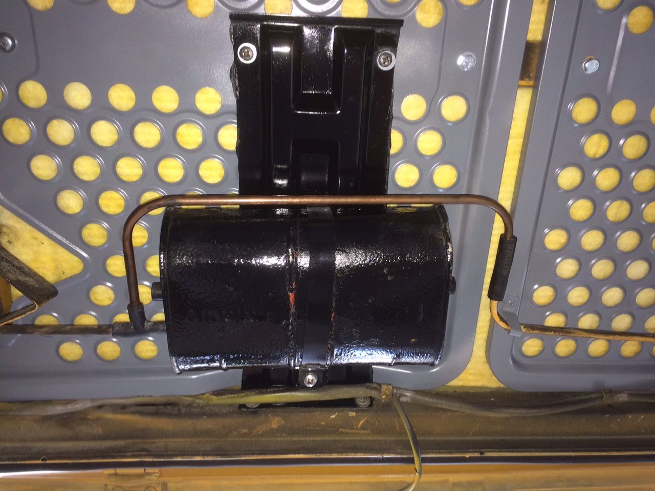

Yes one hose to each carb is totally fine. There is a little network of hoses around the canister on a '72. Also a bent steel tube that wraps around the canister and the rubber tee 211 201 405.
I recommend using the oblong plastic canister that came with the Bus originally. The metal one can work if that's what you have.

Thanks for the reminder and the p/n. As for the bent tube, that's missing but am thinking there's no reason I couldn't use some steel brake line and bend it to suit. As for the canister, turns out a friend has one he's not using so I'm set in that regard.

This is a '72. Yes you could make the bent metal line.

PostPosted: Sun Jan 19, 2025 4:00 am    Post subject: Re: Charcoal canister venting w/ dual Webers Reply with quote
NiCopp is much easier to handle than a steel line and cost less than SS. Available from the jungle. Take a look at your brake lines and see if ordering a spool ( much cheaper than buying by the foot) makes sense
