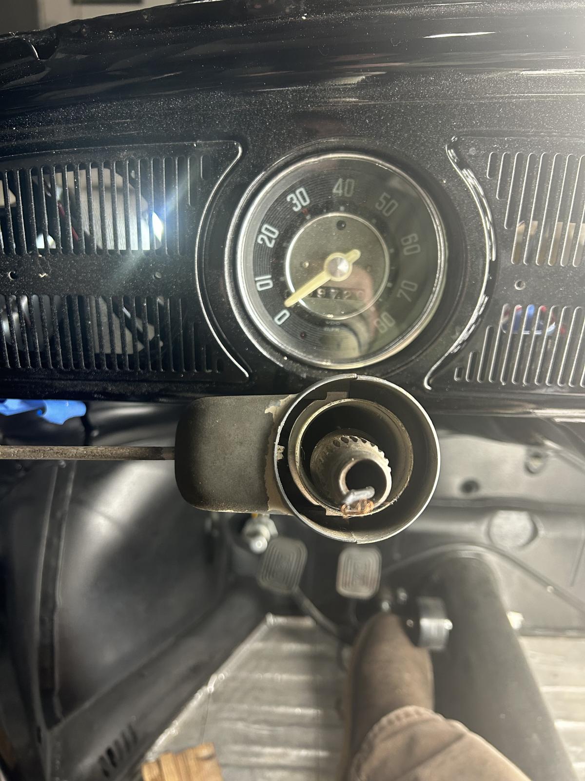

My '62 has a set screw to make final adjustment when the steering wheel is on. The steering wheel and signal switch have to be a certain distance apart for the selfcancel to work. you can see the set screw in this photo of my bug.
