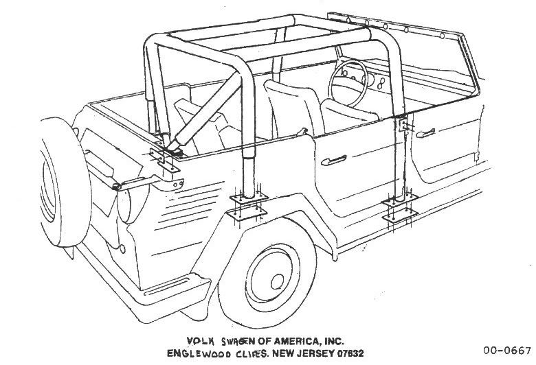

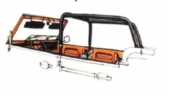

I know this argument has been done before but I believe there was at least 2 different "official" rollbars that were offered by dealers.
This one is the real official one with the official ZVW accessory part number ZVW 148 283. This picture comes off the install directions from VOA
. This is the one that Uber is talking about.
This other one is directly off the 1974 VOA brochure. It looks more like a 4 point and nothing like the "official" one. It could be an artist's rendition of one that never was produced. It doesn't look like the one you have either.
Clearly there may have been several versions of "dealer install" rollbar setups. The design of the rollbar the OP posted is the most common (non-Thing Shop) i've seen.
