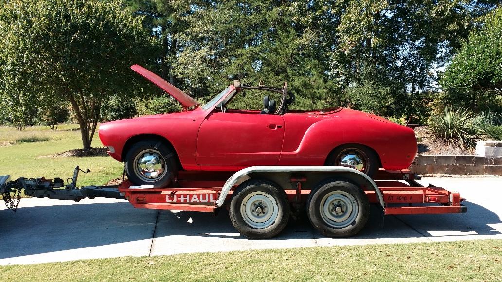

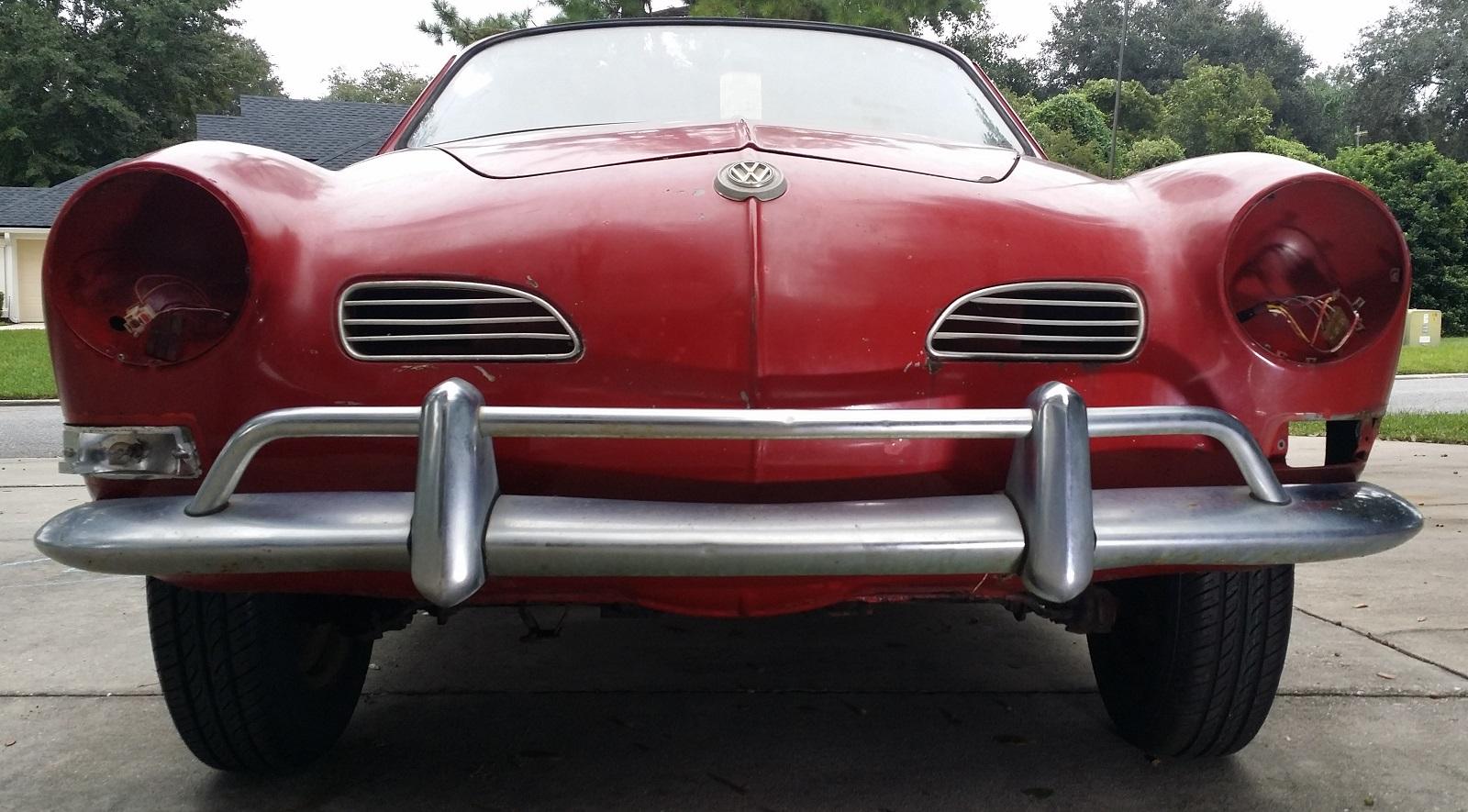

I would like to introduce the (probably) newest member of The Samba Ghia family, the yet unnamed triplet.
She was casually lounging in GA with one of her sisters…
When she was very rudely abducted…
Had a hood thrown over her head to prevent her from disclosing her location if she should manage to get out an S.O.S.
Was transported south on I-75…
And now quietly rests in a garage in North Fl... with out the hood.
More pictures and details to come.

That's what happens when all you have is a Honda CR-V with a 1500 Lbs. towing max. I could have used a tow bar but after sitting in storage for 23 Yrs. (the Ghia not the CR-V) I didn't want to risk bearings seizing at 70 MPH. Embarassed

I tried. They only rent pickups for local use. The cost would have been about the same however. It still cost me less than shipping it. I drove the chase car.

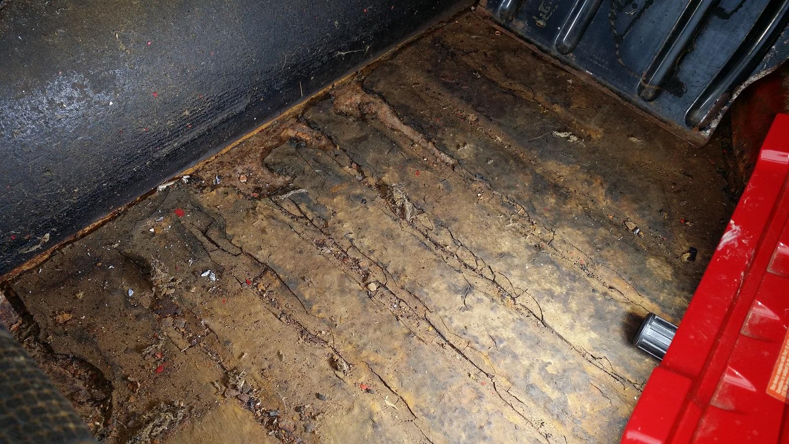

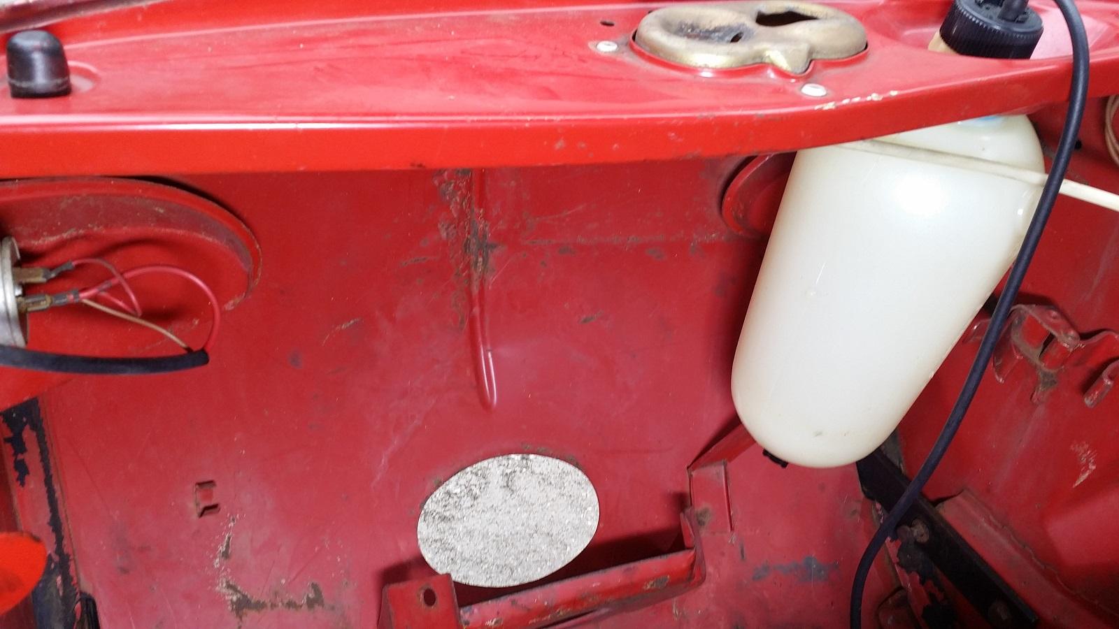

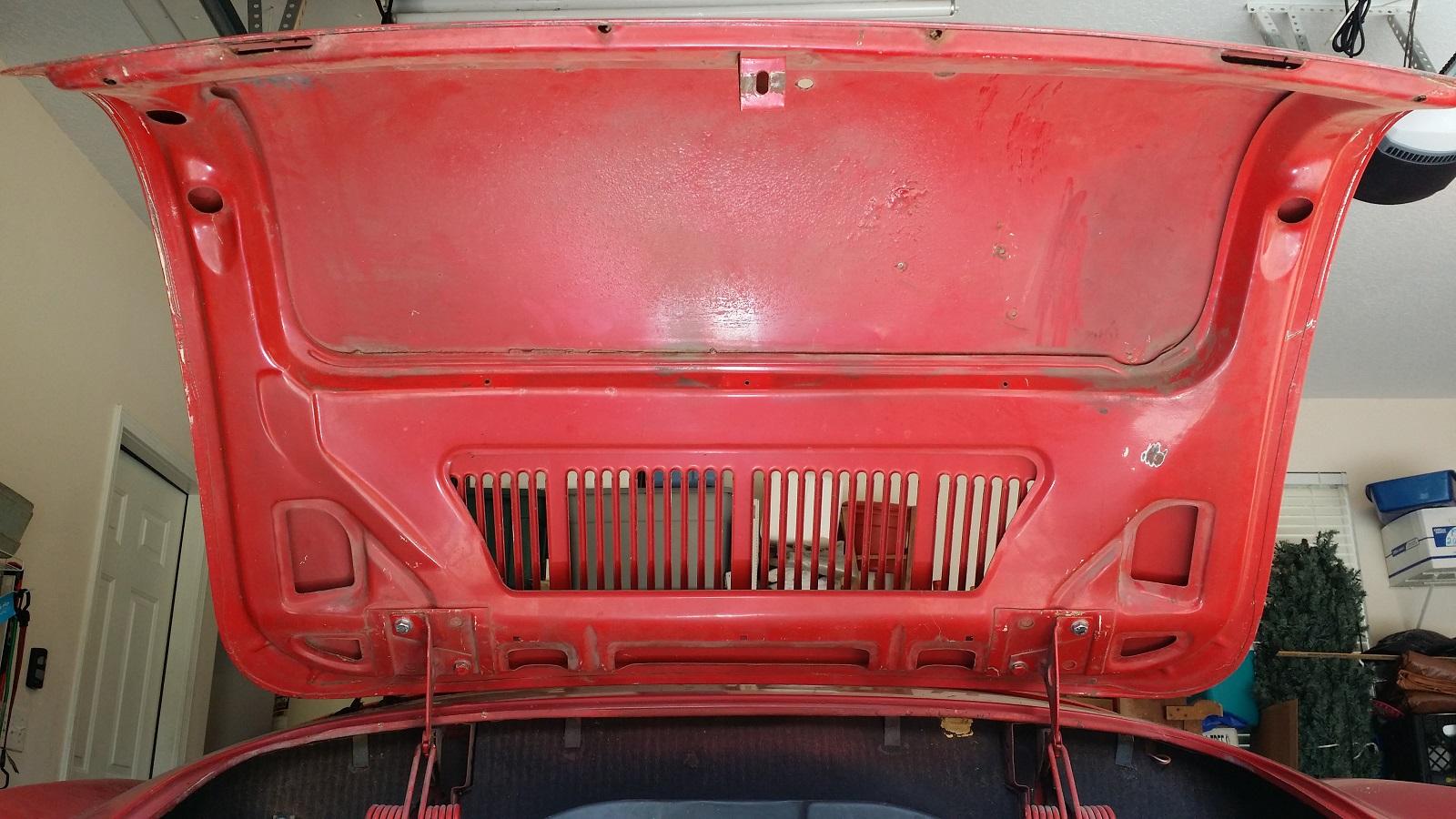

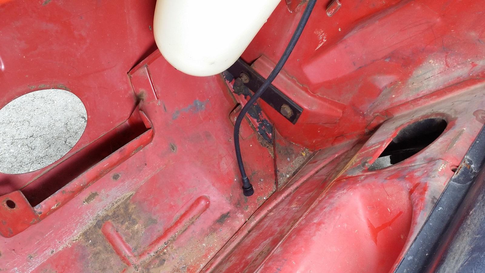

EDITORIAL NOTE:

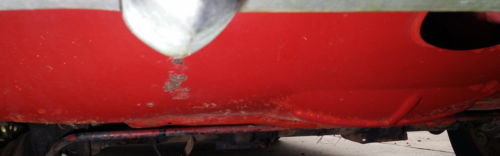

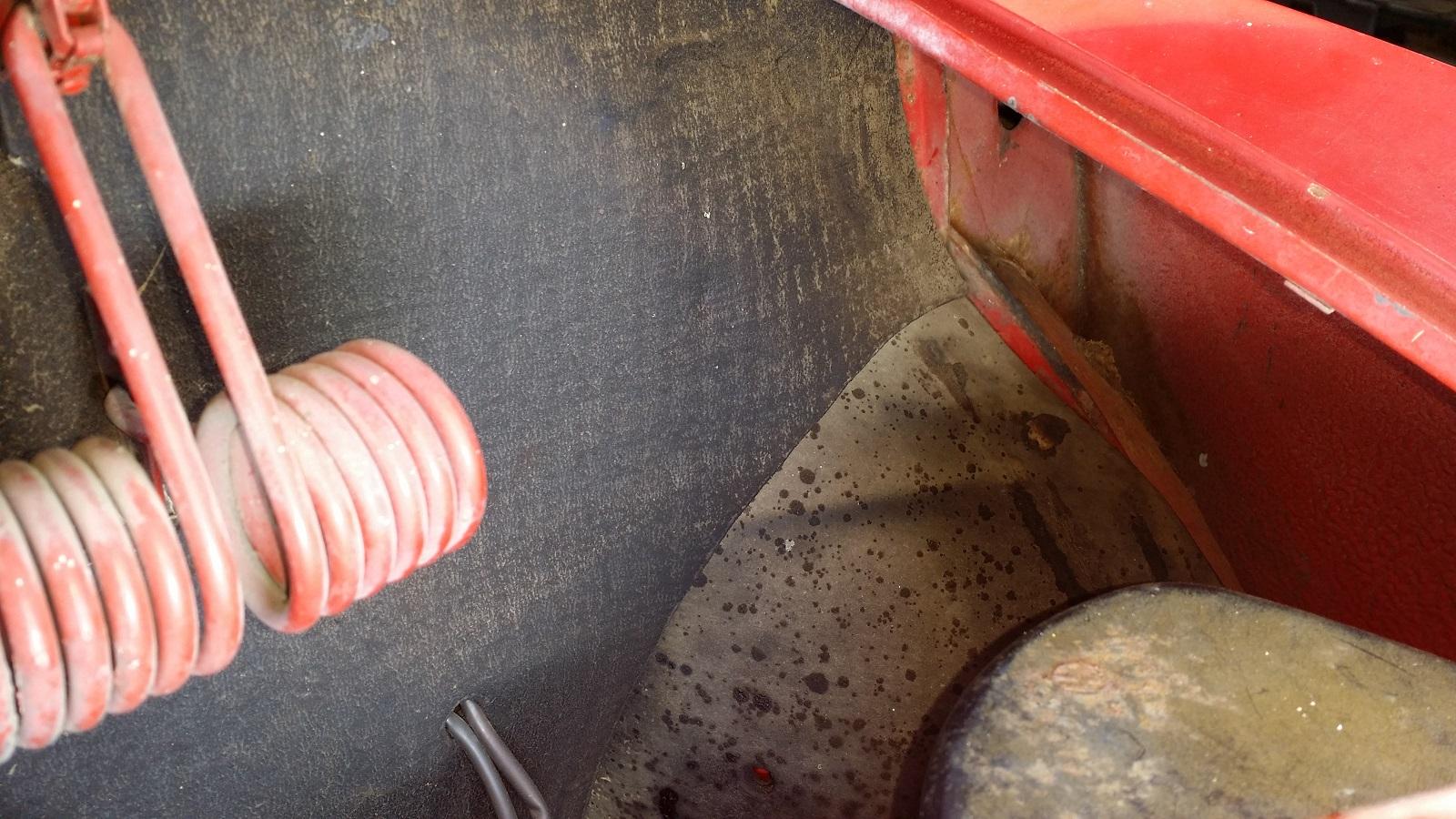

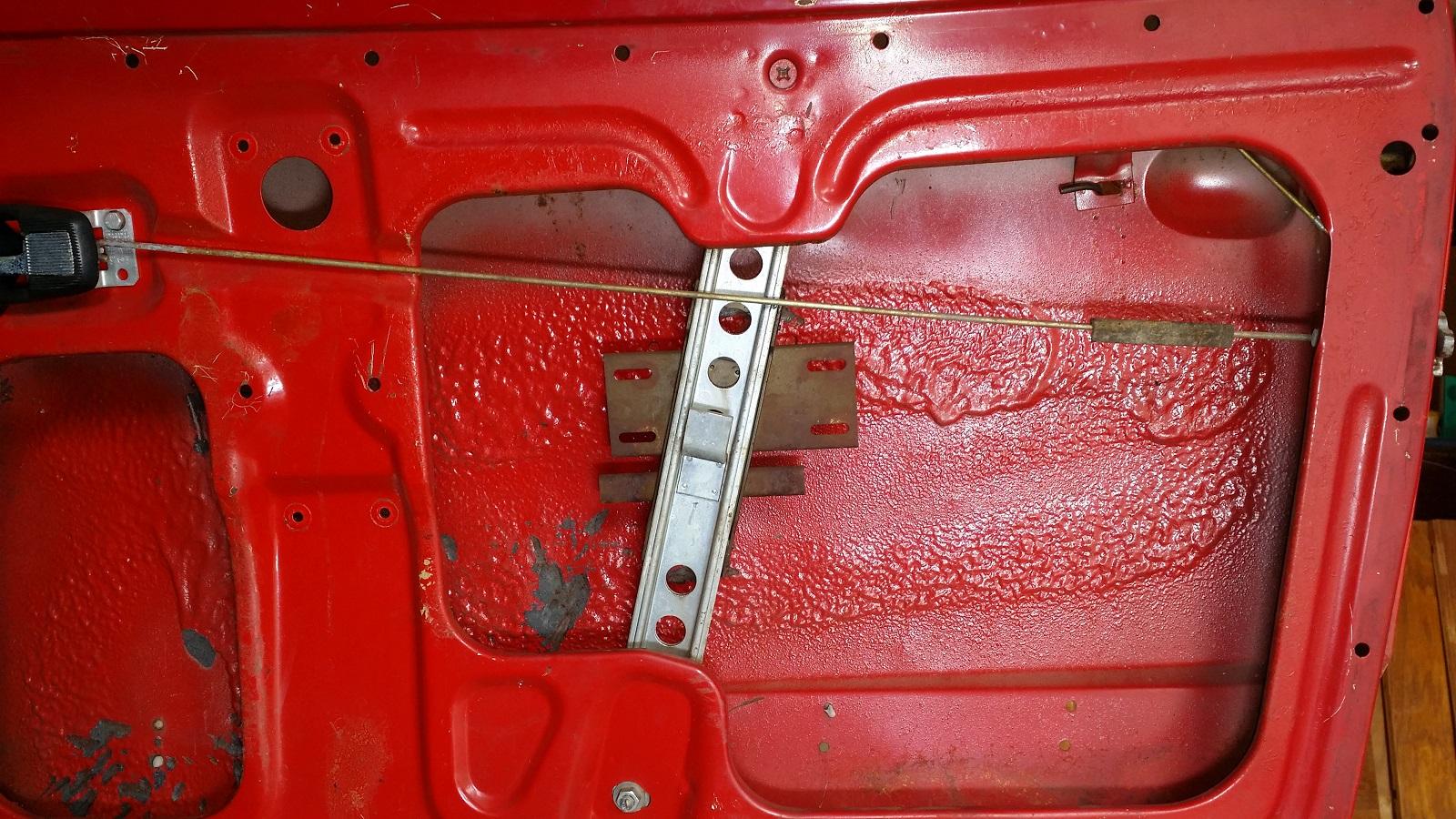

I purchased this Ghia from fellow Samba member vw.dodge. I cannot say enough good things about him as person, and a seller on TheSamba. He was completely cooperative with all my requests for information and pictures, details when requested, and went the extra step of pointing out defects that I failed to enquire about. He is very knowledgeable about these cars. I would not have any hesitation purchasing parts from him in the future.
Thank you “vw.dodge”
Now on to the fun stuff...

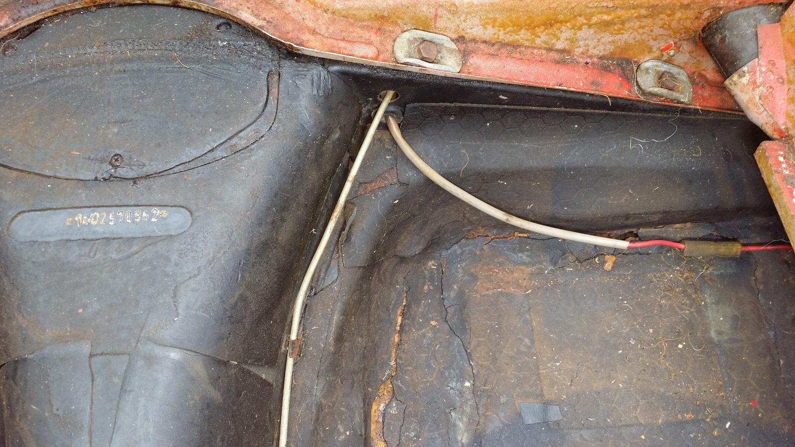

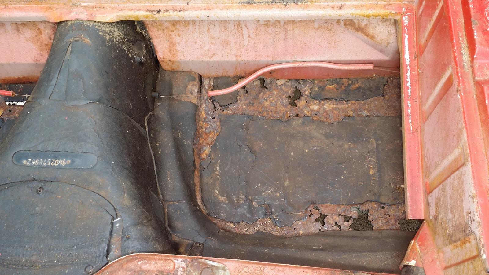

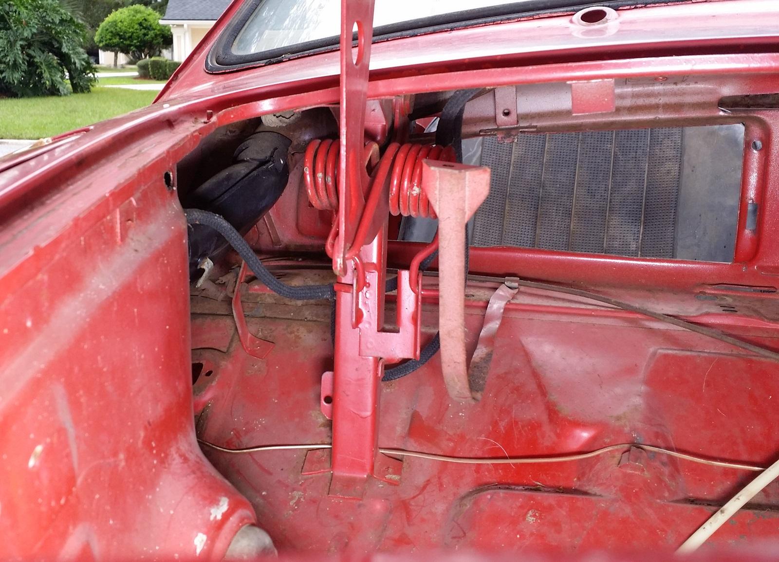

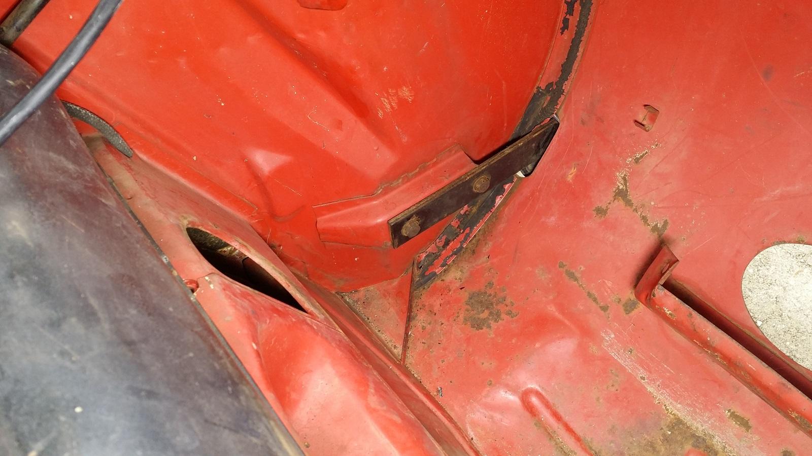

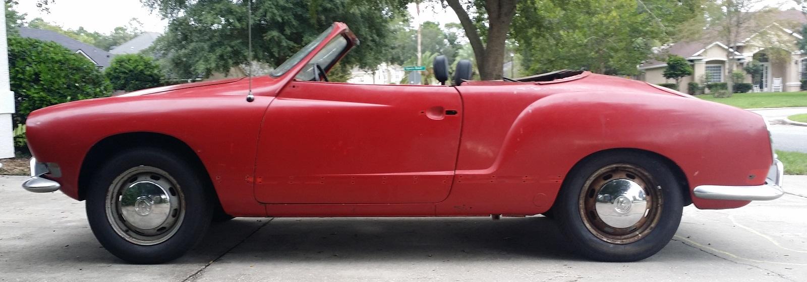

As far as can be determined I am the fourth owner of the car. The car was built on 2-14-70 in Bahia Red with a black interior and black top. It was delivered to Washington State on 2-20-70. From there it is believed the car went to Colorado, then Alabama. The previous owner purchased it in 1992 and it has been in dry storage in GA ever since. I picked it up on 9-19-15. The car is now in Jacksonville, FL.
Edit: I forgot to mention it is numbers matching. Previous owner provided the birth certificate.
On initial inspection the car appears to have a very solid body. The car is straight, free of collision damage(?), and mostly free of body rust. The car has rust in the battery area and luggage compartment. The floors are in rough shape but may not be a total loss. I am told the floor and luggage rust occurred when the vehicle was left out and the top deteriorated. The sale included good metal cut-out parts to repair the luggage and back seat support area.
Most parts, with the exception of tail and front signal lenses, door windows, and rubber parts were included. Carpet and interior are MIA. A full tilt restoration will most likely not begin until Fall 2016 due to pending possible relocation to Central Florida but I will work on it as time permits. Here are some pictures. I have tried to highlight the problem areas in order to elicit feedback and guidance.
Front
Spare well and Bumper brackets
Trunk Area
Under Dash
Doors – inside (Both sides are in the same good shape)
Driver
Passenger (Better detail on these)
Inner Front Lower
Inner Rear Lower
Floor Front Driver
Floor Front Passenger

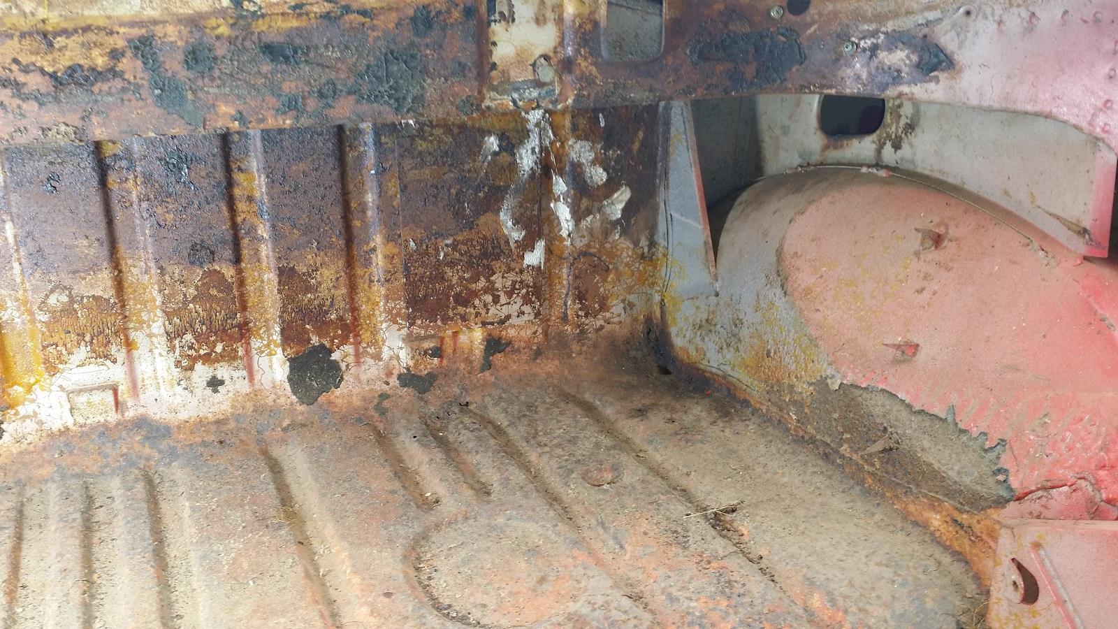

Floor behind driver seat
Floor behind passenger seat
Floor under back seat – Driver
Floor under back seat – Passenger
Rear body/pan mount – Driver
Rear body/pan mount – Passenger
Rear arm rest – Driver
Rear arm rest – Passenger
Cargo area
Upper – Passenger
Upper – Mid
Upper – Driver
Lower – Passenger
Lower - Mid
Lower - Driver
Engine bay
Rear Lid
Battery Tray
Driver wheel well
Driver quarter drop-off (DOH! - picture got rotated when uploaded)
Passenger wheel well
Passenger quarter
Passenger quarter drop-off
Driver quarter drop-off – underside
Passenger quarter drop-off – underside

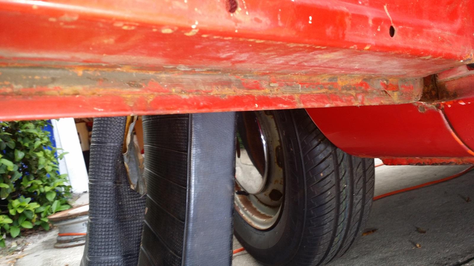

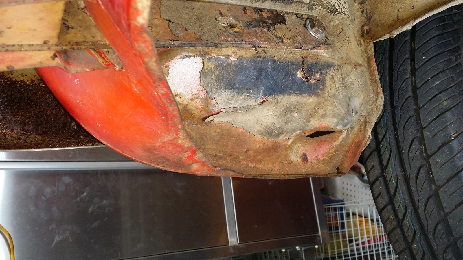

Passenger outer quarter BOND-OH NO!
That’s it for now.
As far as I can tell the only Bondo is in the rear passenger quarter and the passenger door. Once I get my floor jack fixed I will get it up in the air and take wheel well and underside pics.
Feedback is welcome and appreciated. I am not a total novice but I am not totally well versed in KGs either.

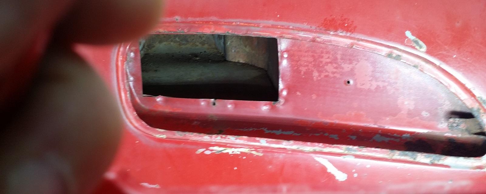

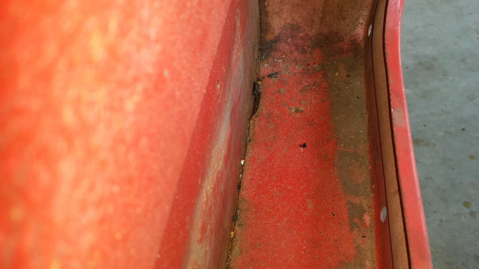

Really pretty good condition overall. You can see in the door pics where the drains are compromised with dirt/debris but caused very little damage. Looks like a good purchase.

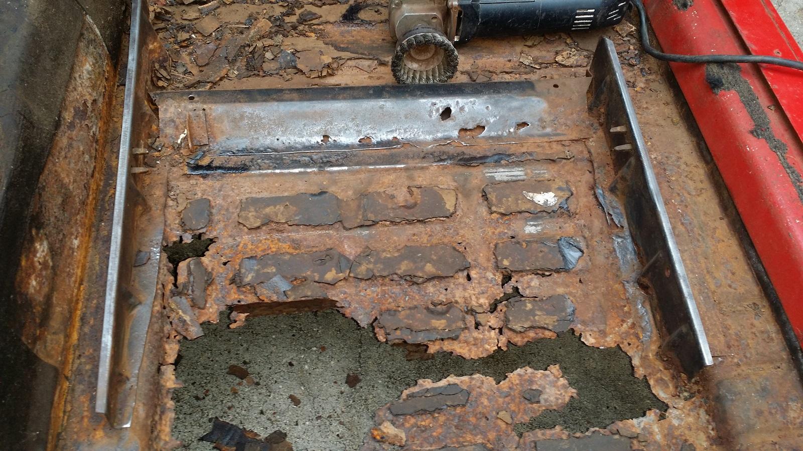

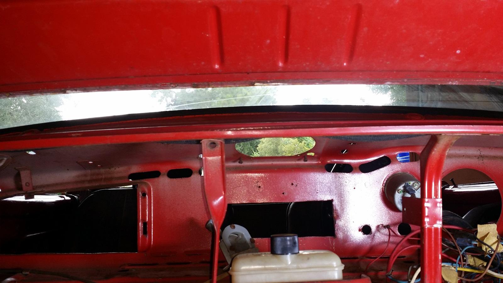

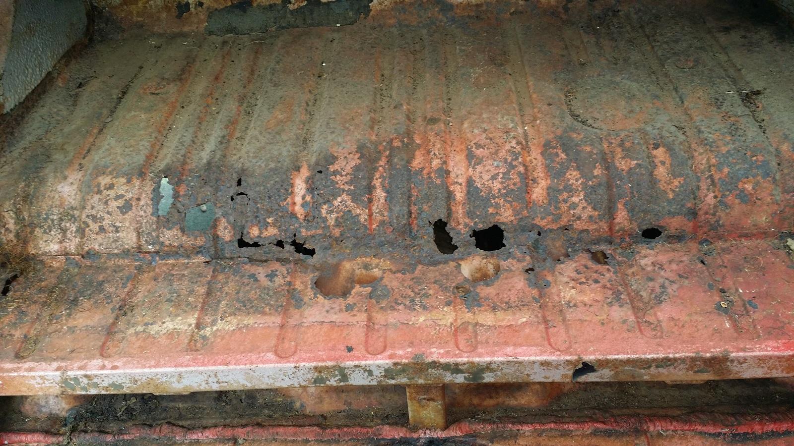

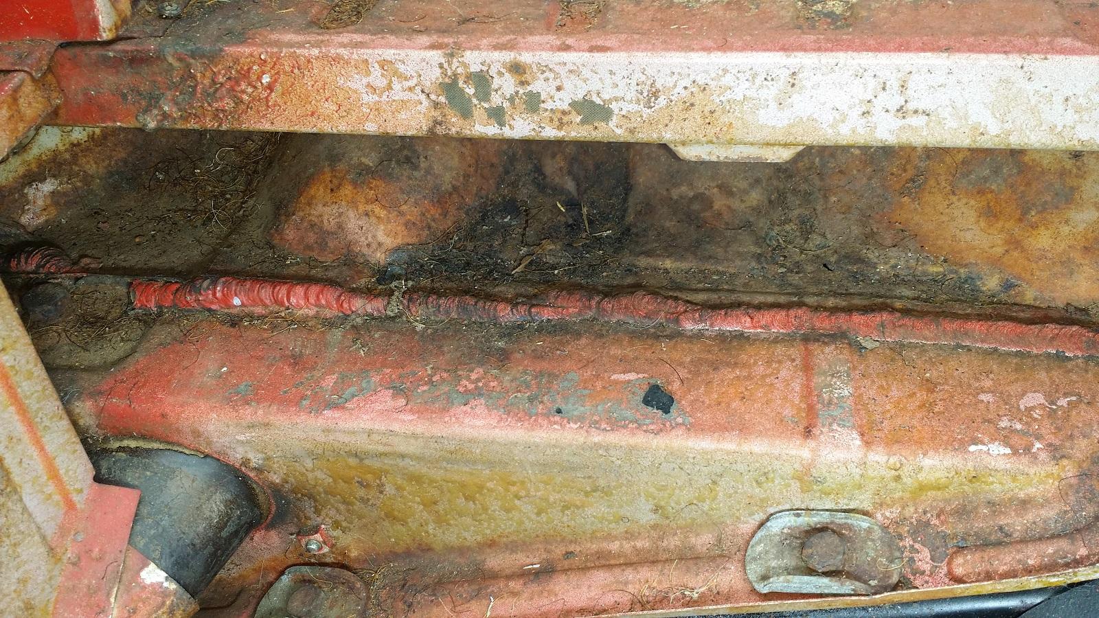

Some more pictures and an update.
Dash (I have a sash patch for the over-sized radio opening)

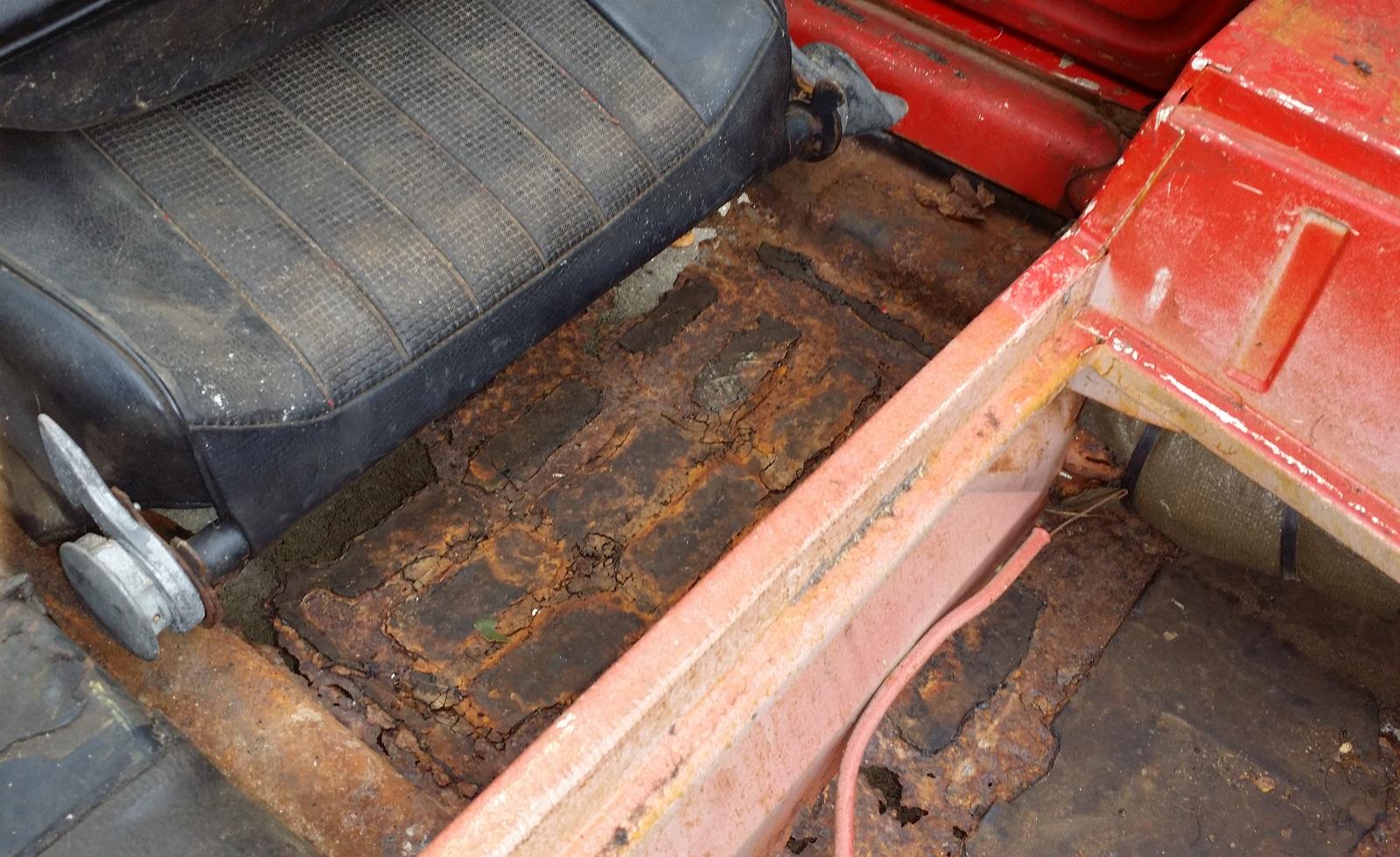

Floor under Driver seat
Floor under Paeesnger seat
Passenger seat cross brace
Passenger seat rail
I was hoping there may be a way to save some of the original floor metal but I doubt it at this point. Could some of the experts provide feedback on whether the seat rails may be salvageable? It looks to me like there is too much degradation of the metal.
Thanks
Emil
Three of the side rails look ok, one is a bit crusty at the bottom but you should be able to patch it. The cross pieces look like they are gone but you should be able to get some replacements made up.
That is good news. When you say "replacements made up" are you referring to custom/manual fabrication or a makeshift replacement piece? Another thing that is giving me pause is how to 1) properly brace them for removal and 2) how to properly line them up and locate them on the new pan. Any and all advice is welcome.
