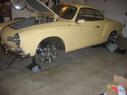

PostPosted: Wed Nov 19, 2008 1:41 pm    Post subject: TIRE/WHEEL SIZE Reply with quote
When I bought her ,
205/60/14,REAR
205/60/13,front, (these are for sale)
front stock beam/drums/adjusters cranked down.
rear unknown.
Currently Keoki 4" narrowed beam/CB dropped spindles/CB WIDE 5 disk brakes,
15" Empi style 5 spokes,
5.5" wide,3.75" backspacing.
rear suspension unchanged ,for now. currently looking for the right tire sizes for new setup. if i were to do it again i would probably convert to GM lug pattern and be able to have more wheel choices.
This is a GREAT thread ,it answers a lot of questions about what fits without all the searching.

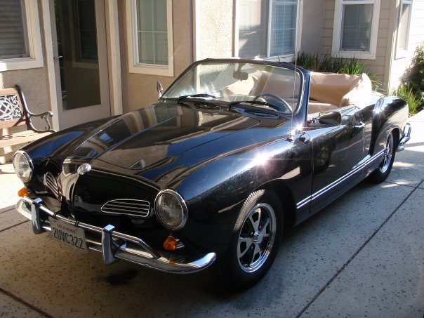

PostPosted: Wed Nov 19, 2008 3:38 pm    Post subject: Reply with quote
66 Ghia convertible, stock height w/ 15 x 5.5 American Eagle 2-liter alloy replicas, 185/65HR15 tires front and rear, 4-wheel disc brakes (CB performance), 3/4" CB Performance front sway bar, Sway-A-Way camber compensator, BOGE fluid shocks front, KYB Gas-A-Just gas shocks rear.

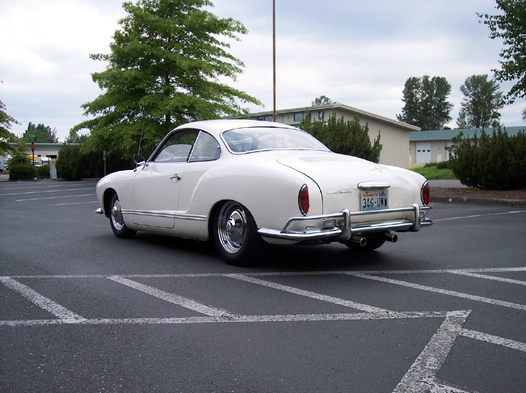

PostPosted: Wed Nov 19, 2008 9:07 pm    Post subject: Re: Tire wheel and suspension thread Reply with quote
1967 Karmann Ghia.
-Tire make and size. Vrederstein Sprint Classic 155 SR/15
-Wheel make, size or offset. Stock VW 15 x 4.5
-Spindle drop, beam narrowed dimensions. Who's make? Brazilian 2 1/2" adjustable stock front beam
-spring plate mods and extensions, number of splines down. Who's? Stock. Inner spline dropped one notch.
-Tubbed, cut torsion, short axle or long axle, swing to IRS, etc.. Stock Long Swingaxle
Tie rod flip kits, caster shims, etc. N/A
-Brakes- disc/drum, type 3 drums out back, etc. - what brand used?
StockDisc/Drum
-shocks/no shocks- what brand. Bilstein gas filled
-If I ever do this again I would have...........Kept the oil filled shocks. The Bilsteins are pretty firm.

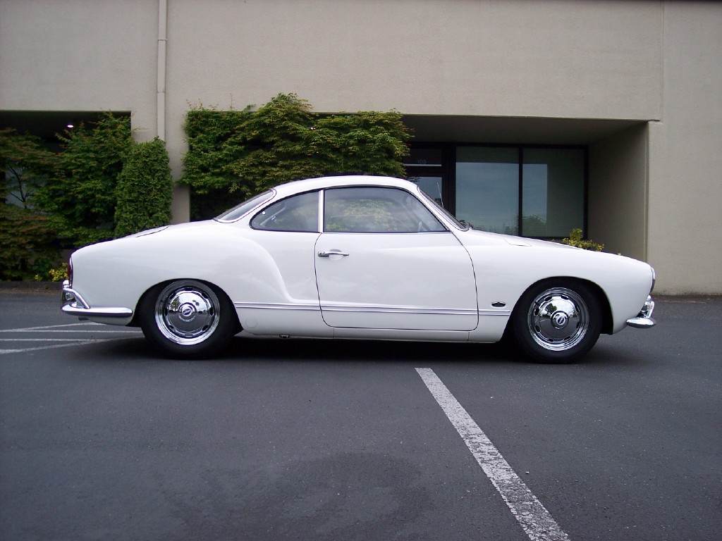

PostPosted: Thu Nov 20, 2008 3:07 pm    Post subject: Reply with quote
scottz wrote:
ok, here's what i did. the beam is narrowed 2". empi 2 1/2" dropped spindles(i here empi sucks now but they claim they don't add track width, and no problems yet!) front wheels are 4 1/2" wide mangels with 4 1/2" backspacing. these made the biggest difference! really tucked the wheel in! front tires are bfg 155/80 15. awesome tire!! the footprint is so close to a 165, but a little shorter and narrower. stops on a dime! Cool the beam has puma style adjusters down 1 notch. bugpack 2" narrowed 3/4" swaybar. no rubbing! Very Happy i really think the swaybar helps with rubbing, i mean, if you're close to the fender reducing body roll is a plus. Razz and its really fun to drive! as for the rear, wheels are 5 1/2" mangels with 'no name' 'wide track' 165 15 tires. (they are fatter than a nankang) ride hieght adjusted 1 notch i think, plus 1 inner on passinger side, to even out driver side sagging. my friend helped with the rear so i will get back if i was wrong. also replaced rear swingarm bushings. oil shocks up front, monroe gas shocks in rear. that's it. rides pretty good. all new balljoints and tie rod ends seem to make it steer a little stiff. only a few hundred miles so far. hope that answers all your questions.
I posted this a while back. Didn't feel like re-typeing it.

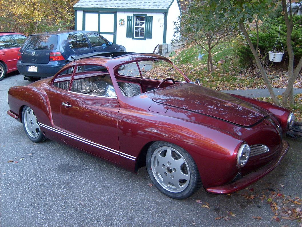

PostPosted: Thu Nov 20, 2008 7:17 pm    Post subject: Reply with quote
-Tire make and size:
Nankang 195/50-16
-Wheel make, size or offset:
Porsche D90 (off an early 90's 944) 16x6, 52mm offset, 5x130
-Spindle drop, beam narrowed dimensions. Who's make?:
CB 2" narrowed adjustable beam (raised to to the top), AC insustries. 2.5" dropped spindles
-spring plate mods and extensions, number of splines down. Who's?:
Notched spring plate, 1 outer spline down, (I think)....everything kinda fell apart when trying to disassmble. Need to get an angle finder.
-Tubbed, cut torsion, short axle or long axle, swing to IRS, etc..:
IRS
-Tie rod flip kits, caster shims, etc. :
Caster shims
-Brakes- disc/drum, type 3 drums out back, etc. - what brand used? :
AC Industries front disc with 5x130 pressed in studs, AC industries rear drum with 5x130 pressed in studs
-shocks/no shocks- what brand:
No shocks installed in the pics, but will be using oil filled for the front and KYB GR2 for the rear.
-If I ever do this again I would have:
Rolled or cut the fender lips and tried to use a stock length front beam. This would allow more turning radius when using a stock style sway bar. Presently trying to find an over the top sway bar that fits, may have to have one custom made $$$$$$$$$$$$$$$$$$$$$$$$$$$$

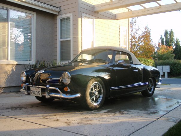

PostPosted: Mon Nov 09, 2009 2:17 pm    Post subject: Reply with quote
Update to my 66 convertible.
Adjustable stock width front beam, 185/65R15s on American Eagle 15 x 5.5 two-liter alloy replicas (+35 mm offset), Sway-A-Way 3/4" front sway bar, Sway-A-Way rear camber compensator, KYB GR2 lowered front shocks and Gas-A-Just rear shocks, disc brakes on all four corners.
