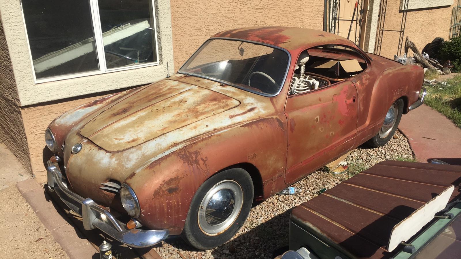

This Ghia popped up here on samba around the beginning of April for a very fair price or trade for a running and driving bug, I just happen have a 1970 bug that I was using as my daily driver for the last year and it was a had never let me down as I went through the mechanics 100 percent making it a dialed driver. He was interested in my bug so I made the 30 hour drive to Norcal to pick up this Ghia and bring it home with me to Phoenix. Now before you say who would trade a lowlight Ghia for a 1970 bug? The person who cares more about the Vw passion and people than the almighty dollar that ultimately runs today's society.
This is a 1959 ghia that has been sitting in a field in northern calfornia since at least 1976. over the years it seems to have had the windows broken out, tail lights and front bullets lenses and chrome rings taken or broken. The dash is all cut up unfortunately and correct steering wheel is missing and dash items there seized up.
It is rusty the pans and seat tracks are toast and will need replaced. The rockers are actually not bad other than mudwasp nests in the front inner fender wells rusted from inside out pretty bad. I will be pulling the body off the pan to install new halfs at some point I will have to post all the rust pictures later.

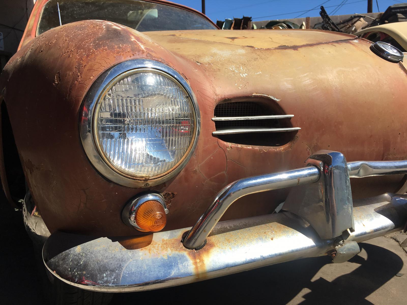

So far in the few weeks ive had it ive found some good og tail lights and both front bullets lenses and retaining rings. Popped out the big dent on the side thanks to my buddy installed 4 solid trim rings and now can stare at it for the next few months while I gather more parts. I will update this as often as I can but for almost daily updates check out my instagram @deluxelowlightghia
As found
On the trailer
Off in the driveway with new friends

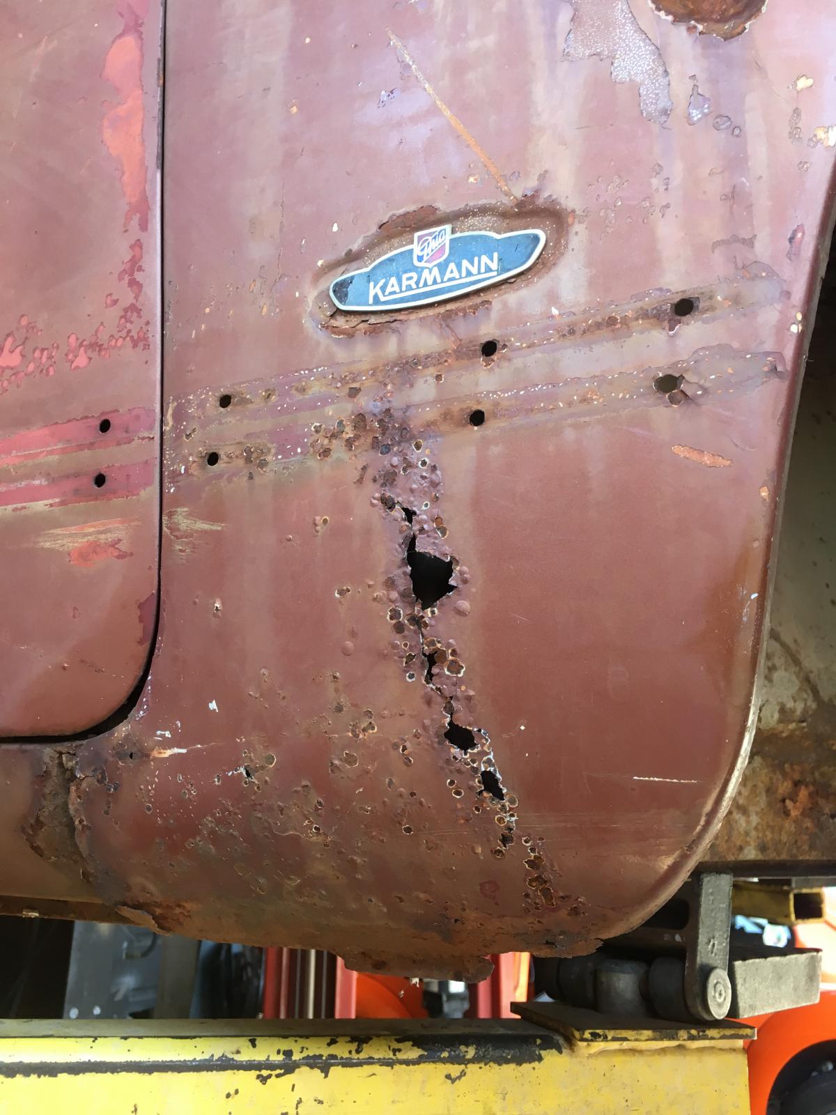

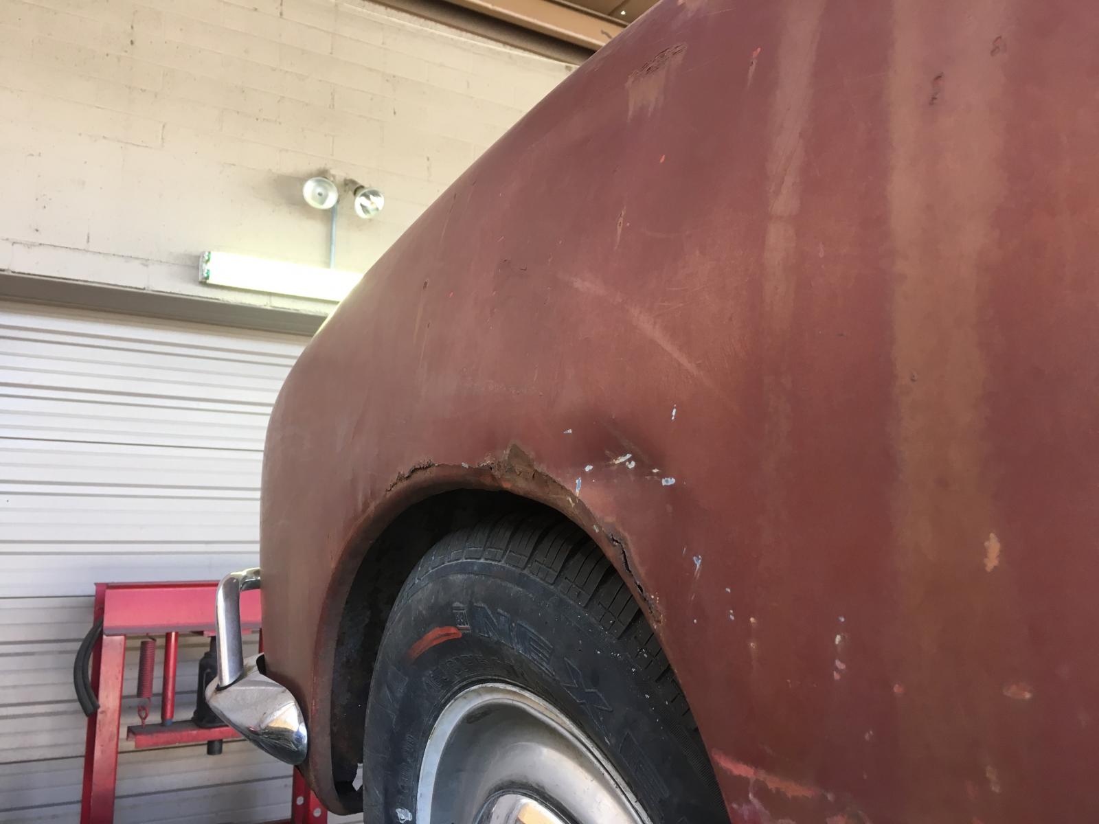

Heres some rust photos
Inner front fenders had mud wasp nests on both sides rusted from the inside out
lower right rear quarter is totally rusted out

For sitting out for the last 40+ years with no windows its not that bad I have seen worse

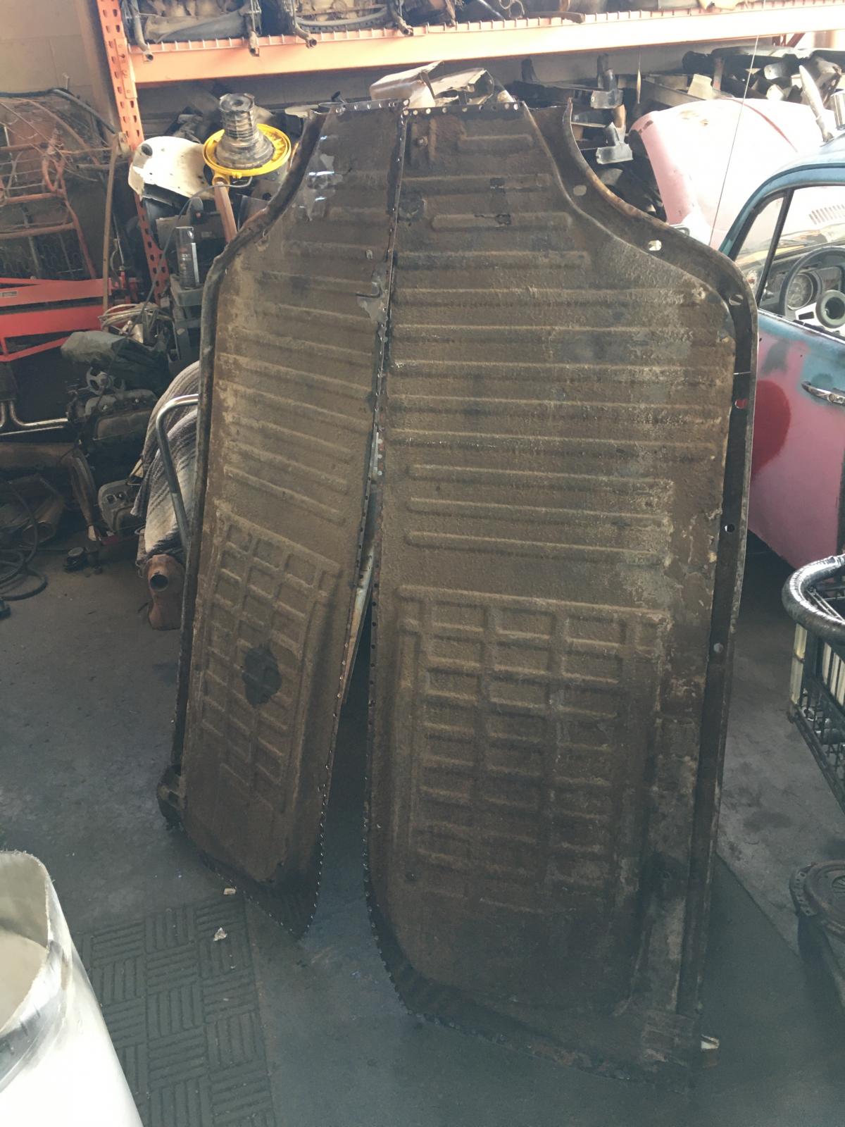

I have now original floor pan halfs and all the glass for this car. It really is a bunch of time I now need to devote to this project and it will be a driver.
