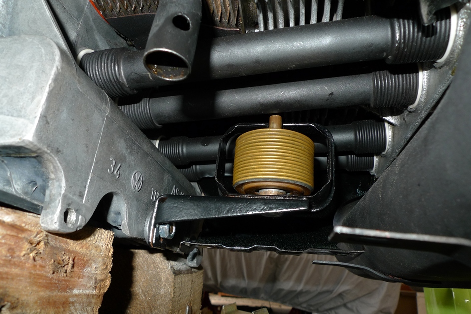

Look under the right cylinder bank. Do you see a bracket with a brass bellows? I'm guessing no. That is the cause of the foam you're seeing. Many years ago, some lame brained mechanic decided that it was so hot in the UK all the time that your engine needed maximum cooling, even in the winter. The result is your engine is now over cooling. The foam you're seeing is the messenger of the problem. Install the thermostat and in her 20 min commute the engine will get up to full operating temp, which will prevent the foam at your filler cap.
I will have a look. Good advice. And i wouldn't describe any weather in the UK as hot.
I recall seeing a bellows type thing undneath but paid it no attention. Is it this?

PostPosted: Mon Nov 02, 2015 1:47 am    Post subject: Re: Oil filler cap spooj / gunk Reply with quote
nocartax wrote:
...I recall seeing a bellows type thing undneath but paid it no attention. Is it this?
Taken from emu88's gallery:
By the way, the crankcase breather is missing the "duckbill valve" in this pic... Wink
Also make sure the flaps connected to the thermostat work correctly.
