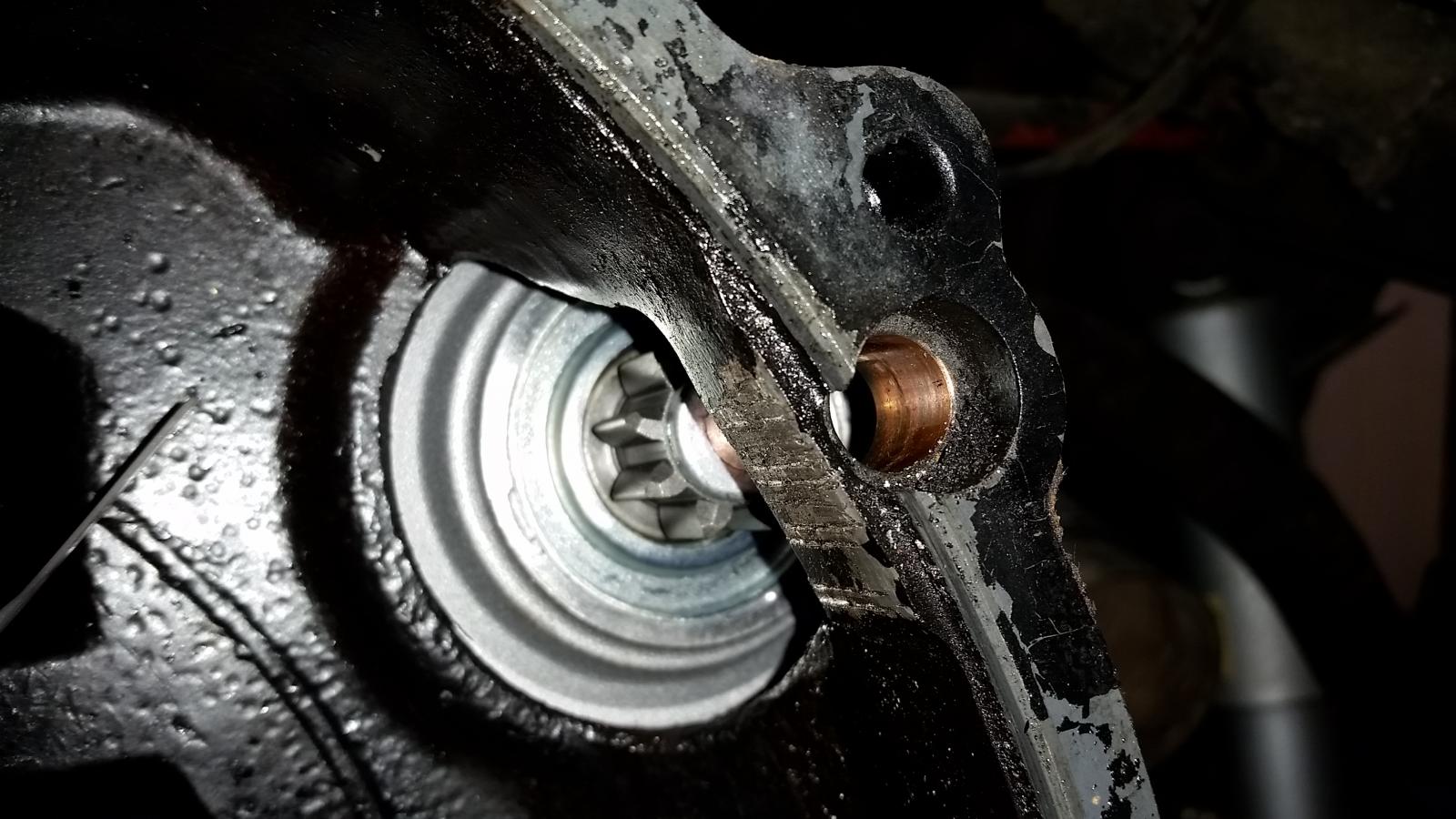

I recently went through the starter question when putting a 12V engine in a 6V transmission. I ended up going with an Auto-stick starter intended for VW Bugs. The numbers are....
Bosch SR-17x
O'Reilly 16300
Autozone 16300
This starter is self supporting in that it does not have a shaft that protrudes into the bushing opposite of it.......pictures are worth a 1000 words.
See how this starter does not need to use the brass bushing? This starter is also supposed to have a little larger HP rating than the standard starter.
This "auto-stick" starter works in all 12V applications as far as I know.
As for a difference between the starters in type 3's in the auto or manual application, I do not know. If the pictures on RockAuto are correct, the manual trans starter uses the support bushing and the auto trans starter is like an auto-stick in that it is self supporting. If that is the case, either starter should work in your application.
Manual starter.
Auto Starter
The auto starter picture looks 100% like the auto-stick starter I purchased. When I search O'Reilly for "3361280" that I get from the Rock Auto site, it gives me the 16300 I mentioned above: http://www.oreillyauto.com/site/c/search.oap?keyword=3361280
I hope this helps. ALL OF MY INFO IS ASSUMING WE ARE TALKING ABOUT THE 68 12V SQUAREBACK.
EDIT: I searched RockAuto for "003 911 023A" and it listed the "16300" I mentioned above.
Bosch SR-17x
O'Reilly 16300
Autozone 16300
Manual starter.
Auto Starter
Yeah, those are the starters I saw at O'Reillys. I was confused because I searched the part number when I got home and a 6V starter came up. Looks like I'm going with the auto starter.
