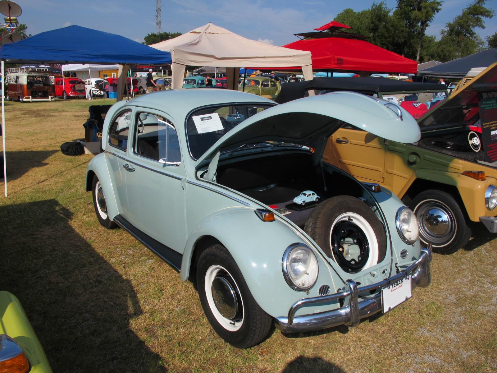

I have restored my '66 beetle sedan and left it stock 6v for now, but having second thoughts because of a starting problem.
My parents had this beetle shipped new from Germany when they came back to the states after military service. They drove a different beetle while they were stationed there but wanted a new one when they left and came back to the states.
I learned to drive using this bug back in 1976 back in Nebraska and drove it every day until around 1987 when I got a new car with air conditioning for the Texas heat. It has been sitting in the elements in Texas ever since. After getting the kids through college and with their encouragement I finally got around to restoring it to its former glory with there help. Started the rebuilding process back in 2017 and had it finished in 2018. Can't take any credit for the body work or paint job, that was done by McGee's Customs out of Dallas. Even took it to a North Texas Dub Splash bug show in 2018.

Congrats on your first post, and that looks like a really nice beetle!!!! Very Happy

That's a nice looking car.
