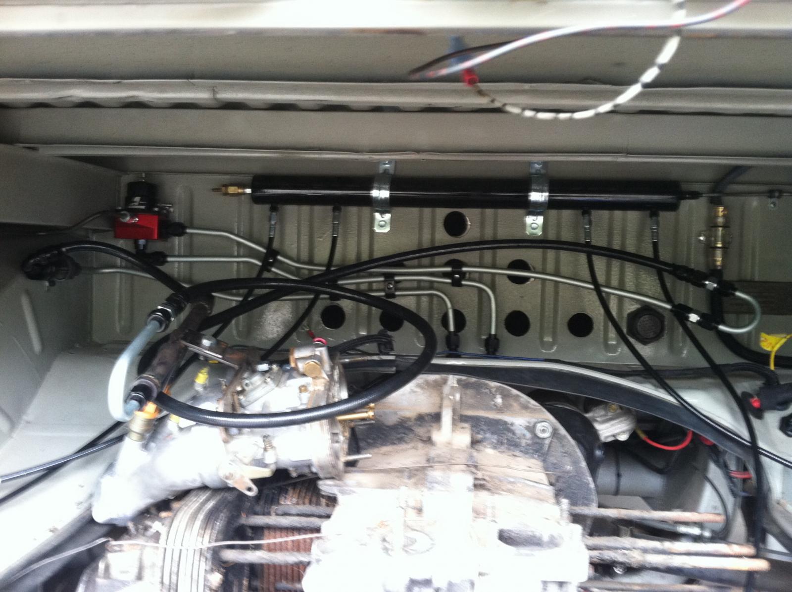

Hey guys, I've got a question about my EFI setup. Do I need, or should I incorporate a way to bleed the air out of the lines? I'm familiar with fuèl injection, but I've never installed a system that I've made from scratch. I'm getting fuel pressure, no leaks but a ton of gurgling and squeeking noises coming from only the regulator. I changed the spin on filter and allowed the tank to drain out of it all the way to the pump inlet. Then I connected to the pump. Do I just run the engine until air goes away?
The regulator is the highest point in the system, but sounds like a whoopie cushion every 10 seconds or so.
I have the return line routed back to the fuel inlet instead of dumping into the top of the tank.
The gauge bounces around when I hear the gurgling but mostly stays around 40 psi.

"I have the return line routed back to the fuel inlet instead of dumping into the top of the tank. "
So the air just runs around.
Look at swirl pots and running a low pressure loop throuh the pot
or simply dup the hot aerated fuel back into the tank.
Otherwise your burps and squeaks may end up with boiled fuel instead and no FI until it all cools down.

The injectors should run a priming pulse when you turn the ignition on. This should purge any small amounts of air out. If its a new motor, you might just need to turn it off and on a few times.

Yes, new everything. I don't have an ECU to connect to the injectors yet. I've just been putting power to the pump in short cycles so far.

i ran it like you did. no problems. it will go away once you purge out the air the first time.nothing wrong with running a tee instead of returning to tank.

There is a reason all manufacturers run an extra hose back to the tank.

I had a system like that, burned up 2 pumps. There is a reason factory efi systems return in the top of the tank

I tried to research the pros/cons of the different returns before I set it up. The main reason I did it this way was the single cab tank placement. It was also easier to plumb into the existing tank drain. I'm using a fuel cell with no baffling so it seemed this method would keep air out of the drain while fuel sloshes around.
I've read that some guys feel the return in the top of the tank aerates the fuel? I tried to keep the lines away from heat and even made the rails out of steel to lessen the impact of heat soak. You can see I even used a Y fitting instead of a regular tee since some guys said the CB system's tee was no good... Hmmmmm...I went overkill on the tubing and hose sizes and used AN to keep flow restriction to a minimum. The pump volume is also ridiculous for my hp level, but that's how I roll. Overkilling the hell out of everything I build lately. Wink carry on

I have almost 12,000 miles on my FI turbo with a fuel tank tee.
I have not had any issue with fuel.......except I am now at 94% duty cycle on my 32# injectors at 22 lbs boost........ Crying or Very sad Crying or Very sad
