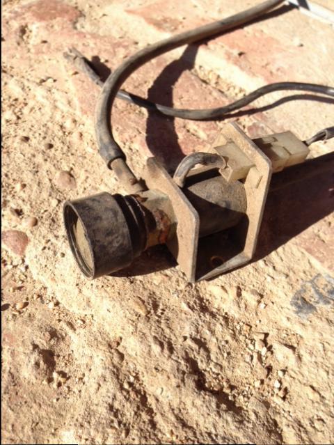

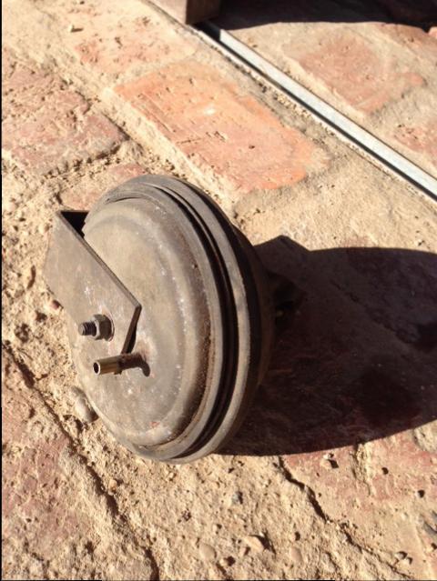

Hi, could someone please tell me where the different coloured wires of the round white plastic connector at the wiring harness and the two adjacent wires connect to, I believe it heads for the dashboard?
Thanks
What are the following items and where do they plumb in?

the large round metal item with the vacuum port is the decelerator valve for an air cooled motor. it allows some air to bypass the throttle plate when you let off the accelerator (and draw vacuum)
you can see it plumed in this pic http://www.ratwell.com/technical/VacuumHoses.html
