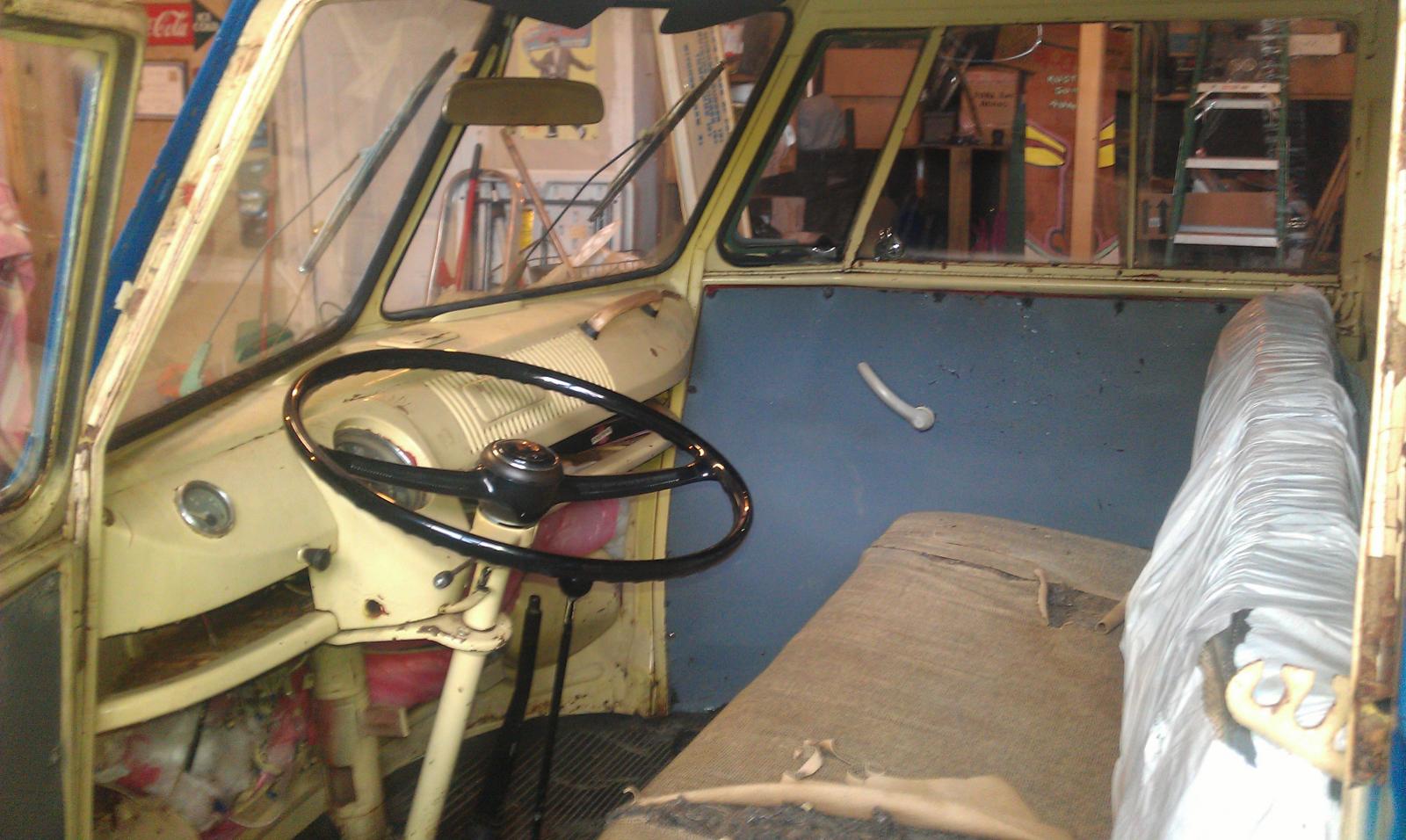

Getting ready to tear into this ultra-cool dual chest SC. It is a factory Ruby Red truck and it will go back to that color.
Larry is a good friend of mine and he has a VW heart through and through. We just finished the resto of a 67 Beetle that he has owned since 1970. Link to that thread is in my profile.
Anyway, Larry found this SC sitting on a farm in Iowa and decided it needed to come home with him. Larry, being a crazy VW guy, is raising his grandson proper and exposing him to as much of Wolfsburg's finest as he can. The boy has affectionately named the truck "Brrt Brrt" after the sound a VW makes going through the gears. Well, the name stuck.
This build wont be over the top, but it will involve a complete going through of the entire truck, mechanical, interior, electrical, rust repair and paint.

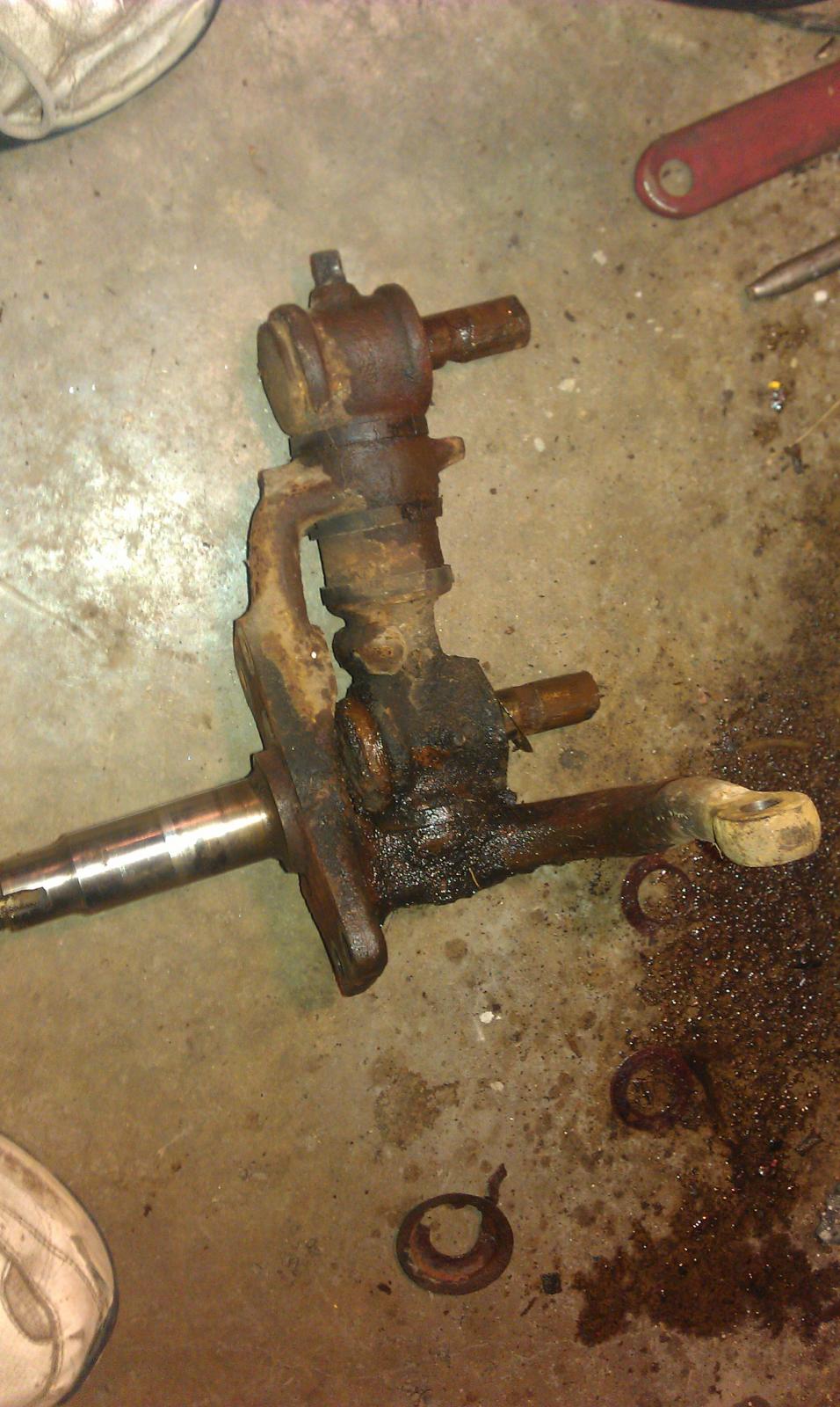

Beginning tear down of front end
Spindles fought me pretty good, but with enough PB Blaster, heat and an air hammer, I got them off. Also, you can see in the wheel well some of the original Ruby Red that this SC left the factory with.

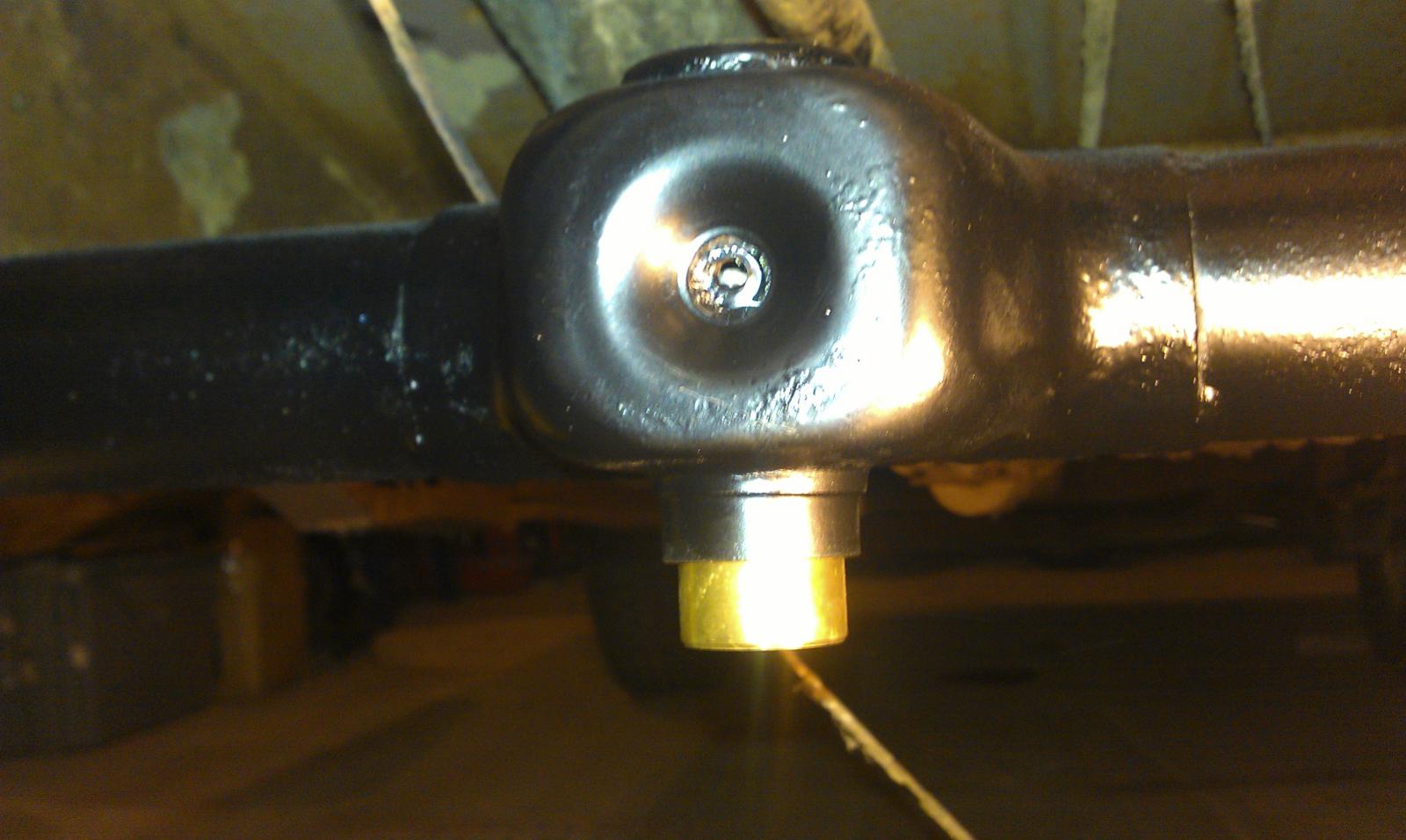

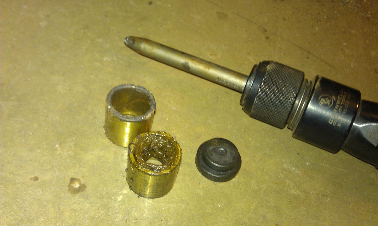

The driver's side, top link pin is rusted solid and the lower has the bearing completely beat out.

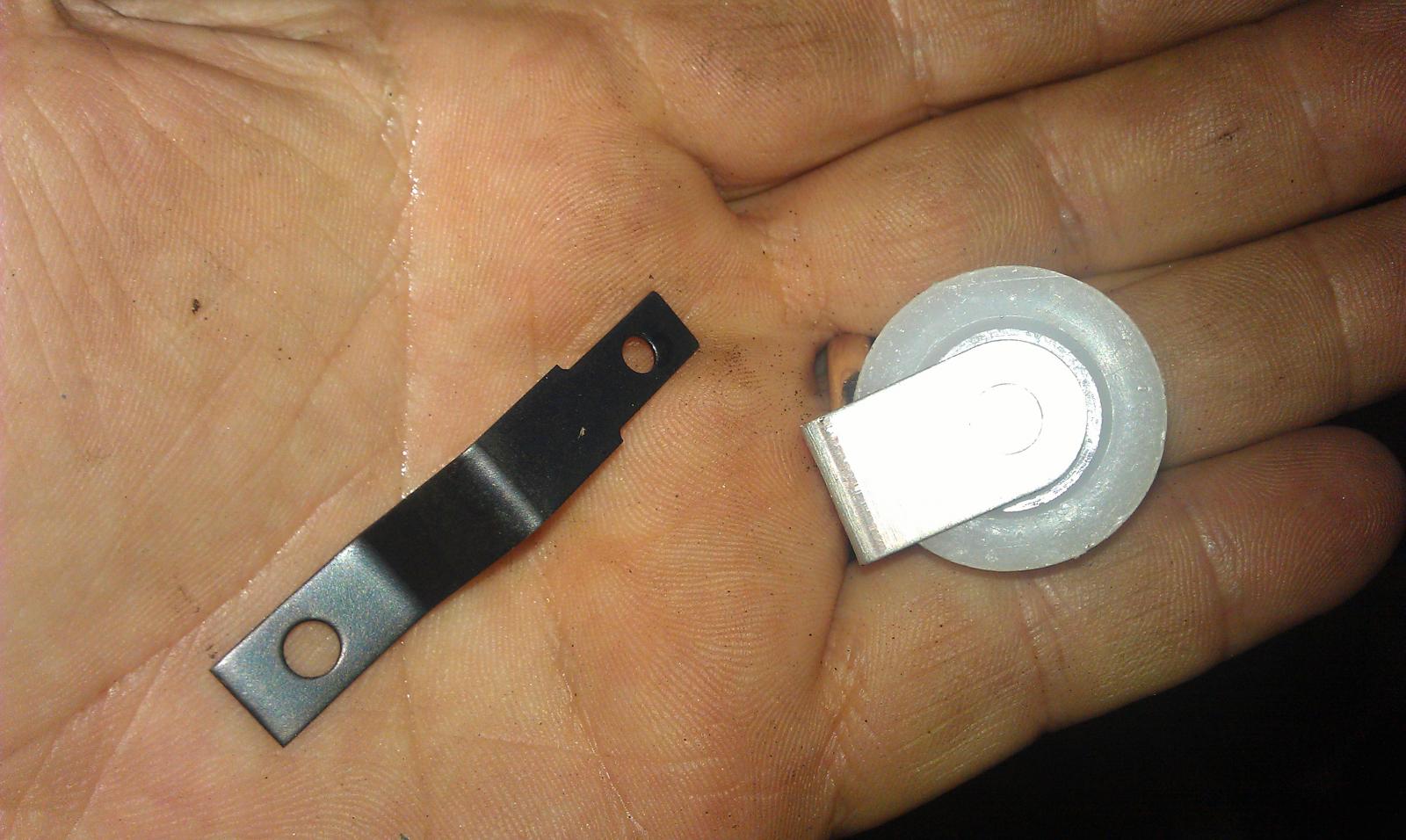

Hard to see, but the star adjuster torsion springs were so weak from rust they literally fell off.
Looked all over for a supplier and found nothing. Searched here on The Samba and found that guys were making their own. I took a stroll through the hardware dept. at my local "Depot" and found something perfect. Just goes to show, you have to look outside the box...or inside the box in this case. Thought I'd share.
Found replacement wheels for sliding screen doors had a similarly shaped torsion spring.
Ground off the rivet from the wheel mount and separated the spring.
Carefully bent the tip that will contact the star adjuster...
and positioned, marked and drilled the backing plate...attached with a couple 1/8" rivets

Found a thread here on the Samba showing the proper way to replace the steering swing lever center pin bushings. Very informative, but was using factory VW Hazet tools, which I do not have.
So, time to get creative.
I used my air hammer and a bearing race driver to push the old bushings out the top.
Drove the new bushings in from the bottom using the same technique.
Note:the upper bushing should protrude from the top about 1/16" and the lower bushing should stop flush with the bottom.
