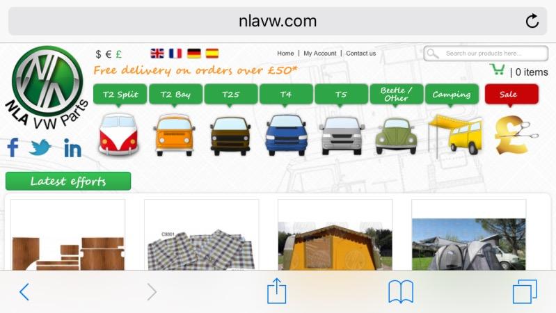

The BusDepot step is labeled on the box and paper work as
cool-out.com
It is a very high quality unit, heavy polished Aluminum..... Haven't installed it, snowing, cold, windy, wet right now..... It was enough that I had to fix my JCB Hoe today! NOT working on the Van!!!
Anyway.......
If you type in that address you are directed to
nlavw.com
Which has the step.
I am fairly certain that cool-out.com and the GW brand of NLA are indeed one and the same.
BTW 145 pounds is $203 plus shipping(if they even ship to the USA) and a huge time lag.......

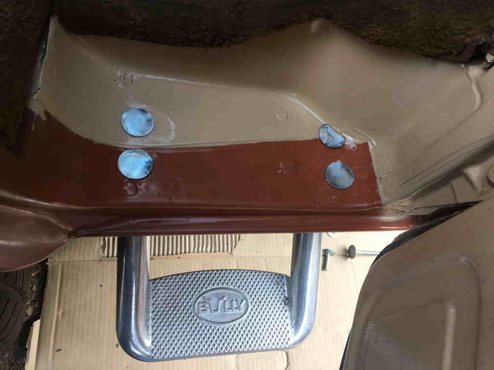

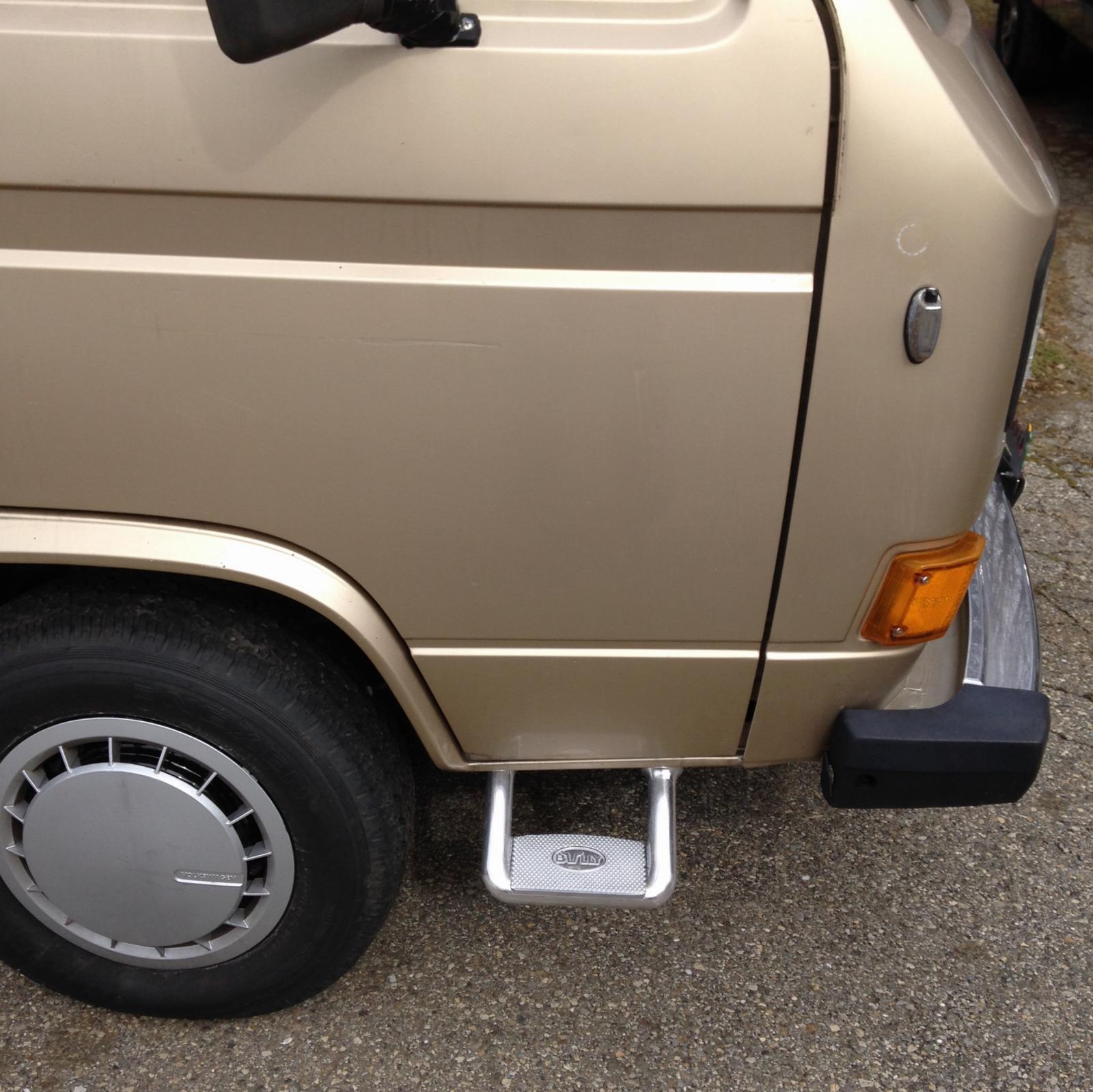

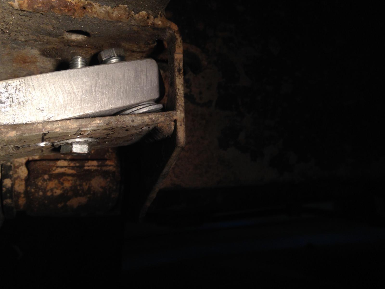

I finally got back to my front "Bully step.
As you may recall ..... bolted directly to the bottom of the foot well, it sat crooked.
To remedy that I thought that I would install some square tubing between the VW step and the Bully step.
I picked up a length of both 3/4" and 1" square tubing. Some preliminary eyeball looking told me that the 3/4" would be perfect!
I cut a 3" chunk, drilled two holes through it and found a couple of 5/16-18 x 2 bolts.
Beautiful!!!!!
Sits level and it works so well!
And the best part is, though it is on there with standard hex bolts now, I've ordered 5/16 - 18 x 2 ELEVATOR BOLTS and the stock footpad should almost cover everything!!!!
~original
Very VERY pleased.
Even for a "healthy" old fart like me, that extra step makes getting in Soooo much easier!

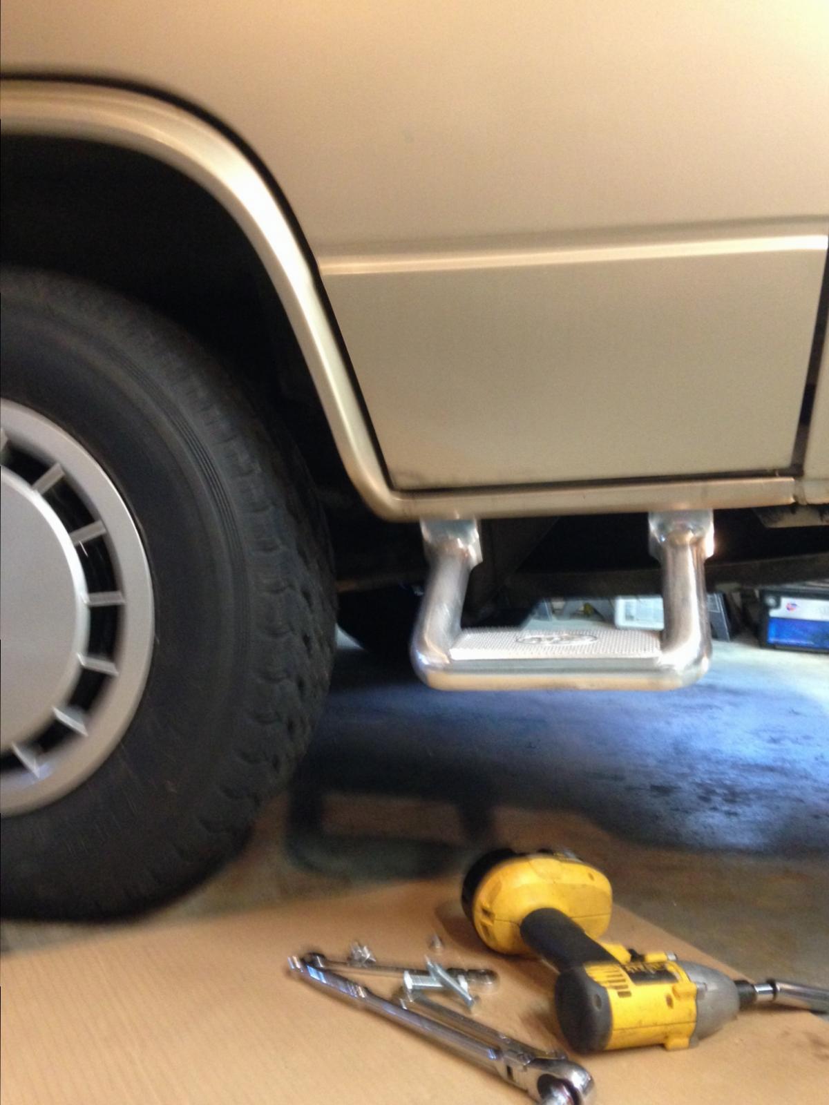

PostPosted: Sat Mar 05, 2016 12:05 am    Post subject: Re: Vanagon Entry Steps Reply with quote
Finally installed my sliding door step.......
Unit loosely assembled waiting for installation......
Closeup of the step brackets and the holes that are predrilled.....
The hardware supplied and the two pages of VERY POOR instructions.....
If you follow the instructions, step #1 is to mark the bottom of the rear jack point 42 mm in from the flat outer edge. You will drill a 9mm hole vertically up through the jack mount.
A little math tells me that 42mm = 1 11/16"
I measured, marked, center punched, pilot drilled and drilled the 9mm (23/64") hole.......
Not a lot of space for a drill..... I could have jacked up the Van but it was easier to use my 90* stubby drill.......
Now they tell you to screw in a provided 25mm bolt into the inner rear bracket from the bottom......

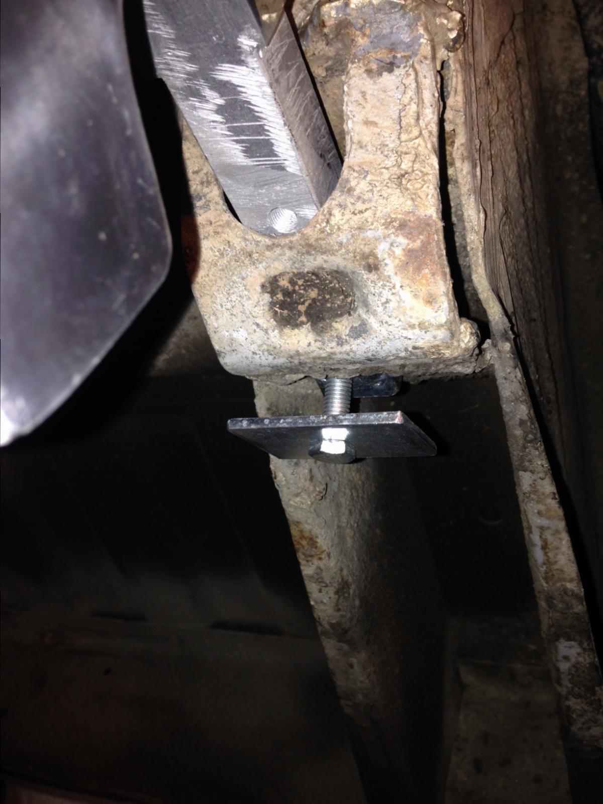

PostPosted: Sat Mar 05, 2016 12:34 am    Post subject: Re: Vanagon Entry Steps Reply with quote
The next instruction is to take the steel tube and slip it over the front step bracket. Through multiple readings ( maybe I'm just dense?) gathered the welded on nut goes up and will be towards the center of the Van when installed.....
Now this next step was really obscure in the directions but the second 25mm bolt is installed from the top down, through the drilled hole in the square tube into the threaded hole that will bevtowards the center of the Van when installed.....
Now, slip the step assembly into the two jack holes. (The ends are still loose on the step itself, they will be tightened last)
Take the mid length supplied bolt 60mm with a washer and place it through the 9mm hole you drilled snd up into the available outer hole in the step bracket.
Do NOT tighten it just yet, just catch a few threads to hold the step from falling out.
Now the longest bolt supplied 80mm has the steel plate on it and holds the front step bracket to the jack point......
It took a bit of head scratching but the long bolt and steel plate are placed through a hollow of the inner most part of the jack point. The bolt angles up towards the outside of the Van.
The bolts engages the nut welded on to the square tube you fastened earlier.....

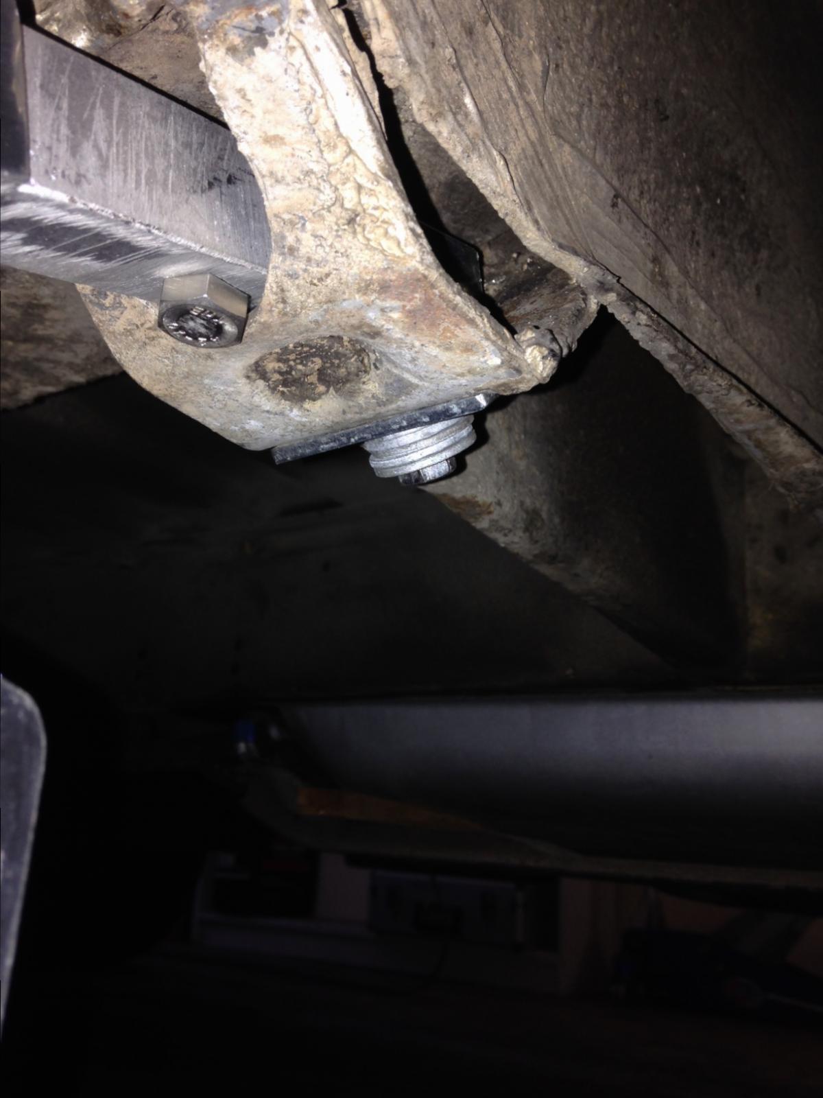

Now..... I had two problems with this design ....
And.....
A third problem of my creation..... Embarassed
First my problem..... I measured in for the 9mm hole I drilled in the rear jack point 1 3/16" instead of 1 11/16" !! Shocked
Easily fixed with a redrill.
This mistake made the step angle away from the body and looked really bad!
My Bad.... Fixed!
The first design issue is with the rear mount. They had me install the 25mm bolt from the bottom threaded up into the bracket.
This bolt is intended to supply angled adjustment for the step...... A very true fact....
BUT.....
It ends up that the mounting point flexes when weight is applied...... the inner part of the step bracket is not firmly braced against the top of the jack point!
I think if you Flex this a number of times, the long mounting bolt will probably break.
My solution was to thread the 25mm bolt down from the top to brace the bracket against the top of the jack point and thus prevent movement when weight is applied.
That worked great!!!!
But.....
I now had no lower step angle adjustment!
For now I simply slipped a few washers under the inner bracket point.
It works fine but I will source two bolts, about 15mm long or so, and thread one from the top and one from the bottom in the same hole which will give me the support AND the adjustment needed.
Here is the current assembly with the washers in place......
Now, problem number two was just as heineous but easily fixed.
The bolt supplied for the front step inner mount was too long and jammed up against the Van's frame without yet being tight!
A few washers under the bolt head fixed that in short order.
But, a third design installation flaw raised its ugly head once I was able to fully tighten this bolt......
As you tighten the front bracket mounting bolt (the one with the washers under the head to shorten it) the bracket is pulled into the jack point as you do.
It pulls the step in excessively causing it to once again not be parallel to the body!
To solve this I simply threaded in a bolt, from my bolt supply (not provided) and the head wedged up against the jack bracket keeping the step parallel to the body.
The washers and the additional bolt are seen in this photo......

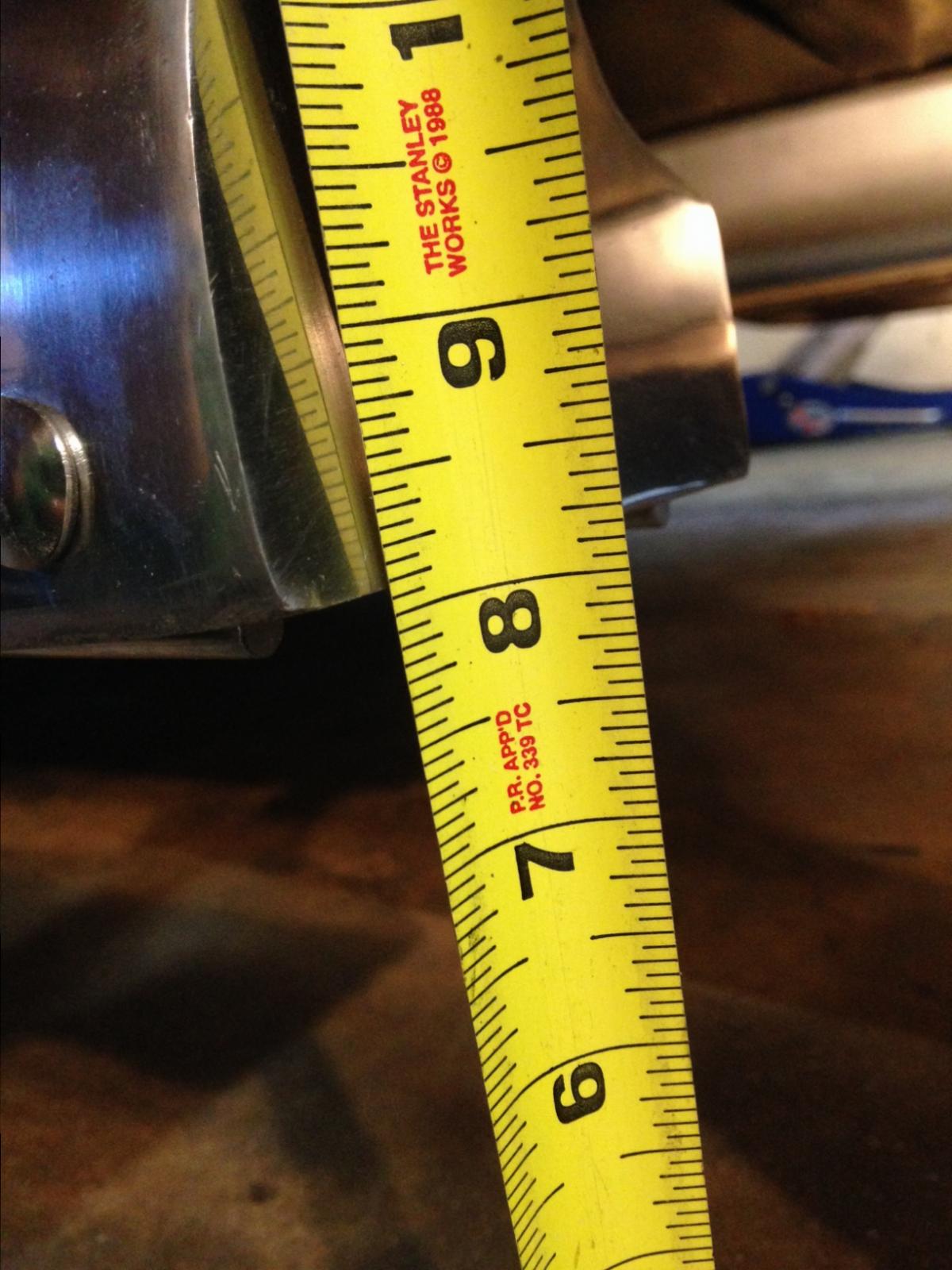

Ok........ What about ground clearance?
For sure it is decreased...... Here is a photo looking under the Van, the step hangs lower than the gas tank (2 wheel drive) .....
The gas tank has 9 1/2" of ground clearance..... (The tape measure body adds 3")
Here the tape at the step shows approximately 8" to the ground, a loss of 1 1/2" .....
The issue is that the step runs jack point to jack point at an 8" ground clearance. Any off road rocks or road humps could easily make contact with the step mid span.
Just be aware of this before you venture off the beaten path.

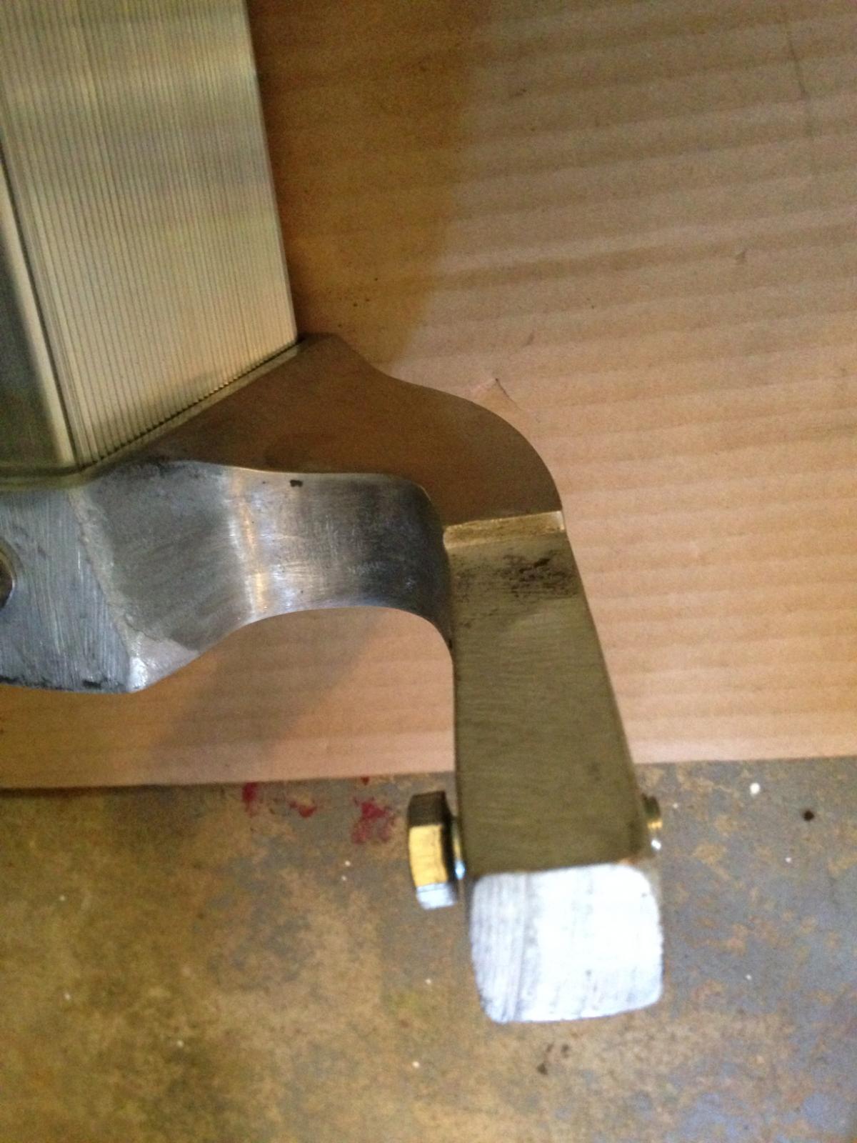

PostPosted: Fri Jan 12, 2018 10:36 am    Post subject: Re: Vanagon Entry Steps Reply with quote

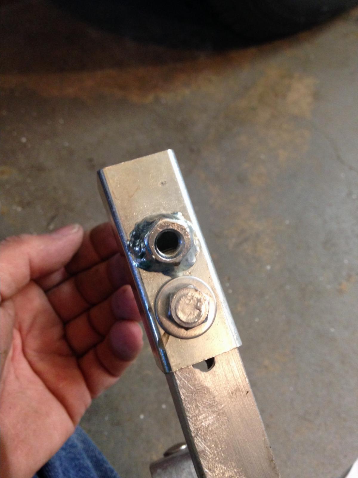

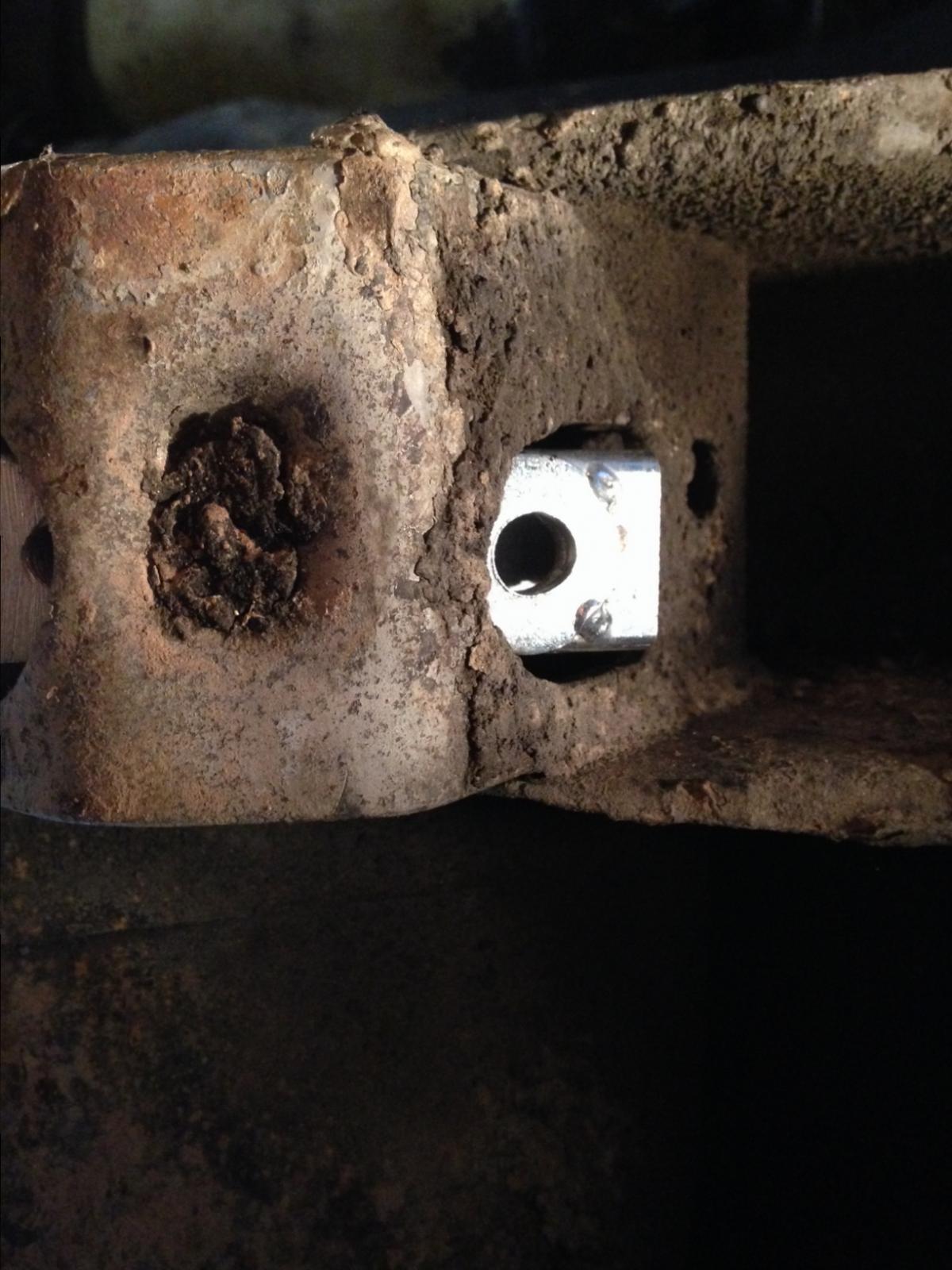

I’m getting sort of old, and I carry a lot of old people around. So:
When I first took it apart I found this horrible situation (some of you might say this is hardly any rust):

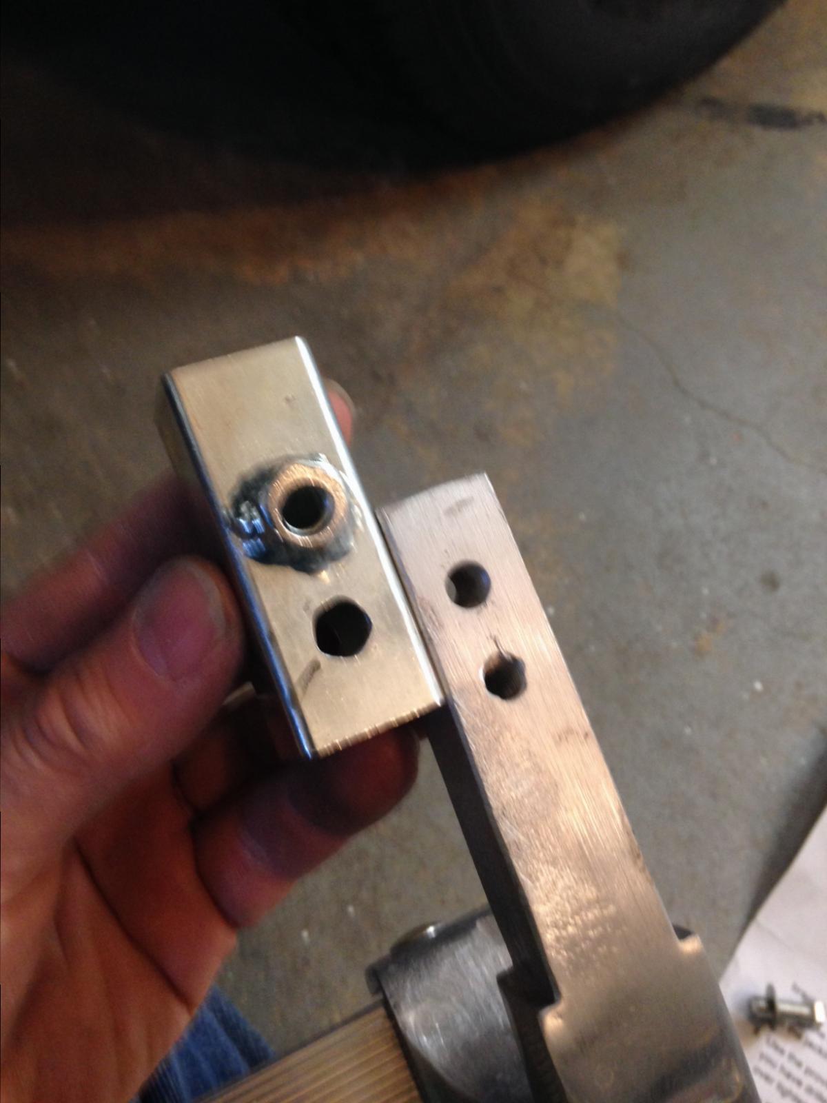

…rather than fight with it I decided to just take the job to my metal guy.
My welder did a solid job but left it real messy:
Thanks to Dave ‘djkeev’ for the hot tip on the flat head 5/16x18 ELEVATOR BOLTS, which allowed me to glue the original rubber footpads down flat.
A view from the bottom welded on dropdown extensions that leveled out the step bar, all painted in Rustoleum:
I had to cut off the long bolts with a Dremel and carbide cutter. WEAR GLOVES doing this! Better yet, plan ahead and get shorter bolts! Notice that I used ⅛ nylon spacers between the aluminum and steel. Not sure why except that I know the metal difference can aggravate corrosion.
Wire brushed the slag off, painted and ready to glue the rubber down:
Pretty happy with this mod. I just need to be careful of sideswiping high curbs.

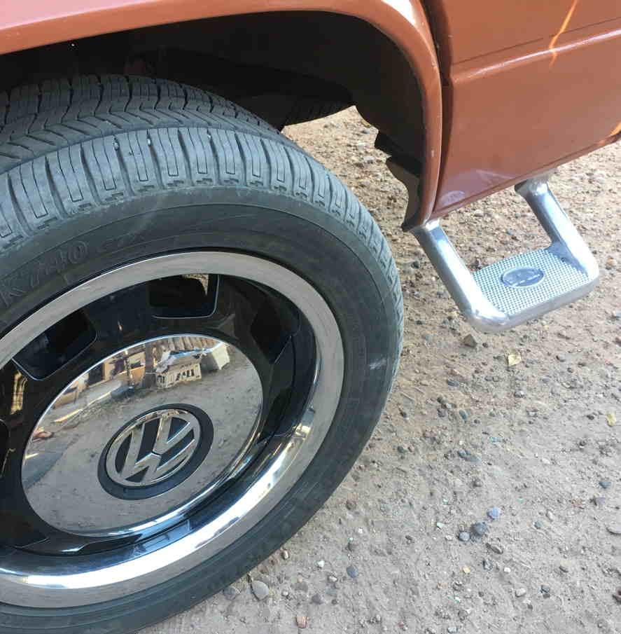

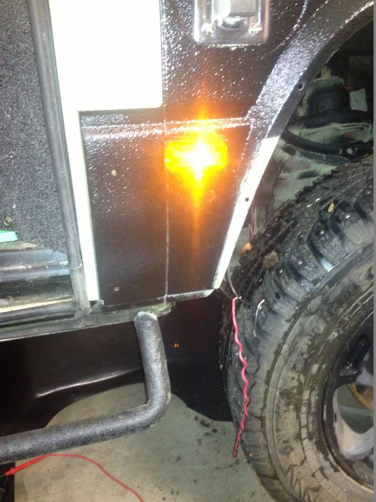

PostPosted: Fri Apr 26, 2019 3:39 pm    Post subject: Powdercoat glossy black Bully side steps! Reply with quote
I thought the aluminum looked stupid, and after a few winters looked even worse. So I had them powdercoated UV resistant glossy black:
The step collects a lot of abrasive grit during winter, so I think I’ll glue down some rubber, or spray on some of that peelable polymer.

Two images of the "Ambulance" step as it was named earlier in the post.
The spring on this step really adds a bit more effort into getting the door all the way open into the locked position.
When I first saw it on VW Classic Parts it was listed for 1650.00€.
Now last time I saw it it was down to 350€.

PostPosted: Mon Apr 29, 2019 10:56 am    Post subject: Powdercoat glossy black Bully side steps! Reply with quote
Another shot of the glossy black side steps with the VW Beetle ‘Heritage’ wheels!
Jake de Villiers
Joined: October 24, 2007
Posts: 5930
Location: Tsawwassen, BC
Jake de Villiers is offline
PostPosted: Tue Apr 30, 2019 8:17 am    Post subject: Re: Powdercoat glossy black Bully side steps! Reply with quote
You're not really going to put your gritty shoes on that gorgeous shiny powdercoat, are you?!?!? Shocked
