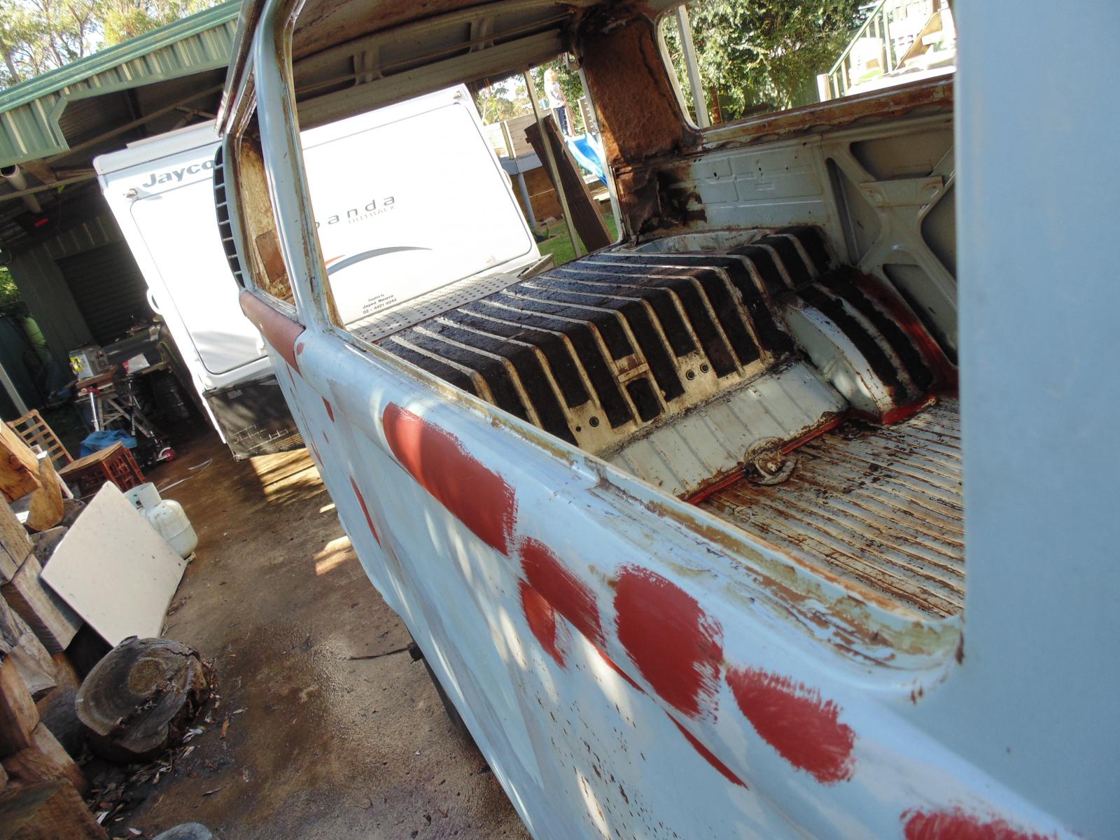

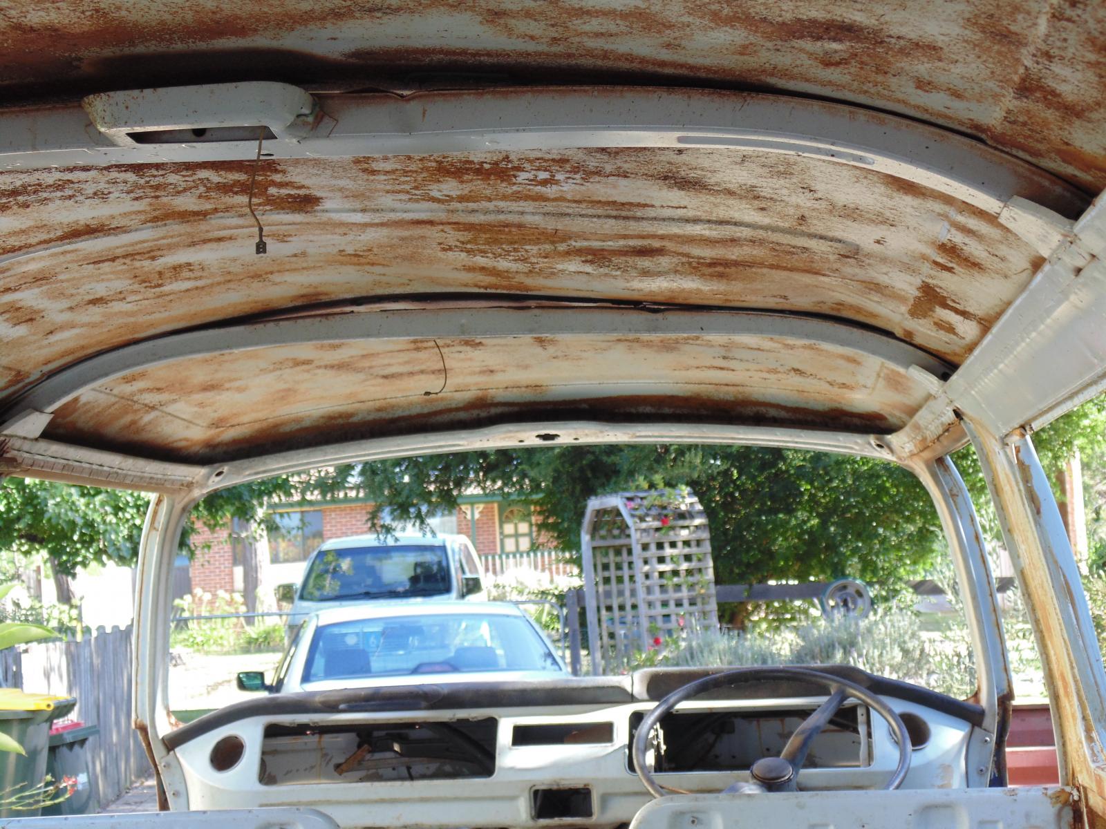

Got the Kombi out today and hit it with the gurney.All the windows have no rust. A little bit in the front lower steps and the lower front apron. The headlight buckets are rusted through. The section above the engine cover is no good either. The roof is a little damaged, i was told a tree fell on it. |

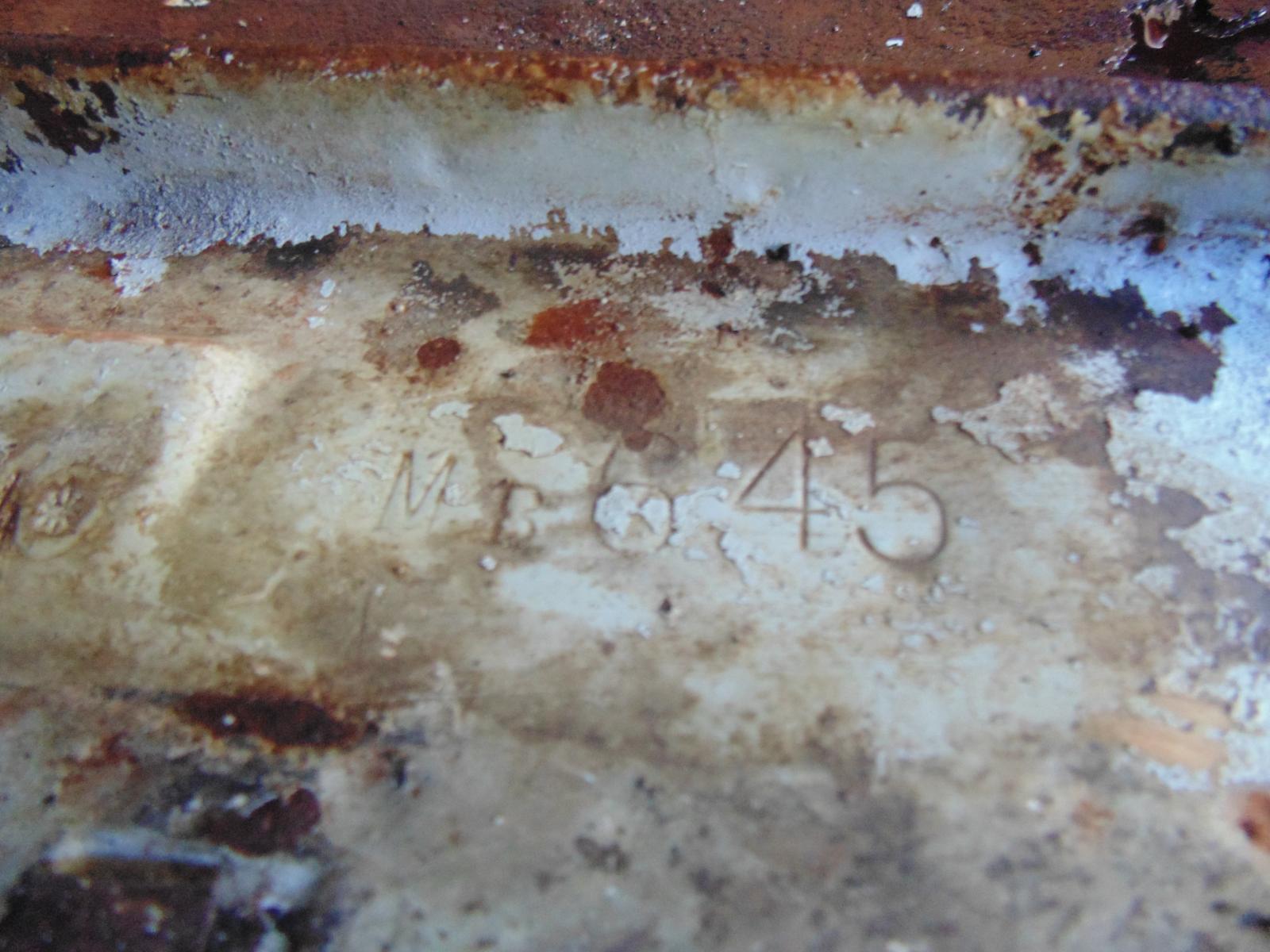

Ive got no M plate. But after the chassis number there is a number stamped MB645? Any ideas? Its an Aussie 69 |

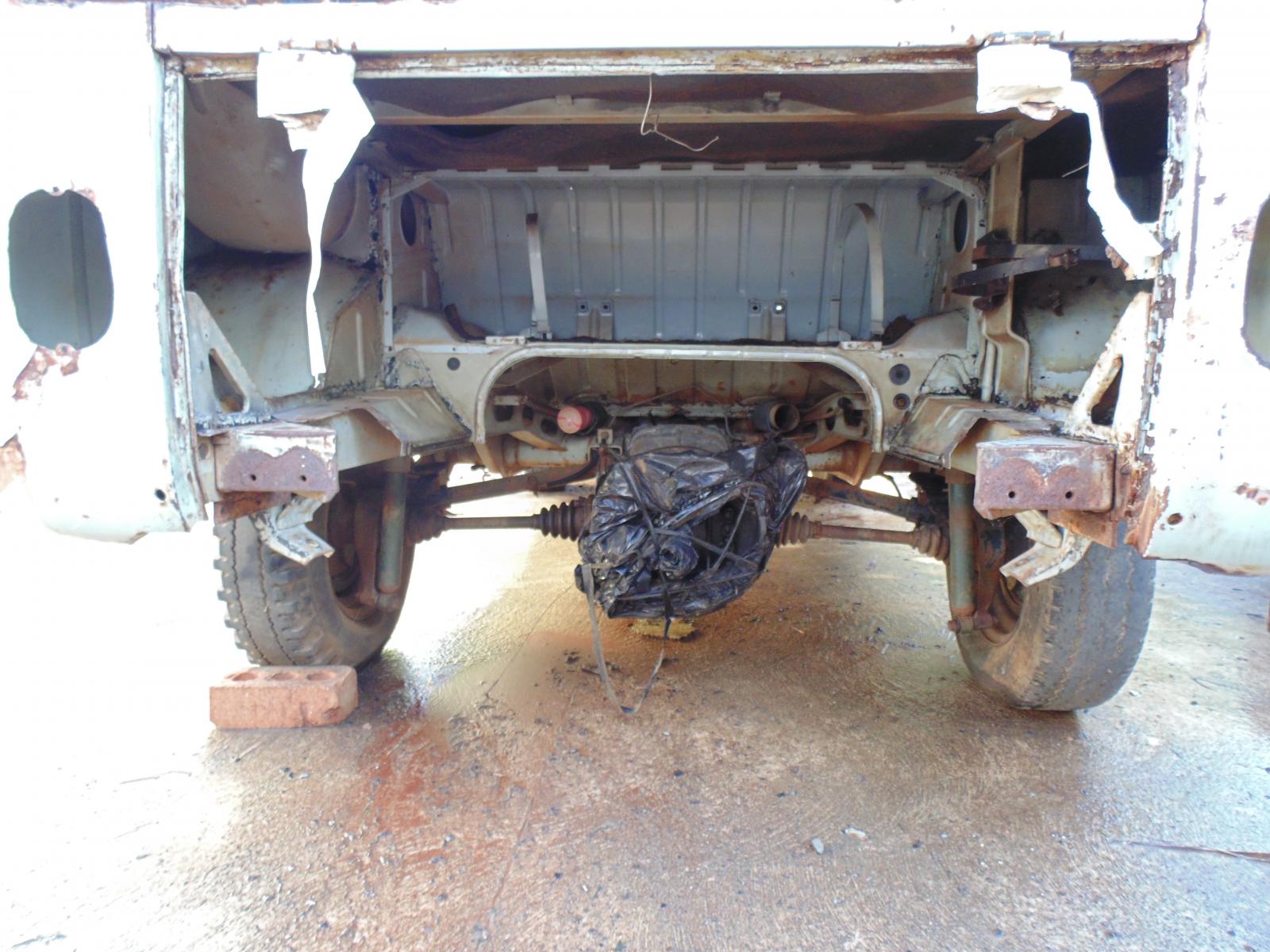

I sure hope you disconnected the transmission to the shift rod, else you have a pretty bent shift rod. _________________ Wash your hands

You need to put a strap on the transmission to support it. Right now it is resting on the shift coupler. This can bend the coupler, shifter shaft, trans gear selector shaft.

Its been hanging like that since forever by the look. The motor was in the back when i picked it up. The damage is most likley well and truly done  |

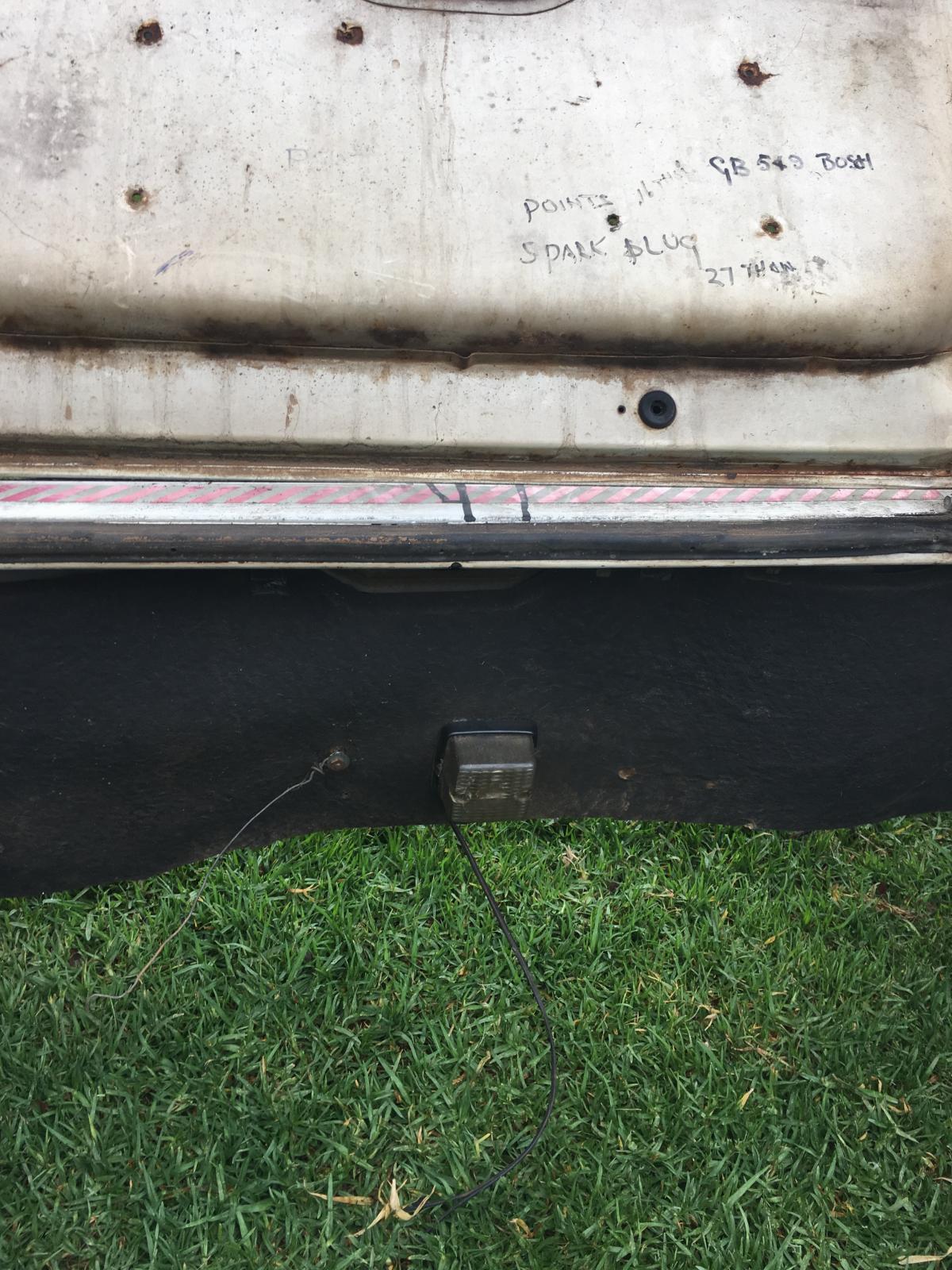

Picked up this. Its in great nik.
The old bus must have been a little unreliable. The old owner had a light in the engine bay
