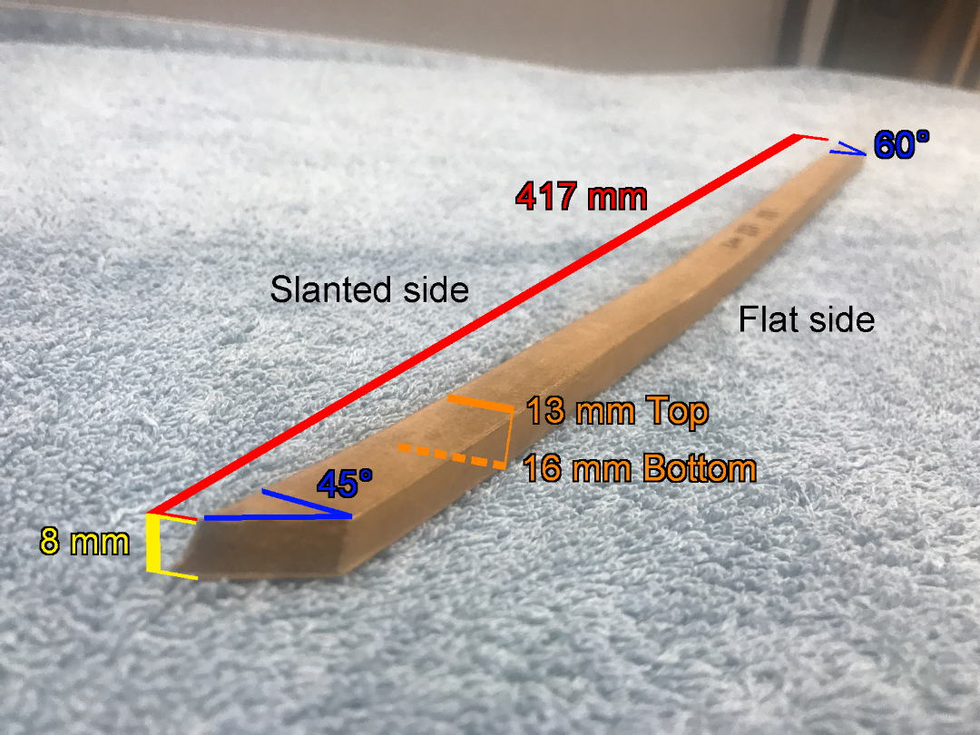

Here are a few pictures of some NOS vent window seals. I can post some measurement over the weekend as well. Let me know if need more pics.

Here are some photo's of the vent window seals showing the measurements.
The long and short pieces are the same height and width.
The piece that goes at the back of the widow frame has a slight angle to it so the glass can close properly. You can see the angle in a couple of the photo's. Let me knows if I can provide any additional information or details.
