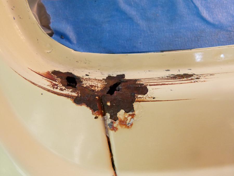

Rust hole under the windshield seal (at the base). Use a screwdriver or popsicle stick to lift the seal up as much as possible and look for rust holes, especially at the corners.
Your location plus the obvious evidence of a repaint suggest that there is rust there that wasn't addressed. Sorry.

Yeah I honestly doubt it's rust because I was there when he did it and I think I took a close look but I don't really remember. I know I saw nothing alarming like that pic
