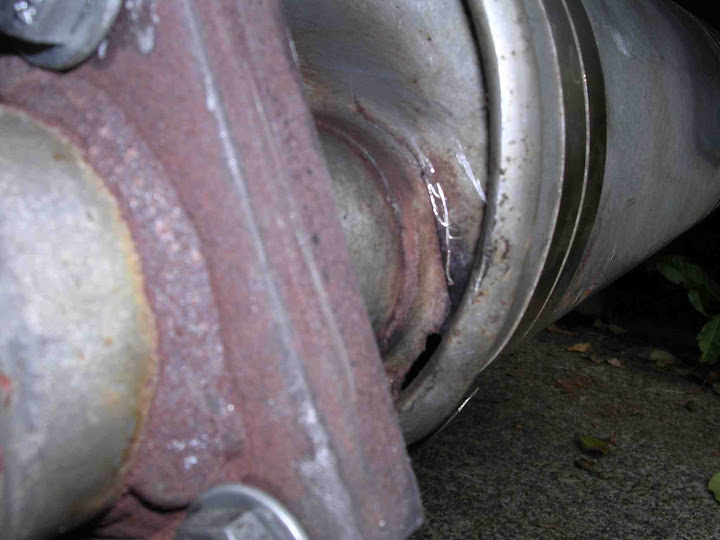

I installed a Vanagon (2.1) Quiet Flow on my swap. It is quiet especially considering exhaust system is short. Rebate was pretty prompt. JSYK, mine cracked at inlet. But. I assume this was due to engine vibrations with older version of my hanger design.
That price is great. Up here, muffler much more.

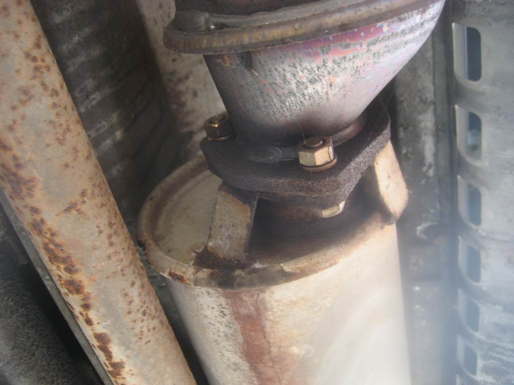

Is this the part you guys are ordering for the 2.1 (22485), and does it require the brackets shown?

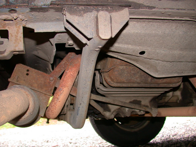

Maybe that's why factory mufflers have straps welded on in that area?????

That looks like an S&S, like this...

r39o wrote:
FYI: Your washers need to fit better at the cat too. Grind an edge flat.
Thanks for the FYI. I'll double check. Fasteners were changed after I welded crack but for sure. Cat factory weld bead is close to washer if that's what you mean.
For sure. Factory straps. Maybe eh? On my setup, didn't use Walker PN 35920. Are these in place of factory straps? (somehow bolt to muffler?). Clearly I know little - nothing of the 2.1 Wink On my swap, first version of hangers were just wrong. Now using 3 Bosal DV isolators on home made brackets.
Now back to your regular programming..... Wink
Neil.
Factory 1.9 muffler setup with factory welded straps.

You can't really see things all that well in this picture, But the links that support the muffler are designed to pivot on either end a bit, the bolts were left slightly loose and then double nutted to allow them some movement. Hidden behind the mustache bar is another almost vertical link that stabilizes the rear end of the two links connecting to the bottom of the sump. For the link that you see disappearing upward there is a 90° bracket at the top which allows the link to swing forward and back. Sorry, I know my description doesn't make a whole lot of sense when you can't see all the part.
On the left side on the engine I have a single support as vertical as I could figure out how to mount it. It too is set of so its ends are free to move a little.
The original mounts that supported the muffler when I bought the rig managed to break every 5-10K miles. Once I redid them I have gone 50-60K without failure.
What's the 35920 bracket all about?
Is that what is needed to keep the muffler from cracking?
