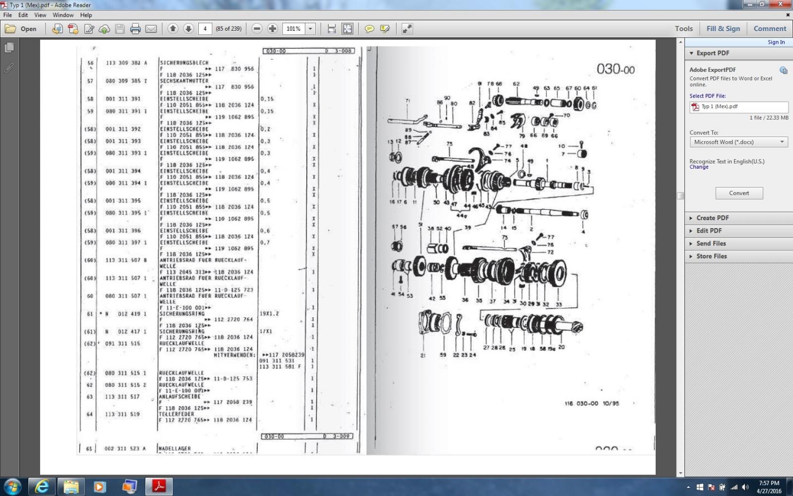

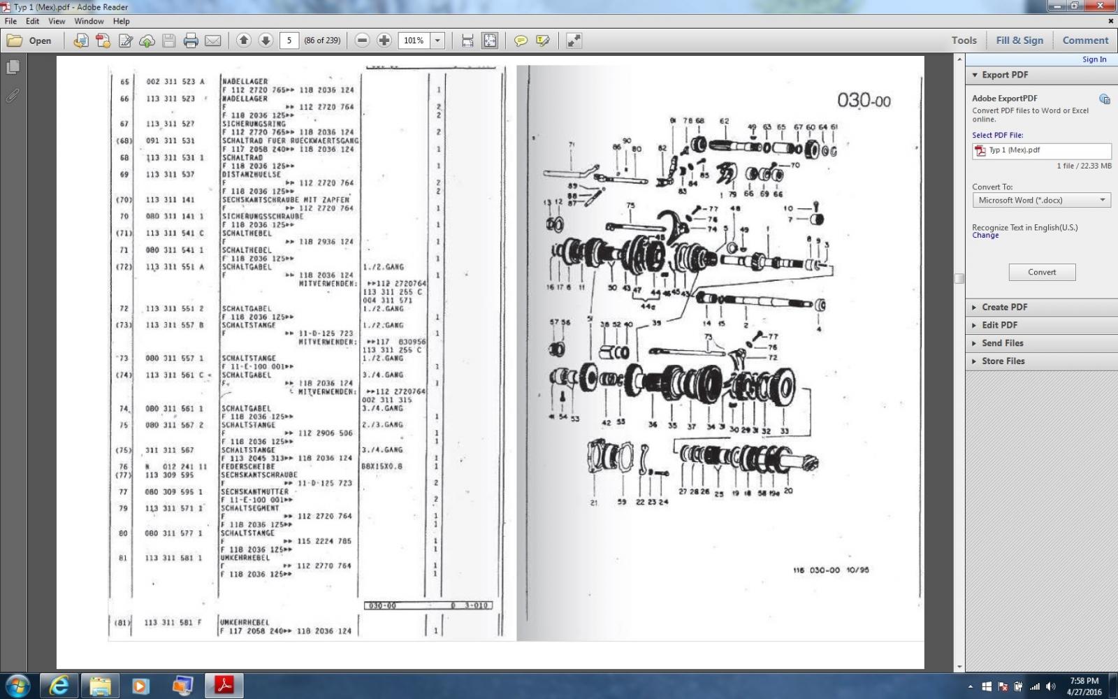

PostPosted: Tue Apr 26, 2016 3:50 pm    Post subject: Re: mexican vw beetle 1.6i 1997 PE code tranny specs? Reply with quote
Here is some info:

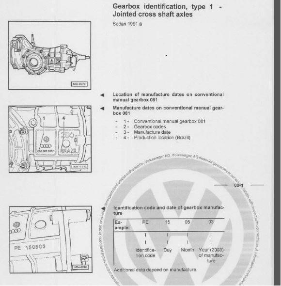

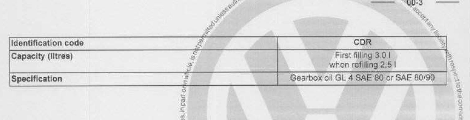

hopkin wrote:
Here is some info:
This info is wrong!
I've never seen a gearbox with code CDR. That's not what our late Mexican Beetles have. We have code PE.
Let's go through the errors in order.
Manufactured dates: From the early 80s when VW of Germany stopped making Type 1 gearboxes, VW of Mex started sourcing them from Brazil. Sometime in the 80s, VW upgraded from a 1200 to a 1600cc engine. But they didn't change the gearbox ratios. My guess is that since the overwhelming majority of Beetles are driven in cities only, high speed driveability wasn't a concern to VW of Mex. So, the Beetle in Mex had a PE gearbox starting long before July 96, and it continued to the end in July '03.
Final drive ratio: VW of Mex never installed a 3.88 in any Beetle. They may have installed 4.12s back in the 70s since there are 4.12s to be found at the repair shops. 3.88s are non-existent in Mex.
First gear: Wrong again. As the chart says, a 3.78 first gear has a 9/34 tooth count. This ratio was only made in Germany, whereas VW of Mex used Brazil made gearboxes for the last 20 years at least. First gear in a Brazil gearbox is 3.80, or 10/38. This gear set is much weaker than the German 1st gear.
Fourth Gear: The .93 is another Germany only gear set. And it only comes in a 002 type gear. VW of Brazil never offered this gear, and never used 002 type gears. The .93 ratio was only installed on a 3.88 R&P in Beetle gearboxes to compensate for the tall R&P.
Reverse: First is the 12:17. The 12 refers to the coupler gear that meshes with the fixed gear on the end of the reverse idler shaft, which is 17 teeth. I do know that the 17 tooth gear is Germany only. I don't recall what the counts are for the Brazil gear.
Next is the 15:40. The 15 is the reverse idler gear that slides into and out of mesh with the straight cut gear on the OD of the 1-2 slider. 15 is Germany only, the Brazil gearbox has a 17 tooth gear in this location. The 40 is the number of teeth on the OD of the 1-2 slider. Again, 40 is the count on the German 1-2 slider. A Brazil slider has 44 teeth.
Paul, I recommend you delete the file from your records. Keeping it is of zero value. And don't refer to it ever again.

PostPosted: Wed Apr 27, 2016 1:07 pm    Post subject: Re: mexican vw beetle 1.6i 1997 PE code tranny specs? Reply with quote
mcmscott wrote:
Thats odd, Every Mexican ( Brazil) trans I pulled apart had a splined 8 bolt 4.37 ring and pinion, late sliders, 3.78 mainshaft(002) late style 3- set (002 style) and also had 10 tooth spider gears. Also every one had a .93 fourth. I have probably built aprox. 50 of these and they were all the same. Also they have bolts instead of nuts with studs.
That configuration is correct, but those Mexican Beetle gearboxes were made in Germany. I've seen tons of those all around Mexico. All really good parts inside.
The Brazilian Mexican Beetle gearbox is completely different. Watch for the PE code, and the main trans case says BRAZIL on it just like the Rhino case. When you open up a PE gearbox you'll be surprised at all the junk they used in Brazil that Germany abandoned.
I don't know when VW of Mex changed to a Brazil made gearbox. I assume it was at the same time VW of Germany stopped making Type 1 gearboxes sometime in the 80s.
