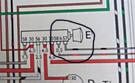

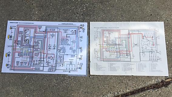

#4 - scrivyscriv, you were also dead on. However, it was interesting why it happened and I wanted to share that with everyone as a warning. Back when I started this project I ordered a laminated electrical diagram off of EBay which I have been using pretty regularly. When I saw your note, I went back and compared the laminated version to the one in Bentley. As it turns out, the laminated diagram has 57 and 58a backwards.
