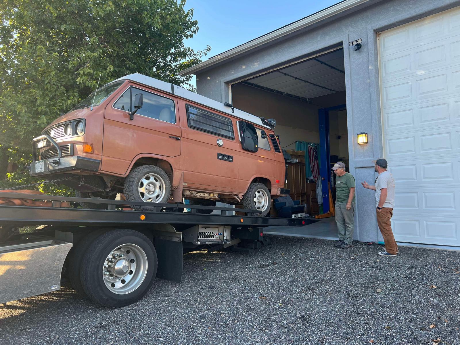

Yep, that was me hanging out with the Syncro kids. I think I would have been able to do this climb until this happened.
Aaron who was behind me saw a bit of smoke from the back of the van. I had rolled back to the left side of the road and put it up against the embankment on the drivers side so it couldn't roll any further. I did look under from the passenger side and didn't see the broken axle. Also, I was able to get it going a bit from brakes on but it would quickly stop. I thought I could smell something burnt which is why we thought perhaps the clutch was burnt or slipping. I think when I would try to start from having the brakes on, the lsd would grab but as soon as I was fully off the brake, it would not move.
I was with an awesome group, Arron and Erin, Matt, and Catherine and Chris.
The break actually happened lower that the switchback where the recovery took place. Arron pulled me up to the switchback, then Matt tried to get me up the hill to no avail, just not enough traction on the loose stuff to pull a Westy up. I rolled back down to the switchback and parked it. Andrew in Moab who has a very cool Volvo C303 met us in town. He, Matt, and I returned to the van but by then it was raining and there was even less traction. I caught a ride back to town with Andrew and grabbed a hotel room for the evening. First thing in the morning I called Trailmater Off Road Recovery. A passing jeep had said they often give a discount if you let them make a YouTube video. Mike and Shawn picked me up at 9am and had me by the highway at 1pm.
From there, it was a 85 mile AAA flatbed to Aaron's house in Grand Junction.
They have a great shop with a lift.
Erin and Aaron were super gracious. They put me up in their guest room and even provided a pup to keep me company.
I had to catch a fight in two days and parts weren't available in Grand Junction so I grabbed a rental to drive home and to the airport in Denver.
I returned on two trips and Aaron helped me install a new clutch, stub axles and seals.
Finished up on Thursday and drove back out to Moab to hang with some friends.
Also on this trip, both of my front shocks failed. They were the first gen T3 shock for lifted 2wd vans. Chris promptly sent out a replacement set.
Todd at Subarugears also has sent out a set of replacement axles that are the latest version. I had bought these in 2017 and they have since changed how they make these.

Here the end of the broken stub axle for the metallurgists.
[img]
Shocked Shocked

So you had "two significant failures" at one (significant) breakdown?

I decided to pull the trans and do the clutch since I had time and Aaron was willing to help. The clutch was actually ok, maybe at half life. The pressure plate had some hot spots. But for the broken axle, I would have been ok. The front shocks were a pain since they were essentially not there. Had pogo action on the front.
I’ve driven a few roads designated 4wd. Often it’s more a matter of clearance and probably the choice of lines. Aaron and Matt have traveled this route before and felt it was fine with a lifted 2wd. The lsd has been great and I can tell when it’s working. We had already done much more challenging stuff before the axle failure.

Axle rotates one full turn every 7 feet. Bending forces on the spindle at suspension bottomout would likely show a definite “crack-start” location/direction.
Ain’t seeing a “first crack”. Can you post a better closeup pic?
Unless successive bottomouts started surface-cracks at the spline ends, evenly all around, over time. Then pure torque finished it off?
Maybe the CV doesn’t bottomout though. Maybe it just binds a little at the max angles, the spindle accumulating fatigue cycles.
OK just a sec, if ANYTHING is happening at the max ends of the CV angle, I bet it would crack the CV cages. —->Which you didn’t report. Did you happen to inspect the cages?
