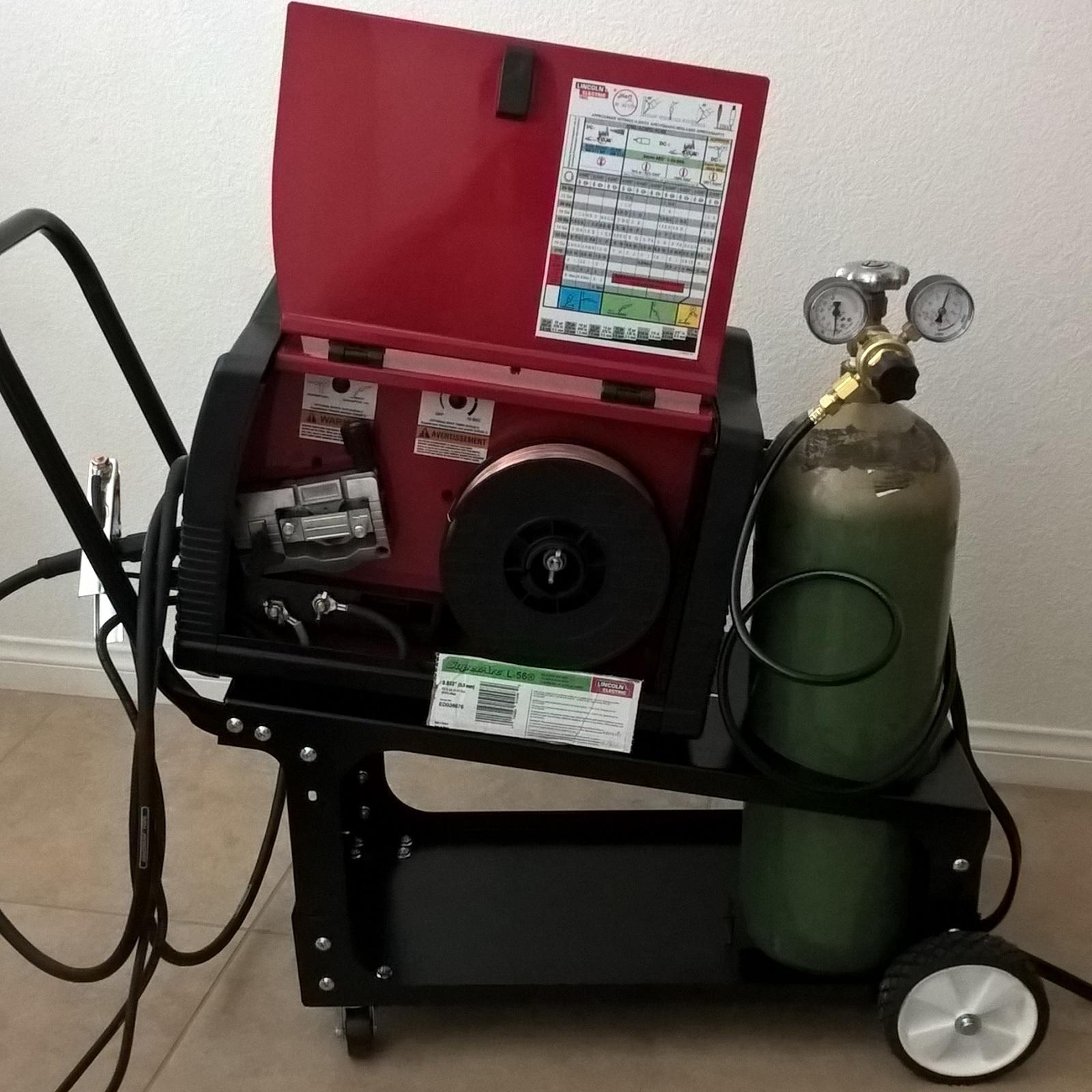

I finally have a welder ...
It's not a real high powered welder, but I think it will work for what I want to do. I basically need to do some pan repairs and modifications. Plus, I want to build some bumpers and brackets. There's a bit of expense involved. I needed to buy the welder, cart, gas bottle, and have an electrician install this 240 volt receptacle.

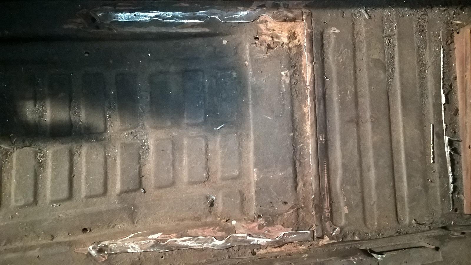

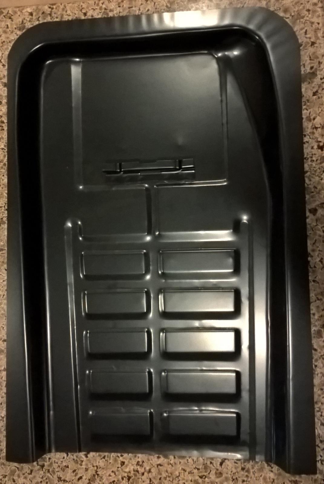

PostPosted: Tue Jun 14, 2016 9:24 pm    Post subject: Re: '69 Baja - Dark Earth Version Reply with quote
I have all the holes welded up and ground smooth on the drivers side. I still have a few holes left to weld up on the passenger side.
The previous owner patched the area where the battery goes.
I bought a pan repair section.
Here's a pic of the underside of the car when I first got it. You can see all the tek screws, the long studs from the seats, and a push button starter wire.
I've removed all that stuff, except the battery tray area, but I will attack that section as soon as I finish welding the rest of the passenger side holes up.

PostPosted: Wed Jun 15, 2016 5:20 pm    Post subject: Re: '69 Baja - Dark Earth Version Reply with quote
I removed the tek screws and patch.
I used a grinder to cut the long sections, and used a die grinder to cut the corners.
Getting the new floor pan section to fit is a bit of a challenge. I put it aside for now. I'll start fresh next time I get a chance.

PostPosted: Fri Jun 24, 2016 10:17 pm    Post subject: Re: '69 Baja - Dark Earth Version Reply with quote
I used a Tri-Square (set at 1/2") to mark the pan with soap stone.
There's a few problem areas where the pan repair section doesn't sit flush.
1. A bulged out area.
2. A minor bent out section.
3. A lightening bolt looking reflection which is a bent up section where it looks like the pan had previously been high centered.
I'll take a hammer and grinder to the pan, and maybe the pan repair section will fit a little better.

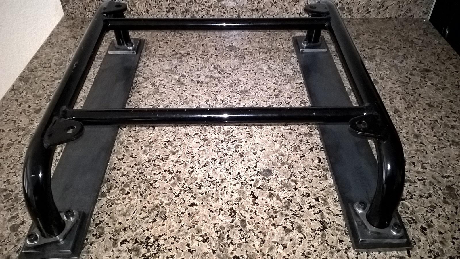

I'm still putting the finishing touches on the pan. The smoke from welding and the dust of grinding limits the amount of time I want to work on the project. Sandblasting would have been the way to go for sure. The tar on the pan and the road grime underneath smolders when welding. I'm done welding the holes up and almost done grinding the pan down.
I'm almost ready to start installing the seats. I bought some 1" exhaust flanges, some 2 1/2" x 1/4" flat bar, some 2" x 1/4" flat bar, and some 1/4" x 3/4" bolts.

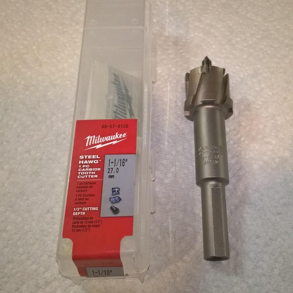

I bought a 1 1/16" steel hawg. You have to use a drill press with this.

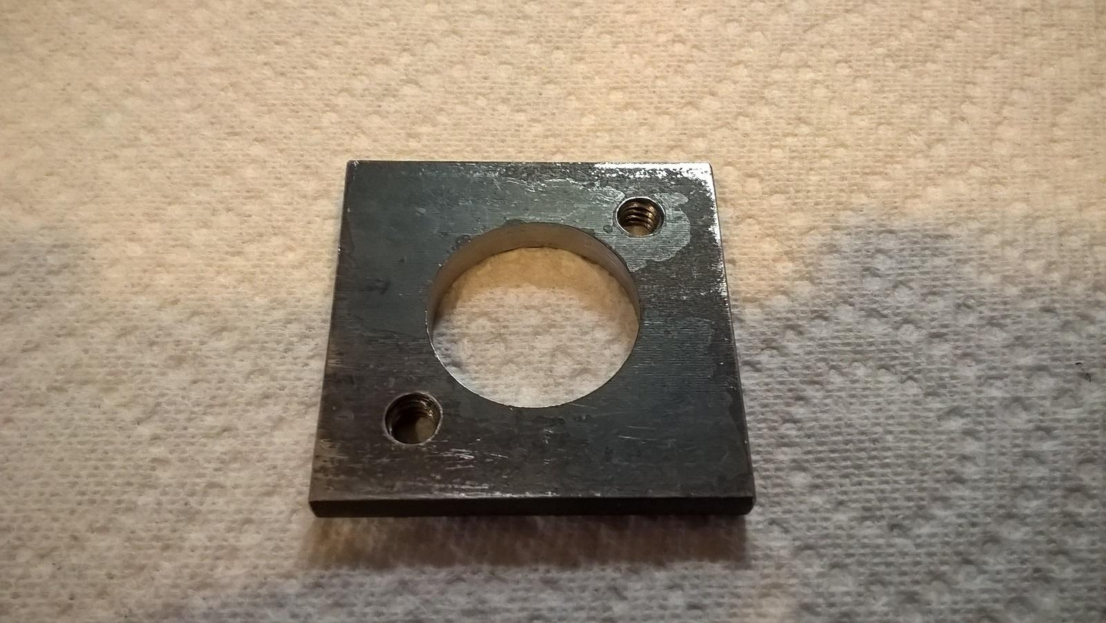

I used the flange to lay out the holes for the 1/4" x 2" flat bar squares.
Here's a flange bolted to a 2" square.
I transferred the hole centers onto the 2 1/2" flat bar.
I used a tubing cutter to remove the factory seat frame tabs.
I used the seat frame to line up where to drill the holes in the 2 1/2" flat bar.
The seats were originally about 3/4" too high for my taste. I cut 1" off the seat frame including the factory mounting tabs. The 2 1/2" flat bar raises it 1/4" effectively lowering the seat the 3/4".
Here's a drawing I made for the seat frames.

Here it is with all the squares and flanges welded in place.
Here it is with the tubular seat frame removed.

I bolted the seat frame back in place to keep everything rigid. I wanted to prevent warping as everything cooled down after I finished welding.
I popped the frame back out after everything cooled down to spray paint the underside to prevent rust. You can see that 1/4" of the seat frame tubing extends through the flanges.
I still have to finish cleaning the remainder of the pan and apply POR-15, but for now, I'm done.

Not much of an update, but here's the underside of the drivers seat.
Assembly was pretty straight forward. I did have to cut about 2" off (and re-bend) the little wire that connects both sides of the slider together though.

Here's the underside of the passenger seat.
The tilt mechanism spring that came with the frame was a bit weak, so I welded a washer on and got a bigger spring. Also, the welds on the tube frame mounts were rubbing against the bent metal where the assembly pivots. I used washers as spacers to get the needed clearance between the pivot points. The seat pivots smoothly now.
Since all I have left to do is bolt them in, I'd say this seat project is done. Dancing
