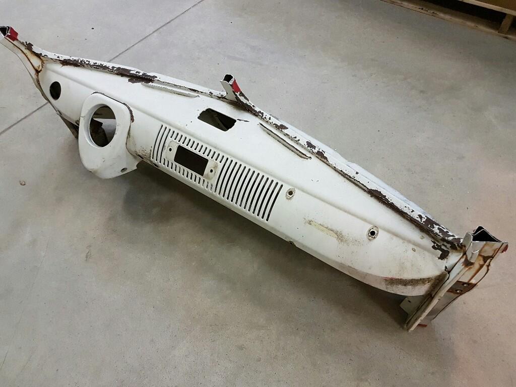

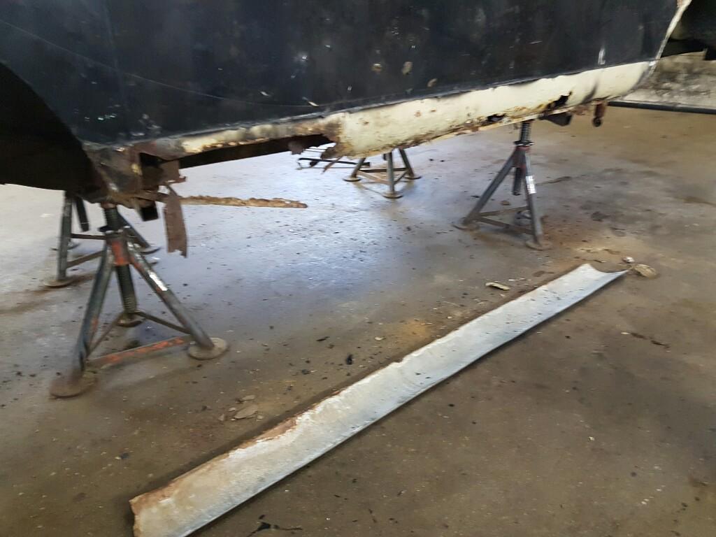

"patch" removed from left side. Someone cut a section out of the inner and outer rockers. Some filler in that side so will remove that before deciding where to seam the panel.

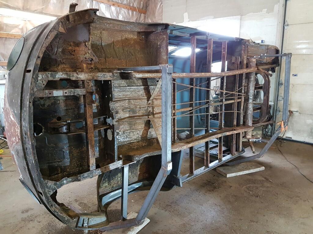

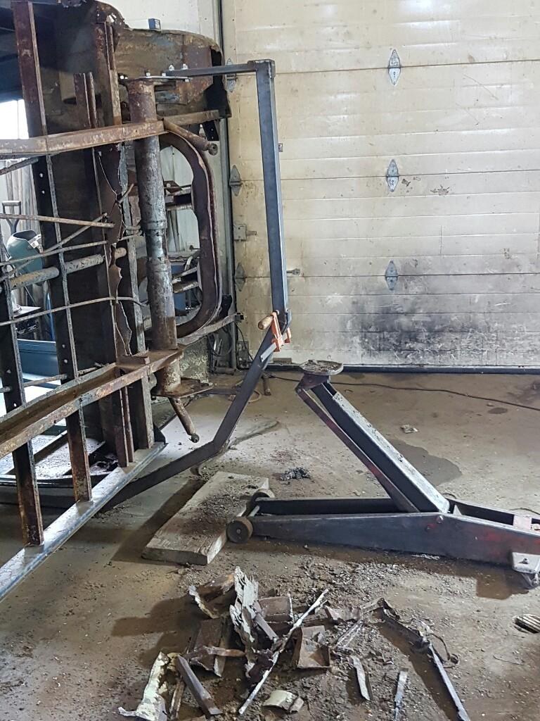

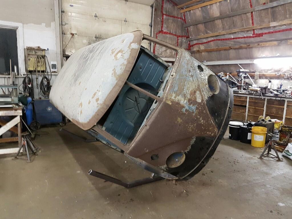

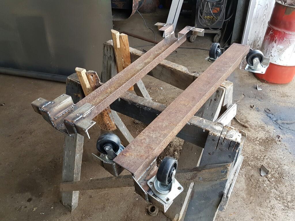

Put on the rotisserie tonight. Quite happy. Was planning to add one more section but not sure it will be that usfull. It is a little springy. I could add a few braces but don't think it's necessary.
Need to add safety bars to prevent it falling back.

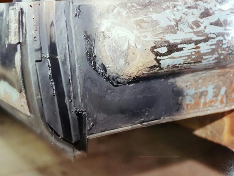

Under the front was painted black. Looks original. Did these come with black under the front?

Seems the black under the front is some kind of undercoat. Found it elsewhere on the frame. It is a bit rubbery and I can scrape it off. |

There were a couple different types. Some saved the steel from moisture and some ended up holding more crud against the metal in the long run. The rubbery stuff had a tendency to crack and allow water to enter and puddle inside it. There were several places, even dealers, that offered "undercoating" which literally meant "under" as opposed to paint undercoat. |

My original plan was like yours but decided I wanted better access while working so only went with a partial loop. Once one side is done I can switch it around to other side. |

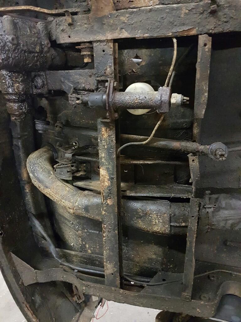

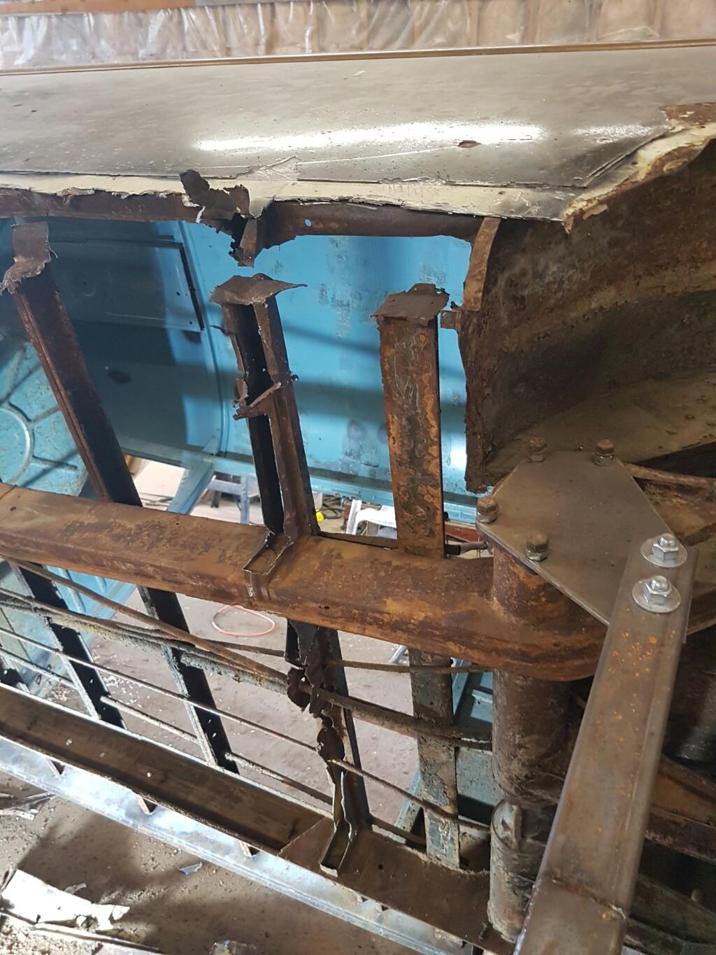

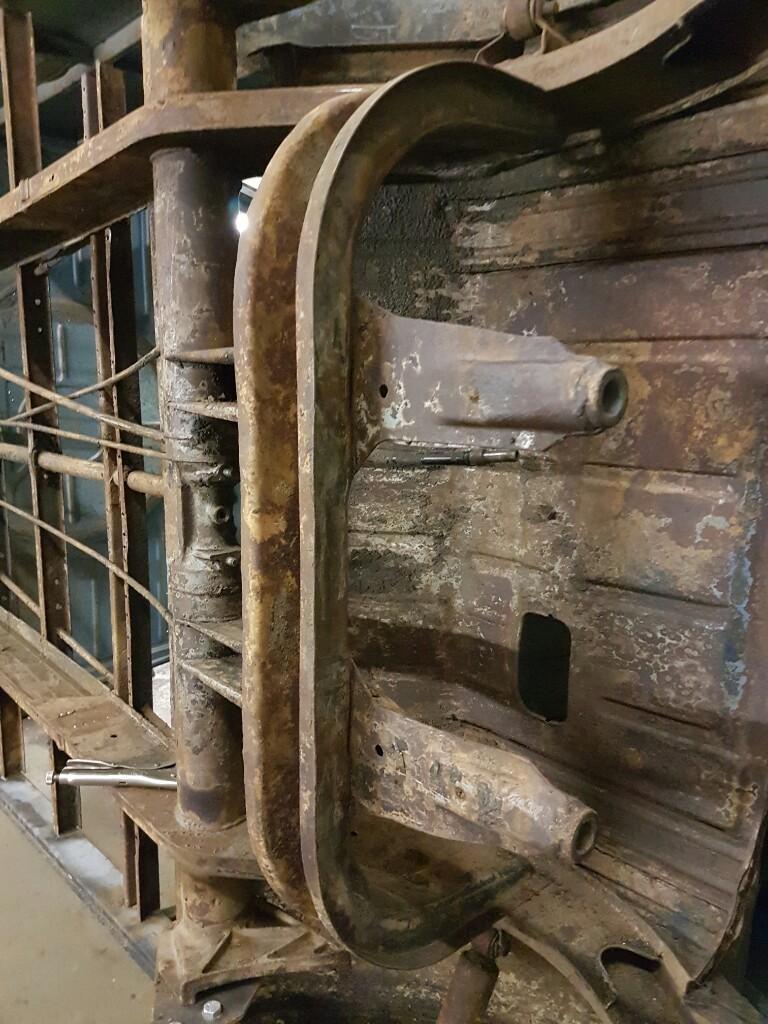

Stripped the bottom today. Saved the brake lines for patterns. Took lots of pic for the reassembly. Everything came off easily except the ebrake pin. Will keep putting the penetrating oil to it.
Getting more of the undercoating scraped off. The two cross member were thin and are cheap to replace so coming out. Will make it easier to replace the center heater tube anyway.
Think I should remove the y pipe. Just the floor holding it and can't get at some spots with it there. Do most remove it when doing similar restorations?

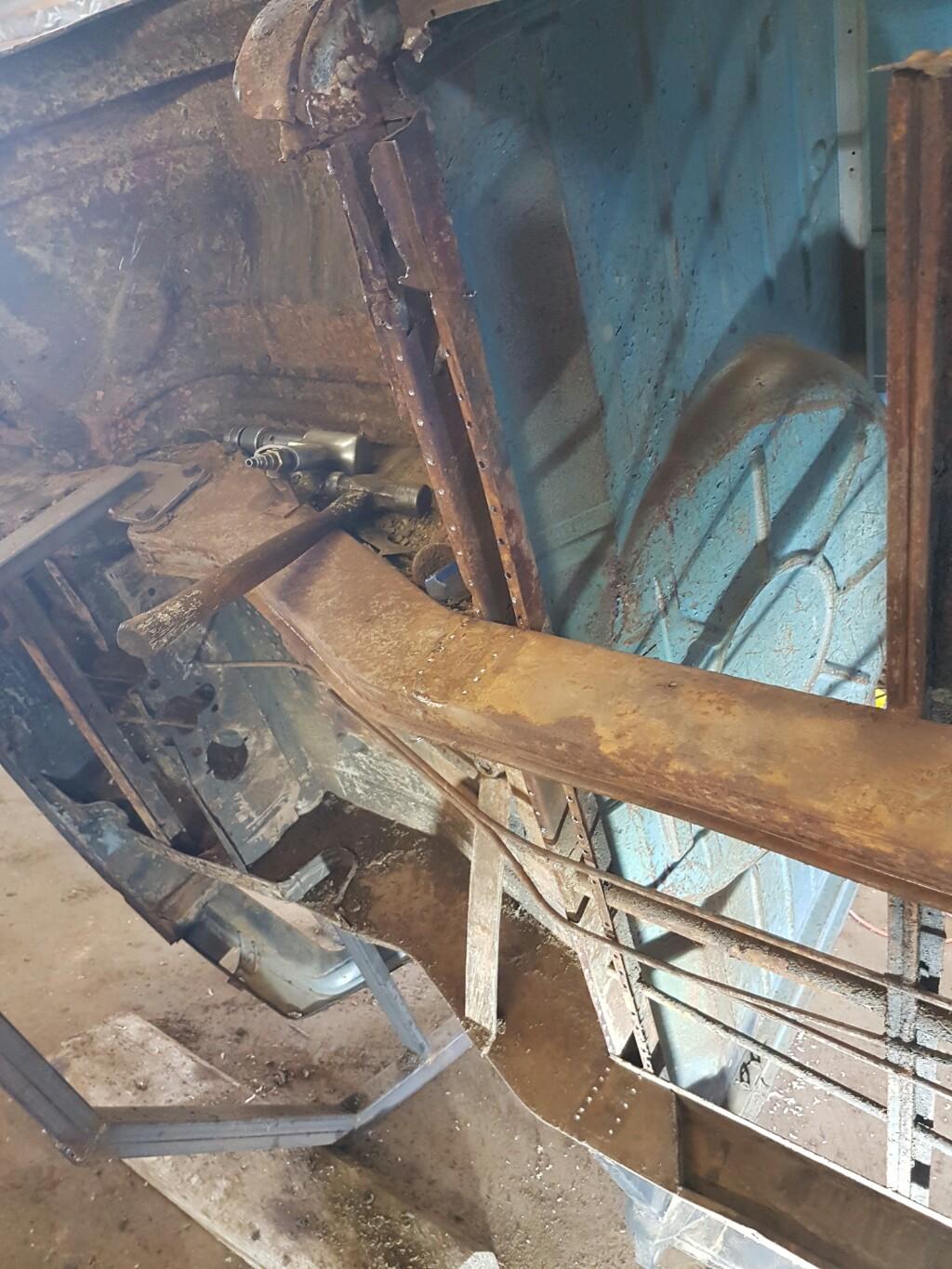

Removed some more today. Got the Y tube out. That was not fun. Love how they put the seam along the back of the floor. Very hard to get the spot welds out. Used a 10" long drill bit and bent the lip a little.

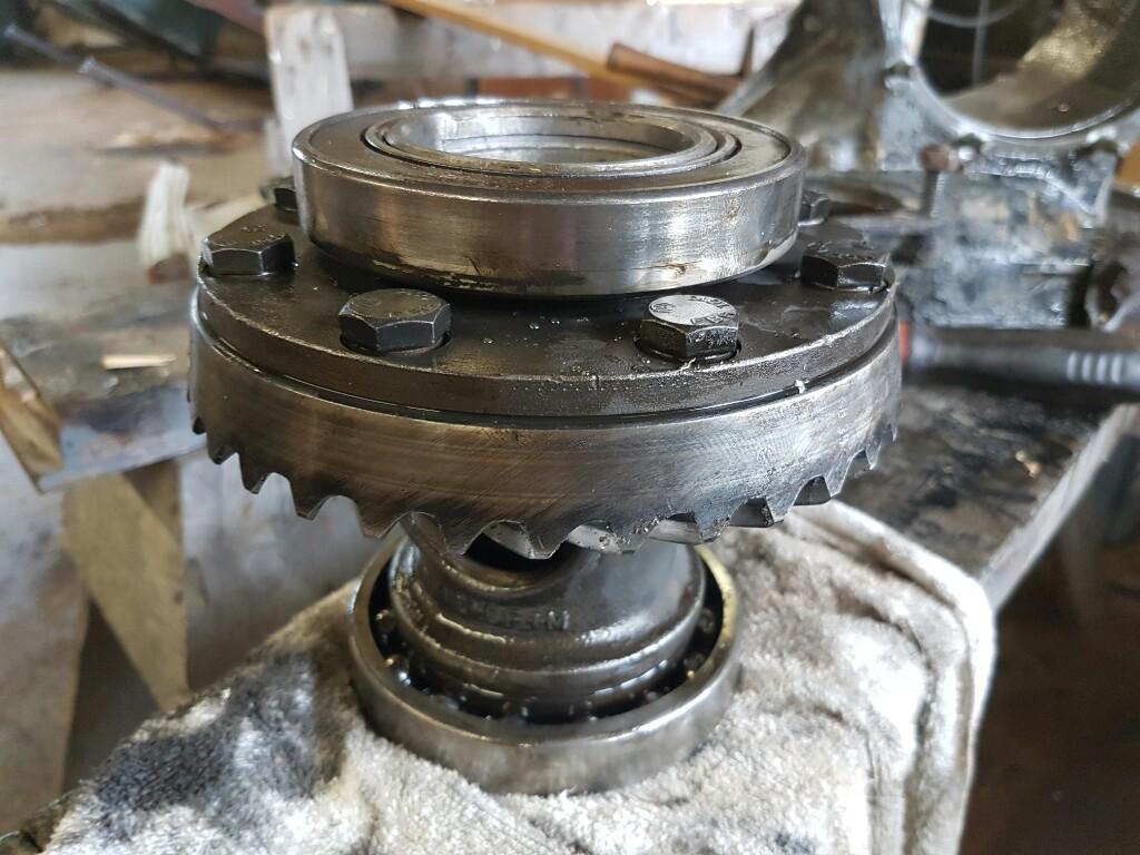

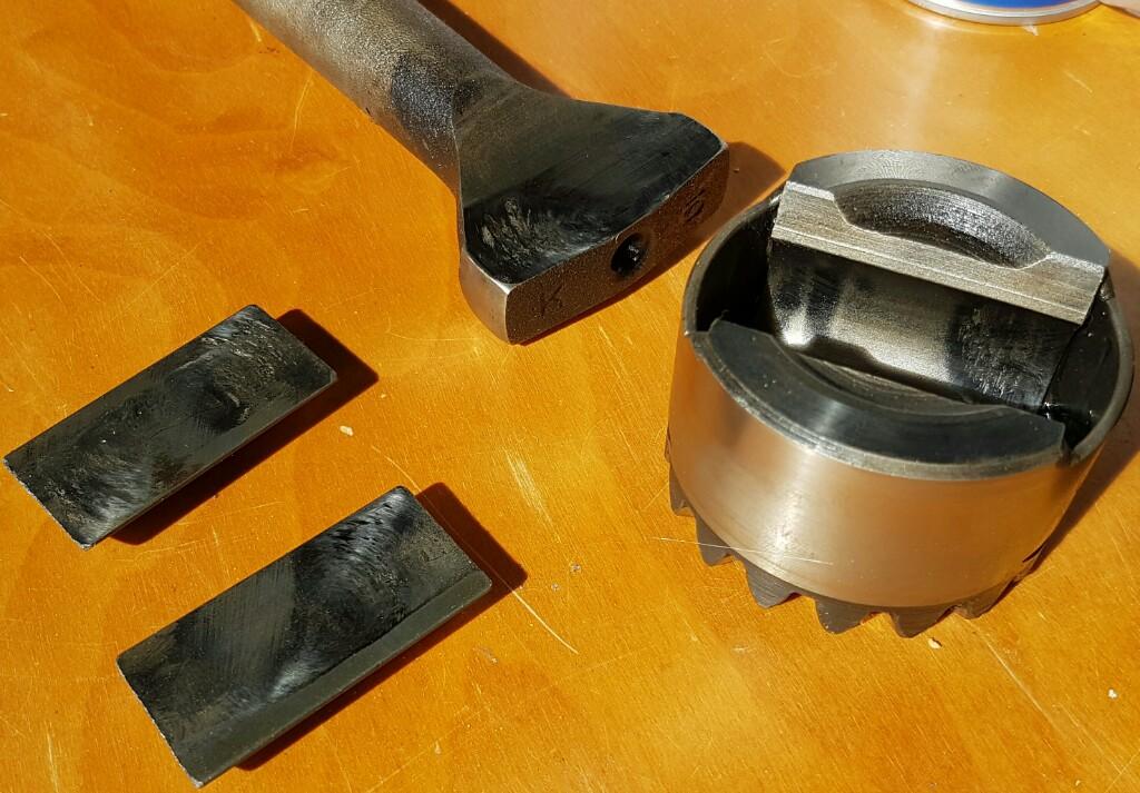

Reductions apart. All bearings need replacing but gears look great. Axels, fulcrums and gear have damage. No noticeable deformation but something very hard got in there at some point and cut up the surface. Nothing in the bottom so must have been leftover from a past repair.
Transmission stripped. Looks very good. Synchronizers all good. Will replace reverse gear and the bracket which has a groove cut in it. The differential bearings need replacing. Need new bushings for shift rod. Think it may be the original transmission. Is there a way to see what year the case number matches?
Back to top |

Posted: Sun Sep 25, 2016 4:41 pm Post subject: Re: 64 Kombi partial restore |
So I guess this is normal wear. I will pick up a set of used plates and gears. Axles I will switch sides. |
