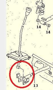

I just installed the Big Shot and it went pretty well. I will next install new tabs in the black box.
I am having trouble finding 1st gear tho, which was an issue with the old shifter too. If I go into reverse first, then out and do an extremely tight slide immediately to the right into first, I can find it. If I go to 'neutral' between gears, I have a hard time finding 1st.
Is this worn tabs? Or is it that the adjustment for throw (the threaded piece attached to shifter; see Bentley image) needs to be shortened or lengthened? I measured prior to removing the old shifter, as per instructions, but not 100% sure I got the measurement exactly perfect.

PostPosted: Tue Jul 13, 2021 11:56 am    Post subject: Re: big shot shifter Reply with quote
tarandusVDub wrote:
...If I go to 'neutral' between gears, I have a hard time finding 1st.
Is this worn tabs? Or is it that the adjustment for throw (the threaded piece attached to shifter...
You should probably inspect the connection by the transaxle - that ball & cup arrangement.
The ball can wear or even break off completely resulting in ever-increasing vagueness in the shift, esp R and 1-2.

OK thanks, very helpful. So can i tell by visual, or is there a lot of play in the joint? How do I tell if its worn excessively and needs replacement?

tarandusVDub wrote:
OK thanks, very helpful. So can i tell by visual...
Mine was pretty obvious when I watched it move:

Thanks for the tip. Mine was shot. The nut was very, very rusty but with some PB Blaster and a torch it came off ok and I didn't have to pull the transmission. Now it looks like the clutch Master/Slave need replacing. Those things, along with the Big Shot, should make it actually fun to drive! $yncro.
